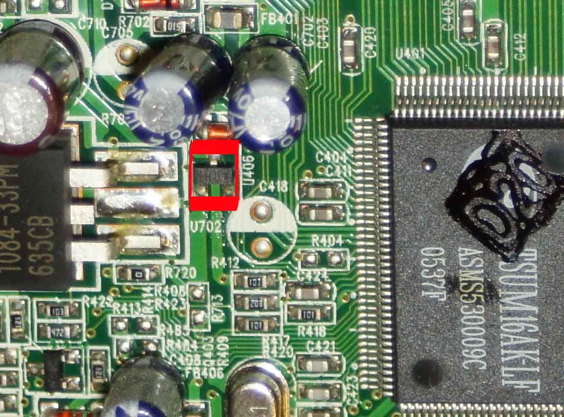

      #62
      Re: No power on a Acer AL1916
      While prepping the image, I realized that I can view the hi-res image in actual pixels.
      Eureka! I see U406.
      The part is in back-order at digikey until mid June. I removed it like the surgeon who took my appendix and voila, I have a working monitor!
      I have another AL1916 at work. The boys requesting for dual monitors for their workstation will be happy.
      Thanks to all who have contributed to this thread...
      I'm contributing by attaching the board, boxed the location of U406.
      I ordered the caps and will replace the Elite brands.
            Same problem here with the Acer AL1916. I removed the U406 Maxim reset circuit and it works no problem. I checked all the capacitors and visually they all seem brand new.
            I want to replace that circuit but I can only find the reference MAX810MEUR+T from RS Amidata but I don't know if that's what I want.

              #66
              I used a 26 Watts solder, I wonder if it's ok. Two more questions.
              1.- Many people around the world seem to have just the same problem with that LCD. Can I be certain about most probably having the same problem in the future?
              2.- Could that reset circuit has anything to do with refresh rate on the LCD.
              Thank very much everybody at badcaps.net and special thanks to PlainBill.
              There is a big mystery about this particular GPU. I'm coming to the conclusion that the reset controller should never have been installed, but I can't find any documentation to prove that.
              No, the reset circuit should not have anything to do with refresh rate.

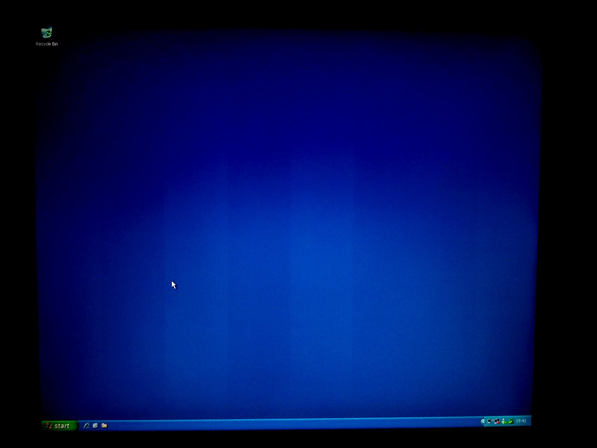

                  Very short time before I found a problem that hadn't happened before.
                  I didn't realise yesterday as it was a quick test just to see if it turned on basically. The problem are some vertical stripes and I don't know if it has anything to do with not replacing the reset circuit E406 MAX810.
                  What do you think?
                  The stripes are not as clear and annoying on that picture as it is in reality. The screen look a bit foggy, mainly on the borders, but it won't show on a picture. It might be that I have damaged something while removing the E406 or something else.
                  I'll try to replace the Maxim reset circuit ASAP and see if that makes a difference. I'm afraid it won't solve the problem so any advice is welcome.
                    A missing reset controller should not do that, but bad capacitors might. Remember that they can look good without being good.
