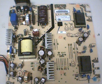

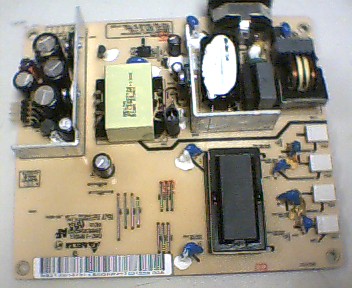

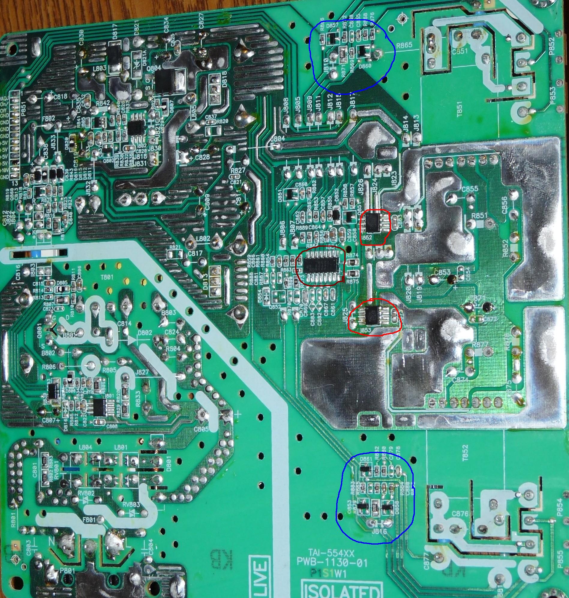

    I have two monitors at work, one is a 22" Viewsonic and one is a 22" Gateway. The Viewsonic had around 4 bad caps so I replaced all of them with the equivalent Panisonic FM caps. The Gateway didn't seem to have any bad caps, but I replaced mostly all of those as well. I tested all the CCFL's with an inverter from CCFL computer case lights and they all seem ok. I'm not sure where to go from here. Both monitors light up for a second then turn off. Thanks for the help

    Bad inverter transformer driver transistors take some pics of the boards and I'll circle them for you.

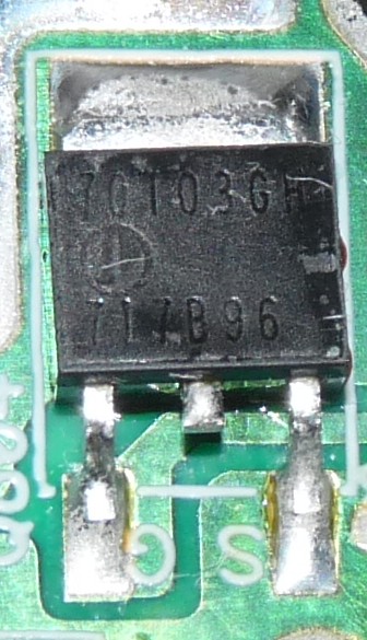

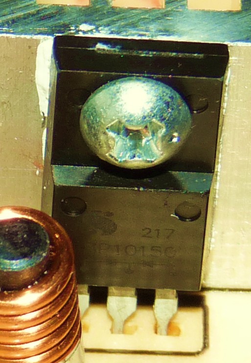

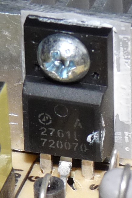

        I think these are what I need? The problem is I can't find them on Mouser, or Digikey. Are these what I need, and if so any idea how to replace them?
          Correct me if I'm wrong but I believe those are called MOFSETs. Check Digikey.

            I can't find any info on the part numbers, so I don't know what to order.
            Can you just buy a higher rated MOFSET, or do I need to know the voltage and other specs. If so, does anyone have a way to find some info on these parts?? Thanks for all the help.

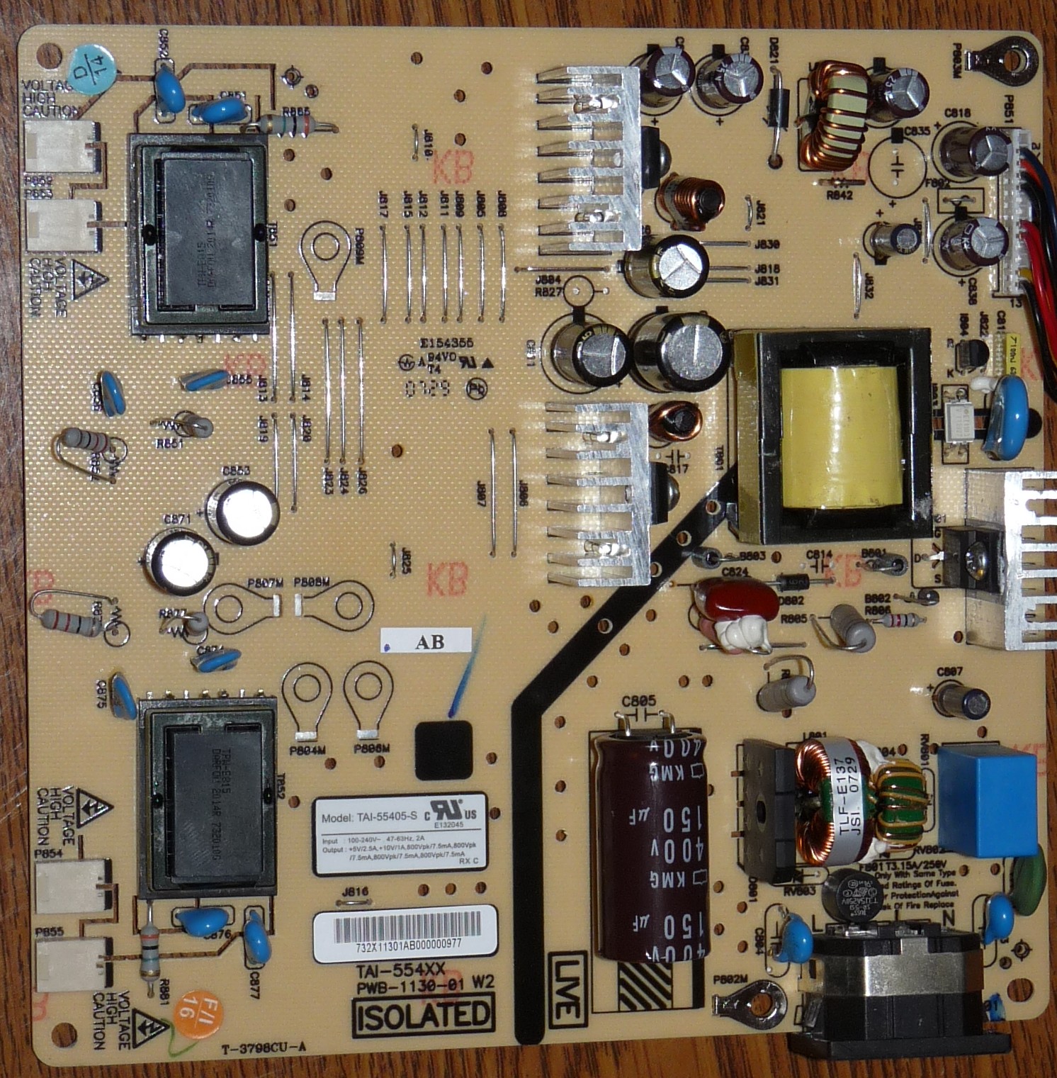

              Re: Monitor Turns off after a few seconds with new caps
              The parts you are calling MOSFETs probably aren't the xfmr driver transistors.
              The xfmr driver transistors are the usually the small old style 3-legged jobs.
              They basically cut power to transformer primary on-off to make it higher voltage AC.
              The drivers are the "switchers" in a SMPS.
              What you are looking at in pics are on the secondary side of xfmr.
              They take the higher voltage AC and turn it back to DC again.
                Both of those boards probably have the drivers on the solder side as flat packs or SMD's, since I don't see them on top (but the pics are very small). I don't think they are bad, as it does work for a second or so.
                I'd be suspicious of the HV transformers, output caps (little round blue ones), or the tubes. I believe the current monitor circuit is sensing an overload and shutting them off. Also check and resolder the HV transformer connections. It's a common failure point on various makes & models of inverters.
                >>I tested all the CCFL's with an inverter from CCFL computer case lights and they all seem ok.<<
                Now try it the other way around. Try running the case lights with the inverter. Do Not run it for more than a few seconds for each tube.
                ** DO NOT RUN THE INVERTER WITHOUT THE TUBES CONNECTED **
                Can you post some larger top side pics and equally sized shots of the solder size?

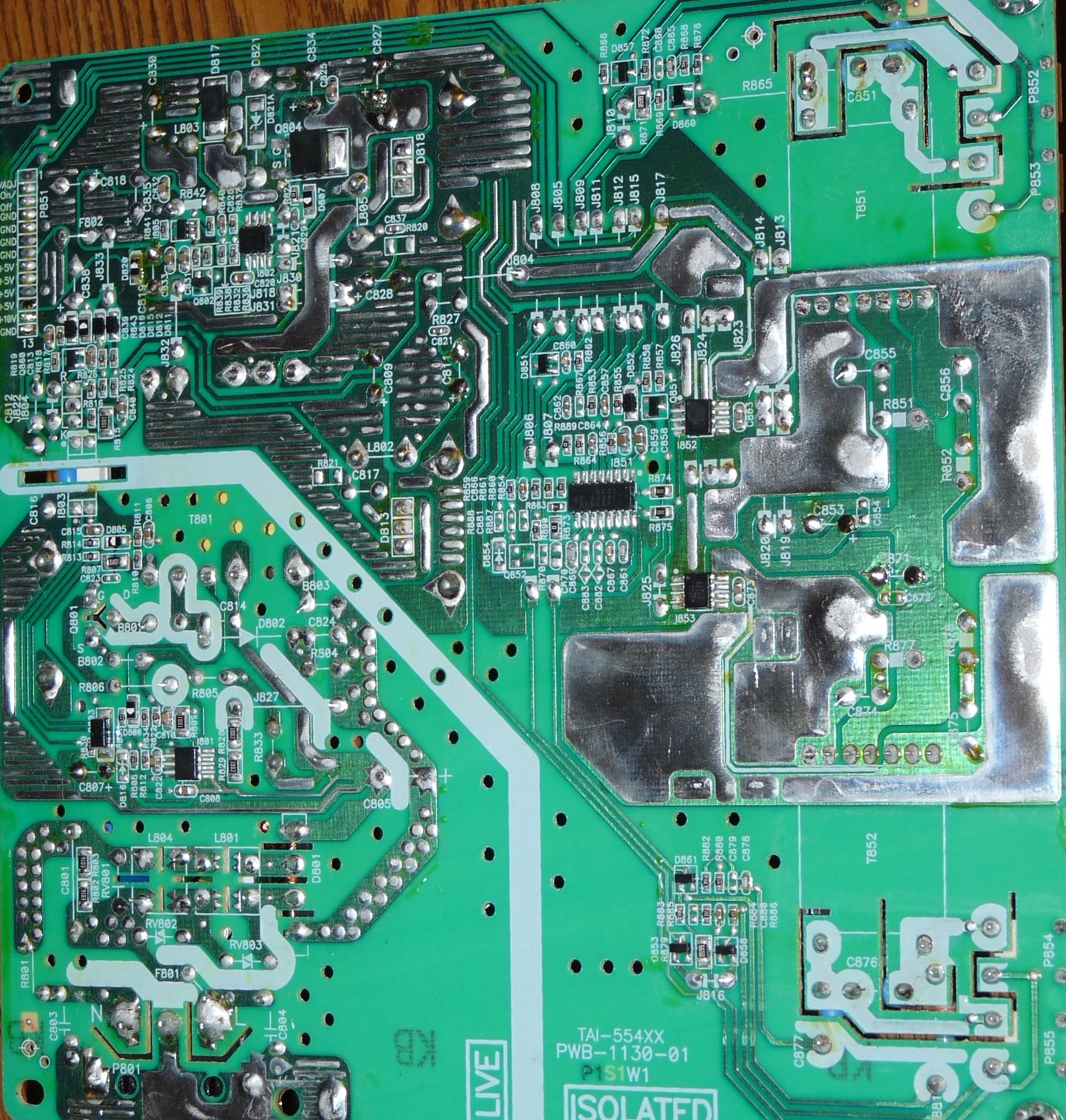

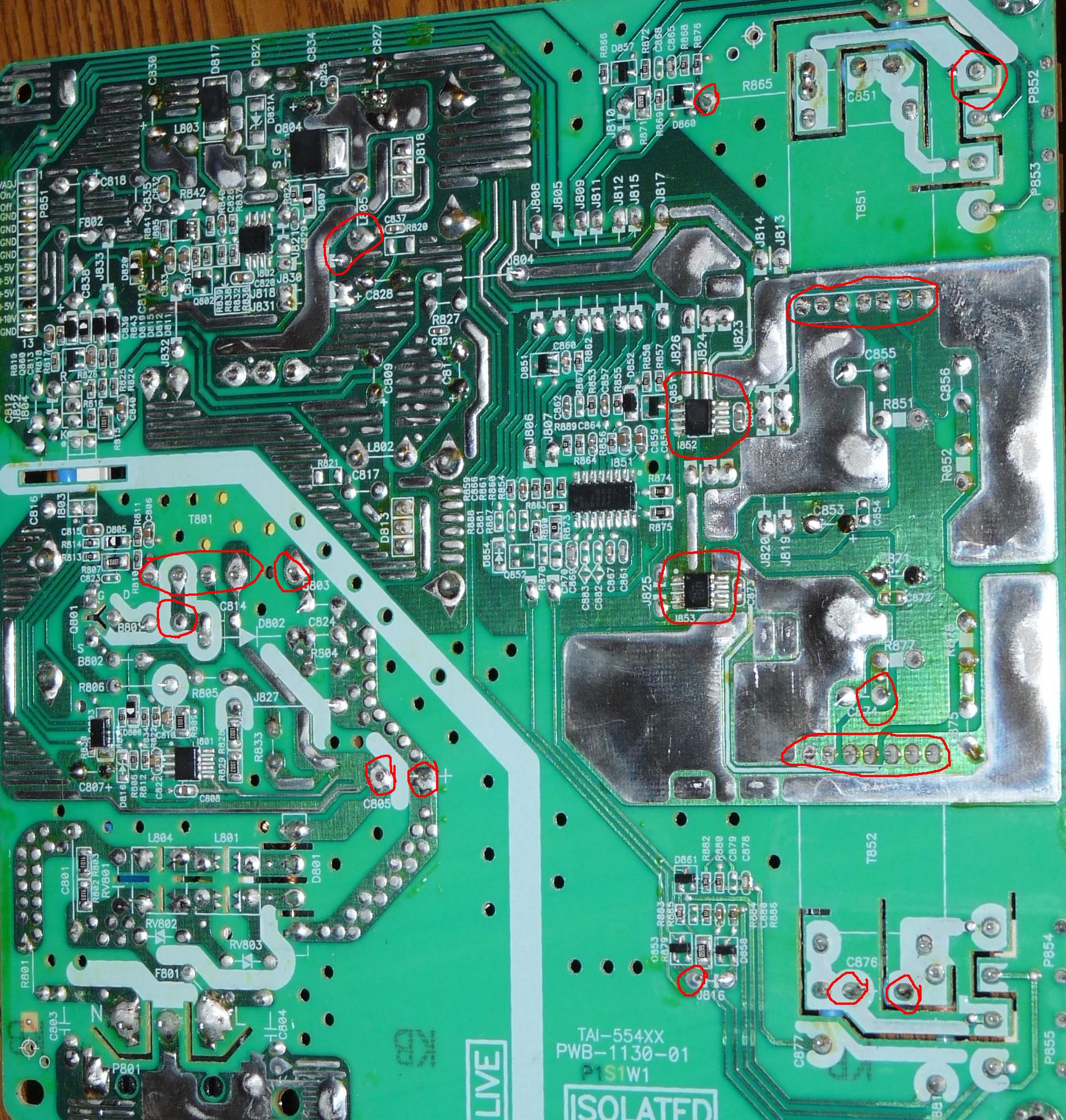

                    I've marked up the picture of the bottom of the Gateway board. The IC in the dark red circle is the inverter controller. The two ICs (actually FETs) in the bright red circles are the drivers for the inverter transformers.
                    I'd agree with PCBONEZ. The drivers are probably fine. Certainly if each output will light up a CCFL for a few seconds the drivers are good. (Note that it is difficult to determine if all four monitor CCFLs are lighting in the few seconds they are on. You have to see individual CCFLs.) The components circled in blue make up the monitor circuitry for each pair of CCFLs. The outputs of these circuits lead back to the inverter controller.

                      Look at those cracked joints on the inverter transformers and on the CCFL output jacks! The first pin on both of those CCFL transformers looks completely cracked all around!
                      Resolder everything circled in red and go over the board with a magnifier and check for more. If I found that many from the pic I'm sure there's more.
                      This is Standard Operating Procedure for me to go over any board after I replace the defective components so I don't usually mention to check for cold joints.
                      Sheesh who runs QC on these wave soldered boards?

                          I'm willing to bet this is due to the lead free solder craze started by the EU many manufacturers still can't get it right.
                          Or they are using their old leaded solder equipment which isn't designed for lead free creating these joints.

                                    Today I resoldered all the spots on the board other than the two small chips.
                                    Still seemed the same. I then tried to plug the tubes from the Viewsonic in and that stayed on. It seems like 3 of the 4 tubes are bad. Could a bad solder point make 3 die at the same time?(kinda dead they still light for a few seconds) I guess I need some new ccfl's. How hard are they to change? I've done a few on laptop lcd's but lately I've just replaced the whole lcd. I never get the ccf'l's to fit right and the screens always distort.
                                    I also just read this post about re-doing the solder on the end of the ccfl's
