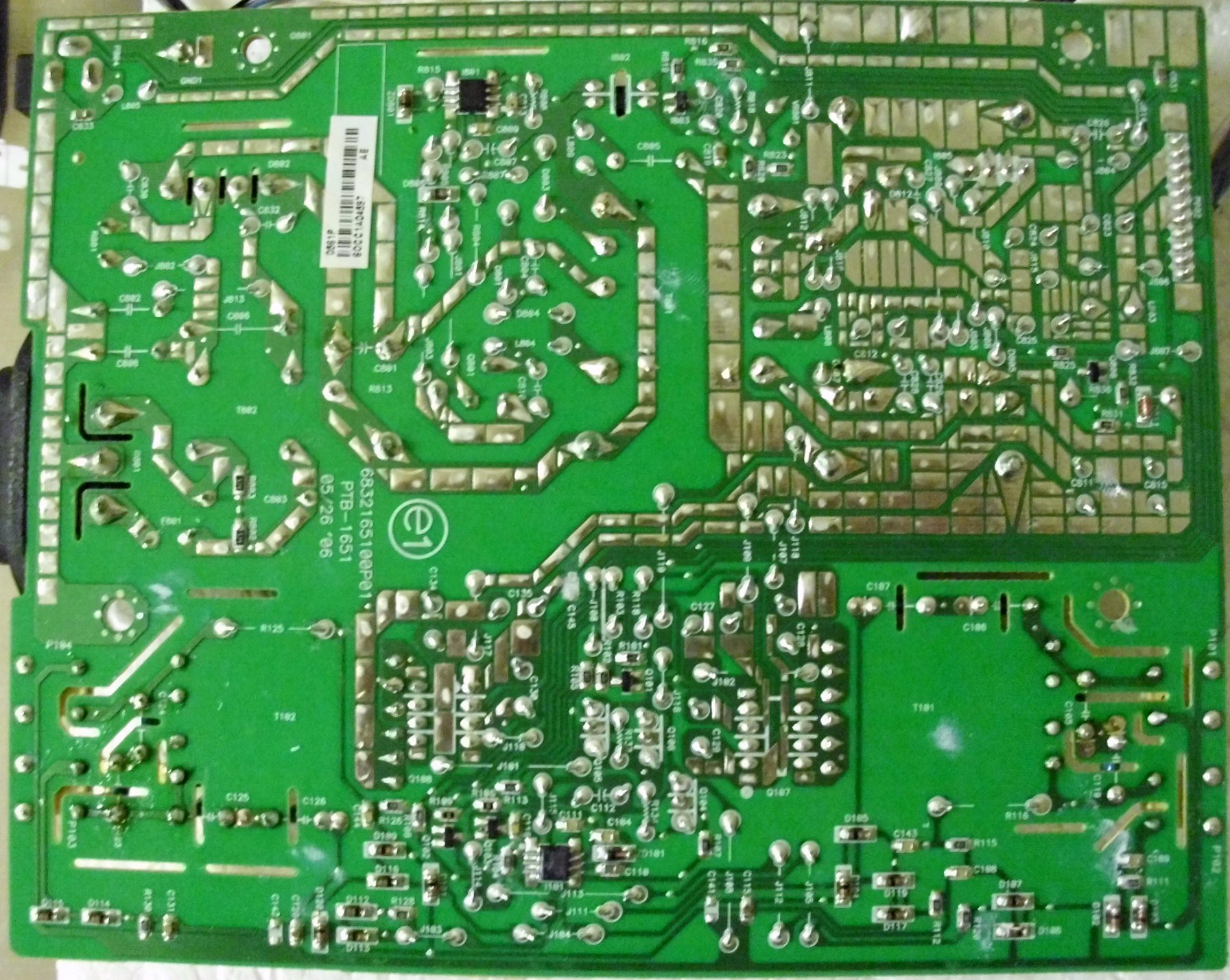

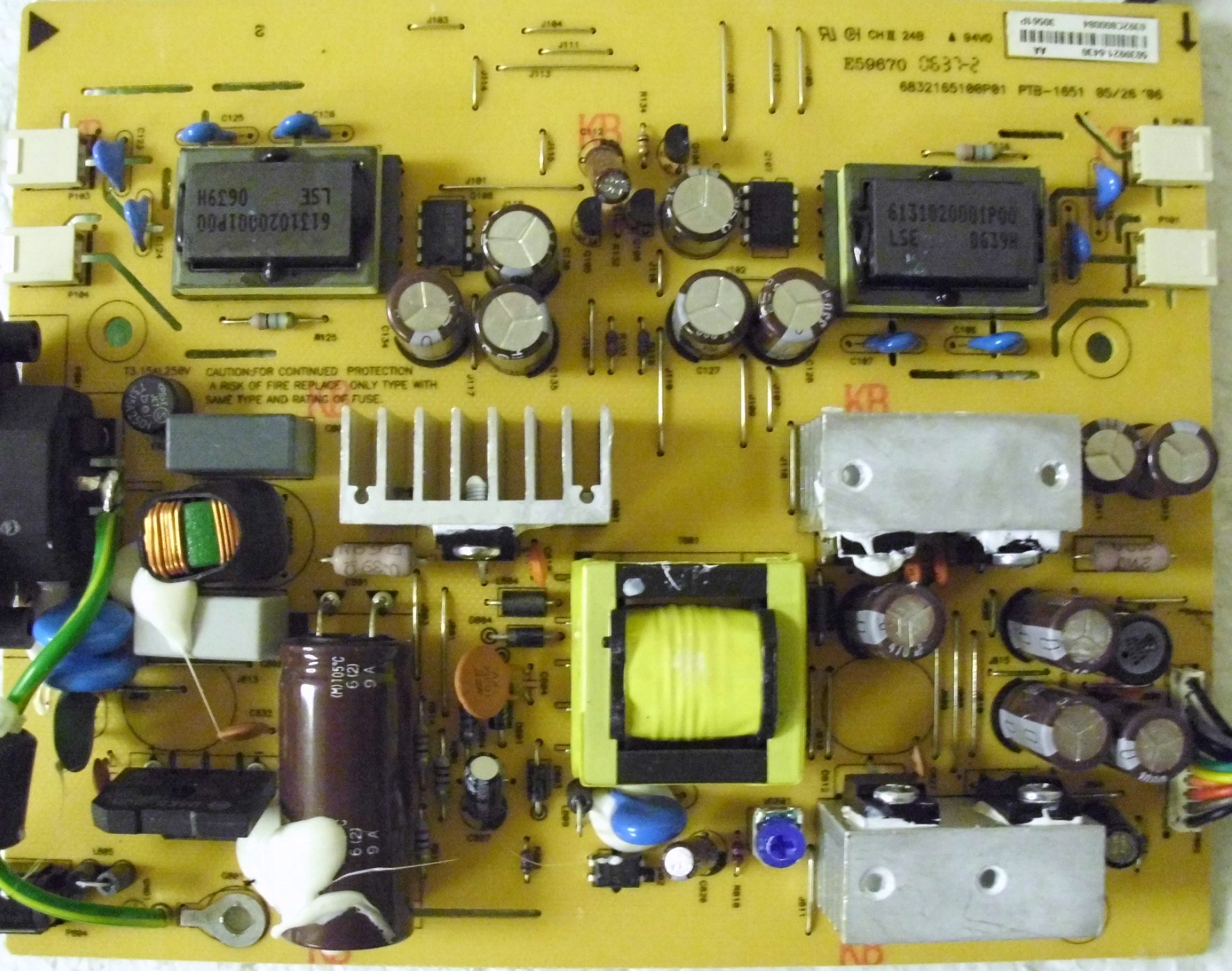

          I wondering if we could start this thred up again.
          My Dell 1907 is showing a good green light when video siginal is present,But no back light activity at all.The discoloration on back of board is because of lighting.I have resolderd the two coils for back lamps. The ic chips 8 pin near
          the two coils is a # bd6t18. also, This board looks just like the one they use in the 1707fpt. I have used known good lamps for testing

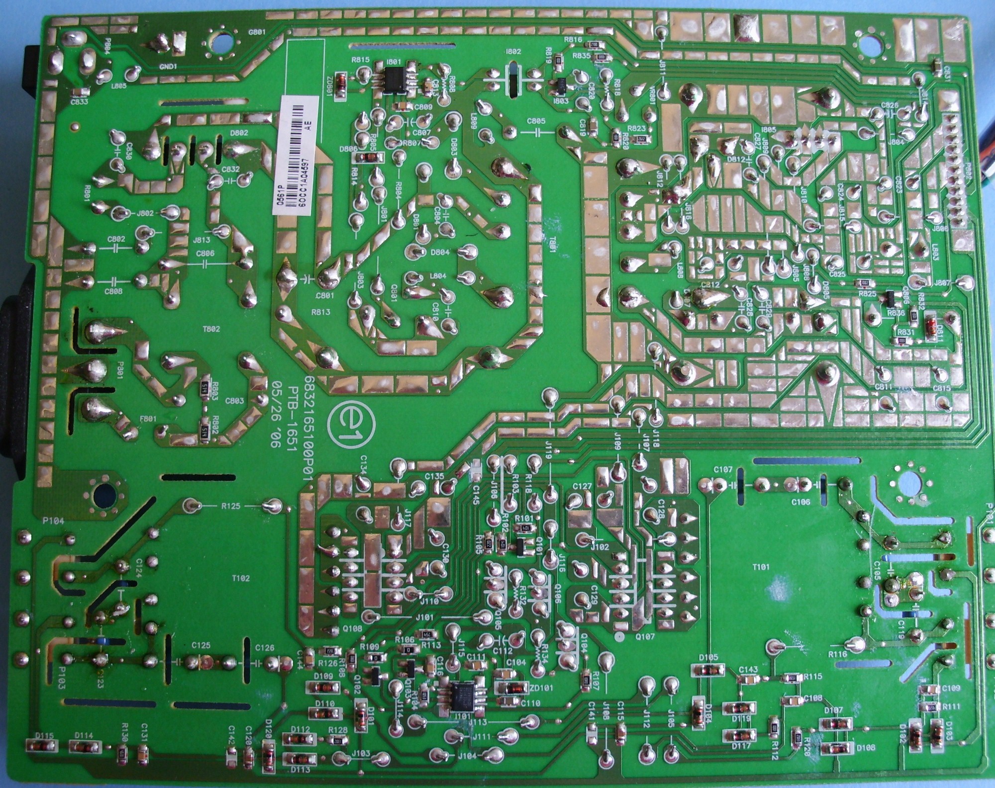

            Hi! I have exactly the same board here with similar symptoms. It's from a Dell 1707fpt I rescued from the dumpster recently I checked all power supply and logic board caps with an ESR meter and didn't find anything too suspicious, all were 0.1-0.3 ohms. I replaced all the inverter caps anyway but there was no change. Next I'll have to try with good lamps from another monitor I rescued (Acer AL1716A, has problems with VGA syncing but steady backlight ).
            Is there a schematic of the inverter on these Dell boards? There are a lot of tiny SMD transistors which are hard to identify.

              I would like to add that there is an audible 'white' noise which seems to come from one corner of the LCD panel when the monitor is turned on. I tried to localize it and it doesn't seem to come from the power supply/inverter board. The sound ends when the backlight is switched off in about 2 seconds after powerup.
              Is it possible for the CCFL tubes to emit noise? I'll try to switch the inverters and backlights from the Acer monitor mentioned above tonight, and see where the real culprit is...

                    jsaily, the 'white noise' sounds like arcing at one of the CCFLs. This can be due to a bad solder joint, or bad insulation on the wire.
                    Alexanna, your problem is a lot harder to identify. It could be anything from a problem on the logic card to a bad solder joint in the inverter. Other suspects include no power to the inverter, and shorted (or open) transistors.
                    The biggest problem is going to be identifying components. Related to that is the pictures just aren't clear enough to be really useful.
                    Let's try a slightly different approach first.
                    On the bottom of the board in the inverter area is an 8 pin IC, either I101 or IC01. What is the part number of that IC?
                    In the lower right hand corner of the top view is the multi-conductor cable running to the logic card. Is there any legend identifying the function of the pins?
                    The two 'ICs' by the transformers appear to be transistor arrays (identifier starts with Q). Please write down the information printed on them exactly as it appears. I suspect BD6T18 includes a date or production code.
                    Have you tried to see if there is any image present on the monitor while the power led is green? Sometimes a flashlight helps.
                    OH!! And do you have access to a better camera?
                      Thanks for the tip! I'll try to move the wires a bit and see if there is any change to the noise. Can you suggest an easy/safe way to resolder the CCFL wires? I've got no prior experience on dismantling LCDs, but am willing to take the risk in this case Also, is it safe to test the inverter without all tubes connected, like one at a time? If the safety circuit kicks in without a load then it doesn't work...

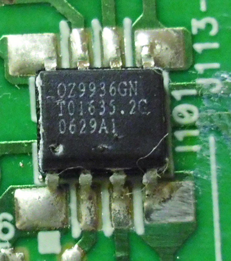

                      By the way, I read the inverter driver chip to be BD6D24 or BD6D2H with a production code P607. It's really hard to be sure. The SO8-sized chips on the under side have markings which need a magnifier to be read, I don't have one at home but maybe I can bring the board to work tomorrow and check them out.
                      The discrete TO92-sized transistors around the inverter are 2N7000 (N-ch MOSFET), 2SC945 (NPN) and 2SA733 (PNP). There are a few surface mount transistors on the underside the markings of which are hard to read.

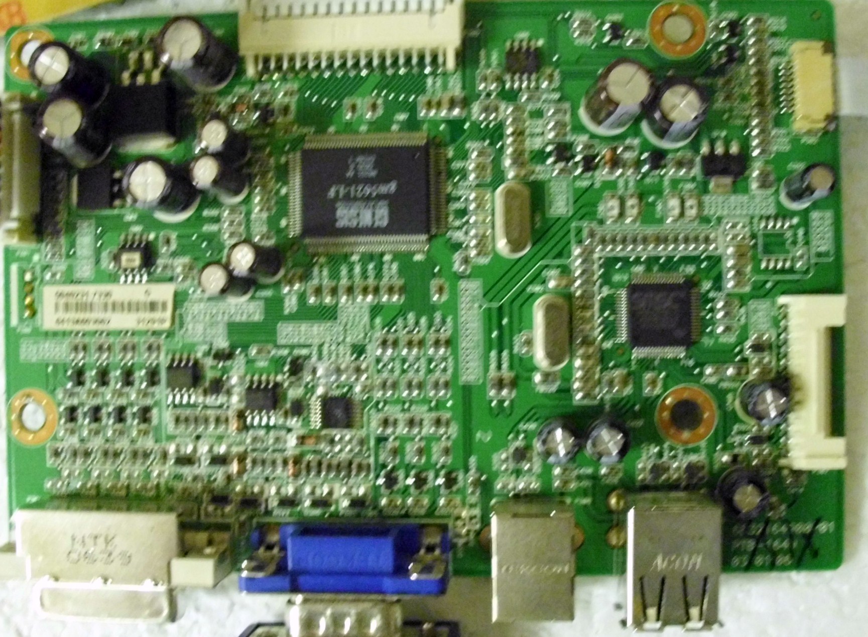

                          I think I have some better pictures. The multi colored wiring from the psu. To the video board has no identifiers. The monitor is apart at this time so I do not know if a image appears w/flashlight. If I could identify which wire was commanding the bl. On I could at least know if the video board was asking for b.l. The power led dose go from solid green when video is hooked up to solid amber when vga is disconnected. If needed I ill reassemble to check image w/ flashlight

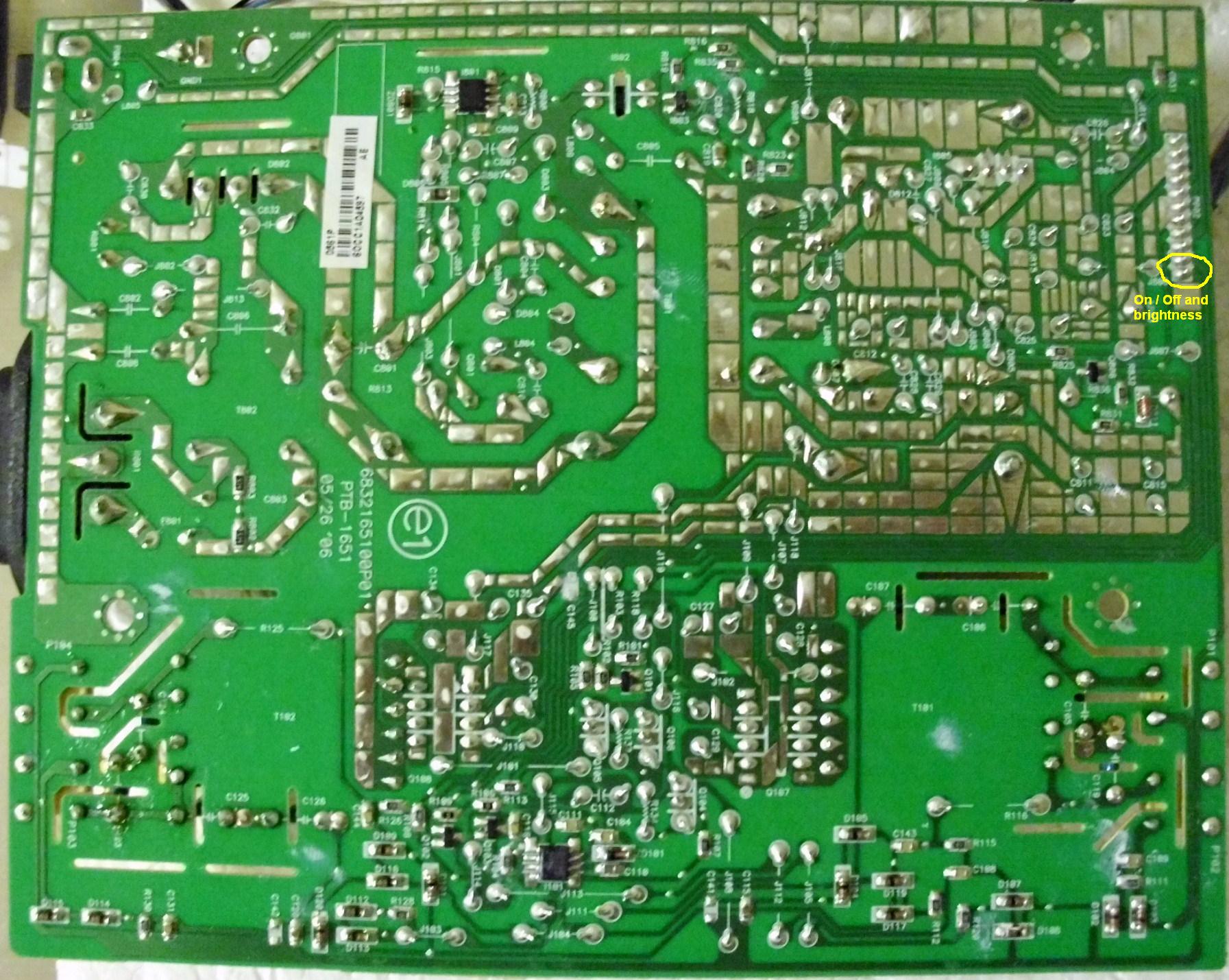

                            More Paint!!! I've identified the two lines that control brightness and turn the CCFLs on and off. See attached picture.
                            The inverter controller is an OZ9936. The manufacturer's site is here. For some reason they don't have datasheets available.
                            I'm trying to identify the manufacturer of the inverter drivers. What is frustrating is I have seen the logo. It does not appear to be Advanced Power Electronics Corp, although the logos are similar.

                              On the bottom pin, reads 2.5v monitor on and 3.3v off.
                              pin 2nd from end is 3.3v on w/green light and 0v monitor off.And yes Iimmage appears on screen w/ flashlight. Its looking like this might be fun,I havent been able to find any data on these 2 items also.

                                As an exercise for the student, locate the inverter power line and check the voltage on it.
                                For extra credit, trace the two lines above and see if their are any dead semiconductors in the path.

                                    Let's see if I can make myself clear. The power supply and inverter are on the same board, but there are often only two conductors connecting them - Inverter power and ground. (This one seems to have four - possibly multiple traces). The bottom two pins on that connector carry the brightness and On/Off control signals from the logic card.
                                    Why won't an inverter work, even for a brief second? In detail, there are many reasons, but some are easy to check. Let's list a few:
                                    1 No power from the power supply (typically 12 volts, could be higher).
                                    2 No 'On' signal from the logic card.
                                    3 Brightness set too low (again, from the logic card).
                                    4 Defective inverter controller
                                    5 Defective drivers
                                    6 defective transformers
                                    7 On/Off signal not getting to the inverter controller
                                    8 Brightness signal not getting to the inverter controller.
                                    You have already found that 2 and 3 are not the case, but those control signals often go through one or more transistors and resistors. Tracing those lines in a picture is a royal pain in the anatomy; it's only slightly easier if you have the board in hand.
                                    The power is a different matter. Most designs provide power to the inverter whenever the power supply is plugged in. There are two ways to identify the actual traces. At this point you can stop reading and see if you can figure them out.
                                    But I've lead you on the path to enlightenment (that really sounds like I'm full of it) long enough.
                                    Clue 1. Power supply traces are much heavier than signal lines. Ground is easy to identify - somewhere or the other it goes to the pads surrounding one or more of the mounting holes.
                                    Clue 2. Large electrolytic caps (typically 220uF - 1000uF) are used to filter the power supply. Where do we see those? Well, we see two clusters of them in the area of the heat sinks. And we see six of them in the inverter.
                                    So here is your homework. Be careful - voltages up to 160 VDC are present on the power supply!!!
                                    1. With the power unplugged, verify that the - pin of the electrolytic caps in the inverter area actually go to ground.
                                    2. Plug in the power and measure the voltage across those caps. If one or more are at 12 - 24 volts, we know the power supply is working, and the inverter is getting power.
                                    3. Trace the two lines from the logic card as they go to the inverter controller. Make sure they change state as you hit the power button. IF for example the line that goes from 0 to 3.3 volts goes to a transistor, but neither of the other two leads of the transistor change voltage when the button is pushed, you probably have found the problem.

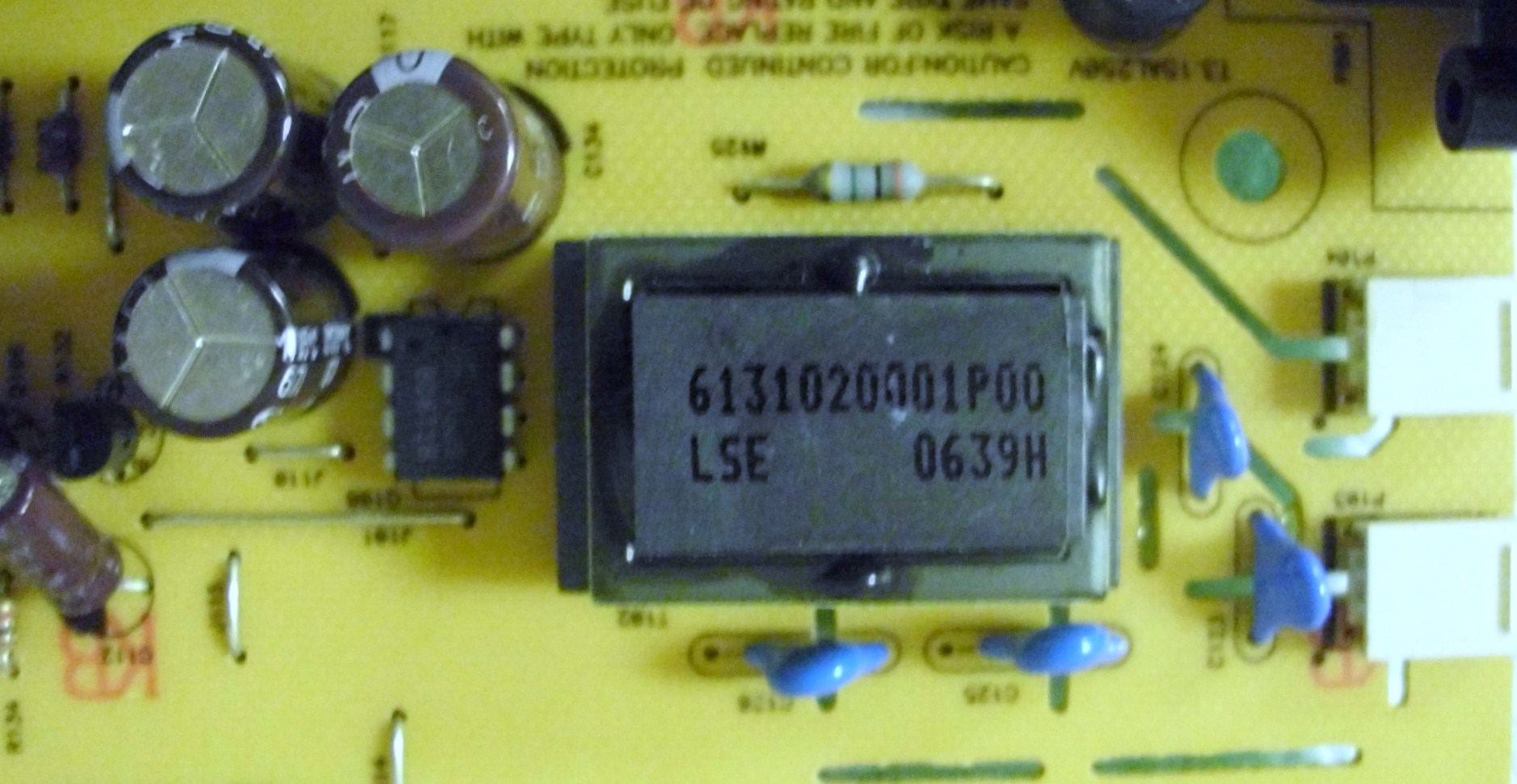

                                      hope this help. the output MOSFET are P609 OR AOP609 manufactured by Alpha & Omega Semiconductor

                                        I have also have what I beleave to be a better pitcure of back of board
