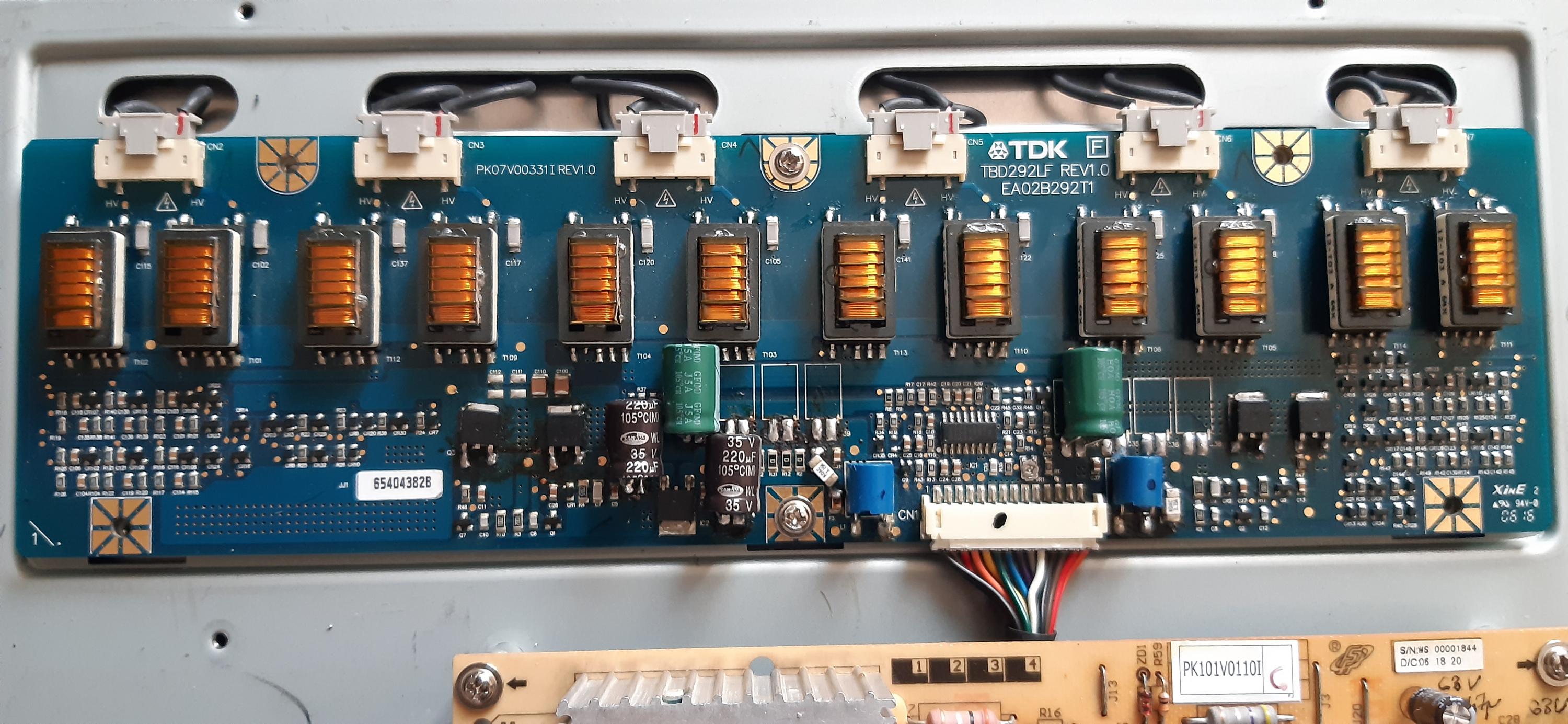

        It may not be really dead as an open winding, at least I haven’t come across one. First check the resistance of the secondary output side of each transformer and compare them to each other. They should run within 3%. Also look for burn or darkened circuit board underneath a transformer. A bad transformer runs hotter. Check for cracked solder joints and those blue little hv capacitors on the output of the inverter.
          Re: Acer AL2416W backlight
          Attach good clear pictures of the boards will help.

            So I today replaced 2 of the caps to another brand, and cleaned the board, also resoldered all transformers, but nothing helped so far.
            I attach the best pictures I can.
            Important, that the discoloration of the board near the left side caps is because the poor quality flux my friend's dad used, and the misaligned mosfet is because he ripped some trace here and there, and the whole board was badly soldered with really poor quality solder, that I couldn't pick up with my wick.
            However, my soldered connections are allright, according to my multimeter.
            I noticed, that there is a pot at the connector. I don't know if he messed with that, but what should be the value?

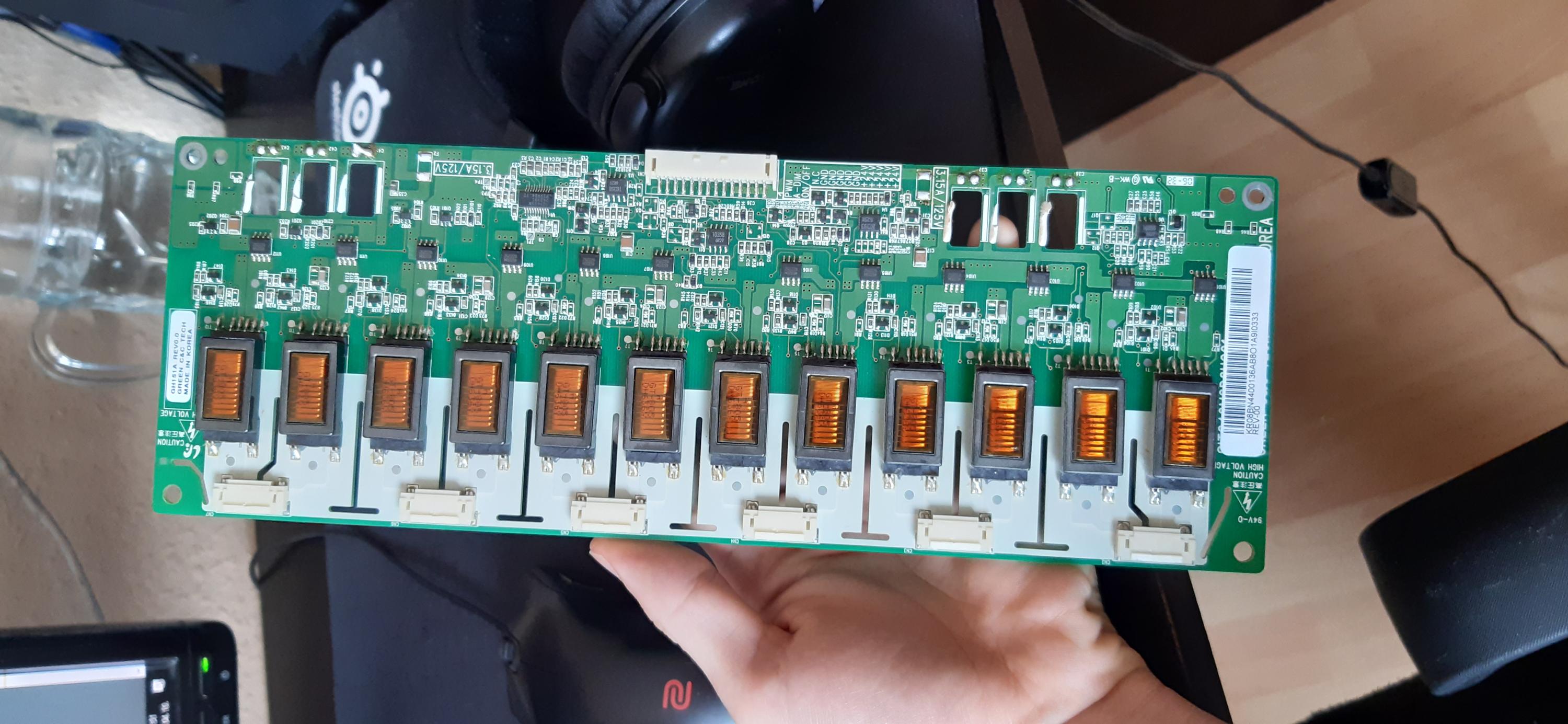

            EDIT: I was just wondering if I could use another 24" screen inverter (got it from a Samsung), since it has the same amount outputs, the connectors are the same, hell, even the 14 pin pinout is the same (only the last, 14th pin is "PWM" meanwhile the TDK has it as "NC".). This is the inverter I got the 3.15A fuses from, and it had rubycon caps which I could put back. (Picture included).

              Well.. I did reassemble the samsung's inverter and put in the Acer, and the backlight works now.. Since the original board is badly messed by my friend's dad, I might rather use this, known good inverter. What do you think, could it work in a long term usage like this?
              • R_J
                • Jun 2012
                • 9558
                The inverter will work ok, there is not much difference between them.
