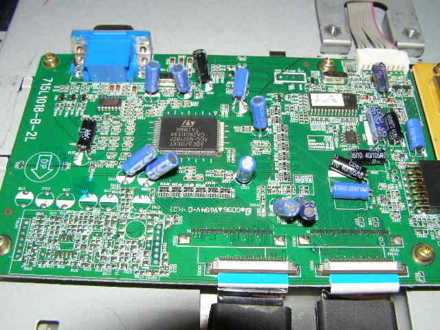

          I had previously opened it up and shotgunned a lot of caps on the inverter board. I didn't get a couple of the smaller value caps because I didn't have their values in stock. I haven't touched the main board yet.
          None of the caps were leaking or bulging.
          The caps that are on both boards vary by brand. I noted "HEC" and "TL". I changed out the larger caps on the inverter board for Sanyo brand caps.

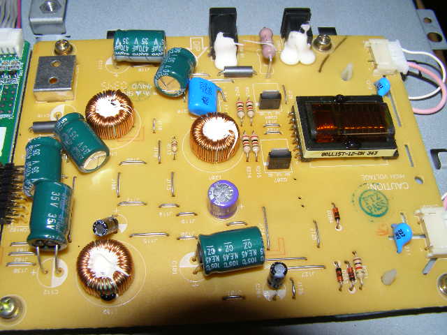

                Pics, as promised.

                      Check the transformer and those coils in pic 2 for cold solder joints.
                      Common problem on large parts when they solder the whole board in a machine.

                        I think you have two SMD fuses on the inverter board that cannot be seen in your pictures because they are on the solder side of the board, one by the input jack and the other by the output plug to mainboard (they are very small)
                        Also with these boards there is a common problem with bad solder joints on those big copper circles (torrids) They require resoldering

                          You were absolutely right! One of the torroids had a big-time broken solder joint on it. Touched ALL the torroids up and any other suspect joint and it fired right up.

                            Torroids = "those coils in pic 2" - I wasn't sure you'd know the name.
