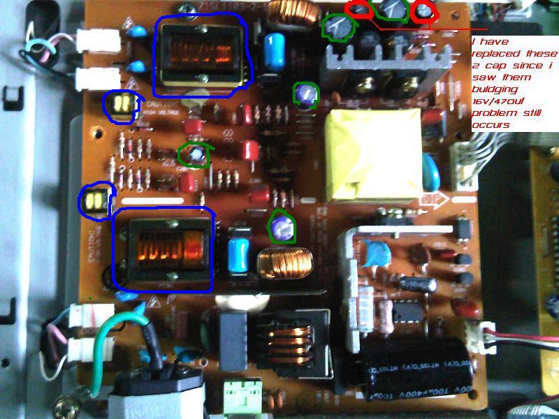

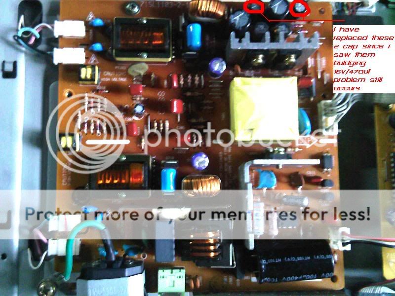

    i have an aoc lm 725, the problem is screen goes black but if you turn off the lcd then turn it on again you can see again the window screen for about maybe 3-4 seconds then goes blank again
    here is the shot of my inverter, can anyone help me the common problem with this unit, thank you masters
    on the 1st pic i have replaced those two encircled capacitors since i saw them buldging but then the problem still occurs can anyone help me?

    Re: AOC LM725 screen goes blank
    I have LOTS of help.
    1. No d in bulging. Yeah, it's petty, but we have to start somewhere.
    2. I've circled a few additional caps in green. As a general rule, replace ALL electrolytic caps (excepts the 100 uF, 450 Volt one) if any are bad. I recommend Panasonic FC or FM series, or equivalent low ESR high temp caps.
    3. I've circled 4 transformers in the inverter section. Resolder every pin on those while you're waiting for the caps to arrive.
    4. Try the monitor in a darkened room to see if you can see any signs of arcing, particularly around the transformers.
    5. If it still doesn't work you have to determine if the problem is the inverter or the CCFLs. The best way to do this is to use the CCFLs from a CCFL case mod kit to test the inverter, and use the kit inverter to test the monitor CCFLs.
      woaaahhh, master plainbill sorry for the wrong spelling there man,
      thanxxx for the very very fast response!!!=) you even drew the things i must do and detailed it very well, thank you, i will do all of your suggestions after i leave here in the office hopefully i can reach the electronic store on time so i can buy those elect. caps.
      will update you soon and will picture every log i can do for this repair=) thanx=)

        Make sure you get the proper replacements. You need caps rated for high temperature (105°C), low ESR. A list of suitable manufactures / series is here: https://www.badcaps.net/forum/showthread.php?t=2280

          Master I'm Back here are the pictures of the caps i got yesterday,
          now here is the picture that i have replaced all of them and made sure resoldered the transformers, but the problem still occurs
          now i did your final instruction, and was very happy cause i didin't know the ccfl kit can be used as a diagnosing thing for the lcd, haha, i tried now i am definitel sure that the inverter has the problem not the backlight=)

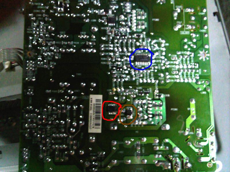

              OK, things are about to get difficult. First, the little lecture on inverters. The usual design has a dedicated controller. That is probably the IC circled in blue in the attached picture. I also circled a less likely candidate in red. I'd like the part numbers of those. While we're doing colors, what is the component circled in brown?
              The controller gets two signals from the logic card - on / off and brightness. The controller provides control signals to the transformer drivers and monitors the output voltage of the transformer and current through each CCFL. The usual sequence at start up is to drive the CCFLs at maximum power for a few seconds, then start monitoring voltage and current. If any of these are too high or too low, the controller shuts down the transformer drivers.
              The first step is going to be to identify the controller and look up the application notes. Hopefully that will have a schematic. From there we may be able to figure out WHY it is shutting down. By the way, one typical reason is a shorted transformer.
              An alternative is to use the inverters from a couple of backlight kits to replace the regular inverter. I'm not too wild about that approach. For one thing, you loose the ability to adjust brightness.

                here are the values you requested
                problem by using the inverters from backlight kits you have to drive them from 12v source and i will be needing two of them if that happens, right?

                    OK, the BA9741F is the controller. The 9435Ps drive the transformers.
                    12 volts should be no problem - typically the power supply provides 12 volts for the inverter section. If you look at the board carefully you should be able to locate the inverter power - suggestion - look at the two purple caps. Odds arer they are there to decouple the inverter power.
                    You misunderstand - a transformer may have a single shorted turn. That would be enough to reduce the voltage output.

                      ok sir so BA9741F is controller and 9435P drives the transformer, what should i do next?

                          Not at this time. What exactly have you done to test the inverter? Have you hooked up known good CCFLs to it and verified they all work and are equally bright? SOMETHING is causing the controller to shut down. It could be a shorted turn in a transformer, a bad CCFL, or a bad component in the protection circuitry. It could be anything as simple as a cracked solder joint.
                          With a scope and a schematic, I could narrow it down within a few minutes. Without a schematic, it becomes more difficult. By remote control, it's nearly impossible.

                                Hello Kharr
                                Suggestion if I may
                                As this PCB does not seem to have any Inverter fuse it is possible for your B/lights to come on for the couple of seconds with a failed transistor and then shut down (one side fails and the other side works,)
                                Check the 4 transistor right of the 2 inverter transformers, they are above and below the 2 big blue ceramic caps (possibly C5707s or 6s)
                                Check with Diode test on DMM (in circuit) but first check there solder connections
                                B C E may be silkscreened on board, lets call that Pins 1 2 3 (to make it easier)
                                Top pair first
                                place the red on 1 and the black on 2 and take reading, do the same on 1 and 3
                                Then do the same to the other one of that pair, the readings should be the same
                                Bottom pair next
                                Do exactly the same as above pair, again this pair should read the the same
                                Compare the top reading pair to the bottom reading pair, if they are near enough the same then they are OK
                                If one pair reads a lot lower then there is a bad transistor in that pair
                                Or remove all 4 off board and check for shorts between pins = 1+2 1+3 2+3
                                And take diode readings on 1+2 1+3 (red on 1 pin) all 4 should read about the same as each other
                                Hope you can make sense of all that
                                      @plainbill
                                      done testing all bulbs with cfl mod kit all ok
                                      here is the schematic you are requesting this is the service manual for lm729 but the inverter board for this model is exactly the same with lm725
                                      download link
                                      @bobdee
                                      alright boss done removing the four transistor
                                      tested pins = 1+2 1+3 2+3
                                      the three transistors same no reading nbut the forth one has a short on pin 1 + 3 do i have to replace it?
                                      the transistor label is C5706 and 5g below, will try to check our local seller if they have this one
