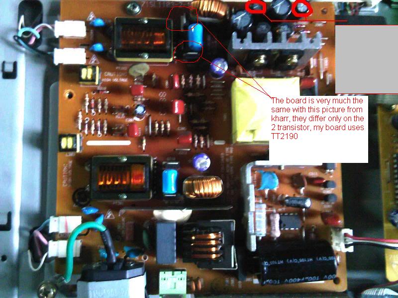

                                  hi... this is my first post, I search the internet about this problem and i landed in this forum... my problem is very similar with kharr, and followed all the instruction that mentioned here. in my case the other 2 transistors (TT2190) got the short. I search for datasheet of this two transistors and also the c5706 for possible replacement, i am wondering if i can replace the TT2190 with ordinary NPN with same characteristic of c5706 or replace it with c5706. This is what I'm thinking in case i cant find the TT2190.
                                    #37
                                    Re: AOC LM725 screen goes blank
                                    @benja1475
                                    Please post good clear pictures of your monitor's boards. using attachment function.
                                    Are the TT2190 used for the inverter transformer drivers. I look at the spec of the TT2190 are nothing close to 2SC5706/5707 at all.
                                      http://www.ebay.com/itm/250662312235

                                        You should also check the tuning caps value and leakage resistance in the inverter output circuits, otherwise you may may blow up your new transistors.

                                          guys thank you for the quick response on my query, I thought this thread is dead because its been 3 year since the last post dated... , about the picture of the board I will post it later, i need to borrow some high pixel cam to do the shot, but the board is very much the same with the picture from kharr in this thread.... about the datasheet from budm, Im confuse why the other 2 transistor is different type from c5706. on my observation they do the same task with c5706... Im sure they are used for the inverter transformer drivers. I do already tried replacing it with ordinary NPN transistor with same characteristic of c5706 because our local electronic store don't have any available TT2190 transistor... but still the same problem.
