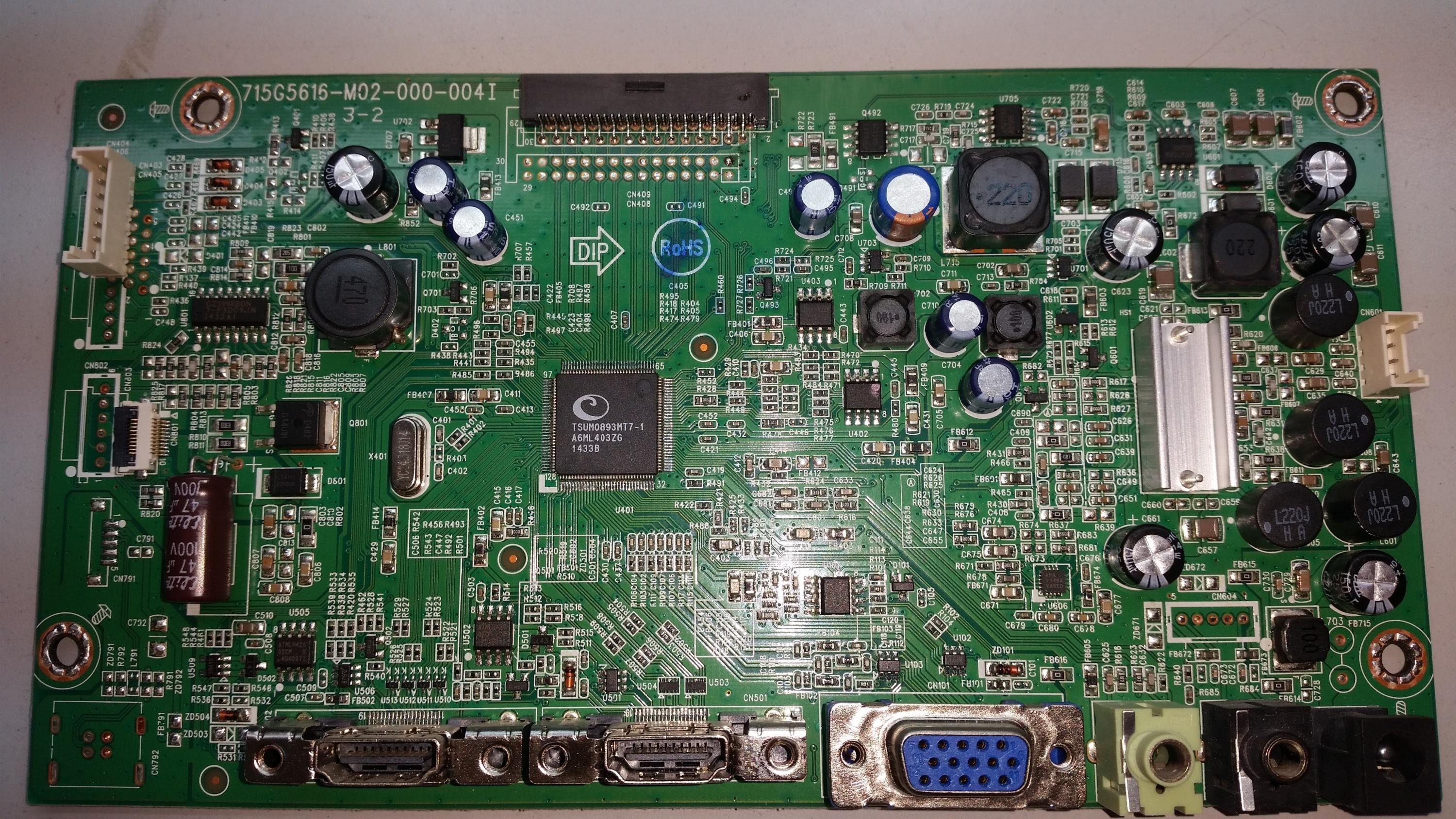

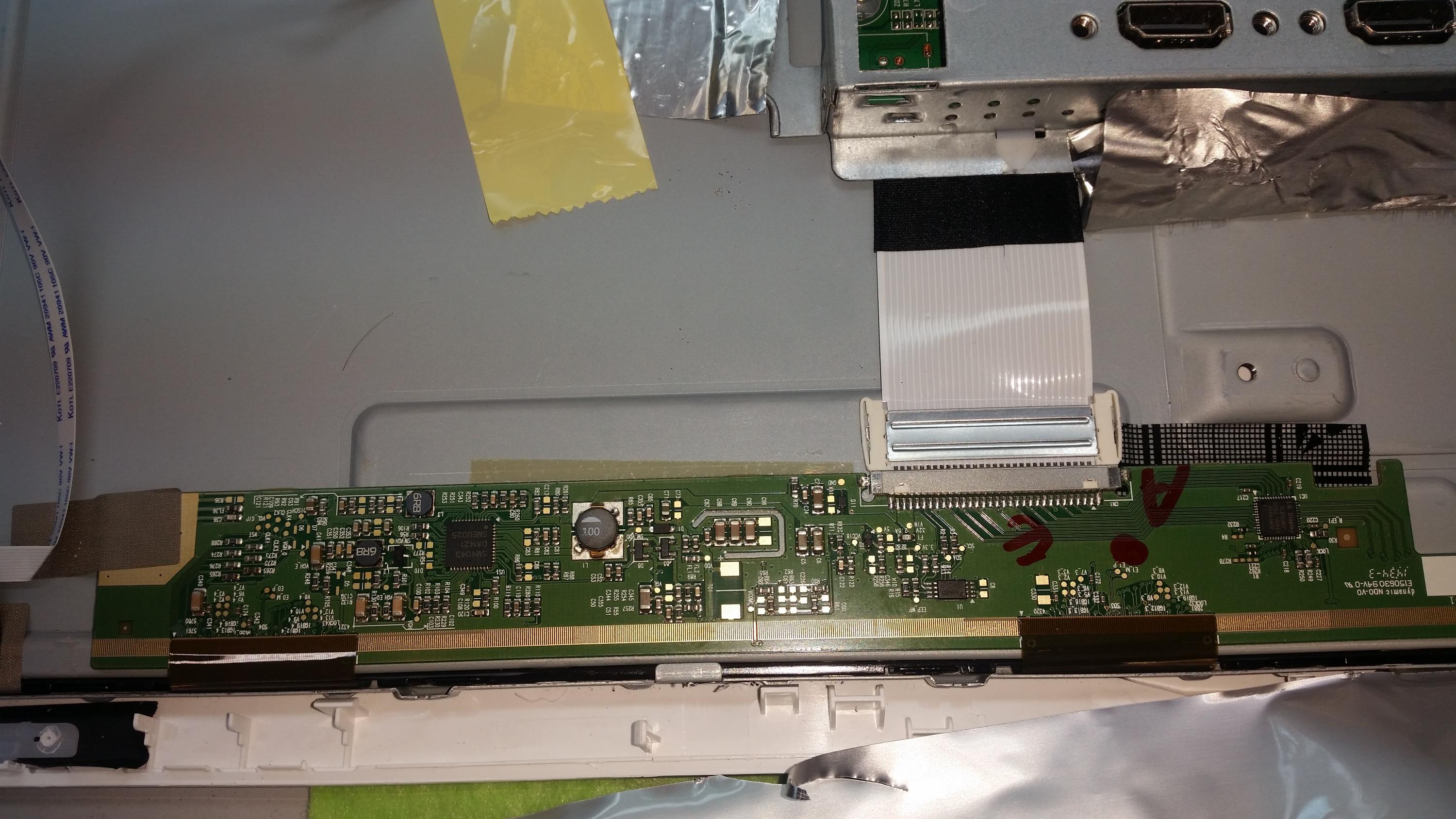

      The main circuit board (which I guess also has a power supply integrated on it) is making a funny buzzing noise when the monitor tries to power up
      sort of bzz-bzz-bzz-bzzz.......................bzz-bzz-bzz-bzzz.............
      I disconnected the ribbon to the backlight but that made no difference
      When i disconnect the LVDS cable the problem goes away and the monitor draws a 80mA milliamps. If I then reconnect the back lights it's drawing a steady 0.65A
      So it is acting like there is a short on the Panel PCB. But I can't see an obvious short. I checked across all the larger capacitors, and from what look like buck regulator coils to ground. No shorts there.

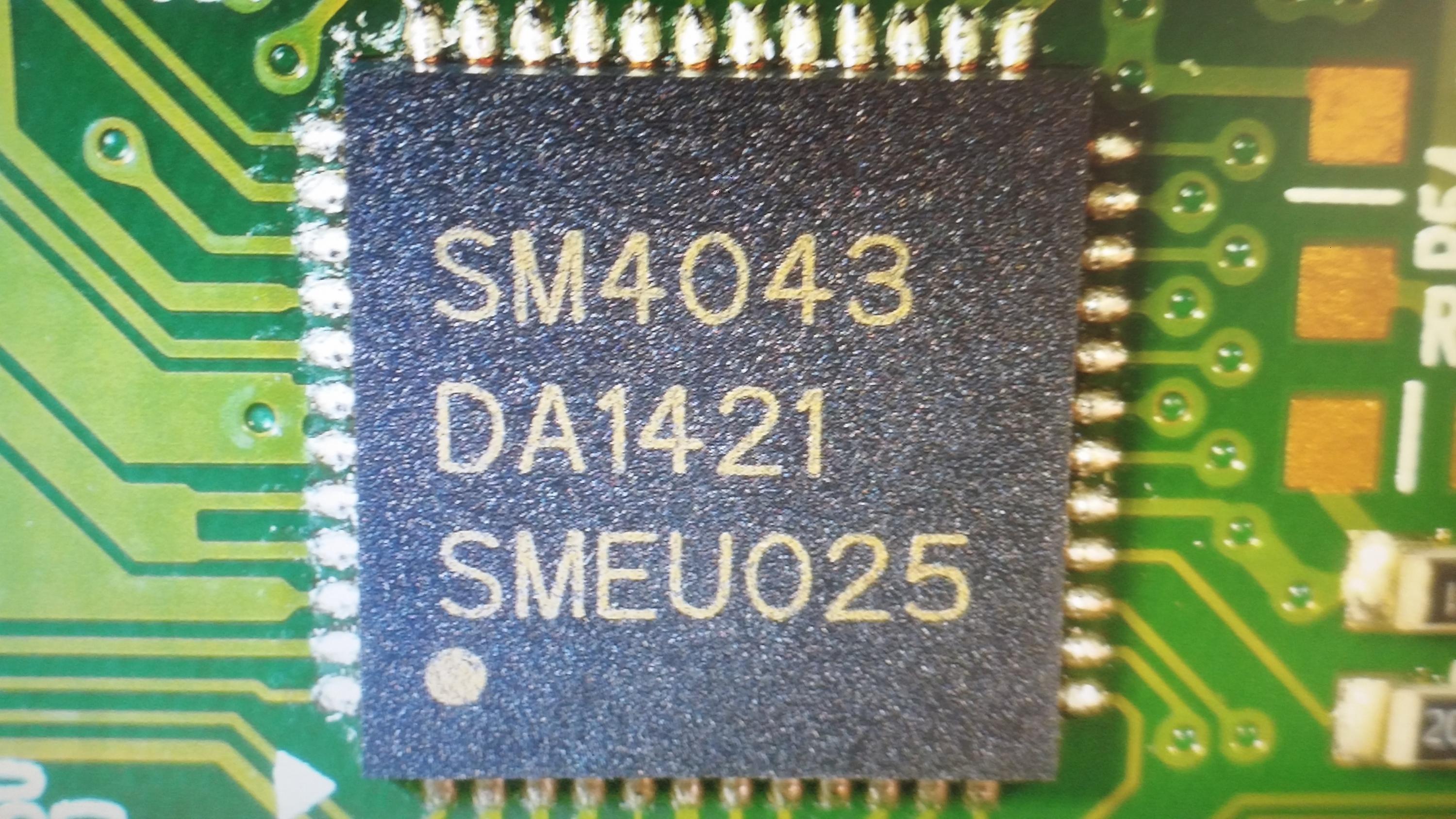

      I have what I assume is a Voltage regulator IC, SM4043 but I can't find a datasheet. I can see on my scope the buck regulator(s) are trying to start up when I get those buzzing noises, but can't.
      Definitely a datasheet for SM4043 would help. Then I could try power the panel PCB from my bench PSU.

          From another service manual it has this description but no schematic:
          SM4043, SILICON MITUS, MNT, VDD
          BOOST + VGH BOOST + VGL C/P +
          VCC BUCK + L/S + OPAMP +
          DISCHARGING + GPM + PVCOM, QFN,
          R/TP, 48
          The manufacturer seems to be Silicon Mitus. I found a datasheet for a SM4028 but it does not have a pinout, so It might be difficult to find one for the SM4043, it might be custom?

            Yes this is being rather elusive. Aliexpress have a number of vendors who have SM4043. None I have seen link to a datasheet
            I think i will have to apply the 5V and 3.3V from bench PSU to the panel edge PCB and see if the the SM4043 runs. Then I can see what sort of current it draws if it does. As I said I can't find any shorts on the panel PCB. I also tested for shorts from all the test points on the panel PCB to ground.
            Is it possible to have a screen panel that basically acts like a short circuit load when under power but shows nothing obvious on a multimeter?
            Maybe the problem is with the regulator on the main board which converts the input 19V to 5V/3V for the Panel PCB, if I can determine the SM4034 works with a bench supply, I can look their instead.

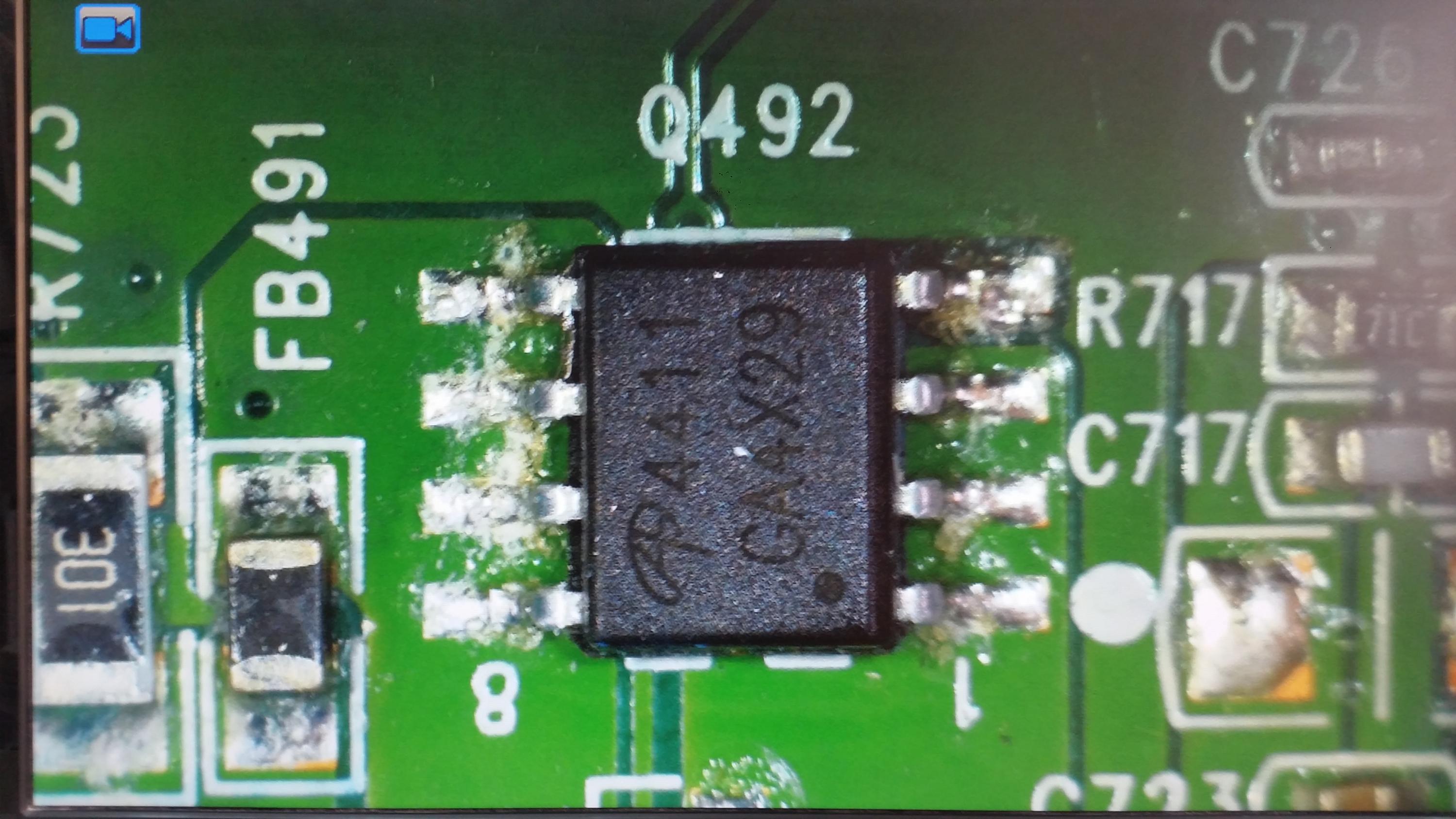

                    Looking at the main board, 5V originates directly from what I assume is a FET marked GA4X29, pins 5,6,7,8 (Q492). This had some horrible looking corrosion around it so I cleaned that off but it makes no difference.
                    Assuming GA4X29 is a FET then It is not clear where the gate of the FET (pin 4) goes but pins 1,2,3 (source? Drain?) seems to be connected to pin 5 of the nearby APW7089 step down converter (U705). and the largish inductor marked .220.
                    That does not seem to make a lot of sense looking at the typical application circuit on page 2 of the datasheet https://pdf1.alldatasheet.com/datash...C/APW7089.html
                    It would also seem that the 5V line should be able to output more than a few mA but it is not obvious what is wrong with it.
                    Why did you say it could be dangerous to drive the 5V input on the panel edge PCB directly?

                      Actually come to think about it, Q492 is probably just acting as DC switch to feed the 5V rail to the panel edge PCB, controlled by the microprocessor, so it's not connected to U705 pin 5 directly but via the inductor.
                      I need to check that is switching on properly, but that would not explain the chirping sounds

                        Q492 is a AO4411 fet. I would think the +5volt line should supply a at least 1 amp and likely more like 2~3 amps
                        If there was corrosion on Q492, I suspect there is corrosion elsewhere and maybe a corroded trace or feedthru.
                        What does'nt make sense about the U705 circuit? Pin 5 (LX) is the output which connects to a coil and then to Q492 fet, Q492 is likely a switch that turns off part of the circuit during standby.
                        What about the input voltage to U705, does it com straight from the 19v input? Check the resistors around the ic, maybe they are corroded as well and changed value

                          It looks like there is still some corrosion on U402 & U403, Check that you have voltage on U705 enable pin
                          While load testing the 5 volt line, did the voltage drop on both sides of Q492?

                                  You said if you disconnected the flat white cable between the t-con board and the main board and the buzzing noise stoped, Did the backlights come on? they should have. There are a lot of components on that t-con board so something could be bad, but there is a 2.5 amp fuse (F1) on that board, I would think if the fault was on that board the fuse would have blown. I suspect you have a problem with the +5 volts not being able to supply any current.

                                    So it is acting like there is a short on the panel edge PCB but I just cant find one on my meter (checking Caps and test points to ground - again!)
                                    I can see that when I get a burst of the chirping sound, I get 3.3V on the panel edge PCB. This seems to be generated on the edge PCB because the 3.3V test point does not connect directly to the LVDS ribbon.
                                    I also get 4.7V on the larger inductor L1 for a few seconds
                                    As for the two smaller inductors near the SM4043 (L2,L3), L3 goes to about 1.5V and I can see the other one goes to 7V or more sometimes, but can go to 3.4V or less - it varies each time, maybe depending on the length of the burst
                                    With my scope I can see a similar thing with each inductor getting a burst of high frequency drive. This suggests the SM4043 is at least trying to drive all the buck inductors.

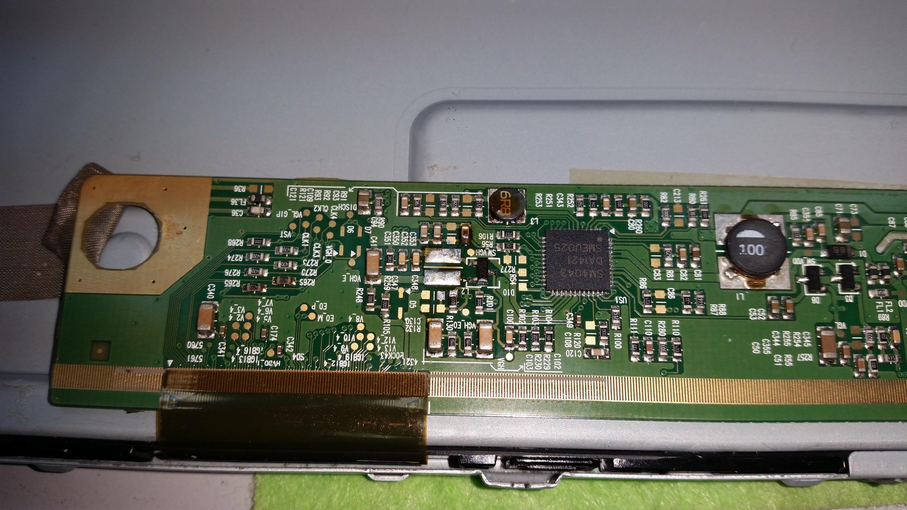

                                      I took a guess that the supply generated by L2 has a problem, so I unsoldered L2.
                                      I was right. With the LVDS cable attached I now get backlights, I have 5V on L1 and 1.8V on L3, and no more chirping.
                                      L2 has 12V on one pad and 0V on the other. The pad with 12V connects to one end of R86 and pin 40 of SM4043. The 0V pad reads open circuit to ground on both ohm and diode test mode (positive meter lead to pad). It reads like a diode junction with negative lead to pad.
                                      So I've narrowed down the problem but I still can't find the fault. A datasheet for SM4043 would be really useful at this point.
                                      Any suggestions? I could apply some voltage to the load pad of L2 I guess...

                                        Whats the panel make and model, sometimes you can find some information that way. Or contact the chip maker
                                        That circuit seems to be the VGH boost converter so it likely boosts the voltage to around +15 ~ +20 volts
                                        Did you check the caps around the +12v boost circuit, The panel is supplied with +5 volts so the +12v must be from a boost converter somewhere
