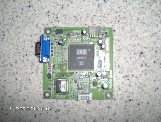

    So I got all four of these and they have a couple of different problems.
    One dosen't even power on, or do anything when plugged in. One turns on the power light, dosen't blink, and two that blink the power button like they should, but when they do the screen lights up for a second, then turns off.
