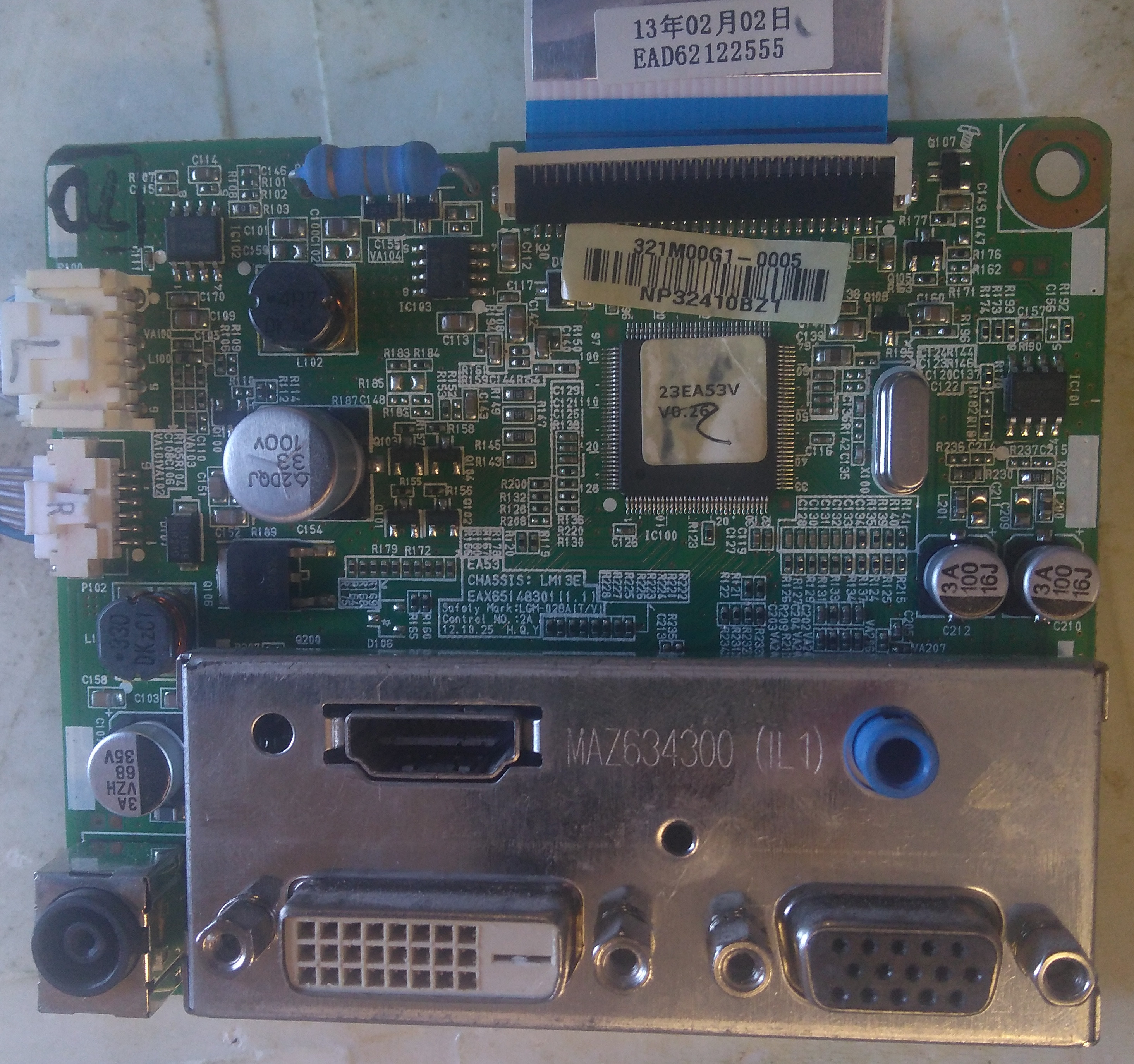

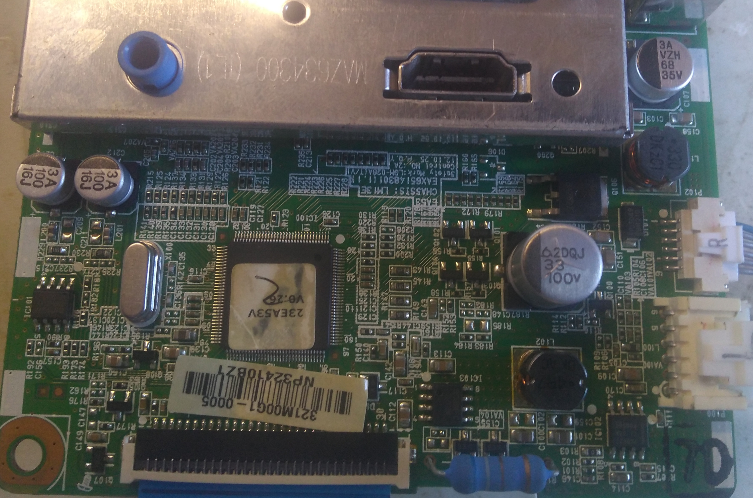

    Hello people,
    When I turn the monitor on I can see the image for a second, then the screen becomes all black.
    If I let it sit there and wait about 5 minutes, then I turn it off and back on again, it works normally.
    But there's a hissing sound all the time, very high pitched sound.
    I've been using this monitor for about 5 years.
    Due to all these signs I think this is a bad capacitor.
    I attach pictures of the PCB with the capacitors so you can judge and advice me what to do. Does any capacitor look bulged? Only (and slightly) the 100v 33uF one.
    Any help will be appreciated!
    All the capacitors I've been able to identify:
    1:
    2DQJ
    33
    100
    2:
    3A
    VZH
    68
    35V
    3,4:
    3A
    100
    16J

    I am in agree with you that the capacitor of 100v is slighly bulged. But remember that often capacitors could be bad with no visible evidence (bad capacitance or ESR).
    • R_J
      • Jun 2012
      • 9607
      Re: LG 23EA53 black screen after one second, it works after 5 minutes, high pitched s
      The 33µf 100v, is the main filter for the led string voltage. It is likely bad, those little caps don't have much inside to make much of a bulge

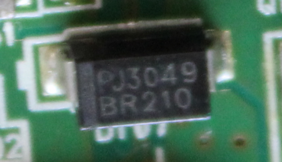

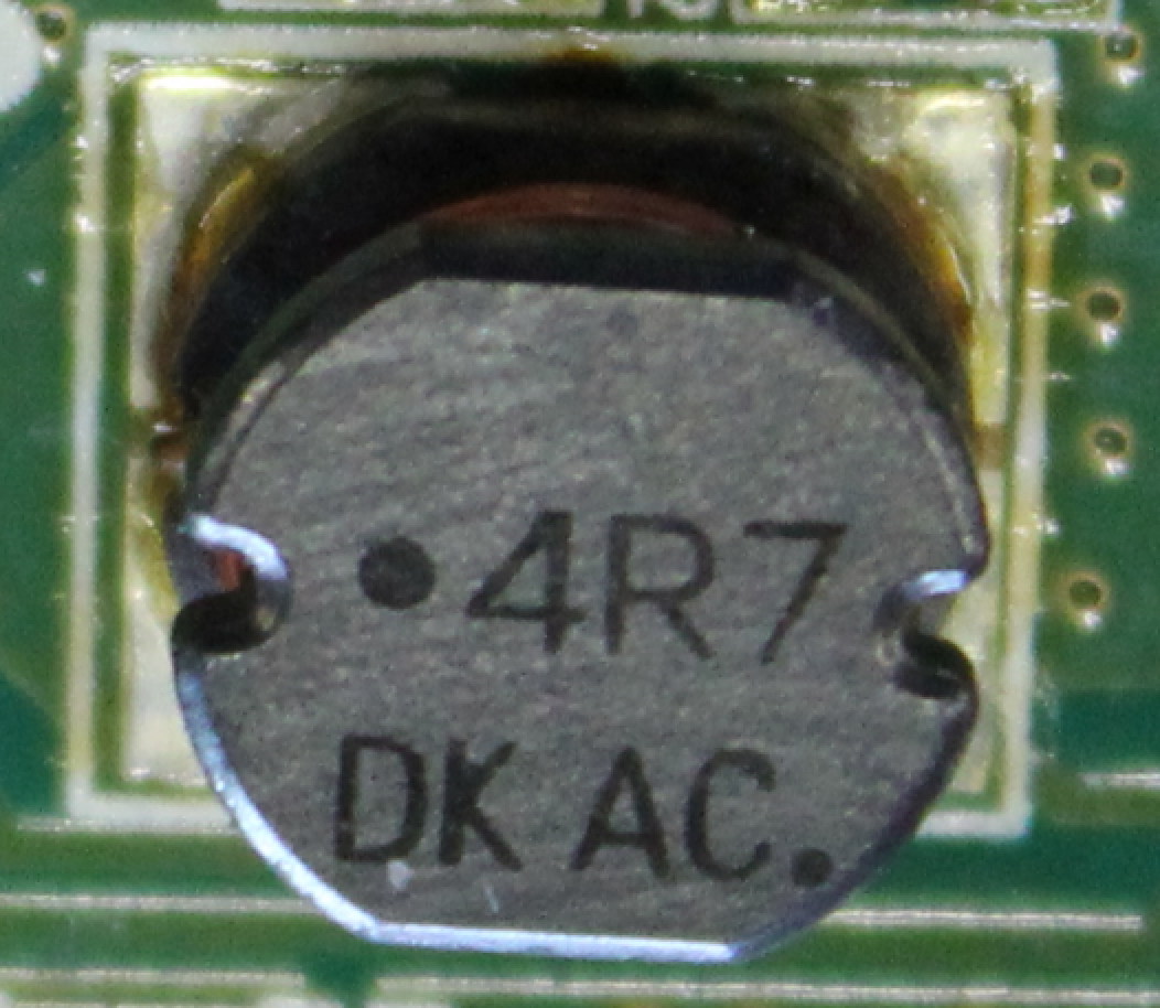

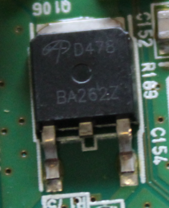

        I attach high res pictures of the components.

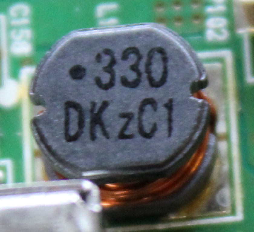

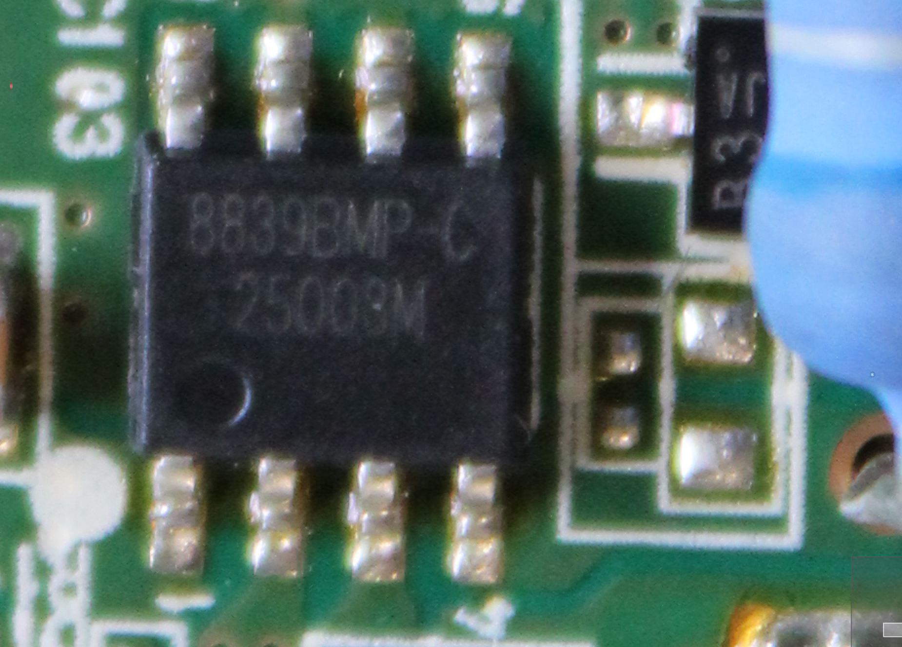

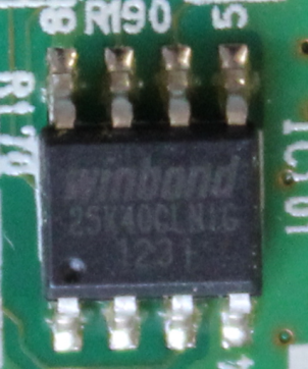

        I managed to identify some of them:
        8839BMP-C
        25008M
        https://cdn.badcaps-static.com/pdfs/...06d1e02bd3.pdf
        https://cdn.badcaps-static.com/pdfs/...43855437b3.pdf
        VOLTAGE REGULATOR (PROBABLY)
        208022-TI-31A-P06564
        NO IDEA
        D478-BA262Z
        MOSFET
        W25X40CLSNIG - Flash ROM
        TROQ - 14.3H007
        CRISTAL
        4R7
        Signal transformer
        https://www.digikey.dk/product-detai...4R7-ND/2777571
        330
        DKzC1
        Probably signal transformer too.
        PJ3049
        BR210
        Rectifier diode
        Resistance
        Some unidentified fuse?
        I know very little about electronics, so please excuse my ignorance and any blatant error.
        Further information about how to diagnose the problem would be very welcome.
        Thank you for your help to get this monitor working again!

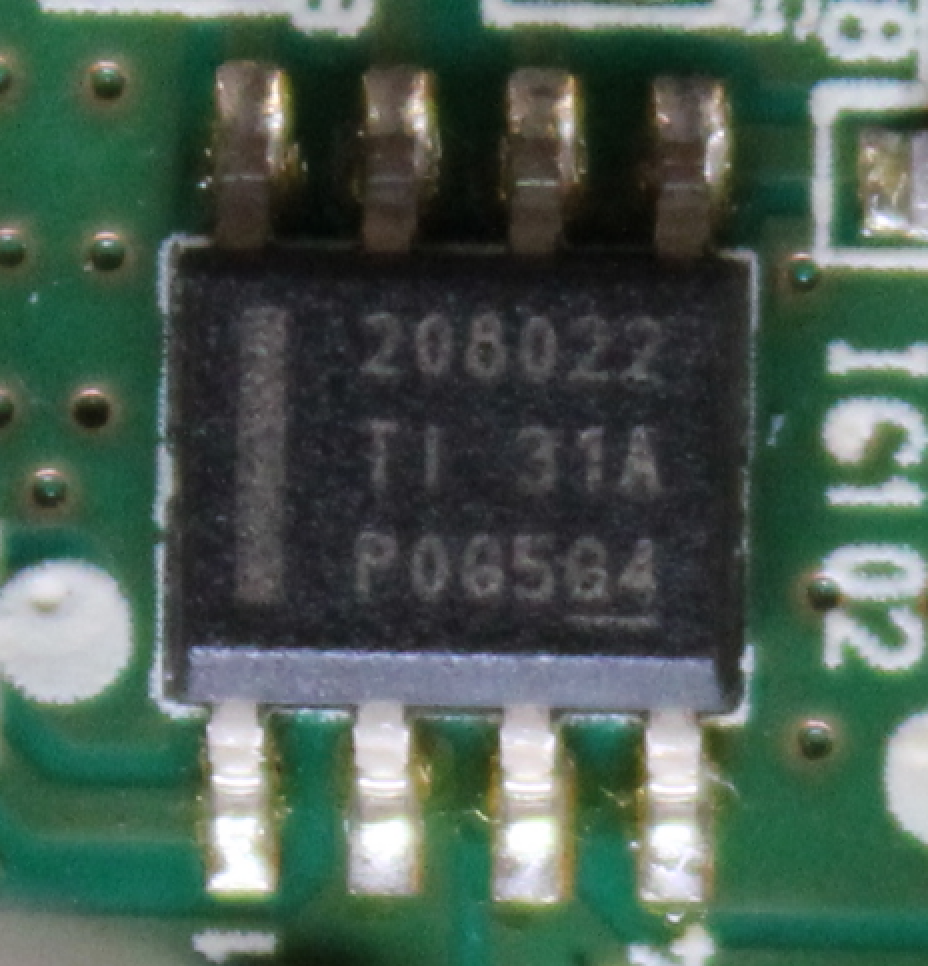

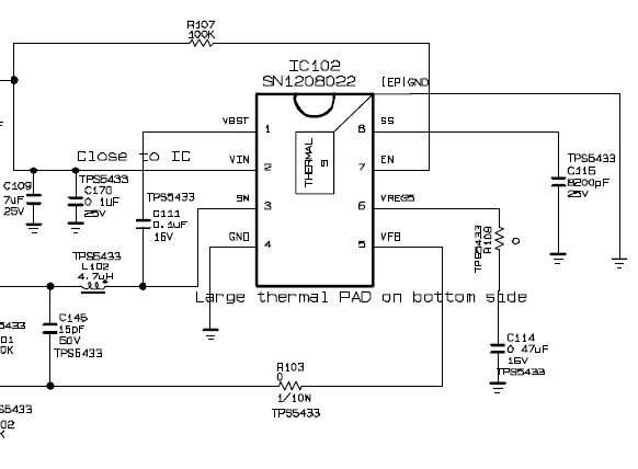

              HELLO everyone...need to know 208022-TI-31A-P06564
              NO IDEA what this is.if someone has the repair manual please contact,thank u!
                Originally posted by morfeas123
                hello everyone...need to know 208022-ti-31a-p06564
                no idea what this is.if someone has the repair manual please contact,thank u!
                ic102 - SN1208022 (sop-8).
                • morfeas123
                  • Jan 2021
                  • 5
                  • greece
                  oh thank you soooooo much.
                  • morfeas123
                    • Jan 2021
                    • 5
                    • greece
                    but unfortenanly i cant find the same.what are the specifications to find something that could do the same.sorry but im novice.just learning now.thanks again
                    • morfeas123
                      • Jan 2021
                      • 5
                      • greece
                      and in the service manual there is now replacemant parts list so i know what kind of ic this is to get something simular.
                      • morfeas123
                        • Jan 2021
                        • 5
                        • greece
                        so please if someone knows please help!
                        • lotas
                          • Jan 2016
                          • 4785
                          • Russia
                          On the forums they write what can be replaced with:
                          TPS54339E and on APW7302B.
