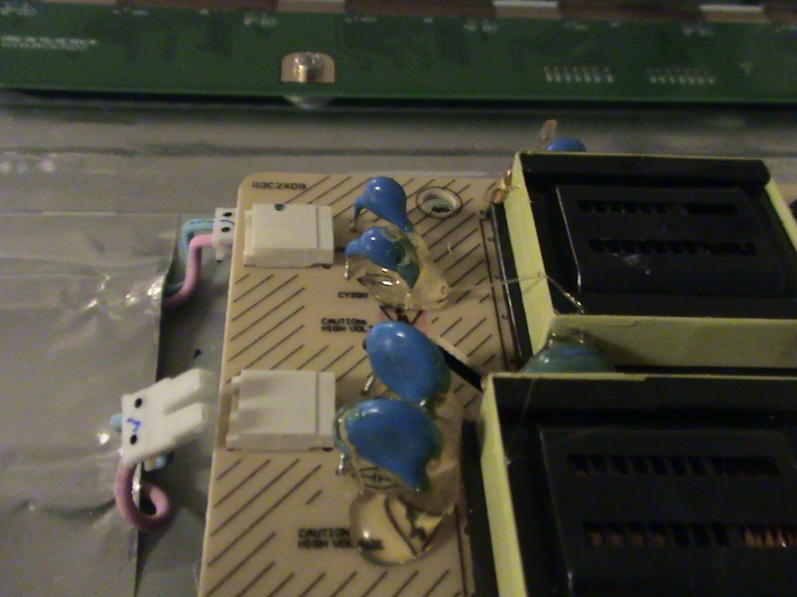

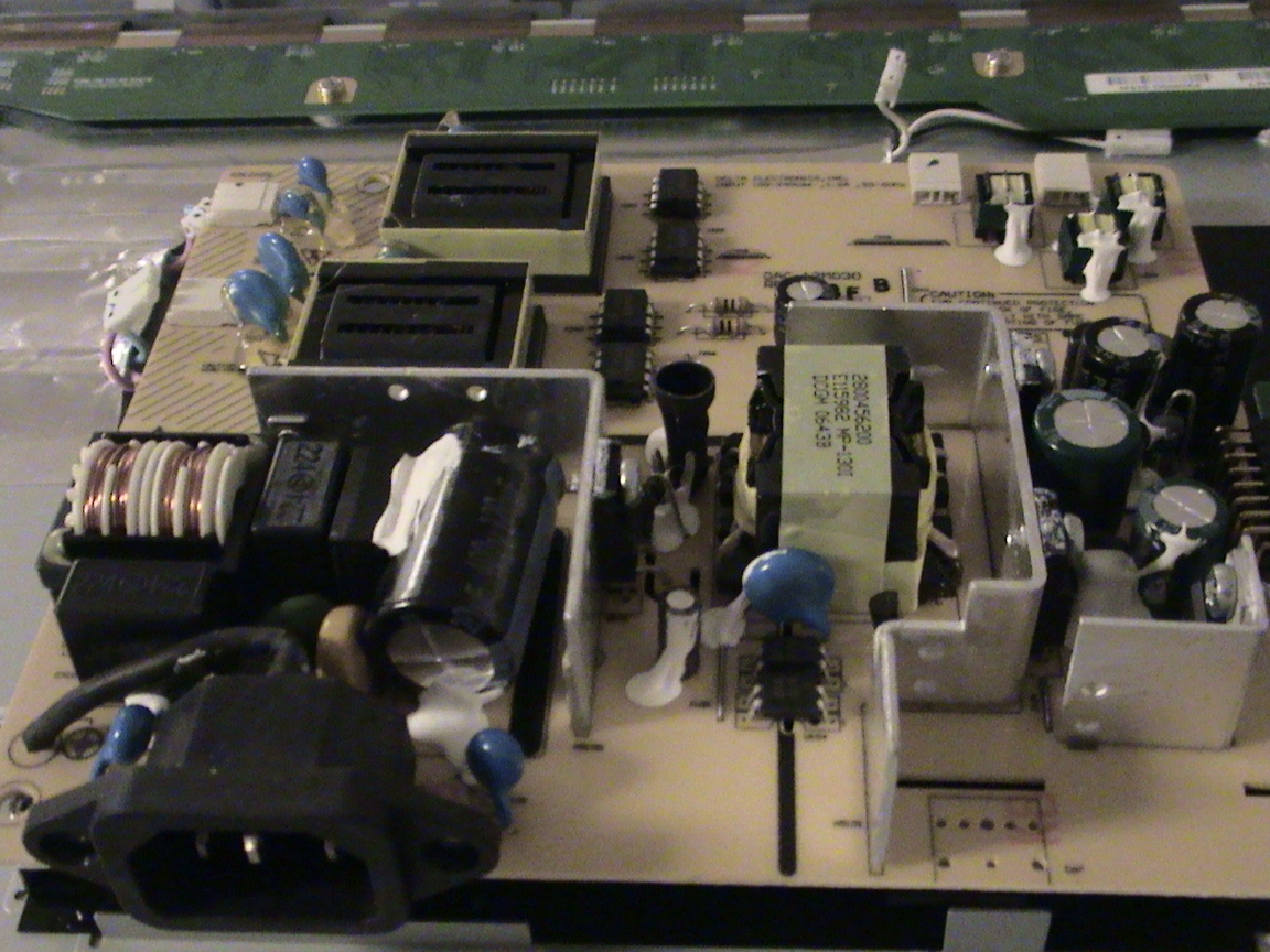

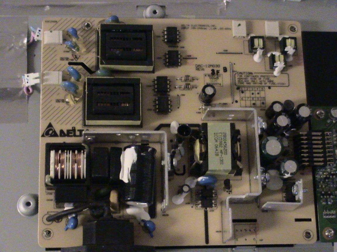

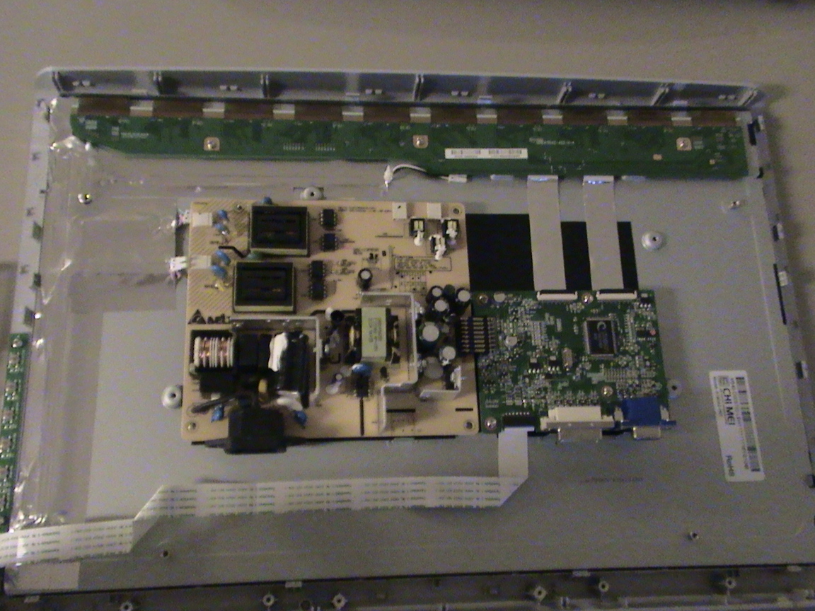

      ok here are the pictures. My question is on one of these photos i took had little flat blue capacitors on it. How do you know they are bad. I'm sorry i'm new at this but i love this kind of stuff.

        You need an ESR meter to test the capacitors. Let us know the brand of capacitors so we can maybe identify if they are a "known bad" series.

          The symptom you describe is typically called 'two seconds to black'. It indicates a problem with either the CCFLs or the inverter. Briefly, here is how the backlight system works.
          The monitor is turned on, the backlight controller drives the CCFLs at full power for several seconds, then checks for a number of possible fault conditions These may include voltage across the CCFL is too low or too high, current through the CCFL is too low or too high. If a fault condition exists, the controller shuts down the CCFLs.
          Possible problems include a bad CCFL, a broken CCFL, open or shorted transformer, or a problem with the current or voltage monitoring circuitry. In general, the first step towards troubleshooting the problem is to substitute known good CCFLs. The CCFLs used with case mod kits are often used for this.
          Yes, it is POSSIBLE the little blue caps are bad, but this is unlikely.

            xtraelectronics- ESR meter ok. the type of capacitors are CapXon and there are also 2 Taicon caps also. thank you for the meter info.

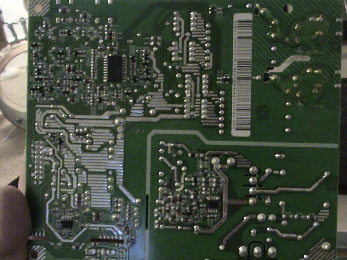

                            I have exactly the same monitor, and the same symptoms appeared about a year or two ago, it would go to standby all by itself while I was using it with no reason or change of signals from the computer. Then it got worse, it would not turn on sometimes, then it won't start up at all, I just get a green and orange led light.
                            I opened and checked for the usual things, cold solder, broken paths, fuses, resistors, all looked and measured fine....(I don't have a ESR meter so caps were not checked, but I'm sure they all shall be replaced, (two Capxon 1000/25, two 220/25, one 22/50, one Taicon 2200/10 and one 1000/10).
                            Power supply voltages are fine though, 12v and 5v are ok and fuses do not blow, actually what I think is that the main problem is not the power supply but the scaler chip on the data board, it used to overheat when the problem started, I installed a heat sink and worked for quite some time but then it died. (maybe due to dirty power from the caps)
                            Now if I touch some of the pins or surrounding components with bare fingers, I sometimes get power to the CCFL and a full screen white background with some random red vertical lines. (I know it's not recommended, but it was a desperate attempt to get some response from the circuit, and it worked!)
                            Since the chip is hard to find/replace (and I guess it's factory programmed for the corresponding timings and column/row matrix of the LVDS drivers, I guess my only solution is to replace the board. I already ordered it from DM and will keep you informed of the results. (I will also order the caps, unfortunately couldn't find them here so I'll have to look elsewhere for them.)

                                      I didn't see the model either, until Mitch's request for schematics, but I identified it through the pictures....
