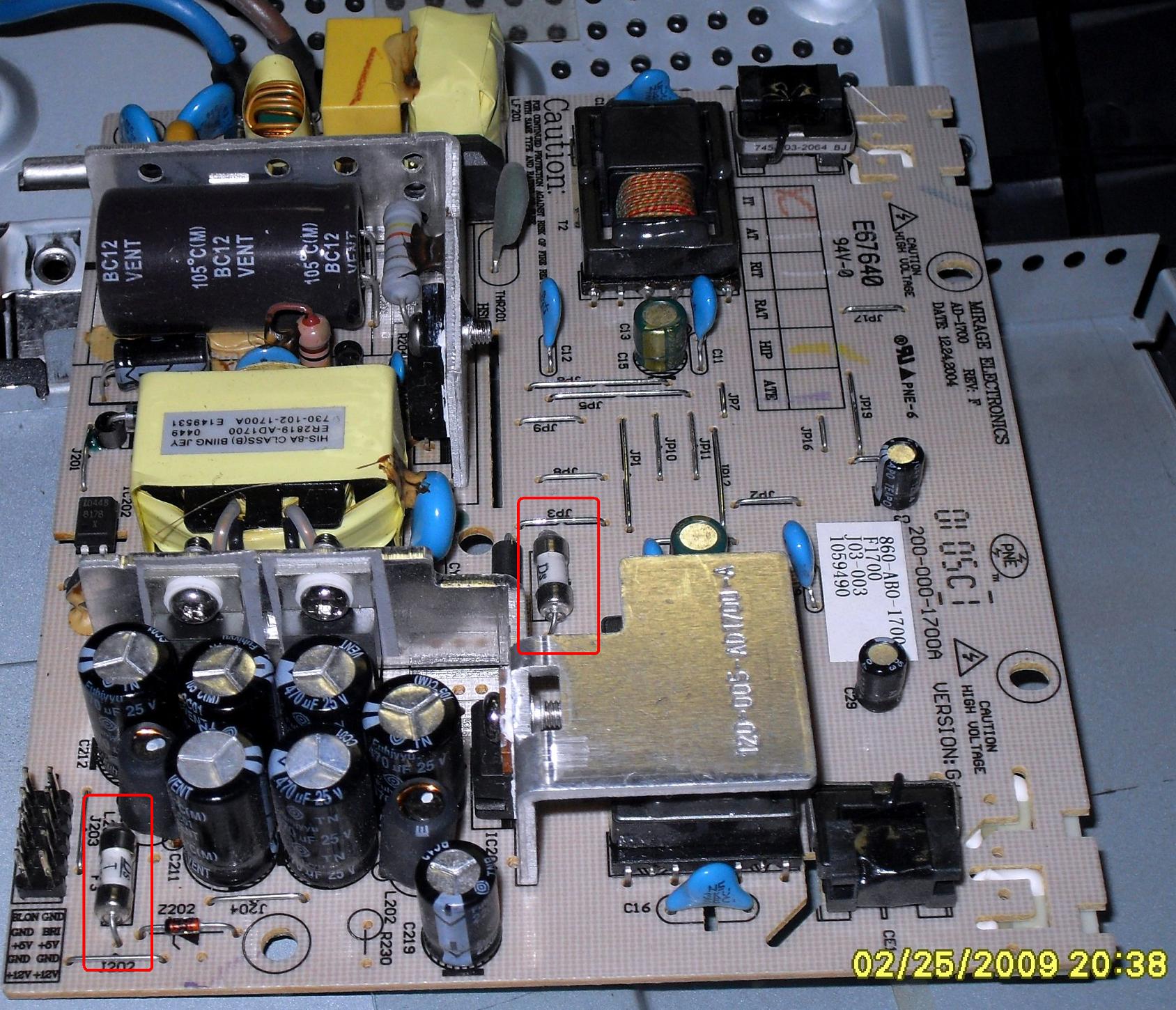

      Did you check the main fuse on the AC input? Or the other two that are present, one for the 5v output to VBoard and the other for the inverter?
      See the attached picture:
      If there's no 5V for the main logic board, the monitor would be dead.

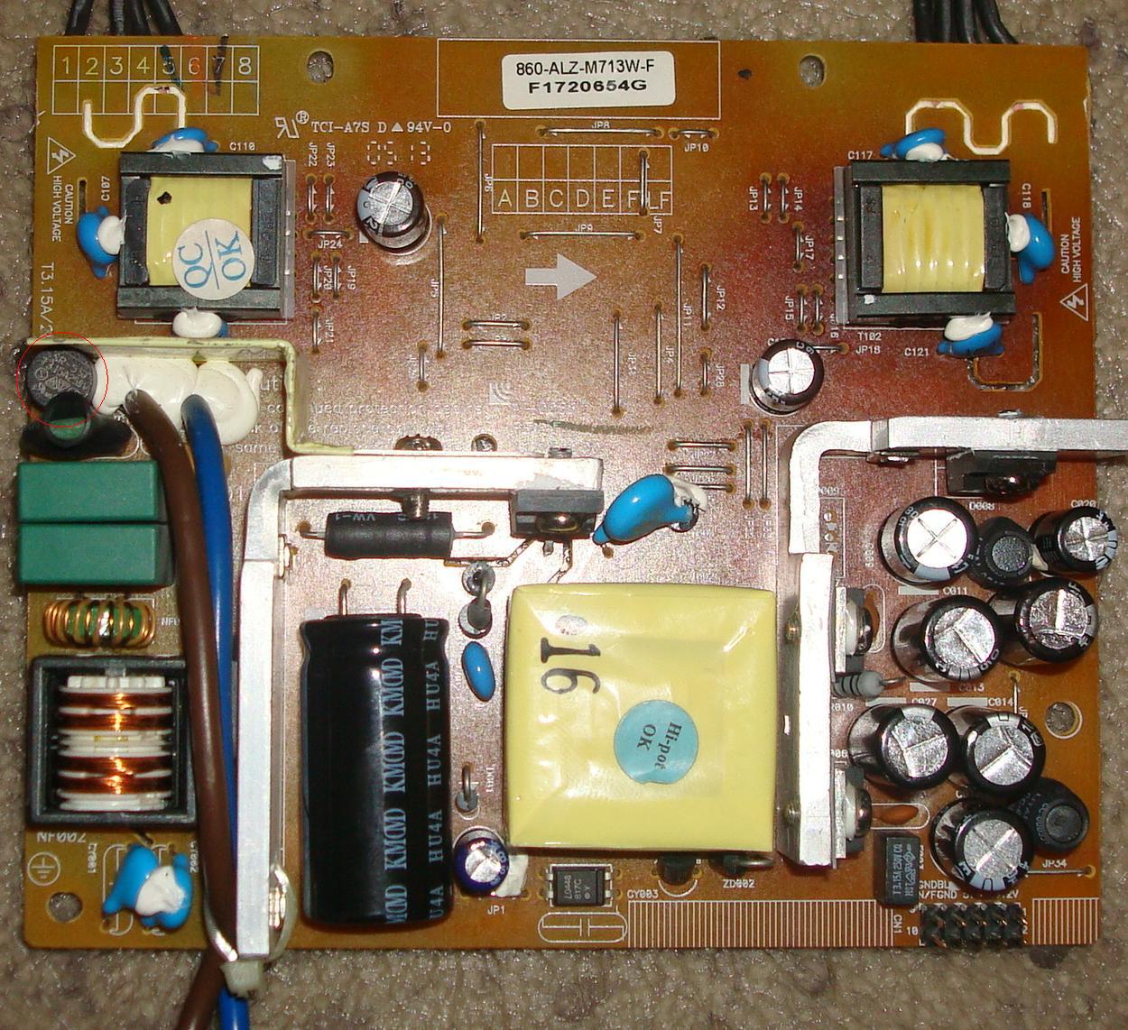

        Replaced all capacitors, checked main fuses, i have a different board then you posted but I did check some of the fuses and all the ones I tested passed fine, except the round one that is circled in the picture.
        Also: there seems to be no power going to the main board so a fuse sounds likely.

            That's what I suggested in post #3. No AC input = NO DC output
            That's the Main AC input fuse
