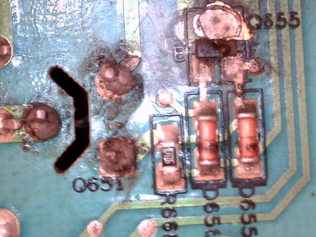

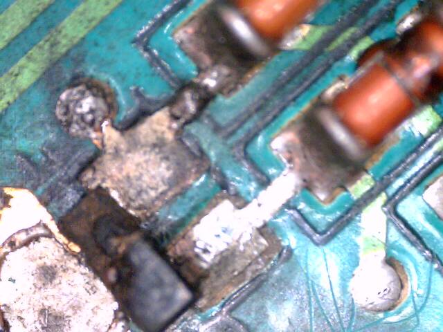

    Brought for repair a dead Hp2105 monitor.
    Found damaged : fuse F601 +cap C605 + Q651 +R670 +Q655
    Need monitor schematic or diagram of the Power supply card 4H.L1S02.A20 to help identify the burned Q655 fet.

      Are any part numbers visible of the part. Post a picture .

        Is this the main switching fet in the primary? It might be a 2SK3530-01MR
