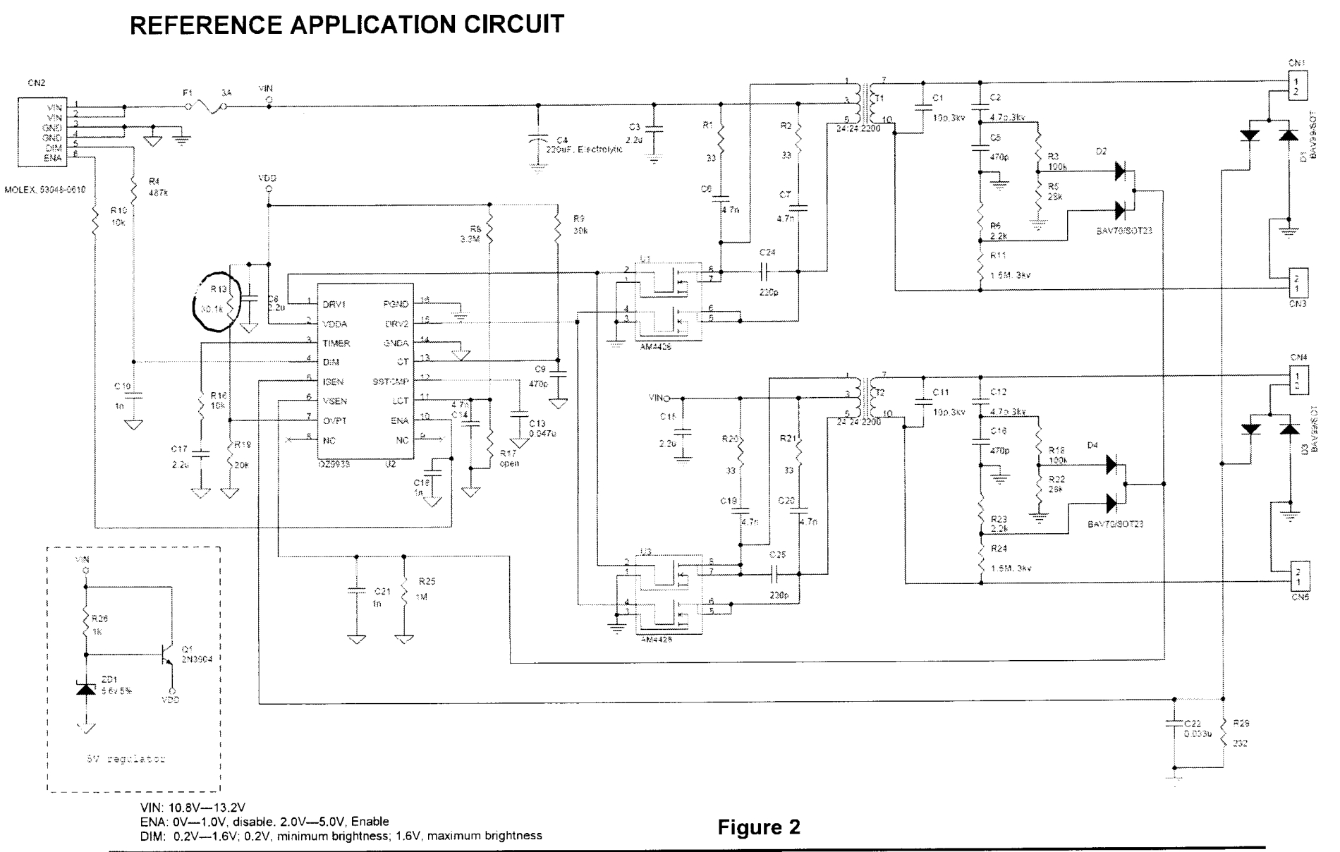

    Sorry, I did not bookmark the datasheet URL but I did print some of it.
    Had to shrink the jpeg a bit to get it attached here.
    pinout:
    1 + 15 inverter driver outputs
    2 - Vdd +5V
    3 - timer - RC constant for shutdown when problems detected
    4 - dim - usually external voltage 1-2v to set brightness
    5 - isen - current sensing on return side of ccfl tubes
    6 - vsens - proportional to inverter output
    7 - ovpt - overvoltage ref signal, somewhere arount 2.5v (AFAIK)
    8 - 9 - no connection
    10 - enable - below 1 v disables/resets controller
    11 - lct - select mode for dimming, analog here
    12 - sense problems with ccfl, voltage rise shuts it down
    13 - startup and 'strike' osc control
    14 - Vss
    16 - driver ground
    Schematic shows 20k/30k in the voltage divider for ovpt, but the samsung is using much higher values - I would not rely on the printed R and C values.
    I will try to relocate that URL.....
