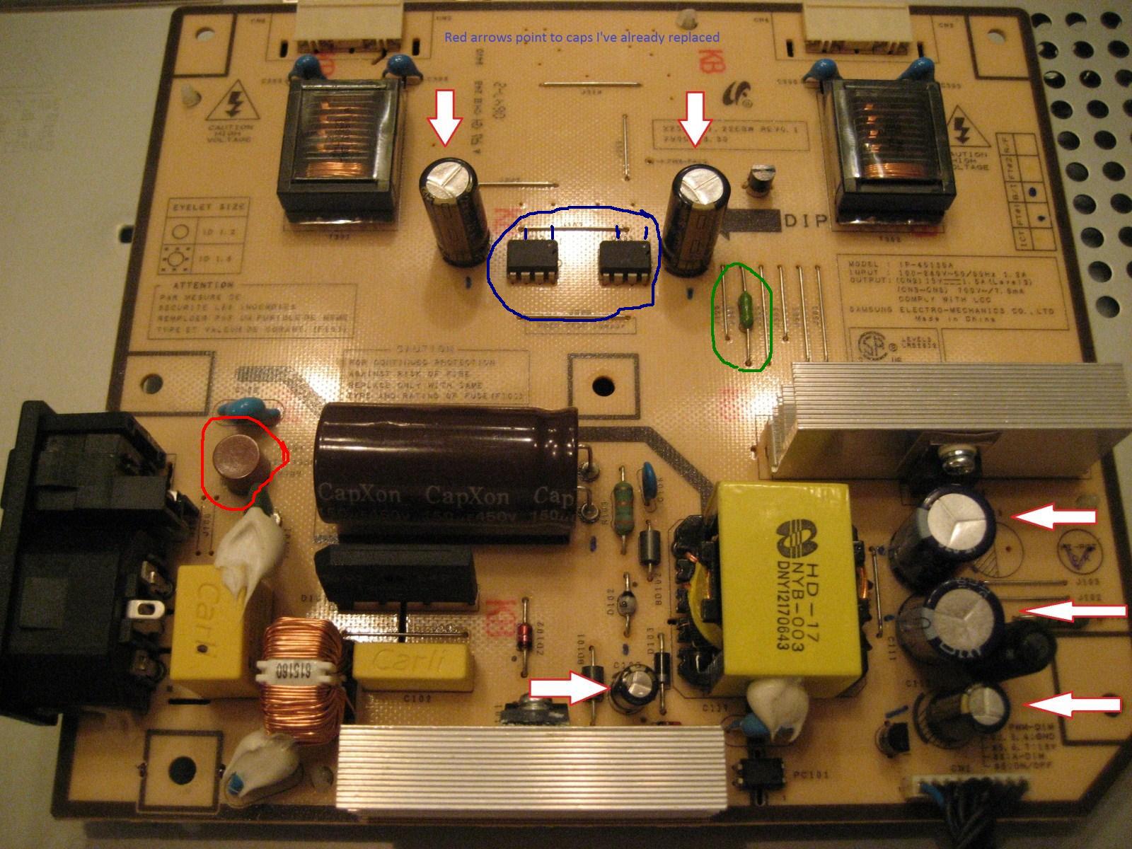

            • PlainBill
              • Feb 2009
              • 7034
              #86
              Re: Samsung Syncmaster 225BW
              Originally posted by jmer1975
              Sir is the inverter fuse is the one that has a value of 125v 3a? i test its continuity, at first it didn't beep, when i invert it it beeps then stops, i invert it again and its the same. do you think it's ok?
              but before i test the fuse i try to put a bright torch at the screen as you suggested, and yes there is an image on the screen.
              do you think its the CCFL or just the backlight? by the way the backlight doesn't light up, i think.
              how do i test and remove the backlight incase it is the one to replace?
              The inverter fuse is the one circled in green in the attached picture. The results you describe indicates the fuse is open. (The brief beep occurs as the caps charge). Check the drivers; if one of them is shorted it would cause the fuse to fail. The drivers are circled in blue. Check pin 1 to pin 3 (blue lines) on each of the drivers. If they show open replace the fuse with an equivalent (125V 3A) fuse.
              PlainBill

                • Bobdee
                  • Jun 2008
                  • 461
                  #88
                  good morning! (Philippine time)
                  can i use a 5A pico fuse replacement for 3A because its hard to look for it especially in my area.
                  an electronic shop owner told me that it can be replaced by a resistor but i don't know if that is true. if it is, what would be it's value?
                  Do not replace with 5 amp, that would be a fire hazard and if not fire a lot of damage to monitor if you have furure problems with monitor
                  You could try rigging up another sort of fuse in fuse holder such as small glass 3amp fast fuse and wire it in untill you can get a new one
                  • jmer1975
                    • Nov 2009
                    • 9
                    #89
                    it works! thank you very much Master Bob and Master Plainbill. you saved me from spending a lot of money by bringing this to a service center. and i will pass this knowledge i've learned to my friends who has the same problem as mine.
                    I am very thankful for you guys...GOD BLESS!!! MERRY CHRISTMAS!!!
                    -- "Master" is what we call to a person who shares knowledge to others

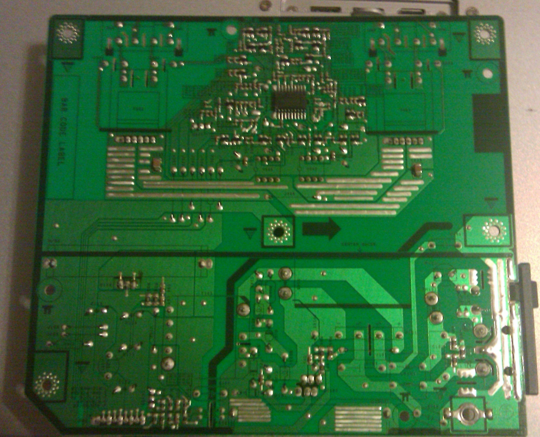

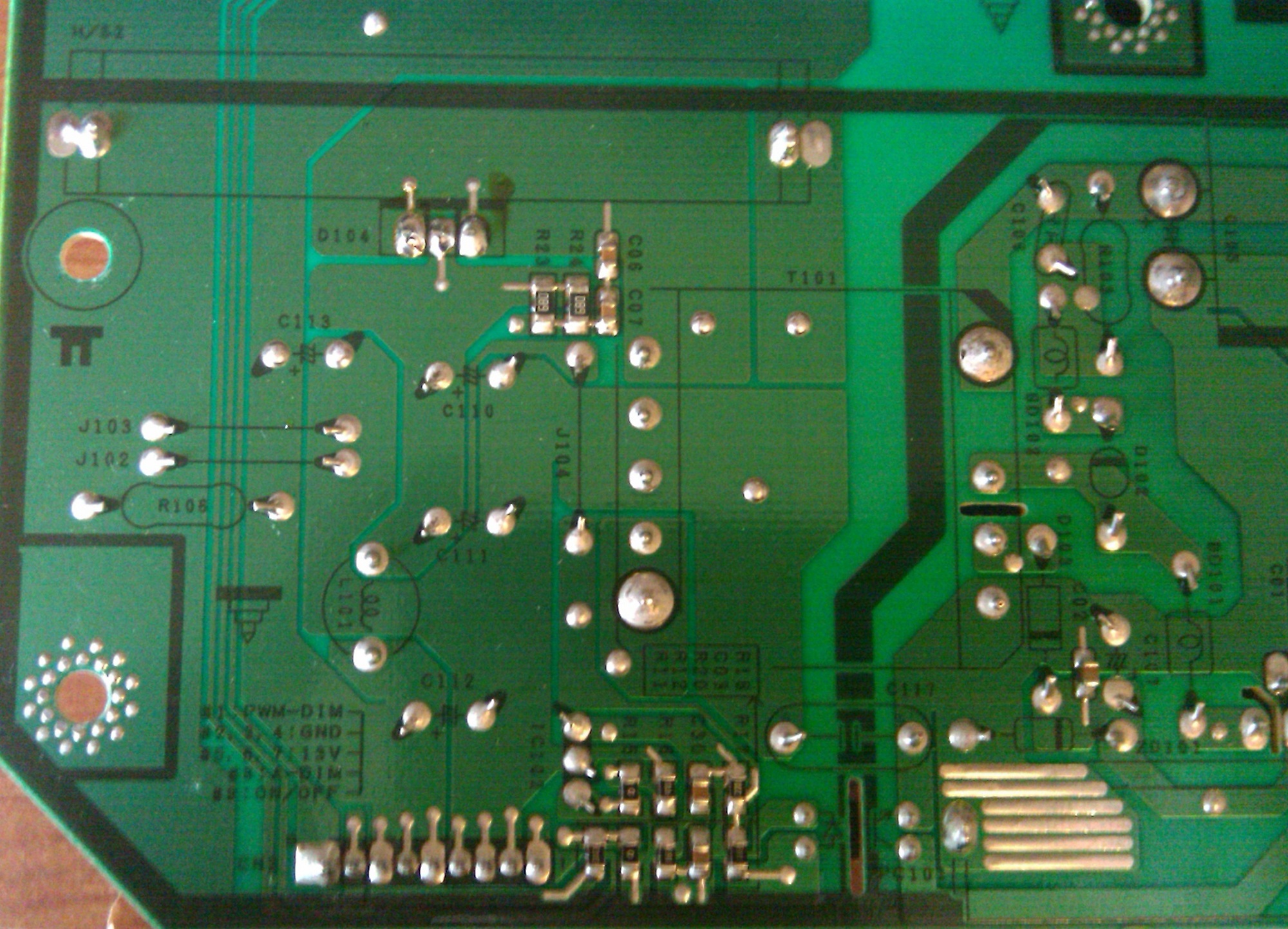

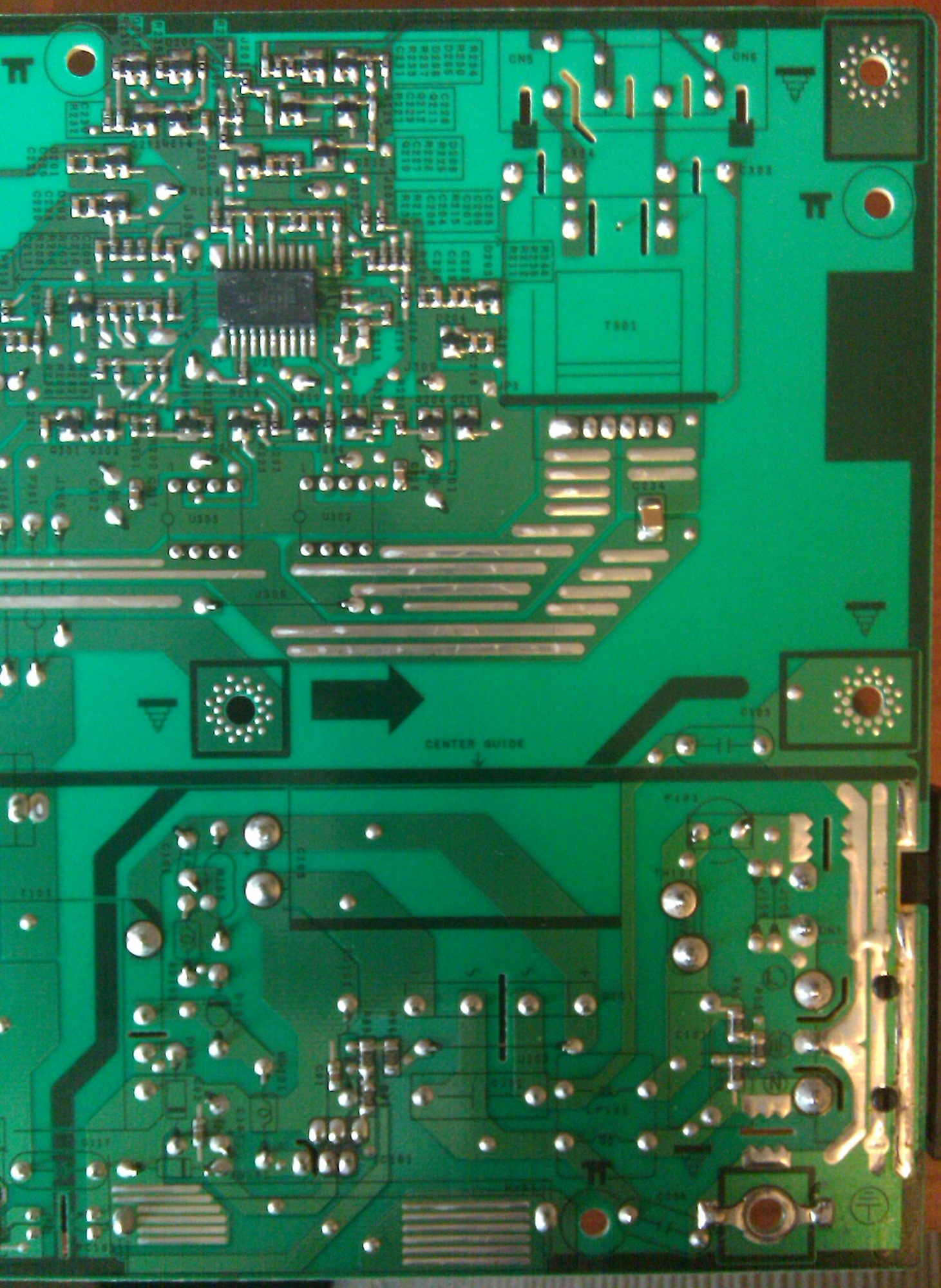

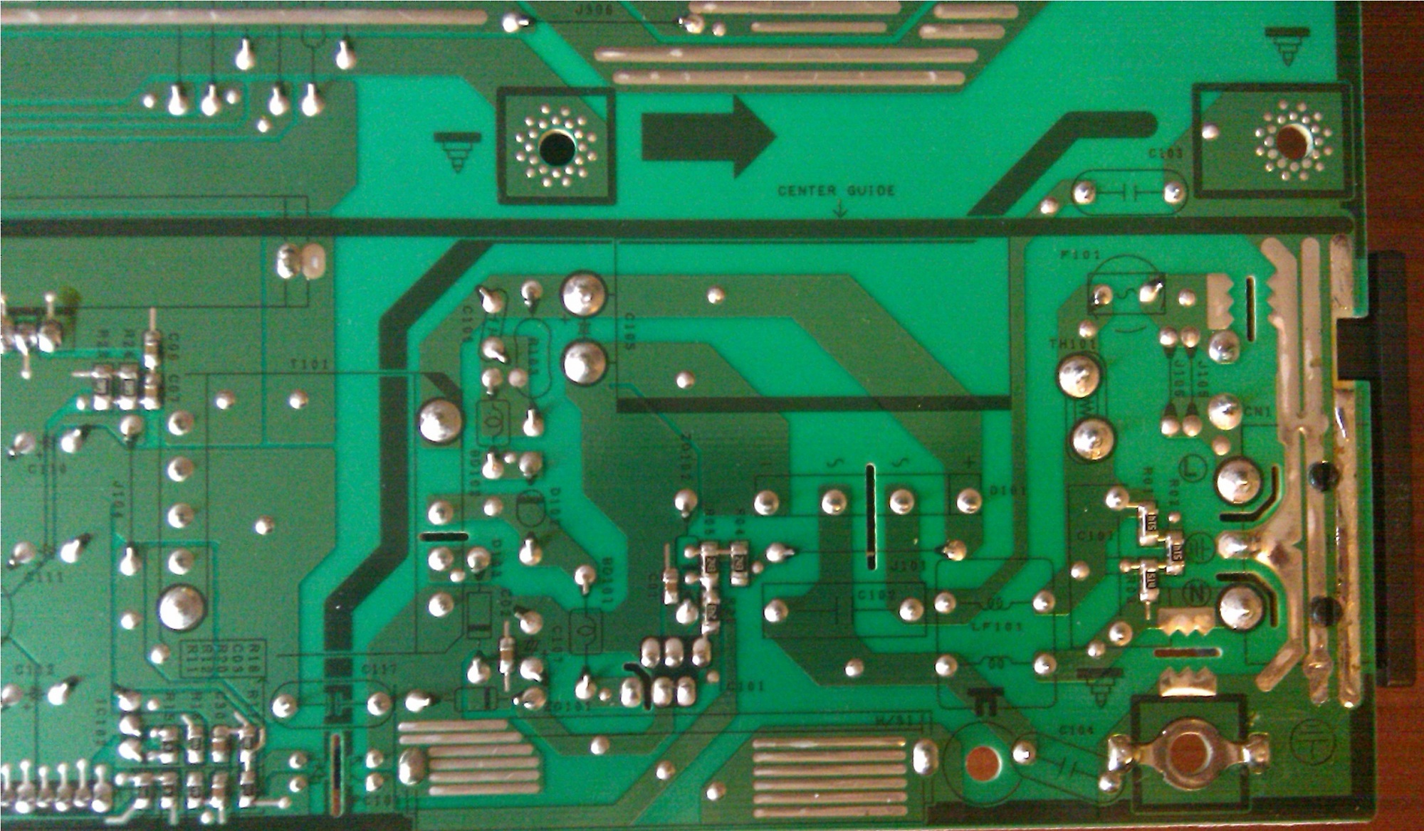

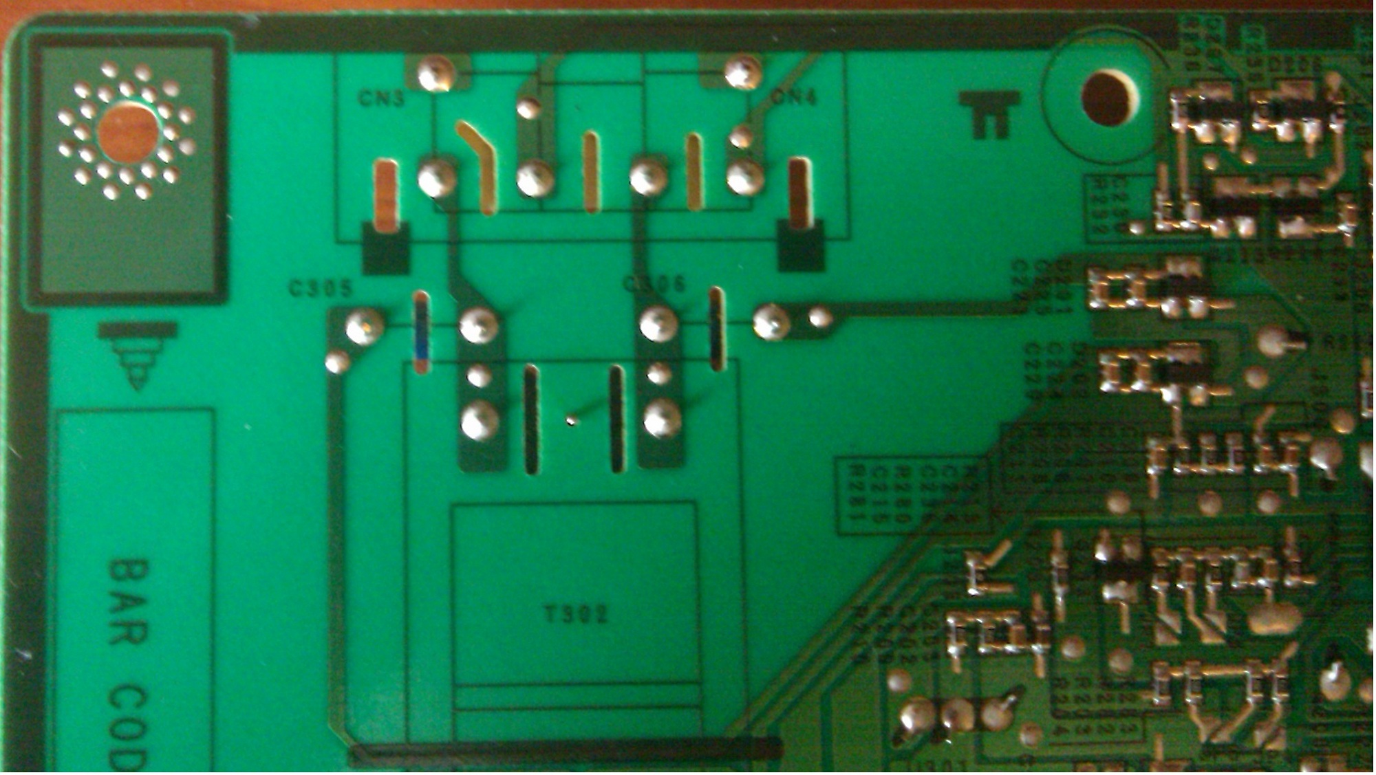

                          • Luscious
                            • 2
                            #93
                            I don't have a resistance meter, I'll have to go to Radio Shack and pick one up.
                            But Here are some (hopefully) clearer pictures of the board.
                            The first two are the left and right halves.
                            The last four are the top left, top right, bottom left, bottom right in order.
                            "Not also that the odd number pins are the pins that were circled in blue. Also, the wires that connect to them may be smaller in diameter. If they are the larger diameter wires STOP!! Do not continue!!!"
                            Larger diameter than what? The red ones?
                            Thanks!

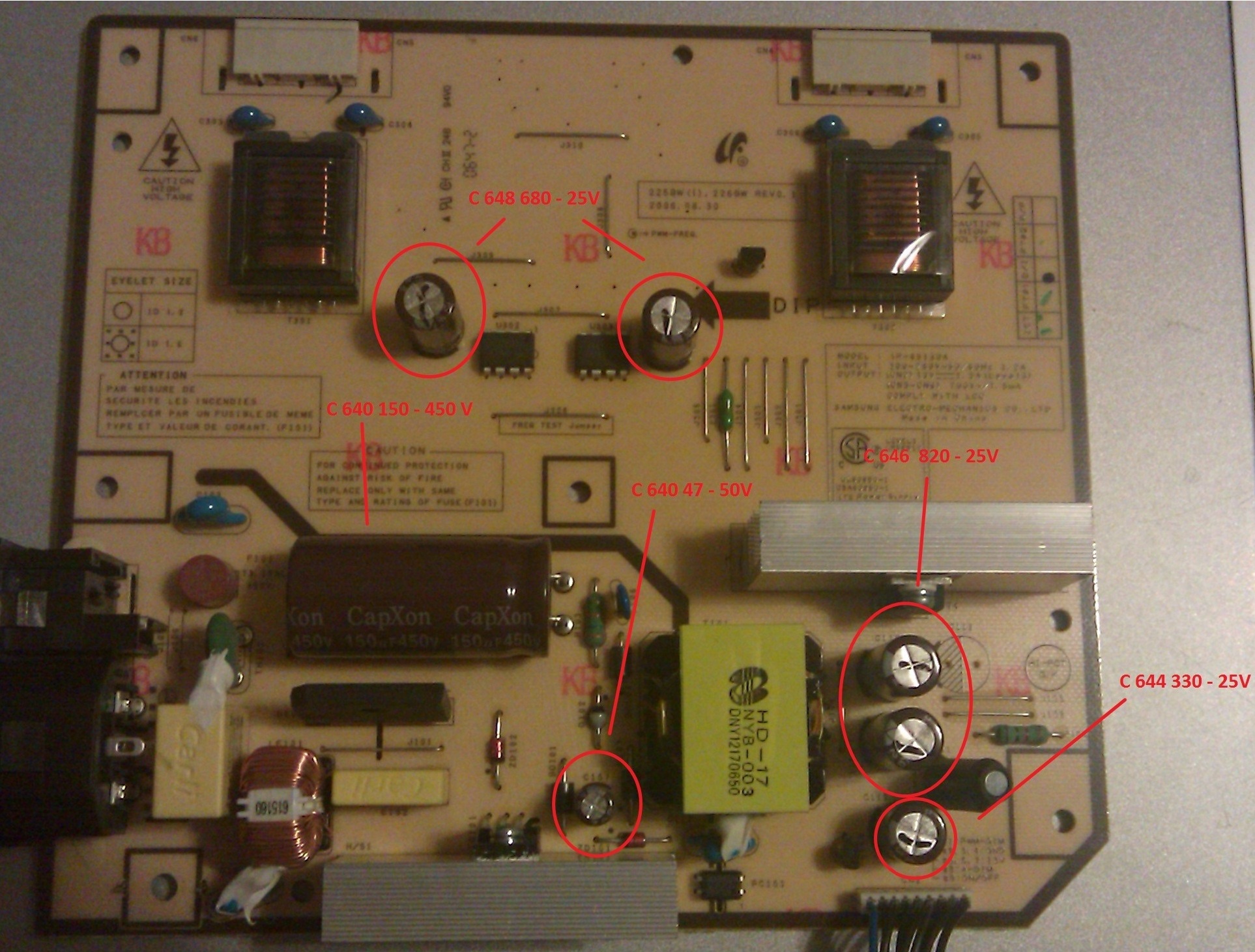

                                        • J_Fellenbaum
                                          • Nov 2009
                                          #100
                                          I would just like the thank everyone one in this thread, the forum and the website in general for all of the information! I broke out my soldering iron for the first time since a quicky class some 10 years ago.
                                          I've got my Monitor back! I had the blinking Blue light, changed the 5 caps listed and back in business! I will keep this website bookmarked for any future electronic trouble as there is tons of info on here! Glad Google directed me here!
                                          Thanks again guys!
