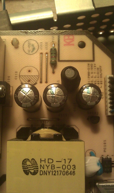

          Greetings,
          I read the Faq and did a search before posting, I hope I followed your procedures correctly.
          I have a Samsung 225BW that has the same symptoms described by others; turn it on and the screen flashes for a moment then goes black. Previously, I was able to press the on/off button several times and it would work, but as of today it only flashes and and goes black.
          I opened the monitor and took the picture below. The Caps with arrows were all swollen and the middle one was oozing. The numbers on the bad Caps follow;
          2 X 820uF25V
          1 X 30uF25V
          Other Caps that have no visible damage, but I assume you will recommend to replace are;
          2 X 680uF25V
          1 X 150uF450V
          I could use help determining the part #s of the caps I you think I should replace.
          Thanks for your help and the great website.

            There was obviously a typo, "1 X 30uF25V", should have been 1 X 330uF25V.
            From reading I am assuming these are the proper caps with part numbers for DIGIKEY
            2x 565-1551-ND 25v 680uf KY (EKY-250ELL681MJ20S)
            2x 565-1553-ND 25v 820uf KY (EKY-250ELL821MJ25S)
            1x 565-1547-ND 25v 330uf KY (EKY-250ELL331MJC5S)
            The one I am unsure of is 150uF450V

              Those caps will work. In most cases it's not necessary to replace the large (150uF, 450V) cap. The have a very low failure rate. That cap is so large that it usually is not available in a radial leaded style. Instead they have it with snap-in leads. Digikey has over a dozen to choose from ranging from $4.05 to $9.36. Choose one that will fit.

                Caps arrived and installed, monitor back to normal ops.
                Many thanks to those who helped!

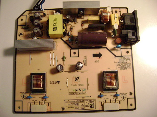

                    I just bought this same monitor (Samsung 225BW) with a different revision power convertor board but same result - Bad Caps. This was Revision 0.2 .
                    C305 = 330 25V
                    C304 = 330 25V
                    C112 = 330 25V
                    C110 = 820 25V
                    C111 = 820 25V
                    C107 = 47 50V
                    C105 = 150 450V
