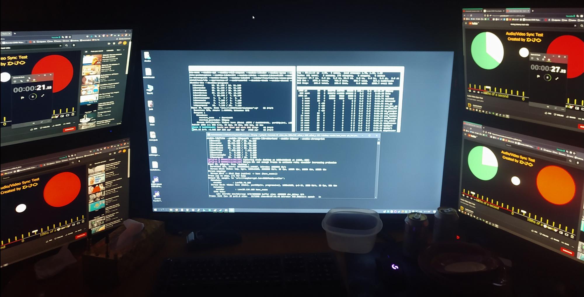

    So I have 5 display setup that consists of one 40" monitor surrounded by 4, ethernet wired samsung 225bw
    Picture of my full setup (from last year or so)
    Now I had a problem with these display, sometimes they momentarily turn black and come back (and the backlight stays on during this !)
