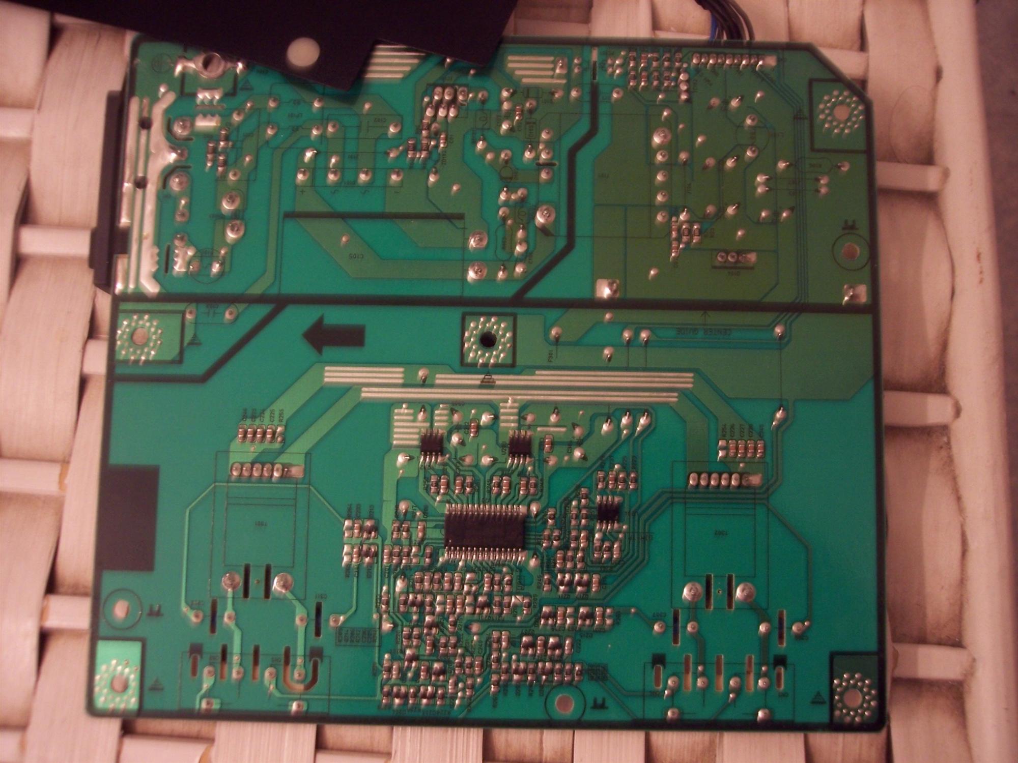

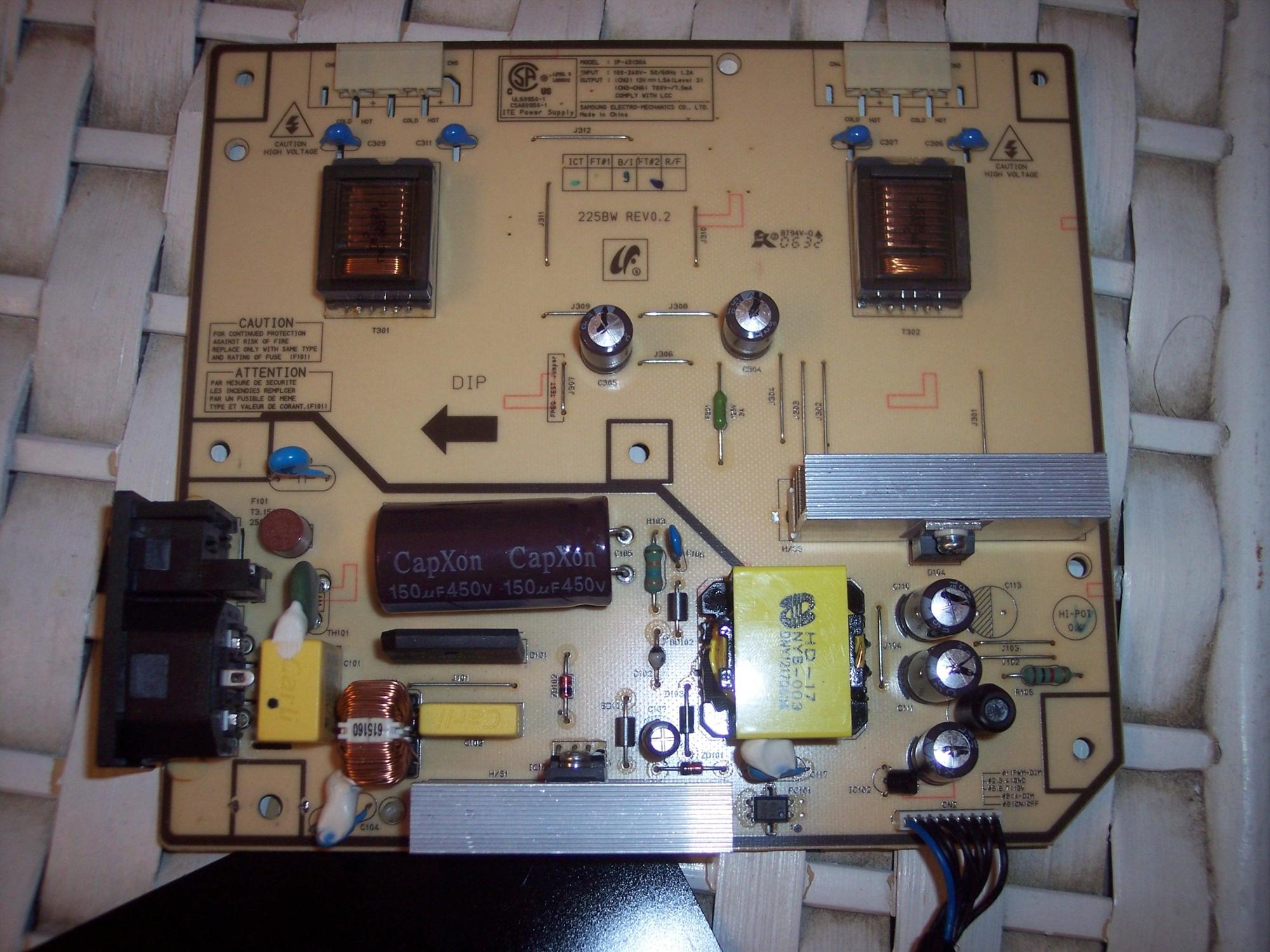

                    #109
                    Re: Samsung Syncmaster 225BW
                    Ha took me longer to figure out how to resize the pictures then it took to take the monitor apart.. hope this helps

                      #110
                      Scheesch!!! The five caps with the black mark on top are obviously bad; replace all of them. Also replace C107 (electrolytic near the lower heat sink); if that one fails it can cause problems.

                        #111
                        PlainBill
                        OK... i quess i dont know what to look for when it comes to a bad cap... the bulging right? the bigger ones should look like the c107 ? Thanks a bunch i'll order all six and replace.

                          #112
                          You got it. It's easy to spot from the side. In a picture from the top it's only slightly more difficult. A non-bulging cap will have a continuous reflection across the top. If it splits into four (or more) different reflections the cap is bulging.
