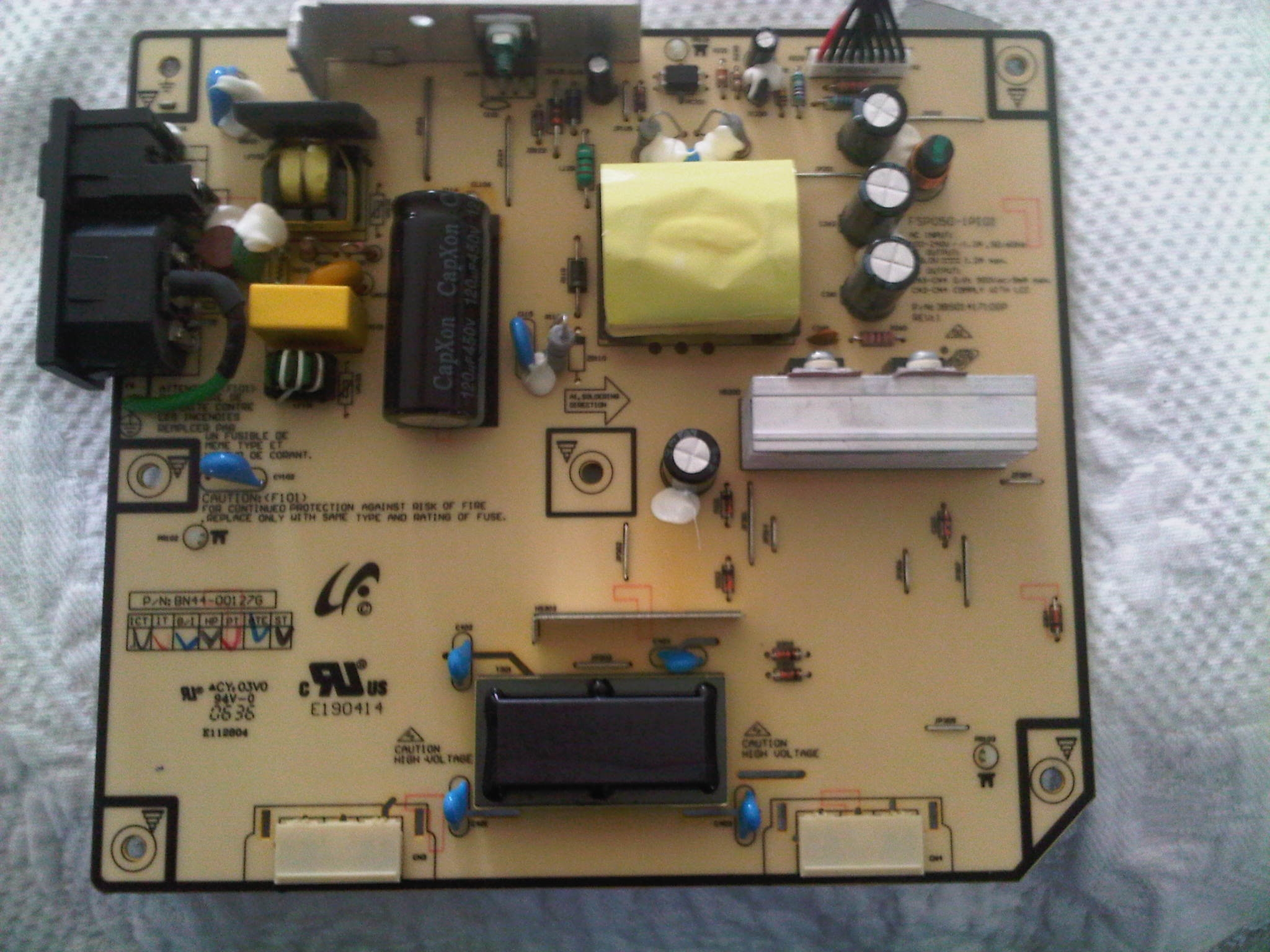

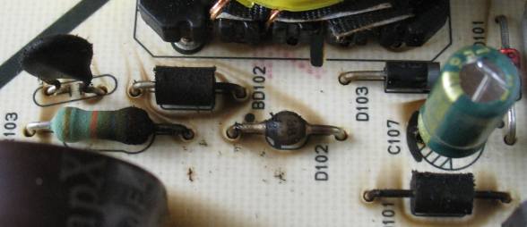

                  Another thing I noticed checking other pictures of the power board in this thread is that they are all very clean.
                  Mine shows that typical dirt near the transformer as you see in crt's.
                  Don't know what that means.
                  The picture is after replacing the 0.47 mu cap.I forgot to clean that up after reassembling. Don't know if that matters.

                    Well, My caps came in today. Wow do these panasonic caps look a hell of a lot better than the CrapXCon Caps. I am going to install them beginning of next week and I will post the results here. Thank you all for the help!

                                Just wanted to let everyone here know. YOU GUYS ARE AWESOME! I did this procedure with no soldering experience and the monitor is working perfectly once again. Thank you to everyone who contributed to this thread.
