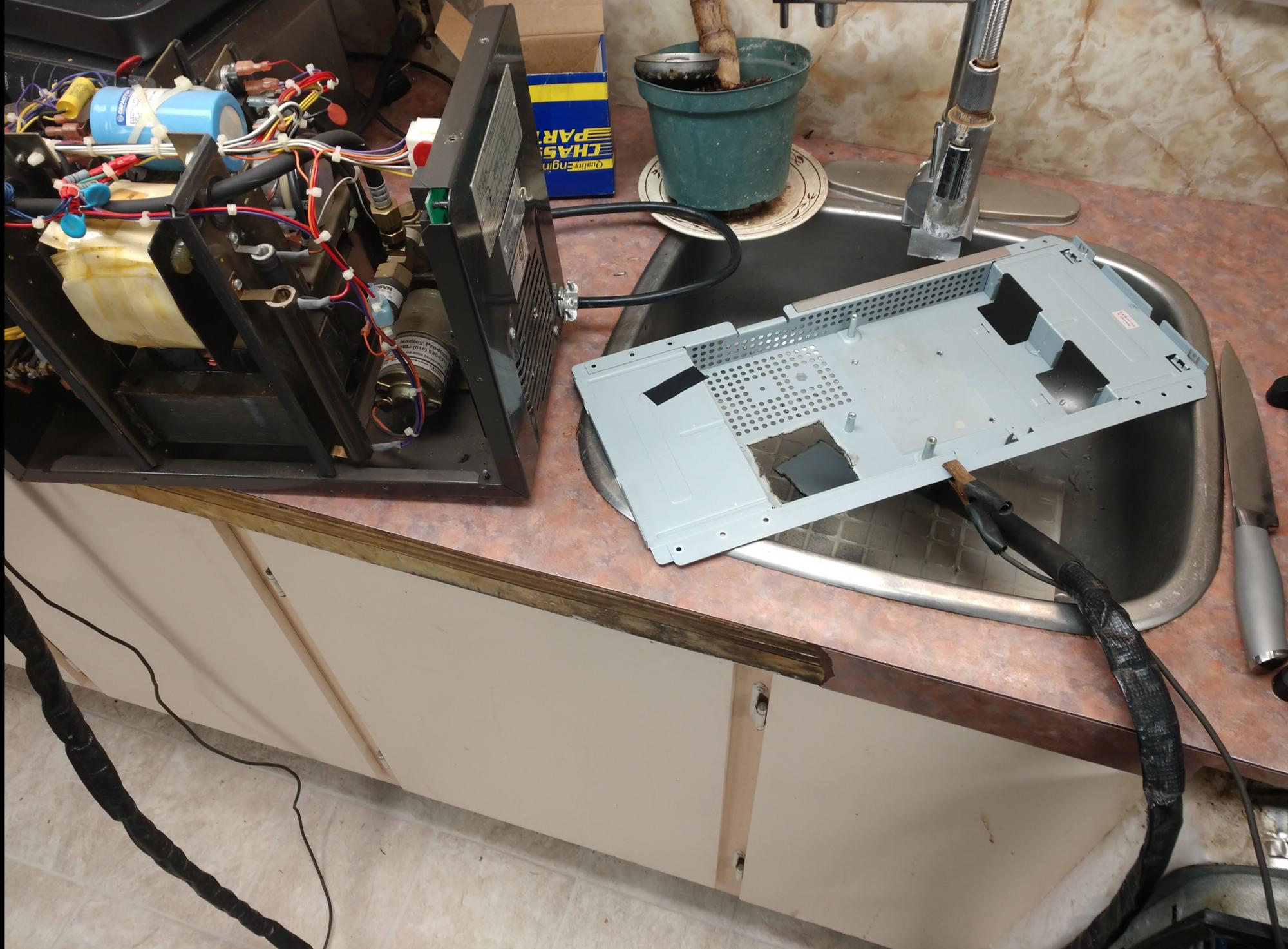

    So I have 5 display setup that consists of one 40" monitor surrounded by 4, ethernet wired samsung 225bw
    Picture of my full setup (from last year or so)
    Now I had a problem with these display, sometimes they momentarily turn black and come back (and the backlight stays on during this !)
    Sometimes the front panel freezes and I have to flip the switch behind to reset it. Sometimes the screen will become 100% red only because the color values have become wrong (press second button from the left 4 times to fix this, if it's not frozen, that will reset all the colour settings by setting the display values to "game" colours)

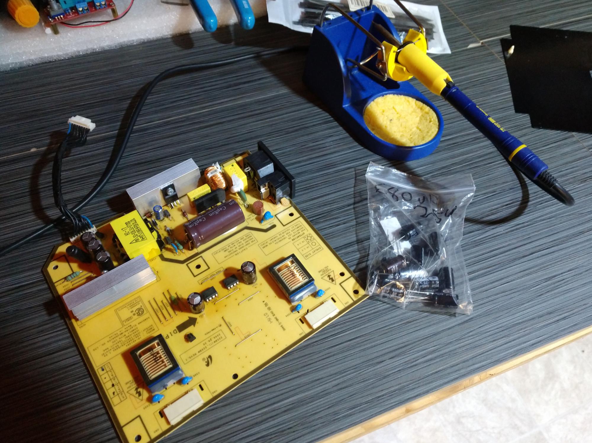

    So I noticed this was become more of a problem with heat so I went and dismantled 3 of them, fixed the busted backlight inverter caps. Also changed some that were not busted. In all cases that did not fix it.
    Here I am fixing the caps

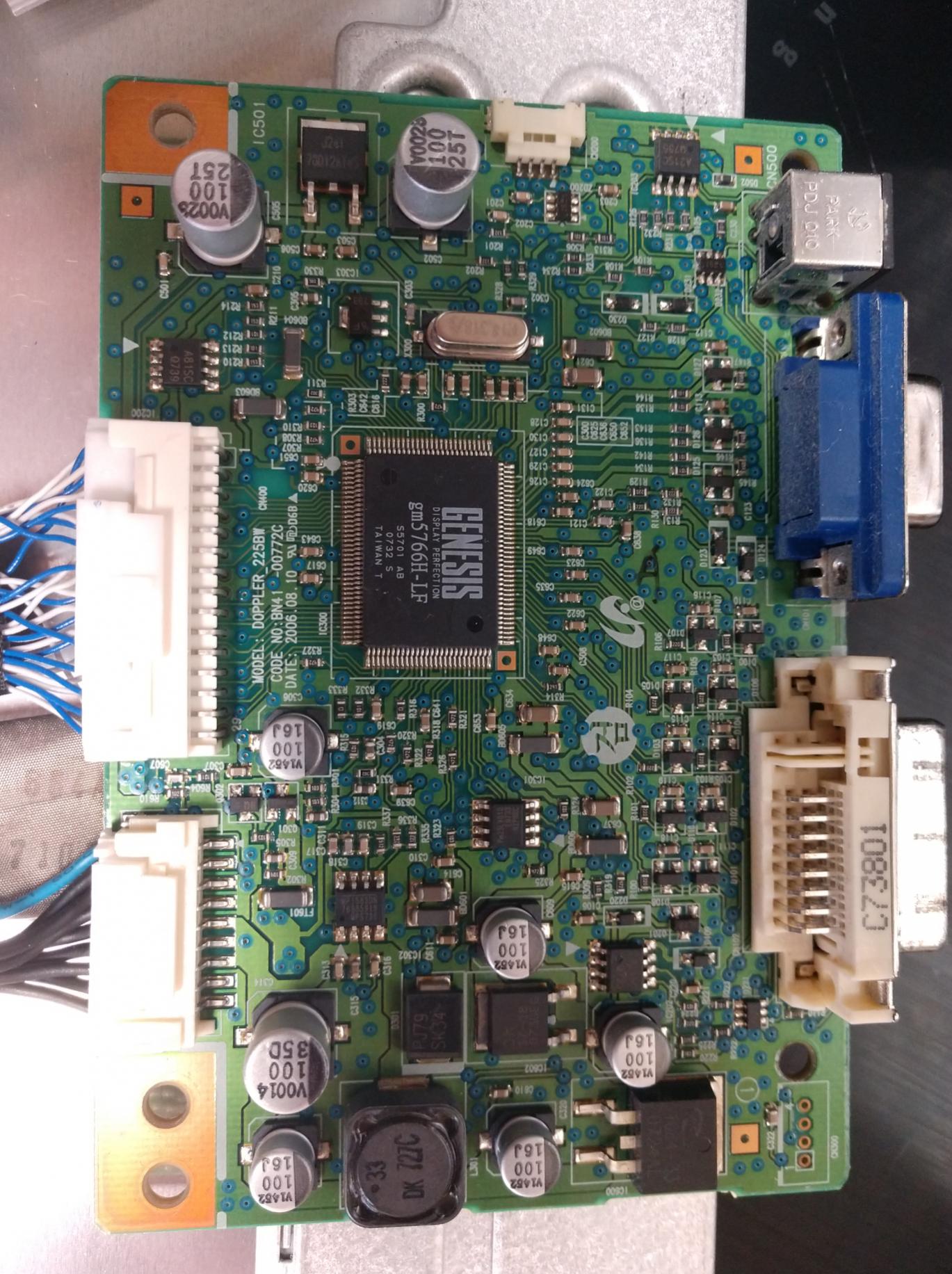

    I took a measurement of the chip in the middle, 43C in open air
    Here is the board close up
    Couldn't find anything explicitly bad with it.
    So I decided maybe it is the heat that is doing it ?
    Then I took my big hairdryer and shot it at the PCB on full blast.
    And that triggers the problem in seconds.
    When it cools down it doesn't do it.

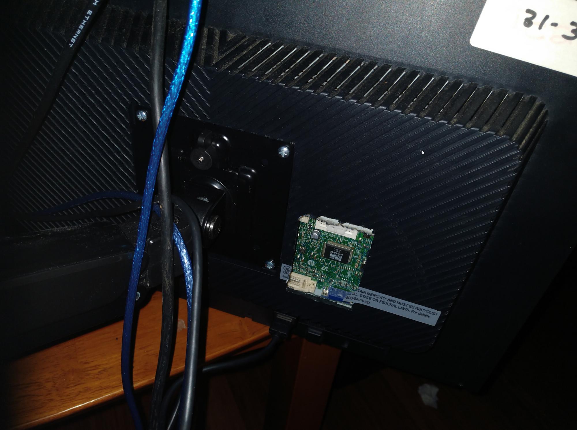

    So I decided to cut a window in the case
    Here is the finished product for now, until I can install a fan

      Re: Samsung Syncmaster 225BW
      I would check the ESR of those surface mount electrolytic capacitors.
      Probably after all these years with heat they are bad.
