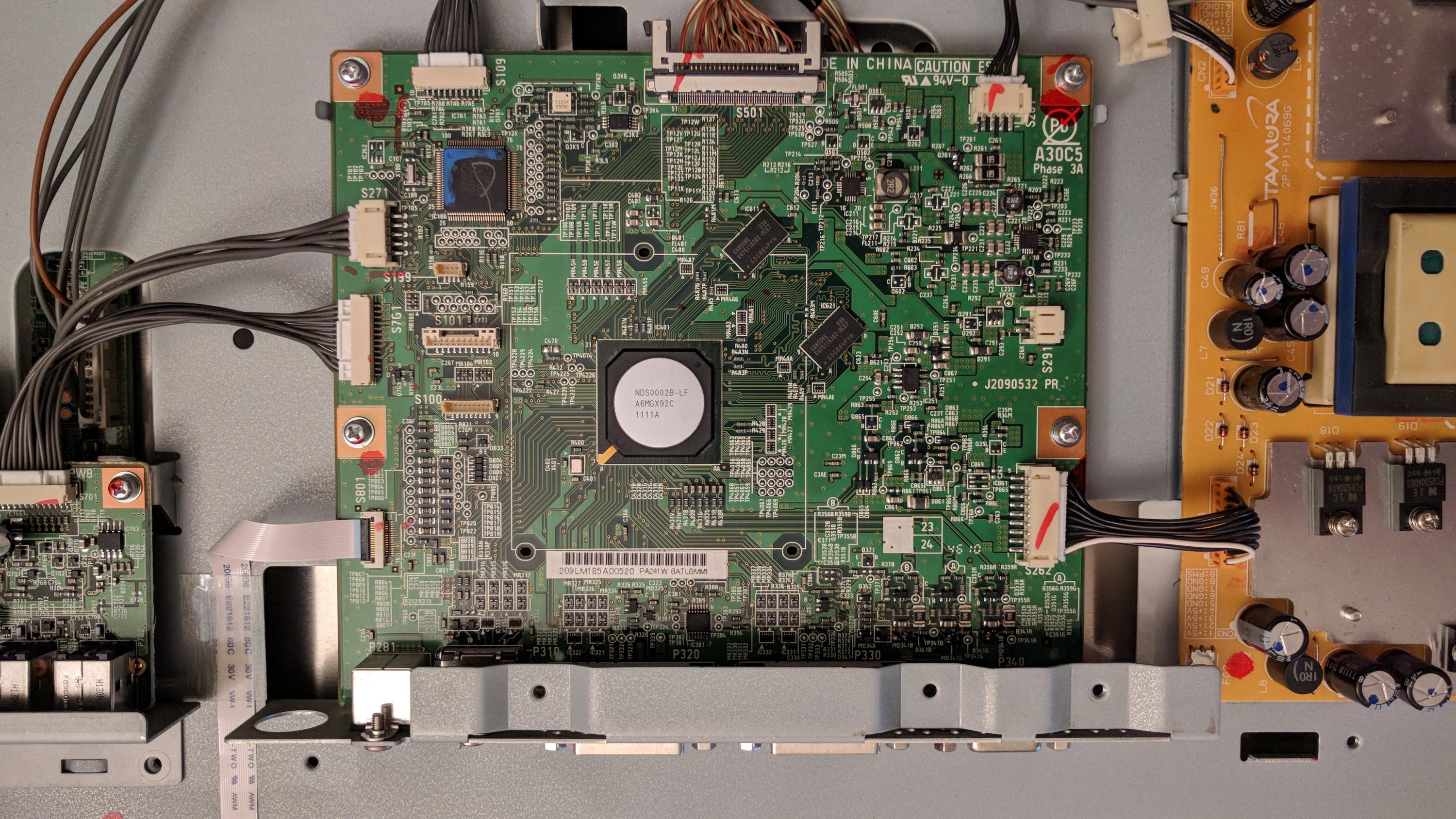

    I tried to do a firmware upgrade in my NEC PA241W-BK LCD monitor via the USB port recently. Unfortunately, the upgrade failed during the process, and the end result is that the monitor is pretty much dead - it's not turning on.
    I called NEC and they stopped servicing this particular model in October 2017. They are also not offering replacement parts for this model anymore.
    Since the panel has about 3k hours on it, I'd like to at least try to get it fixed, assuming it would make sense from the financial standpoint.
    According to a buddy of mine who diagnosed it, the power board is fine, but the main board needs to be replaced because the main chip (it has the following signature: NDS0002B-LF) is not working. While the chip seems to available, the replacement of just the chip would be cost prohibitive and he prefers to replace the whole board.
    The problem is the availability of that part - NEC told us flat out that they don't stock this part anymore here in the U.S.

          So what was the problem with the monitor that you felt it needed a firmware upgrade? It is possible the firmware is stored in a spi/flash ic and not the main processor.

            I started having some connectivity issues between the calibration puck and the monitor - the manufacturer recommends performing color calibration with the puck every couple of weeks to keep the color accuracy which is important for photo editing. So while I wasn't able to perform calibration anymore, the monitor itself did work just fine. But I wanted to get fix the communication problems and be able to perform calibration again.
            So I did the software update on my PC that manages the calibration process - that didn't help, so I figured maybe there was a newer version of monitor firmware. And to my surprise (the monitor is 7 years old), there was - it was a 2-3 years old, but much newer than the firmware that I had installed. I did everything as indicated in the upgrade notes, connected my PC to the monitor through the USB cable, started the upgrade - and around 25% I got the message "upgrade failed". So did it again, and the same result. I was not able to turn it off using the power button or switch the input. So after a while, I just pulled the plug, just like the manual says. Tried to turn it on - the screen remained blank, but the status LED started to cycle between 3 colors (blue, green and red), then it got orange/red... and that was it.
            I think my buddy just wants to save himself the hassle of doing the detailed troubleshooting and went for the easy solution, i.e. since the power is supplied to the main board that's supposed to control the monitor, then something on that board must be broken - either the main chip or something else. So let's change the whole board.
            I took a picture of the main board - not sure if it helps to determine where the firmware is stored, but I figured I can share it.
            Any thoughts on swapping the board from another monitor that's working? I can get it for about $200, which is I think much less than the new one, and also less than what the new main board would cost me (assuming I can get it from Europe and assuming that my buddy can program it).

                  Re: Bricked NEC PA241W-BK LCD monitor
                  Have you read this? https://www.nec-display.com/dl/en/dp...ate/index.html
                  there may still be a way to upgrade the firmware and maybe salvage the monitor.

                    It worked!!! But I have to admit I was skeptical at first -the reset procedure suggested earlier didn't do anything, so I really didn't expect much. But when I plugged in one end of the the USB cable into the monitor and the other one to my laptop and when the laptop recognized another USB device, it started to look much better. Then I did the firmware update - this time it completed flawlessly and the monitor is working. Thanks again for the tip and for saving me a couple of hundred of bucks :-)!
