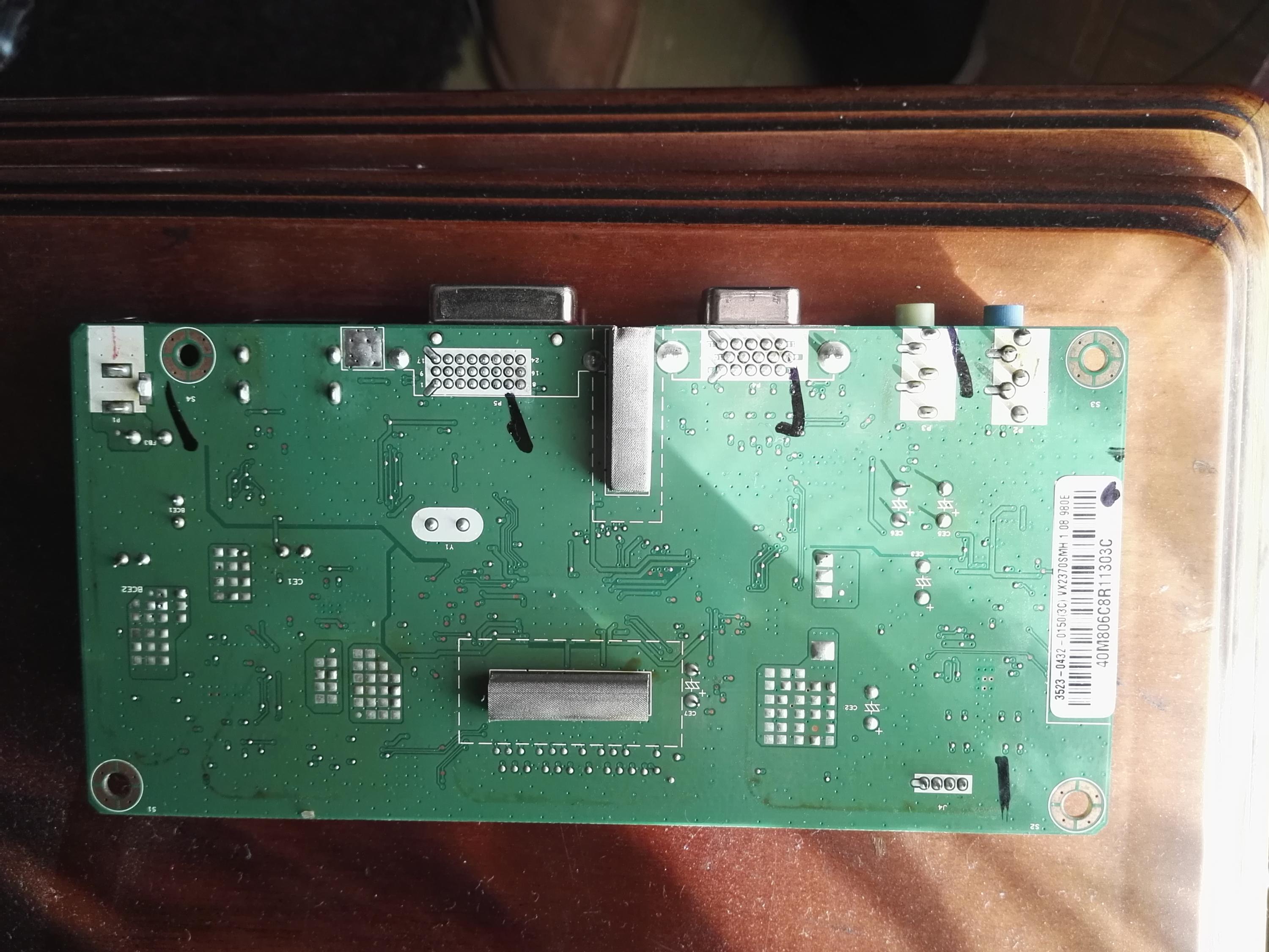

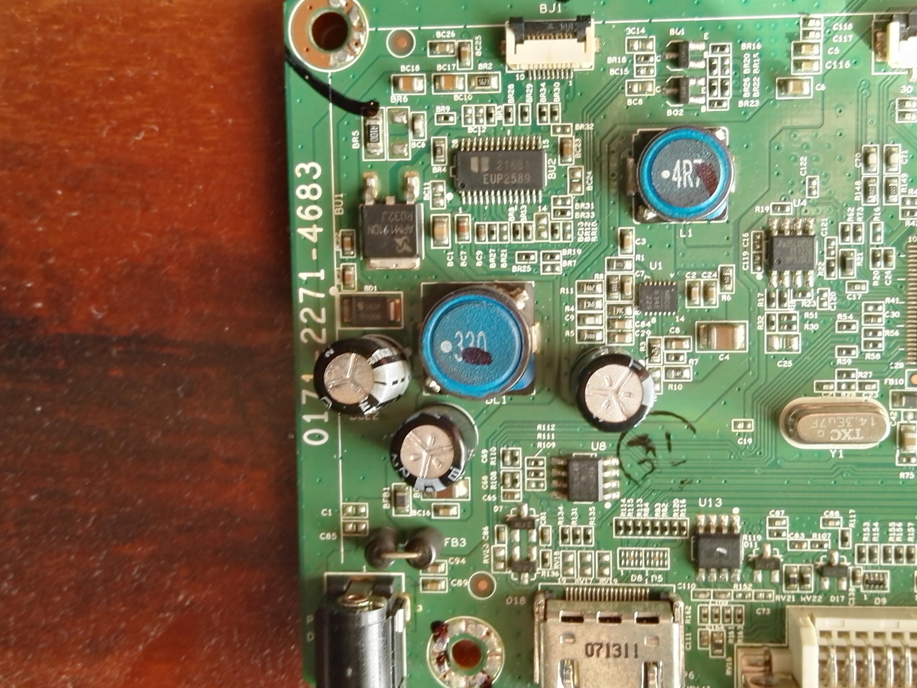

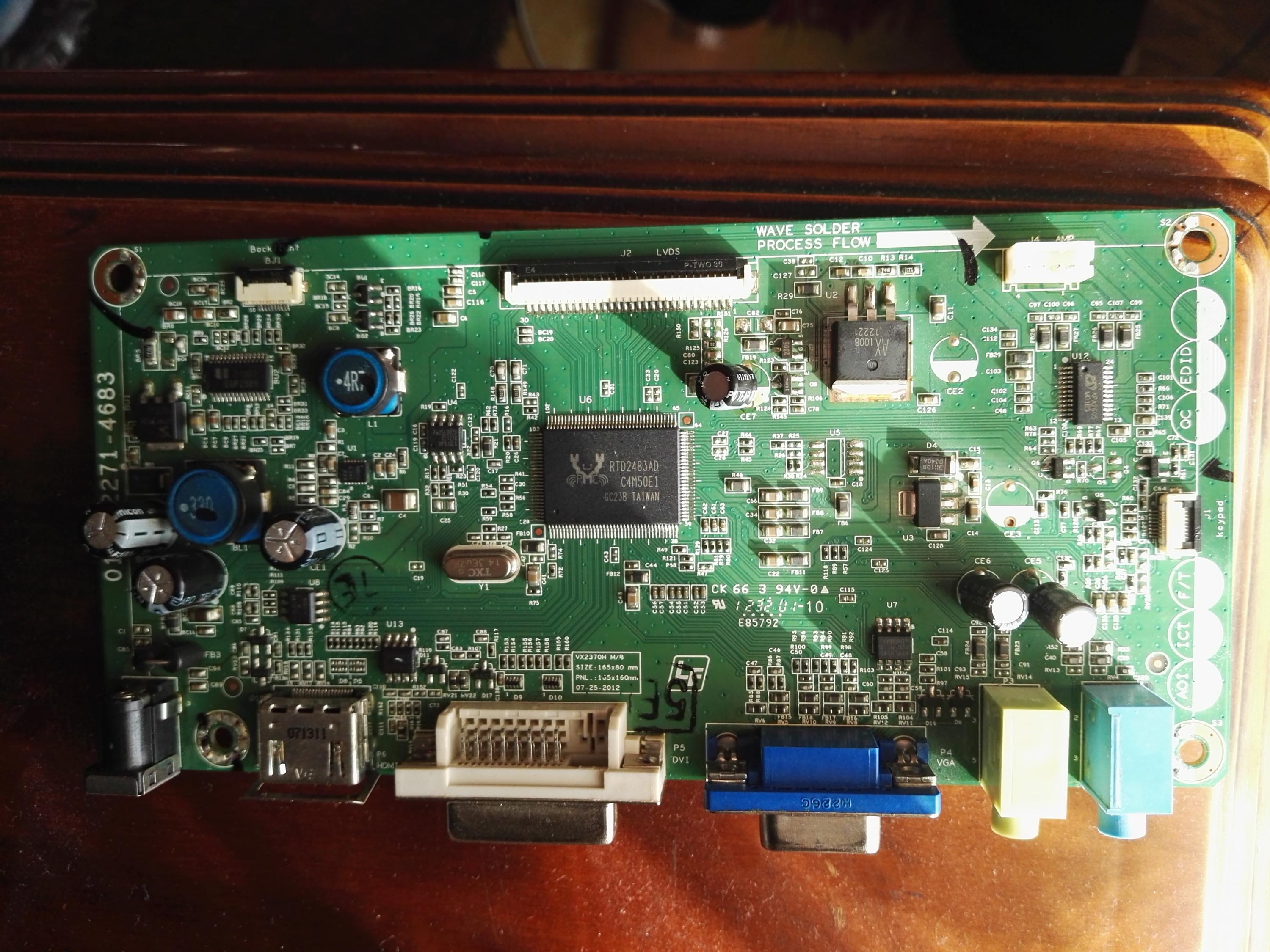

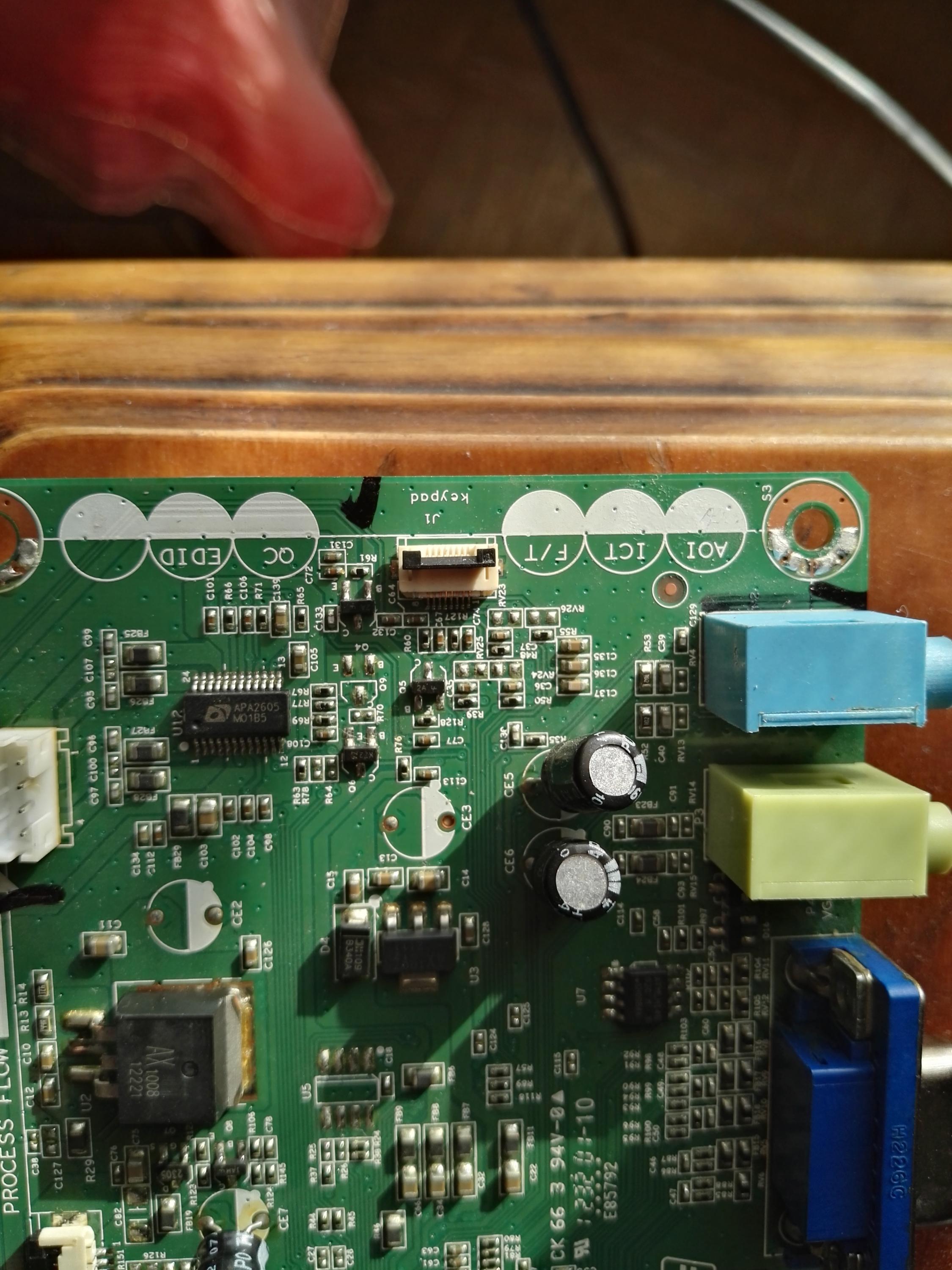

            I share some pictures what logic board looks like ,I got some idea but dont know how to implement,
            if I can send same commands as keys from keypad flex port ,but I dont know which pin to sends what command or combination of pins ,any idea about that ?.
            I read your flashing thread about that benq screen ,but that is risky thing for me to do ,unsoldering that eeprom and that isp flasher which I dont have one, plus I could destroy the monitor at least it is working from vga.

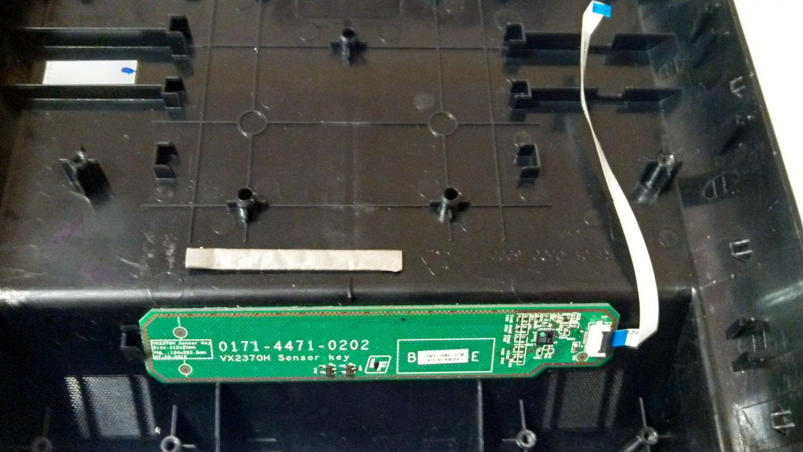

              Look at this sensorkey placement it is whole glued there ,even new firms like AOC doesnt make design like this.
              İf this isnt being amateur what is I wonder ,On that day of purchasing this monitor I was certainly one of those days like you feel dumb and numb ,viewsamsonic is history for me after this model.
