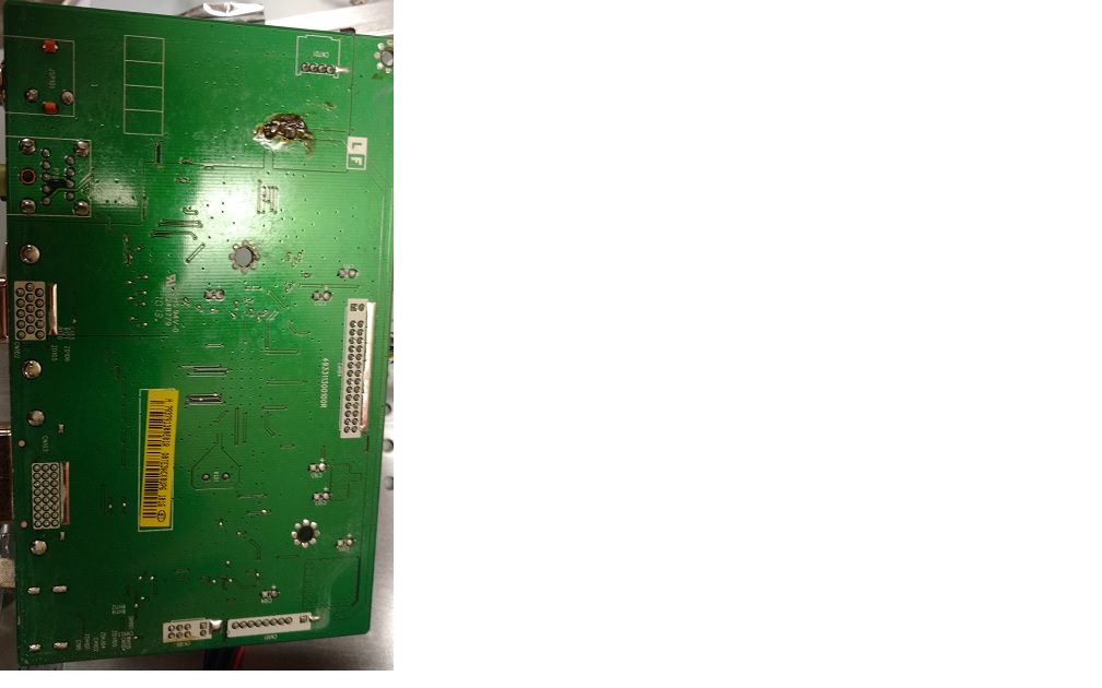

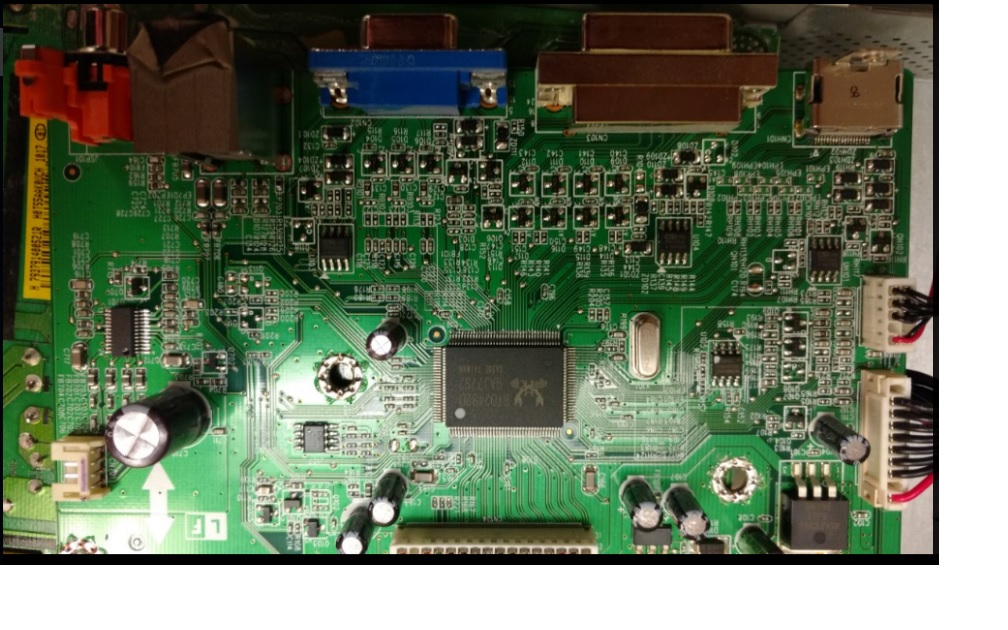

    Asus VH242 white vertical line
    Hi, I found this nice Asus monitor.
    It has a white vertical line (static line doesn't move)
    I attach 2 photos of the video board.
    It looks like a capacitor was change at some point.
    Could it be that the capacitor is failing again?
    Thanks.

    Re: Asus VH242 white vertical line
    Vertical lines are usually a sign of the TFT panel going bad (or rather the ribbon cables attached to it are starting to get detached.)
    Post a picture of the problem, though, so we can evaluate if that's the case or not. Meanwhile, you could also try re-seating and cleaning the LVDS cable going between the logic and T-con board.
        Probably a panel fault, as I mentioned. You can try moving the flat cables between the t-con board and the TFT screen right above the line to see if that makes it disappear or change colors. But apart from that, there's not much you can do with any simple tools. No parts to replace to fix that.
