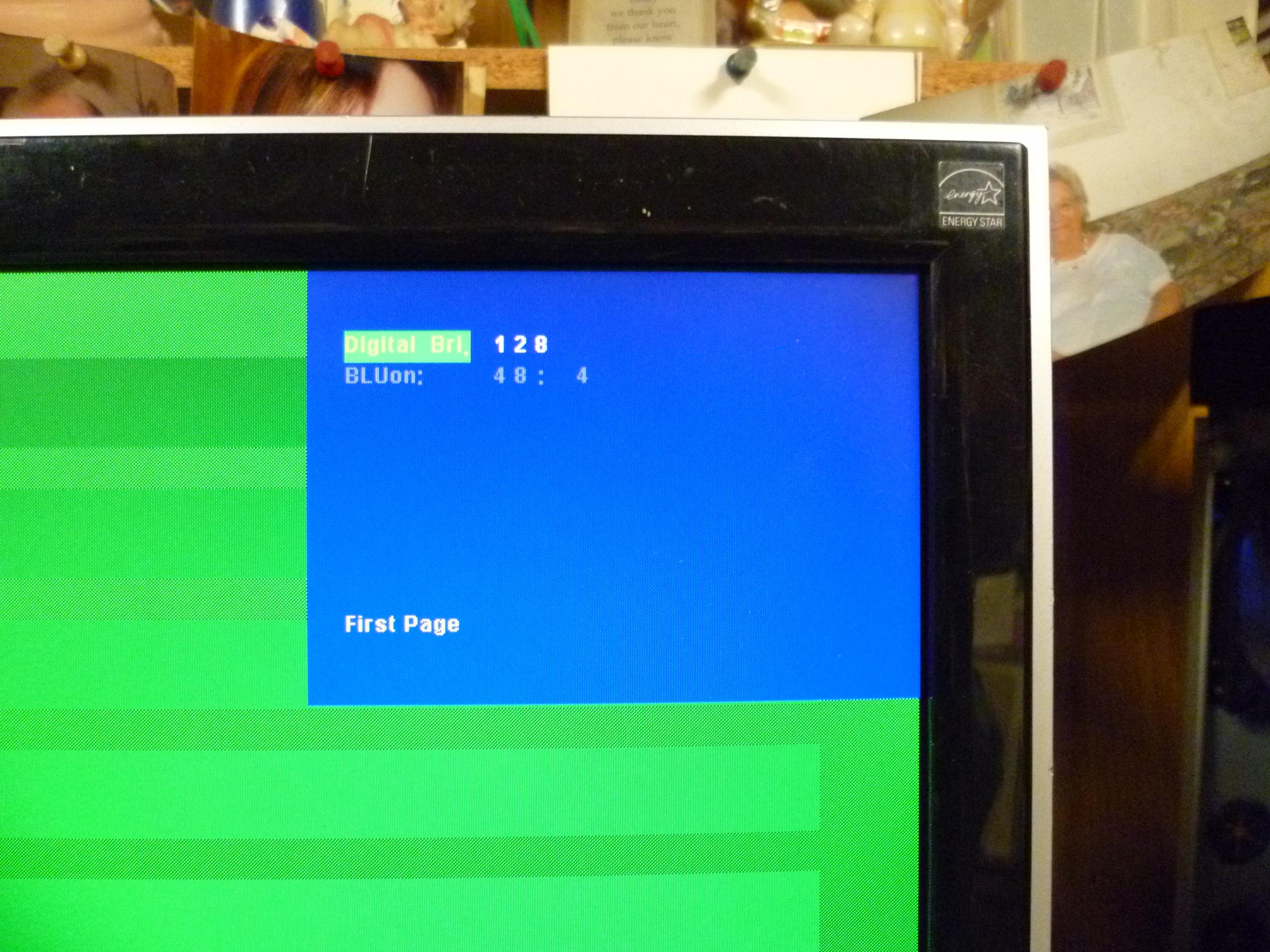

                  This is getting weirder and weirder...I decided to reopen the monitor and while plugged in I just passed my finger along the logic board ribbon cable connector...the left one, and I could see the image change..from right to left, the image improved and from left to right it became washed out.
                  As if my body was creating some sort of ground. So I thought the cables and connectors needed cleaning ( i had already cleaned them) but this time I removed them and cleaned the cables with an eraser and alcohol, and the connectors with alcohol (99%). I reinstalled and shucks, the colors were washed out and I could not recreate what I did, even while applying some pressure on the connectors.
                  I decided to swap the cables, with same result - colors washed out and can't recreate the experiment.
                  Were back to square one, but it was amazing to see when I passed my finger along the connector, it was as if it was a volume for the sharpness of the colors! Any ideas?

                    As per Momaka suggestion, I tried heating up the board no change. Tried leaving it outside in the cold Canadian weather (-14 C) for a few hours, fired it up and still no change.
                    I repeated the experiment of passing my finger on the logic board connectors, but nothing changes, just washed out colors.
                    I saw on youtube a guy with weird colors on a monitor that says to solder the ground of the connectors. Not much space to solder there, and I would be afraid to damage the connector.
                    I took some close up photos of the connector I passed my finger along (the one on the left in the second photo) in case someone with professional eyes sees something.
                    I have a feeling there is something wrong with one of the cables (the left one). Where it is inserted, the connector has made a marking on the cable end. Looking with a magnifier, I can see a small aligned dent on each connection. Should I shave off (cut a 3mm edge) the end of the cable so that the connector would sit on a fresh piece of connections or is that a no no? They are 36 pin 125mm FFC cables that sell in China, but that would take weeks if not months to get new ones, and I'm not sure they would be the right quality. The original cables are sold on Viewsonic's website, but they are out of stock

                          Ok, I checked the test points on the logic board for the 3.3V, 5V and 12V voltages. Here's what I get, as soon as I touch the TP say for the 3.3V, I get 3.29 and then it goes to 3.304 V steady within about 1/2 a second. Same goes for the 5V, 4.99V on touch and after half a second 5.03 V steady. The 12V line, show 13.96 at start and goes up to 14.08 in the same fashion. The 12V is from the service manual, but on the board I can see it says 13.8V going through a fuse F1 and reads 13.96 at first and goes up to 14.08 stabilised.
                          I checked the voltage on that small Cap on the logic board (47uf) and when I touch the positive side, it gives me the same reading as the 5V test point..i.e. starts at 4.99V and stabilises at 5.03V.
                          Any ideas?

                                        Re: Viewsonic vx2235wm colors washed out after power board recapping
                                        Hello Momaka, and Merry Christmas.
                                        You won't believe this! I decided to reinstall the monitor. Reading through the service manual, I noticed a key combination to call up factory settings. Tried the key combination as per the manual, but it wouldn't work..it says to hold the power button, up arrow and down arrow simultaneously. Tried many times but did not work.
                                        Then I decide to try other key combinations and at some point (I think I was holding the menu button and the up arrow), a factory screen came up! There were lots of adjustments but by luck I decided to fiddle around with a VCOM setting that was at 255. I lowered it and the screen improved...right around the 128 level was the peak best screem so I pressed menu again and the factory screen disappeared and the monitor was back to normal!
                                        I've been trying to get back in this factory menu but can't, however the screen is beautiful, just like new! Any idea what went on, and how I can maybe recall this factory screen? I searched the web and saw some ideas but they don't work on my screen. There were a lot of choices on that screen but it seems that VCOM was the culprit. Anyways, now I have a fully recapped (with good caps thanks to you) and working beautifully! Just great!!
                                        • rddube
                                          Aspiring Expert
                                          • Jun 2013
                                          • 944
                                          #40
                                          Succeeded in calling up that factory menu again. Here's how:
                                          5.3.5 Factory Mode Introduction
                                          When input the signal, press "power key" to turn off the monitor. Press" [▼] +[▲] +[ ] "at the same time so as to enter factory mode. After power on, press ''Menu[1]'' key, you can see the Factory menu
                                          Attached are photos of this secret factory mode for anyone who has the same problem I had. There is page 1 and page 2 - page 2 I took 2 photos so to show what the selection was.
                                          You can see on the first menu Vcom is what I changed...initially it was at 255 and brought it down to 128 and bingo, that did it. Wonder what all those other settings are for?
                                          Many thanks to all of you and especially Momaka for helping me out in this super adventure!
