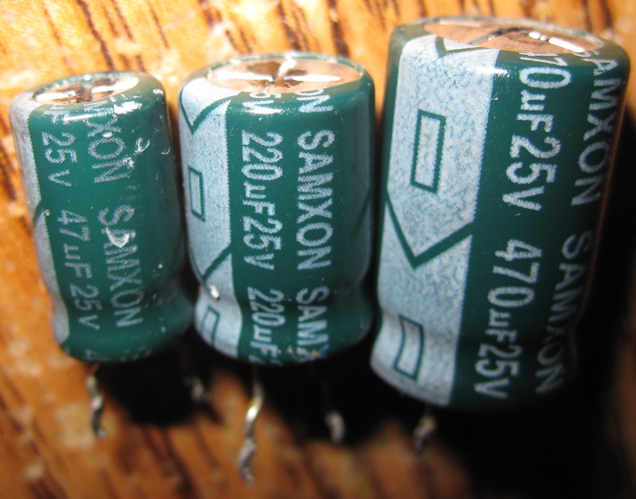

    Well I think every single one of my 19" LCD monitors had a problem or died at least once now... all either bad caps or suspected bad caps.
    Anyway, my 900G completely would not turn on anymore after flickering on and off for a few days. While disassembling it, I noticed the LVDS cable that attaches the main board to the T-con board (?) was glued together. Well, I had to remove the glue, then proceeded onwards. After finding the bad capacitors and replaced them with what I had on hand, I put it back together and powered up...
    It was white for 2 seconds and then faded black.
    Weird. Same behavior with a DVI signal. Ugh. Did I break the mainboard?
    Well, turned out the LVDS cable was loose. Really loose. Probably because I ripped off the hardened ceramic-like glue. For now I used some black tape to stick the wire... don't think it will hold long, but I figure that (A) I know what the symptom is now and (B) I figure I'll be back as the caps I used aren't very good (I need to restock...badly...)
    Long story short: Use hot glue or what removable glue do you use for this kind of situation?

    Re: Gateway 900G 19" LCD monitor: LVDS cable GLUE?
    Hmmm... I've seen factory LVDS cables glued down with double-sided foam and/or aluminum tape, and I've always been able to remove it carefully without damaging anything. Afterwards, I never re-glued it with anything if the original adhesive tape didn't want to hold it back.
    Regarding the white screen you saw: that's typical when the LVDS cable is not connected properly or when the T-con board has one of its TFT panel inverter power circuits go bad or the LVDS driver chip and/or its linear reg. go bad.
    Yes, if you didn't use good caps, you will be doing this again. LCD monitor PSUs tend to run quite hot at normal room temperature (i.e. 70-75F or 21-24C). I've measured 70C inside the case of one of my 19" LCD monitors when the room temperature was close to 30C. I imagine with a lower room temperature, that may drop down to 55-60C, but that's still a cap-cooker if you use general purpose 2000h caps. CRTs often appear to run as hot, but they have much more space inside their cabinets, so the components don't actually run anywhere near as hot.... save for the CRT neck board, maybe.

      Hmm. the original stuff was actually something that set hard, almost rock hard. It wasn't just tape to hold it in place though there was some metal foil tape.
      I wonder what the hard stuff was... Definitely felt harder than hot melt glue or RTV.
      BTW, the caps this monitor used were all samxon GF(M) U2A's - supposedly 105C low esr's. All of them...

        No idea what that would be. Perhaps they spilled Threadlock on there by mistake?
        If you want to use hot glue to hold stuff down, it will work fine - even in a hot LCD monitor. I've used it before and it's not a problem. If the LCD gets really hot though, you may get a bit of a hot-smell glue coming from the monitor. But it won't melt away or anything like that.
        Samxon GF c[r]aps are known to go bad, especially in monitors. They are indeed low ESR, but nothing special. IIRC, even Panasonic FC could be used as a substitute, and that's an entry-level low ESR cap series.

          Doesn't appear to be threadlock, usually that stuff is watery and dries down. This stuff is white and like a blob, perhaps it's a different formulation of hot melt or maybe some type of epoxy. Either way I don't think they intended it to be removed. Then again hot melt/epoxy weren't meant to be removed either, just that it was so hard that trying to remove it probably caused damage to the connector whereas hot melt and RTV remains pliable after setting.
          As it was a stop gap solution, I found three of those Samxon crapacitors to be really bad and just replaced those (just one was slightly bulged, other two looked fine on the outside). There were a few others that were marginal but I didn't replace them as I didn't have any replacements on hand. This is a death trap monitor, will die at any moment... heh heh heh...

              I notice there's a lot of aluminum tape, which leads me to believe that RFI is a concern... I do notice this monitor seem to cause my radio to generate noises so I'm a bit worried about RFI as well...
              BTW, the bad trio... Just that 470uF looks a little phatty, but all three needed to be replaced else the monitor wouldn't power up anymore.
                That means probably all of the Samxon GF caps in the monitor need to be replaced (save for the big input cap on the primary).

                  After about 6 months of it working just fine, it crapped out once again.
                  I replaced a few more of the capacitors and it's up and running once more. The count is now 9 capacitors swapped, and includes a capacitor that's >5 ohms ESR, and the rest around 1 to 2 ohms.
                  I ran out of 470uF capacitors, but since there were two in parallel I stuck in a single 1000uF in place of the two 470s. As it looks like they tried to reduce BOM line items since they used 25V caps on the 5V lines, it probably will be fine... for how long...
