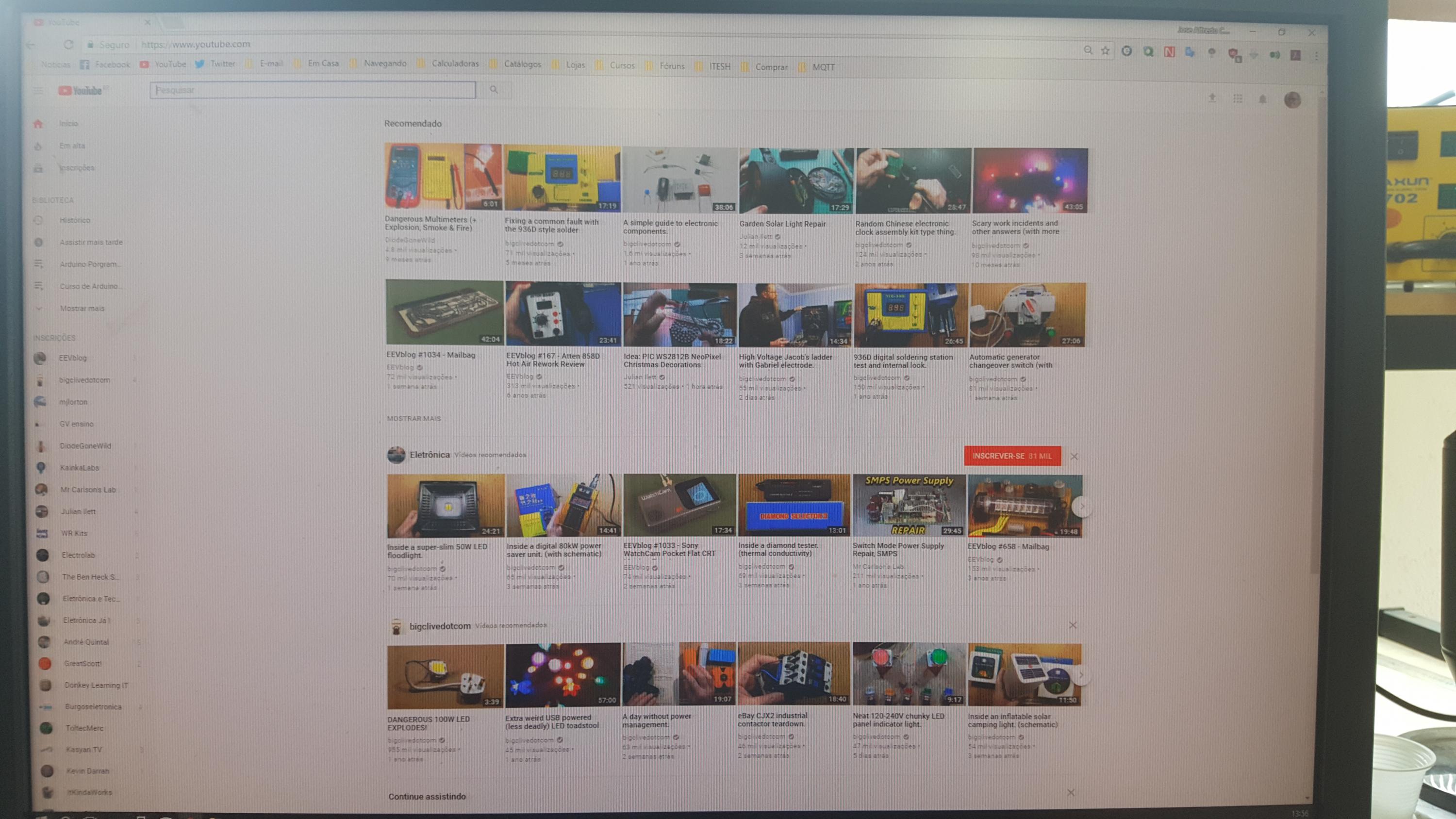

DELL 2408WFPB LCD Monitor
  • jacs
    • Nov 2017
    • 5
    • Brasil

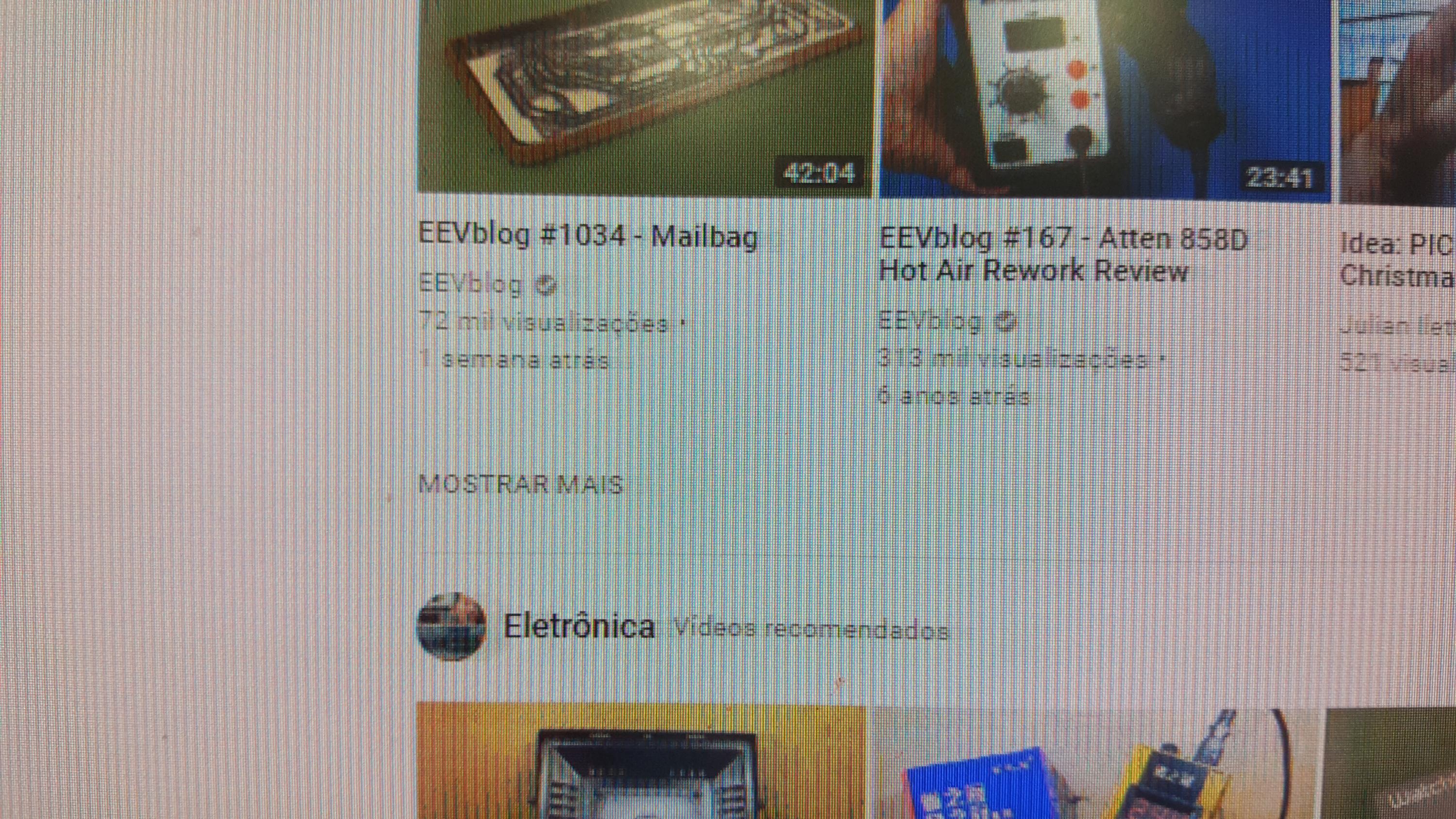

    This LCD monitor have vertical lines all over the screen as you can see in the photos I posted here. They are quite different of the vertical lines I am used to and would like to know if anyone of you have experienced this same problem.
    No bad capacitor on the boards, at least visually. Should I remove all of them for testing off-board?
    Or do you think it could be the T-CON board?
    Thanks for any help.
  • piernov
    • Jan 2016
    • 4439
    • France
    Re: DELL 2408WFPB LCD Monitor
    Try to reseat the LVDS cable and clean the connectors (on the mainboard and on the panel). If I'm right this is an issue with one specific LVDS channel (which is carried through one set of LVDS lines).
