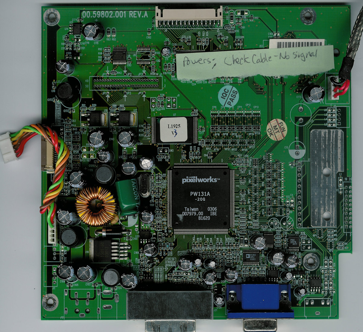

    I have an HP L1925 LCD Video Input Logic Board that powers on, and I get the standard "check signal cable" display, but as soon as I plug in a source to either the DVI or Analog 15-Pin VGA, it immediately says "no signal" and places the monitor into standby. I've tried all different resolutions and cable types, but to no avail.
    What could be the cause of the board not accepting a signal? Could there be a blown capacitor somewhere? What else could I test?

    I can only figure a TAICON from the picture. Can you give info on the other caps (cap, Voltage, brand)?

          The smaller caps around the DVI/VGA inputs are black TEAPO 12/02 16v 10uF SS 105 degrees C.
          Slightly larger brown ones are: TAICON 16v 100uF 0304(M) 105 deg C (VT).
          There are also some larger 470uF TAICON, and the one big green one is TAICON as well.
            Re: HP L1925 LCD Video Input Logic Board won't accept signal
            I wonder if it's the TEAPOs that are the culprits since I have another of the same boards that is 100% TAICON caps (exhibits different problem).

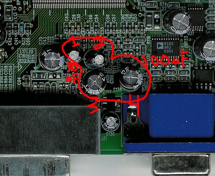

                I finally got around to testing this board with a digital multimeter (DMM). On Ohm Resistence test (setting 2000), I saw that the following 4 capacitors (circled in attachments) registered shorted (0 value basically): 2 100uF and 2 10uF. *I tested them on-board*--haven't removed them yet.
                My question is, if I replace these 4, do you think it'll work? Do Caps normally go bad around each other like this? How sure can I be that it is the caps, and not some other component on the board?

                  Have you tested the same caps on the other board?

                    Yes, I actually have 3 of these boards--all with varying problems. The other 2 check out fine on these same contacts. In other words, the others do not show a short for these caps.

                      Change them all. Teapos / Taicons give problems. You can start changing those at the signal input area, and then if it starts working properly, go ahead and change all the others now to prevent further problems.
