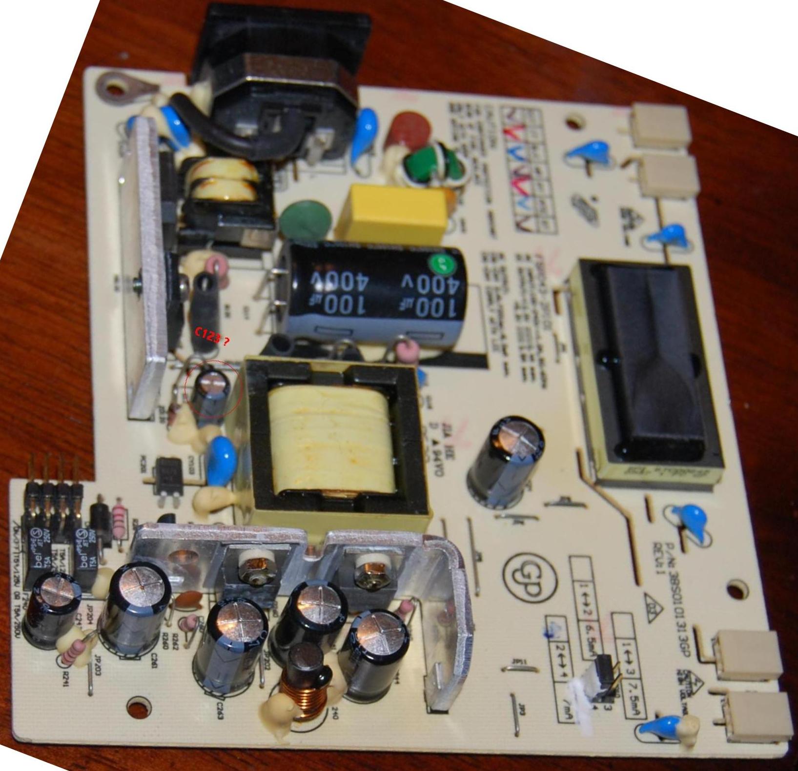

      Here is the VX922 PS board. There is a cap c123 I do not know the value of.

                              Fixed a VX922 yesterday. Bad caps were CapXon KF series.
                              I decided to do a little testing since this board is easy to work on and there is plenty of room for bigger caps.
                              3x 470uF 25V - replaced with Sanyo WX 1000uF 25V caps
                              1x 470uF 10V - replaced with Rubycon ZL 680uF 16V cap
                              2x 1000uF 10V - replaced with Sanyo WX 1000uF 16V caps
                              Display works like new now.

                                Thank you for telling us what to use and of a successful conclusion.
                                Where did you get your Sanyo caps from? I had to get Panasonic instead for the 25v and Rubycon for the 16v 1000uF.
                                I assume you have gone for larger values to get larger volume and that means larger heat tolerance; but doesn't the larger values have a timing effect or does that not matter in a voltage smoothing circuit?

                                  Re: VierwSonic VX922 and VX724 Bad CapXon
                                  it does not matter.not a timing element.
                                  larger,lower esr =longer life.
