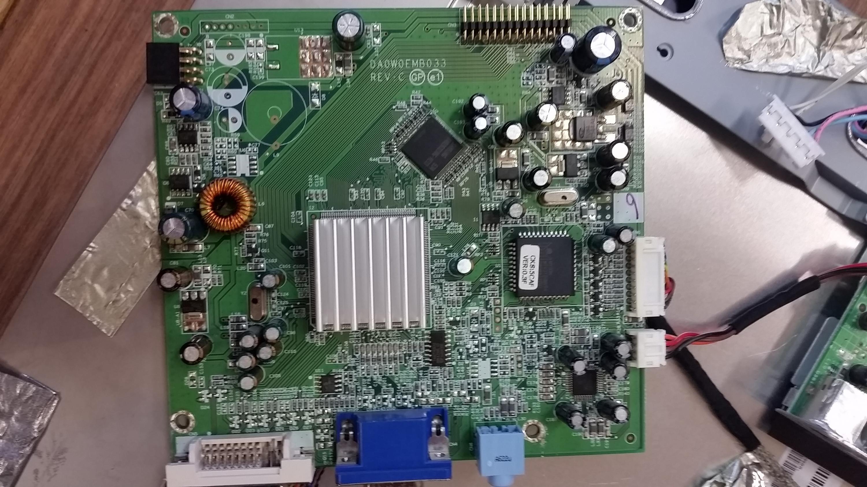

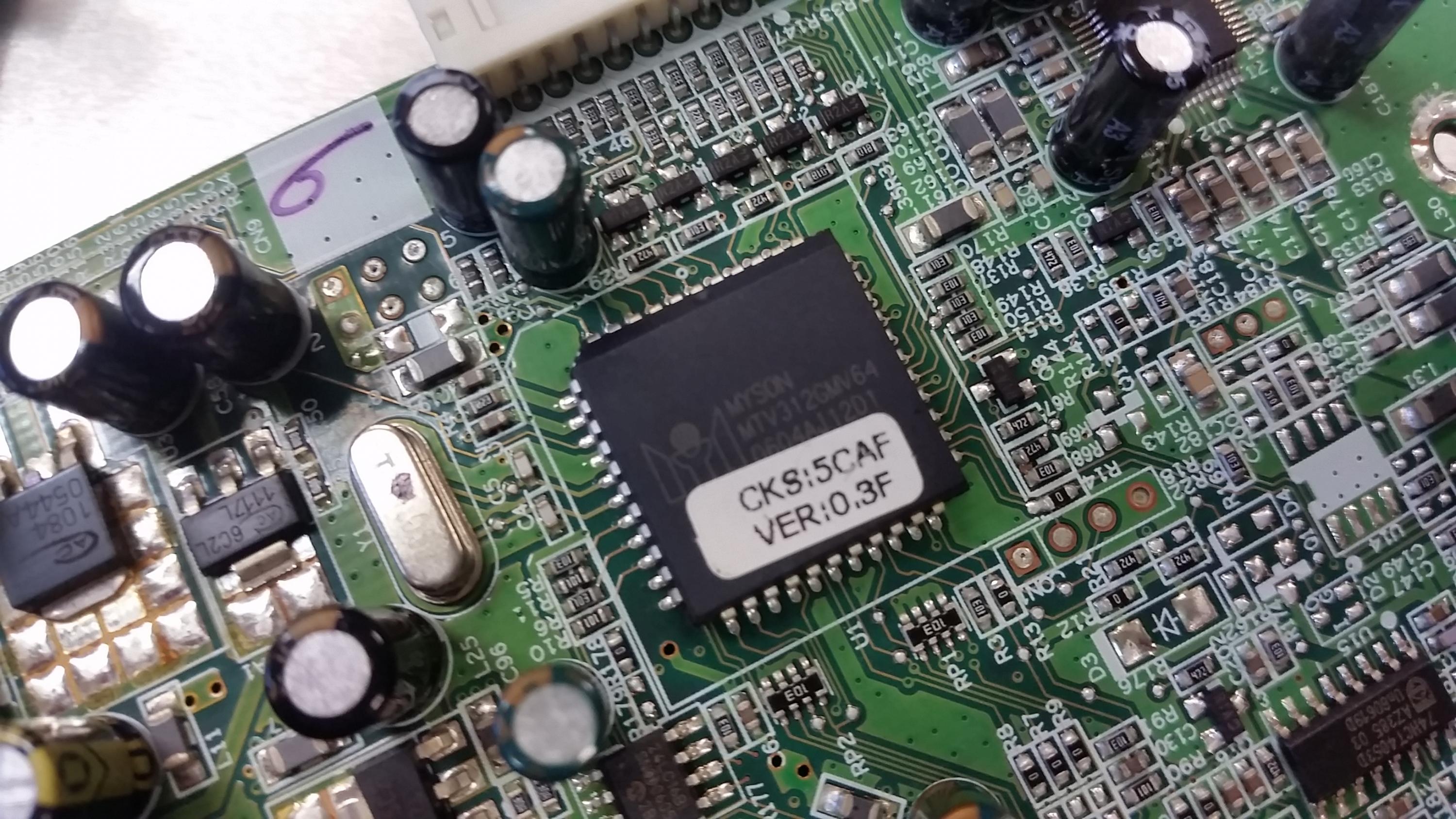

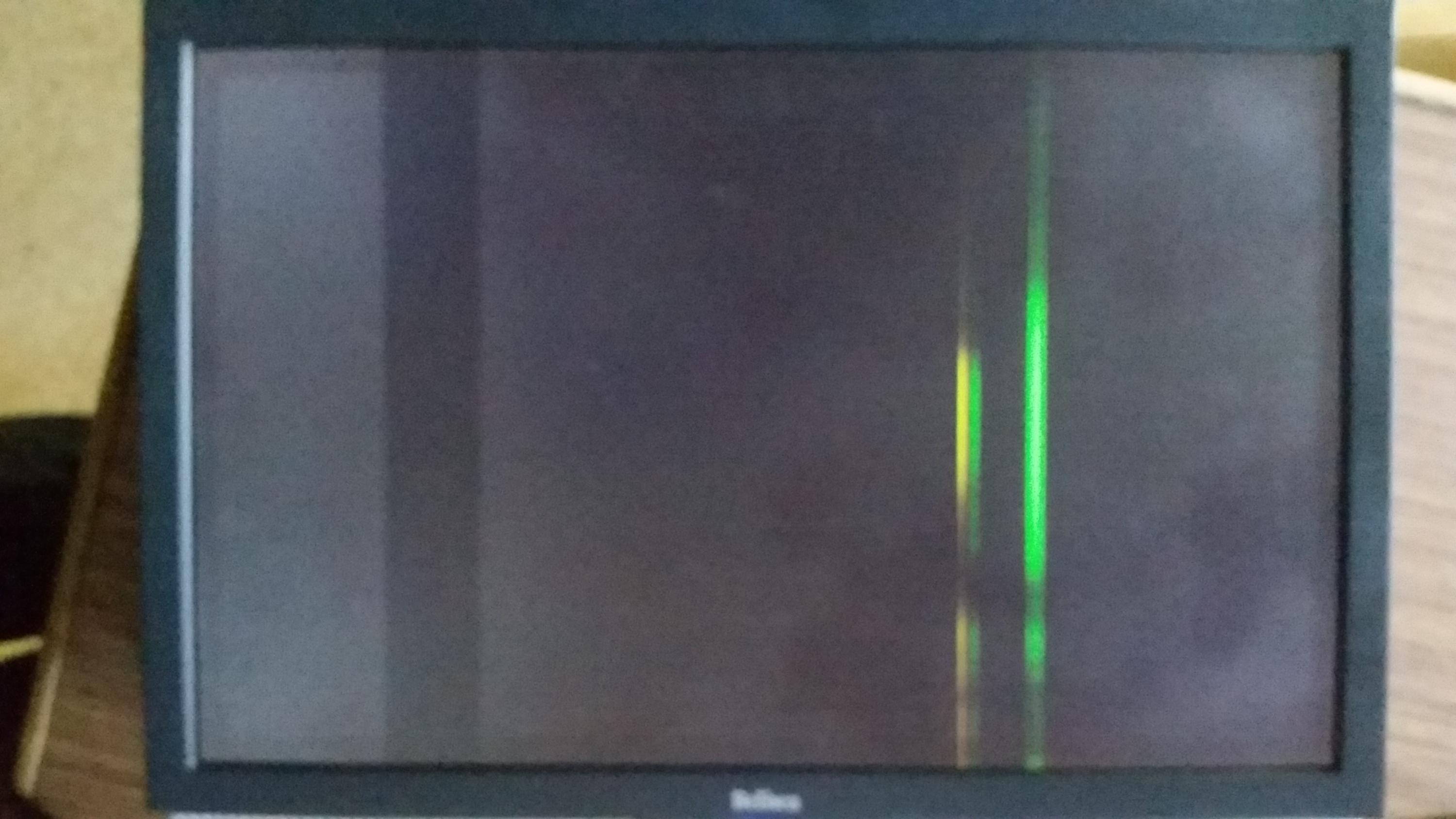

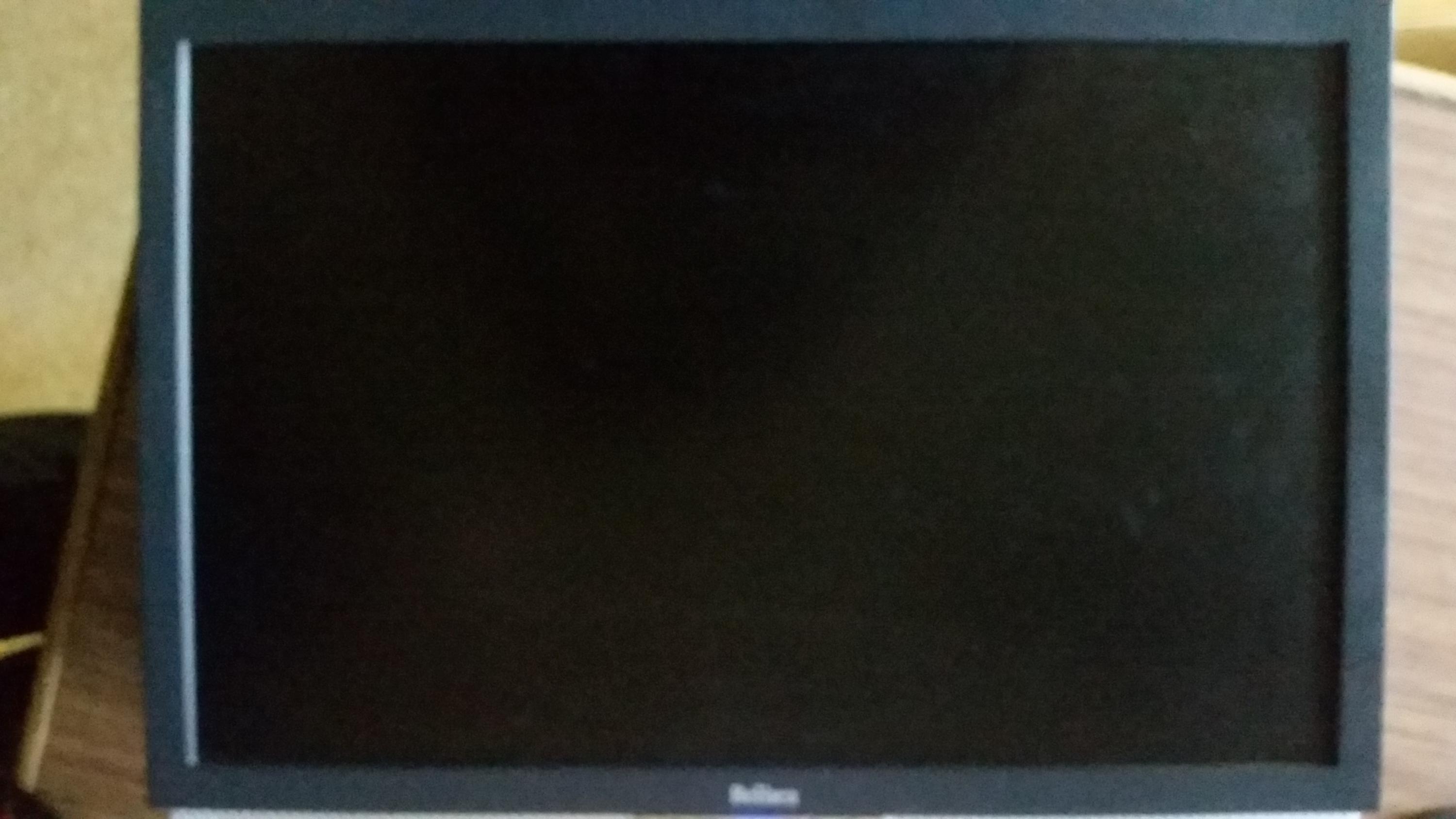

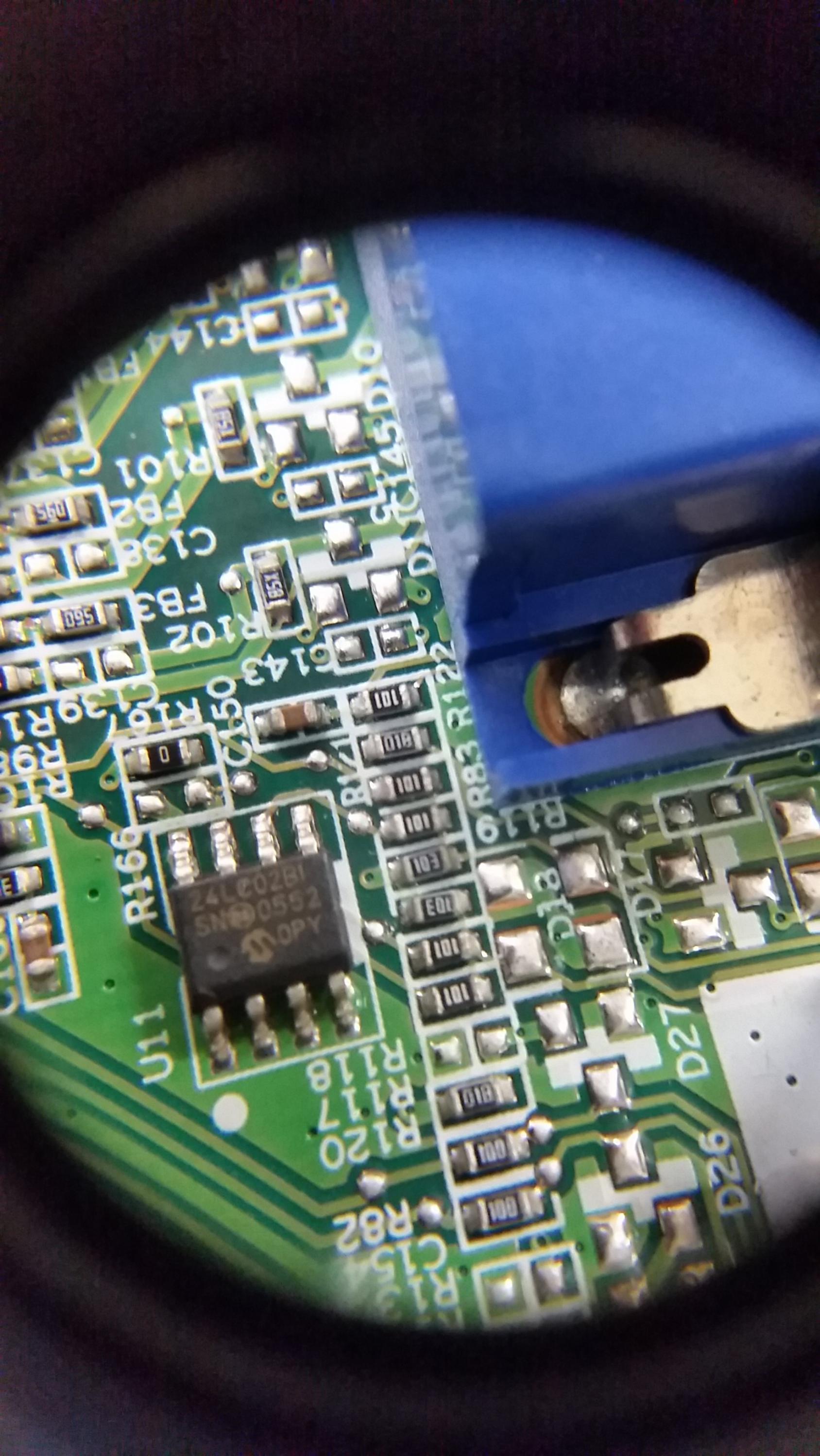

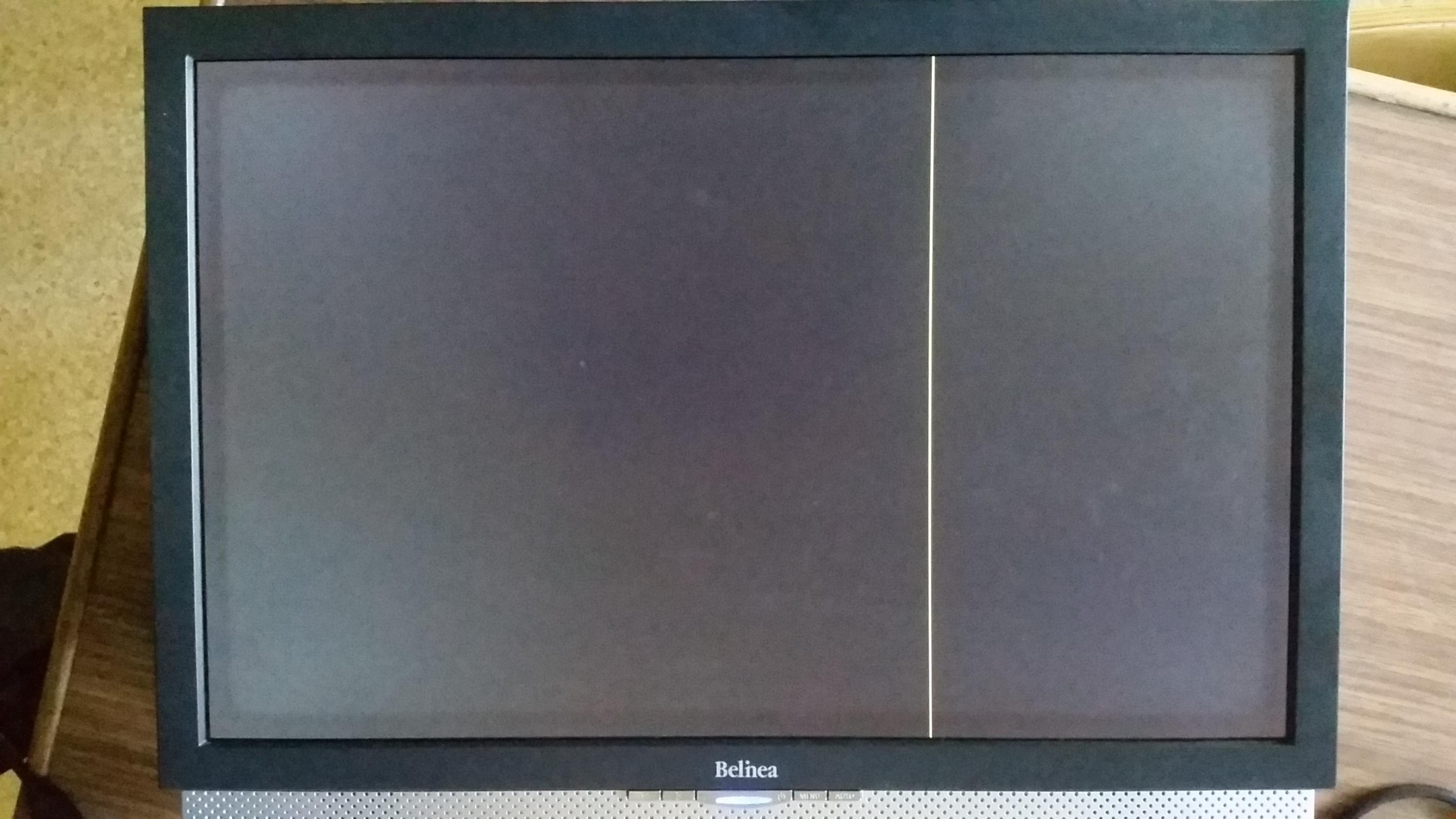

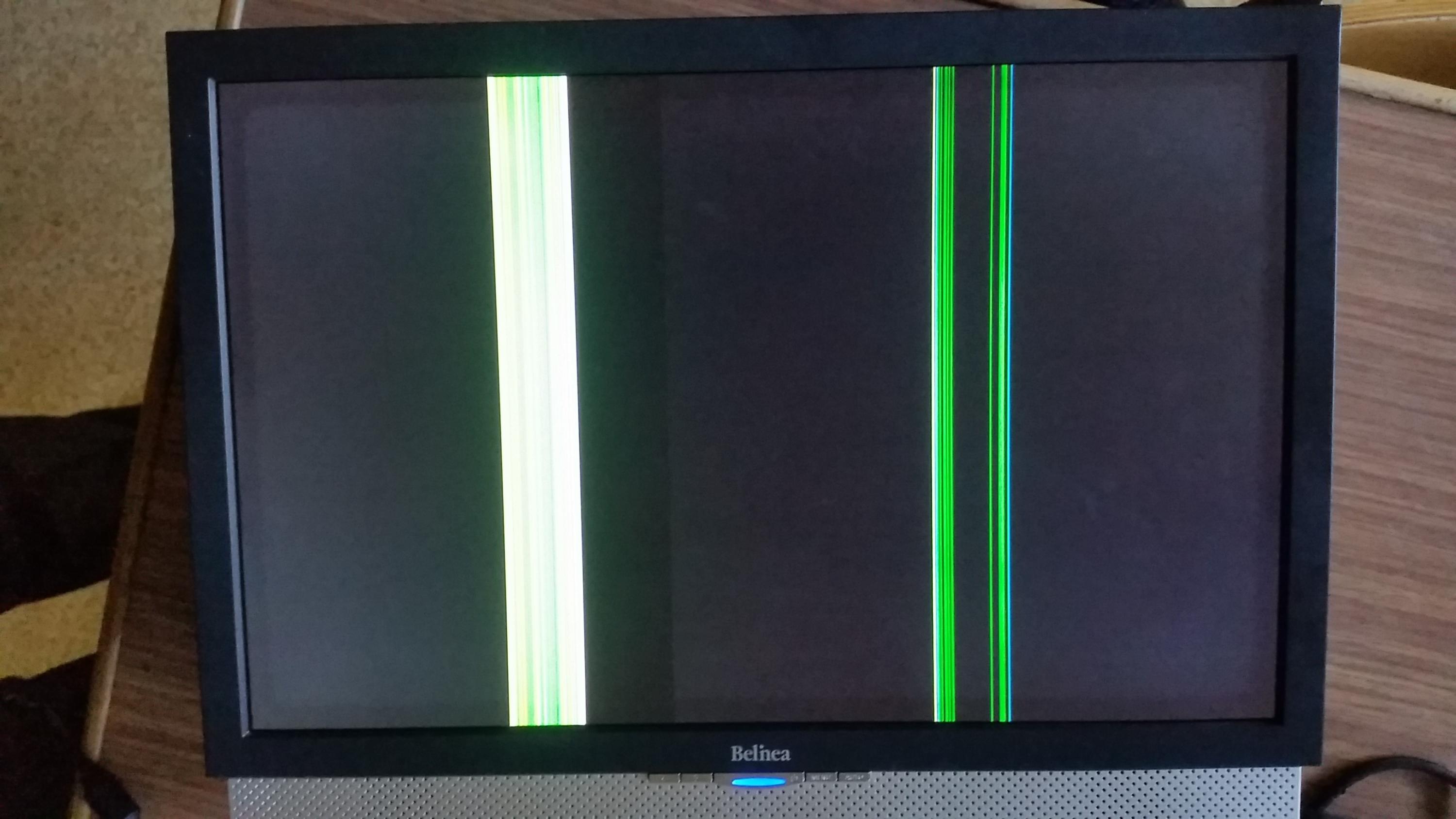

    Hi, I got dead Belinea 102035W display, with no backlight.
    1. I replaced BD9883F chip and backlight started to work.
    But, on the display are strange strips, I'm afraid that maybe EEPROM is bad or something.
    All caps look good, but I didn't test them.

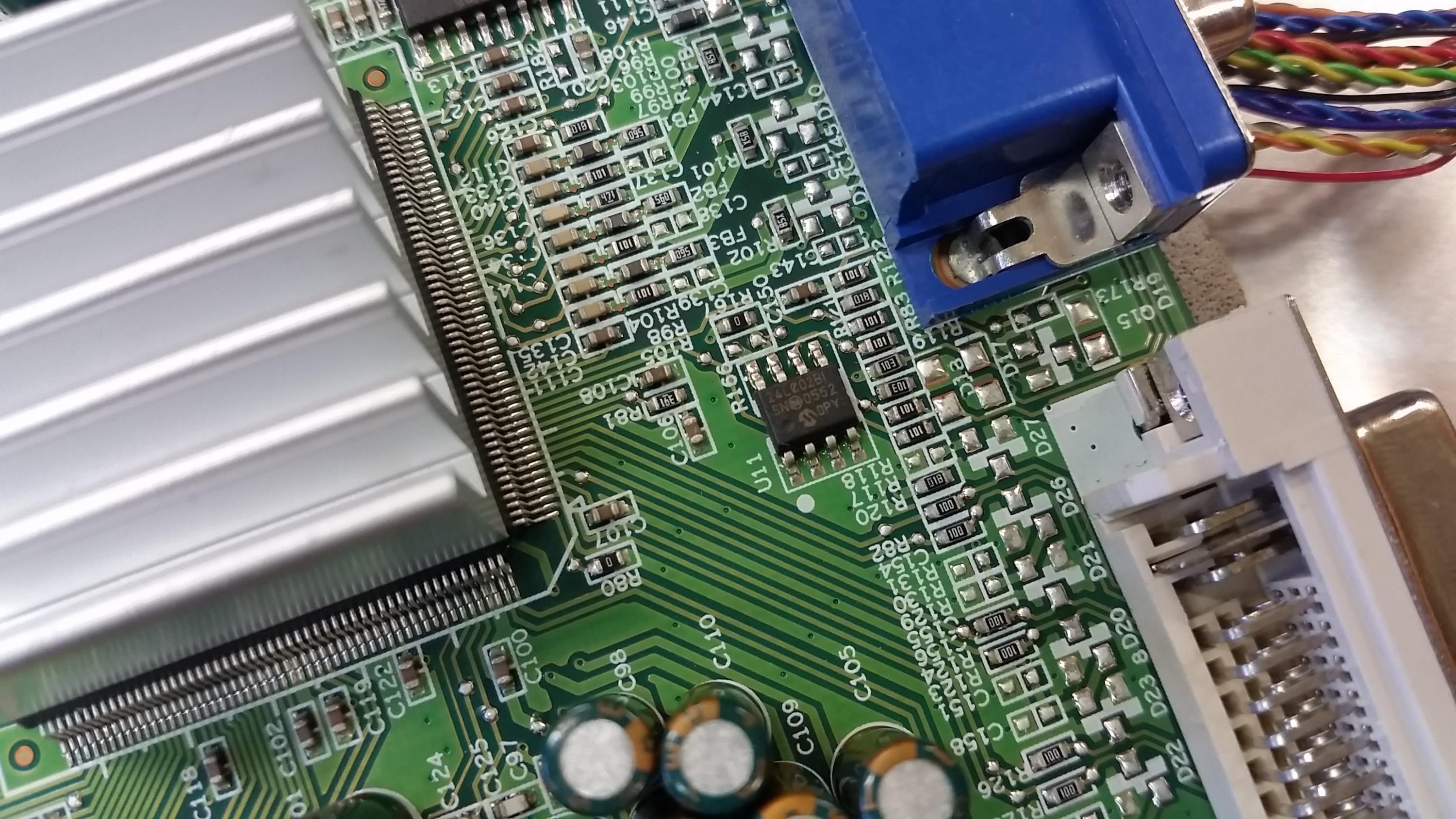

    Here are some photos of totally black display without backligt (off) and some random stuff when I try to turn it on. Also photo of SOP8 EEPROM 24xx chip - maybe someone have EEPROM dump?
    What could be wrong? Any ideas?

    Re: Belinea 102035W - doesn't display properly
    Bad LCD panel.
      What do You mean? LCD isn't cracked or dropped. Or do You mean broken LCD processing PCB? If PCB, then - Yes I know that, it is broken. But what are guesses?
      Trying to measure caps, or my hypothesis is bad EEPROM or some caps maybe.
        Bad tab bonds on panel

          Ok I Got it. Ripped cable inside the LCD itself
            Its the film that connects from the circuit board to the liquid display panel is starting to separate.
            watch this video https://www.youtube.com/watch?v=vCExlSnG4yY
                  there is nothing much you can do to actually fix this, besides replacing the panel.
                      The panel (screen) is no good Ekran nie jest dobre
                      You can't rip anything of without taking the screen apart
