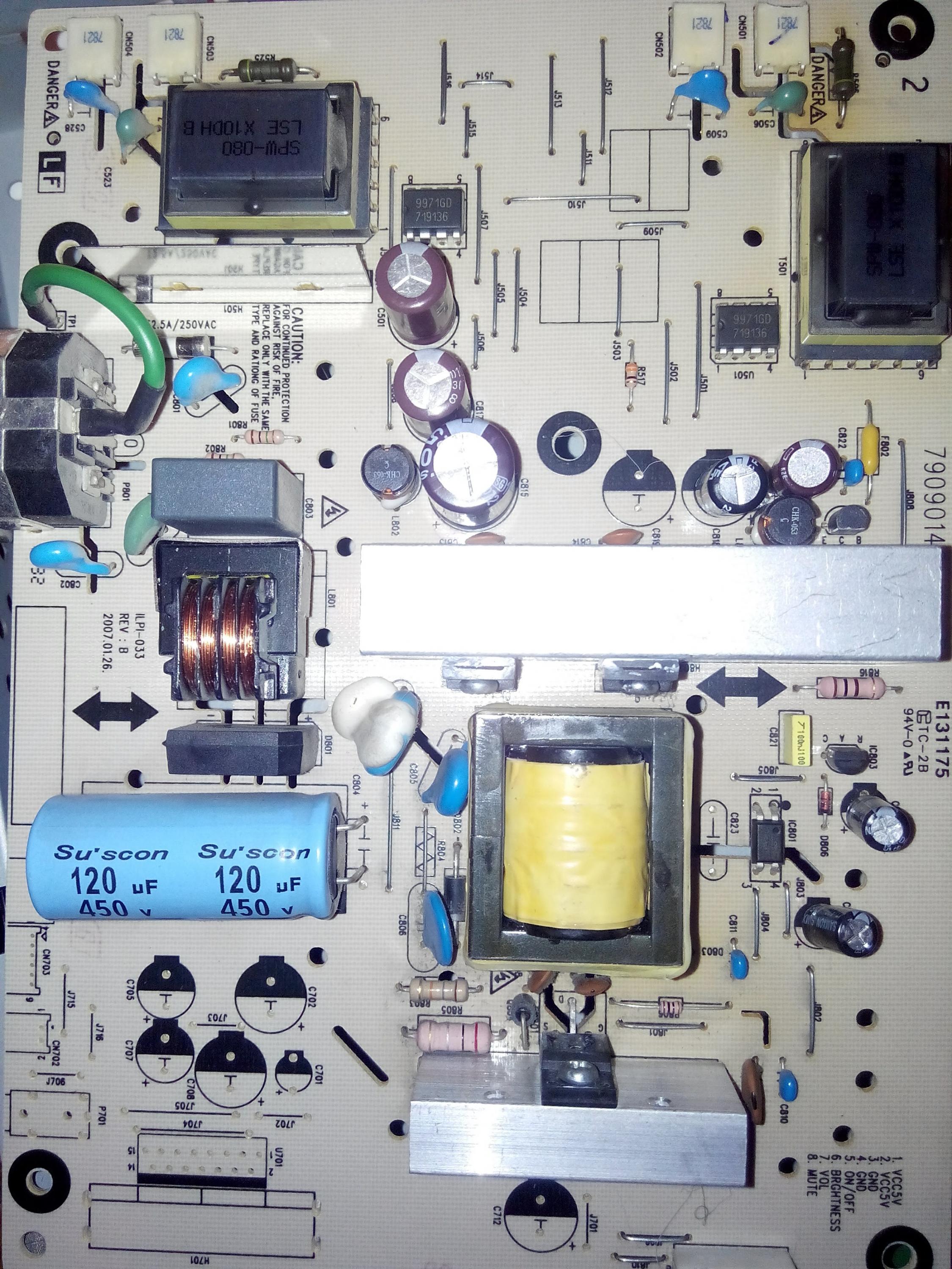

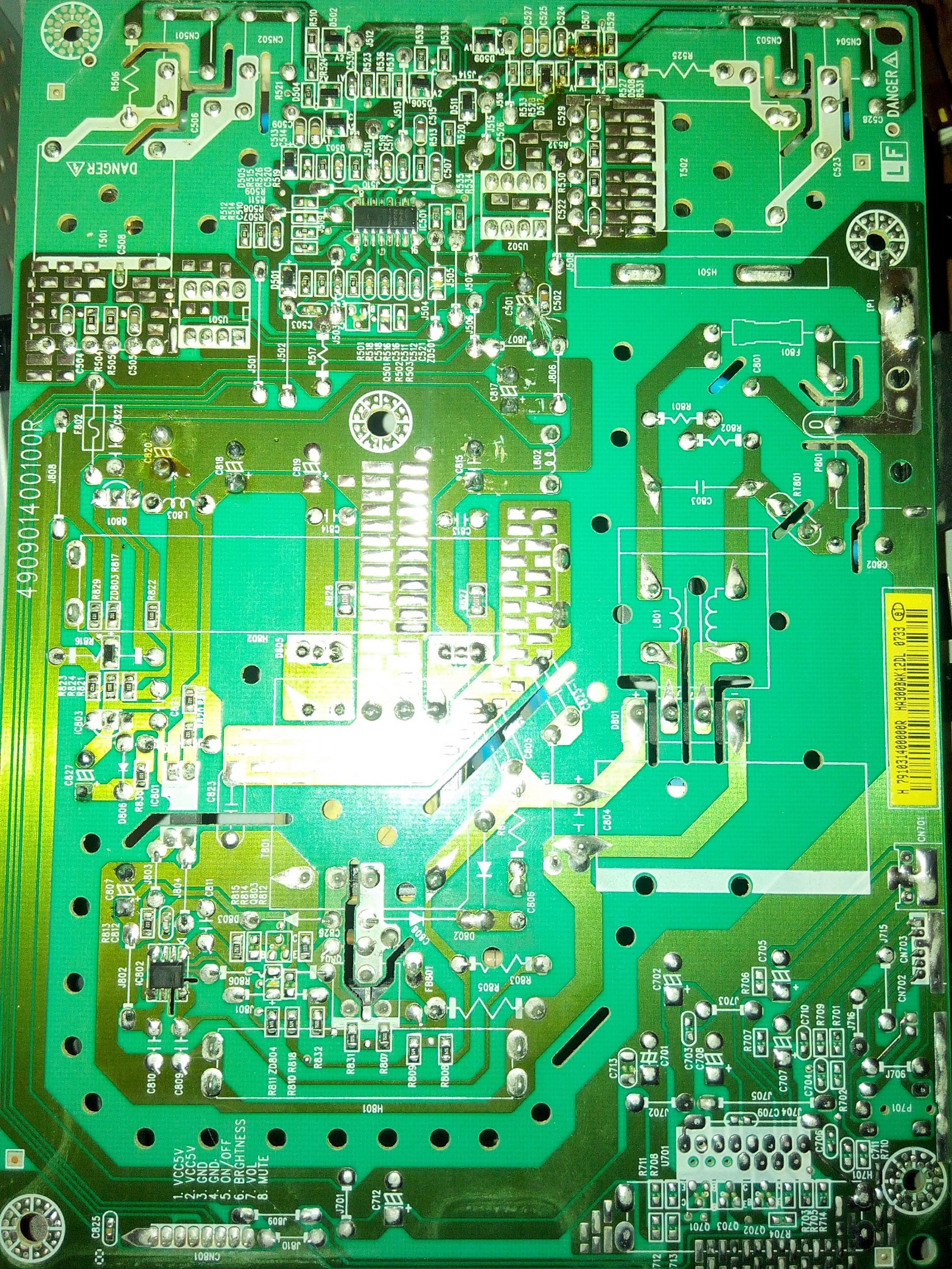

    I've now replaced ALL caps, they were 7-10% off from marked rating (except the 120uF/450v - large blue), board is E131175 - anyone has schematics, or how much output goes on the CCFL driver plugs? I know it should be 600V+, but not seeing that:

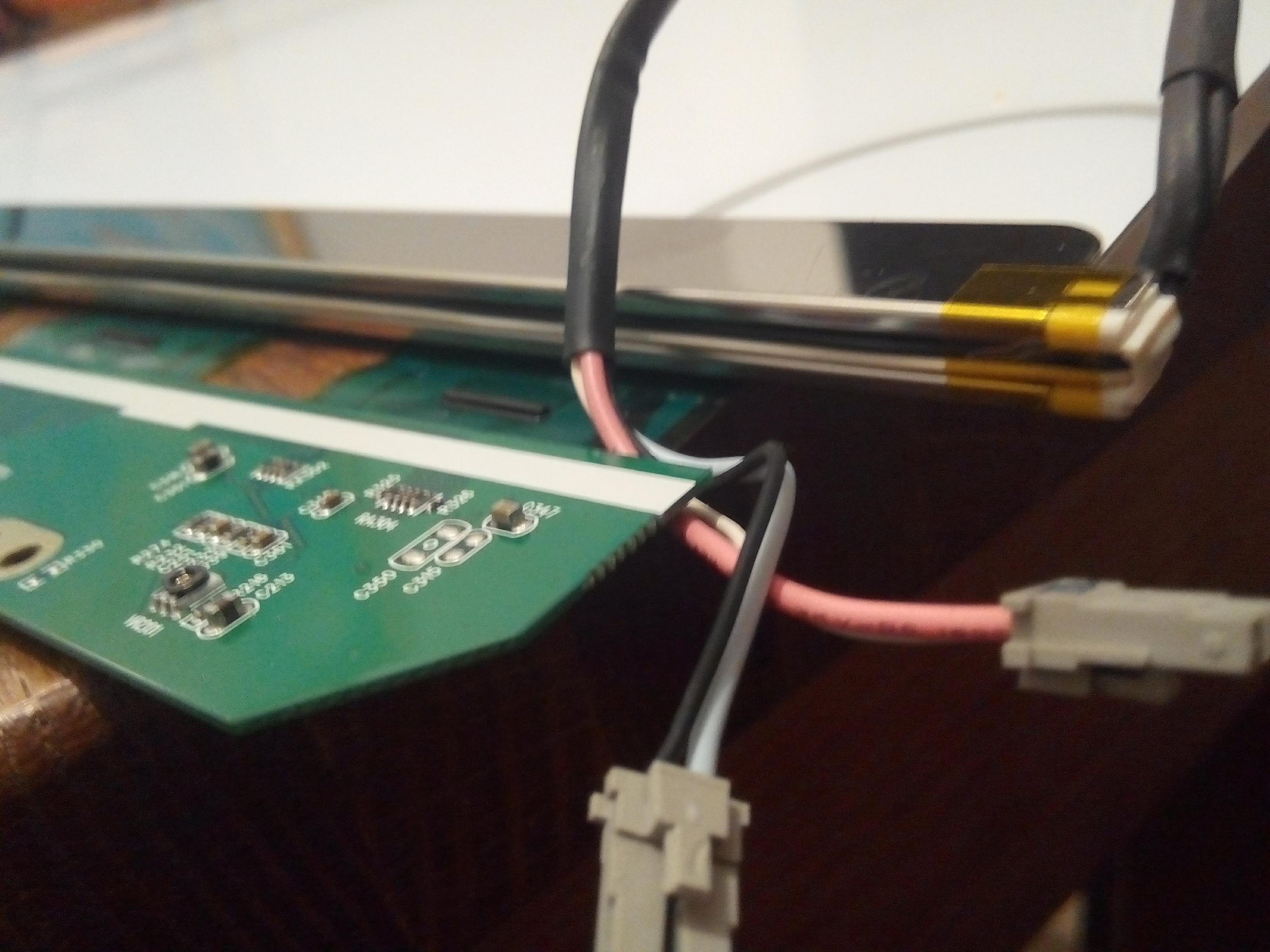

    1) Trying to figure out how to determine if it's the board not putting enough power, OR, the CCFL. Measured on the output connectors that go to the CCFL, and on board each (top in the image), shows ~4VAC, is this OK? I guess it will go much higher once the CCFL is connected properly?

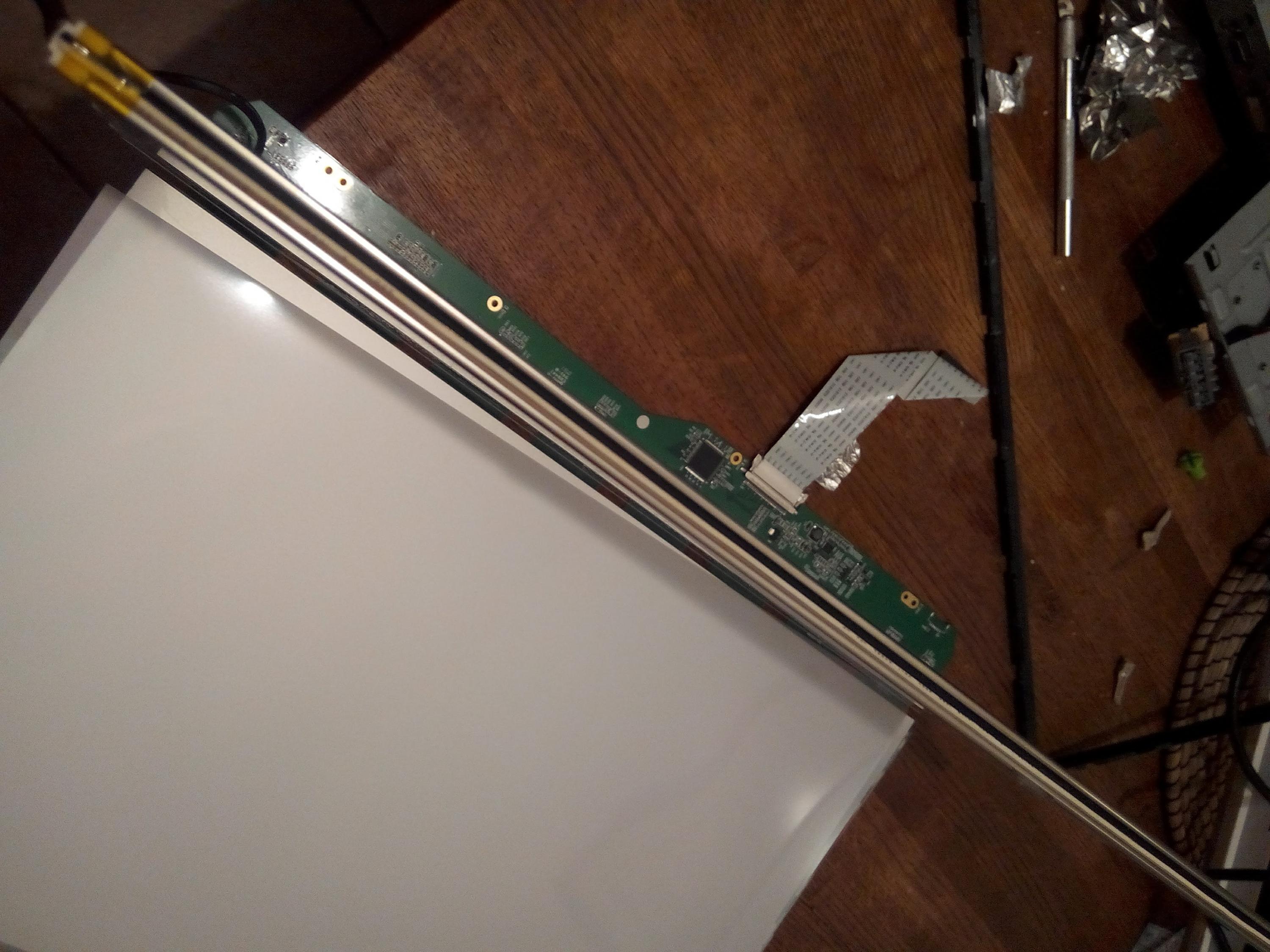

    The CCFL assemblies look nice, see images... Hopefully tomorrow i get more time, and disassemble further to see the CCFL themselves.
    2) Also, tried to drive just ONE set of CCFL, i.e. blue+red cables (bottom of display), same fade to black occurred, and also same thing when the other pair was tested (top of display), each test was individually (thinking less power would make it work), obviously, both tested together produces the fade to black. Is it safe/valid to test just one pair of CCFL?

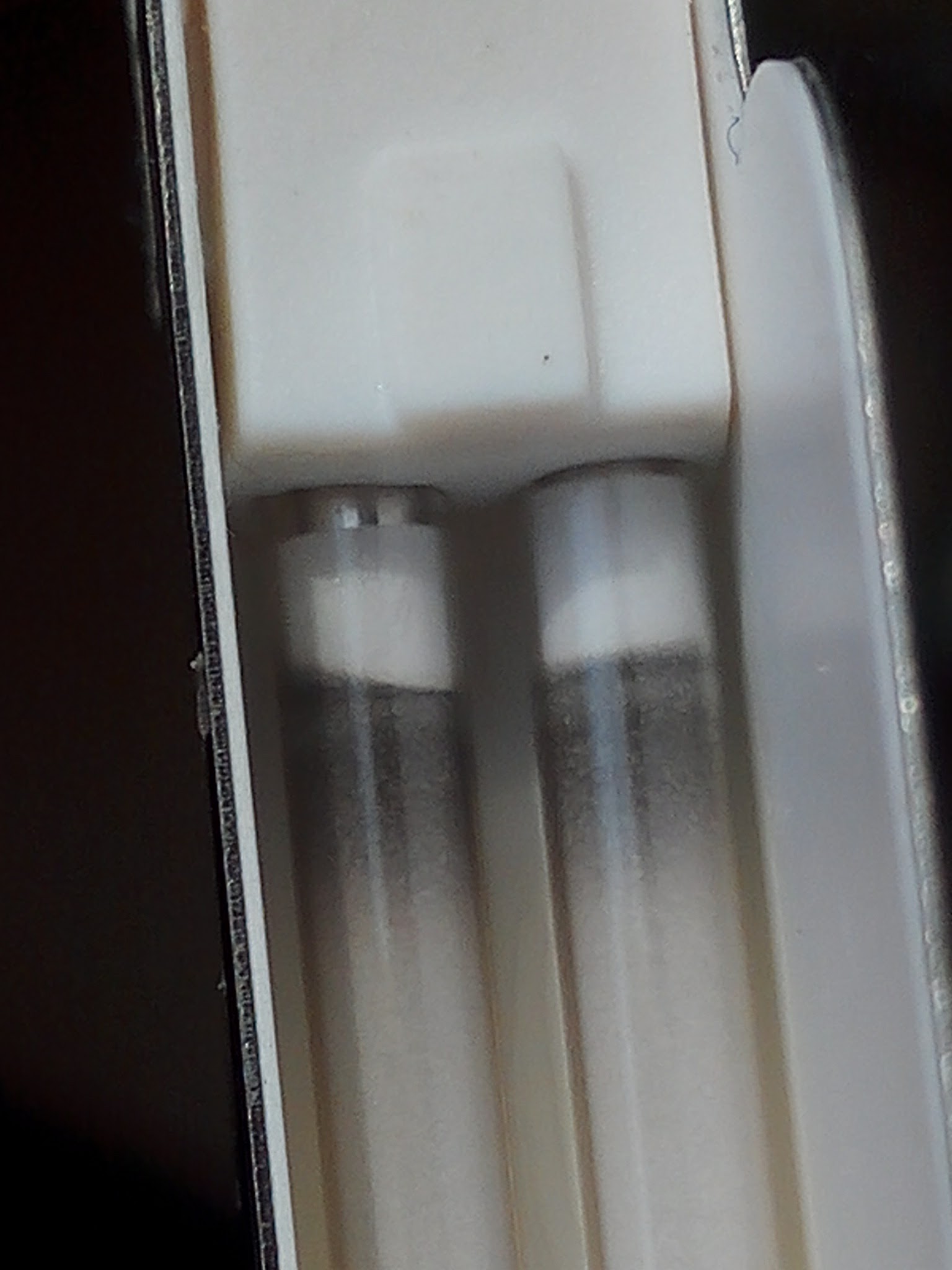

    I do not see the lamps, only the back side the lamps, the ends of the lamps are not blackened?
    The protection circuit will kick in if it does not see all 4 lamps connected, it also detects if one or more lamps draw too much current. It will take only one bad lamp or one not connected lamp to shutdown the circuit.

      ok, I'll keep disassembling this to get to the lamps.. do u know if it is possible to test the OUTPUT on the board, with it plugged in, with a multimeter that is rated 750VCA? i only got 4VCA, that is strange...

        Never try to test the HIGH VOLTAGE/HIGH FREQUENCY AC output feeding the lamps, the firing Voltage to get the lamp to start conducting can be as high as 1500VAC or more, you will destroy your meter.
        I test the board using know good lamps or make test lamps from old CFL: https://www.badcaps.net/forum/showthread.php?t=19987

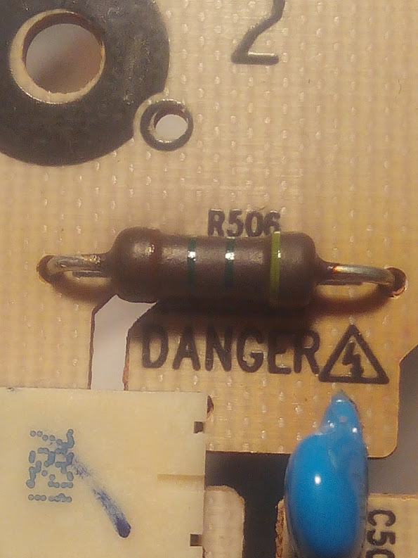

        Blue Ballast cap c506 looks cooked with light tan color, the resistor next to it also got hot.
        You will also need to test the resistance of the high Voltage windings of those two inverter transformer.

          Thanks for that info!!!!! I naively assumed that since C523 & C506 both appear in symmetrical places, and both are "green", that is normal but now realize both should actually be BLUE..
          How do i get their RATINGS, I don't see any markings it was all faded. tried searching for circuit plan online but have not found anything yet.
          the blue caps NEXT to the green ones read: N3 3KV SEC (so 3nF, 3000V)

          Regarding the Resistors next to these blue caps, both at R506 & R525 read 1.47MOhm in-circuit. so I think they are OK? or.. both bad

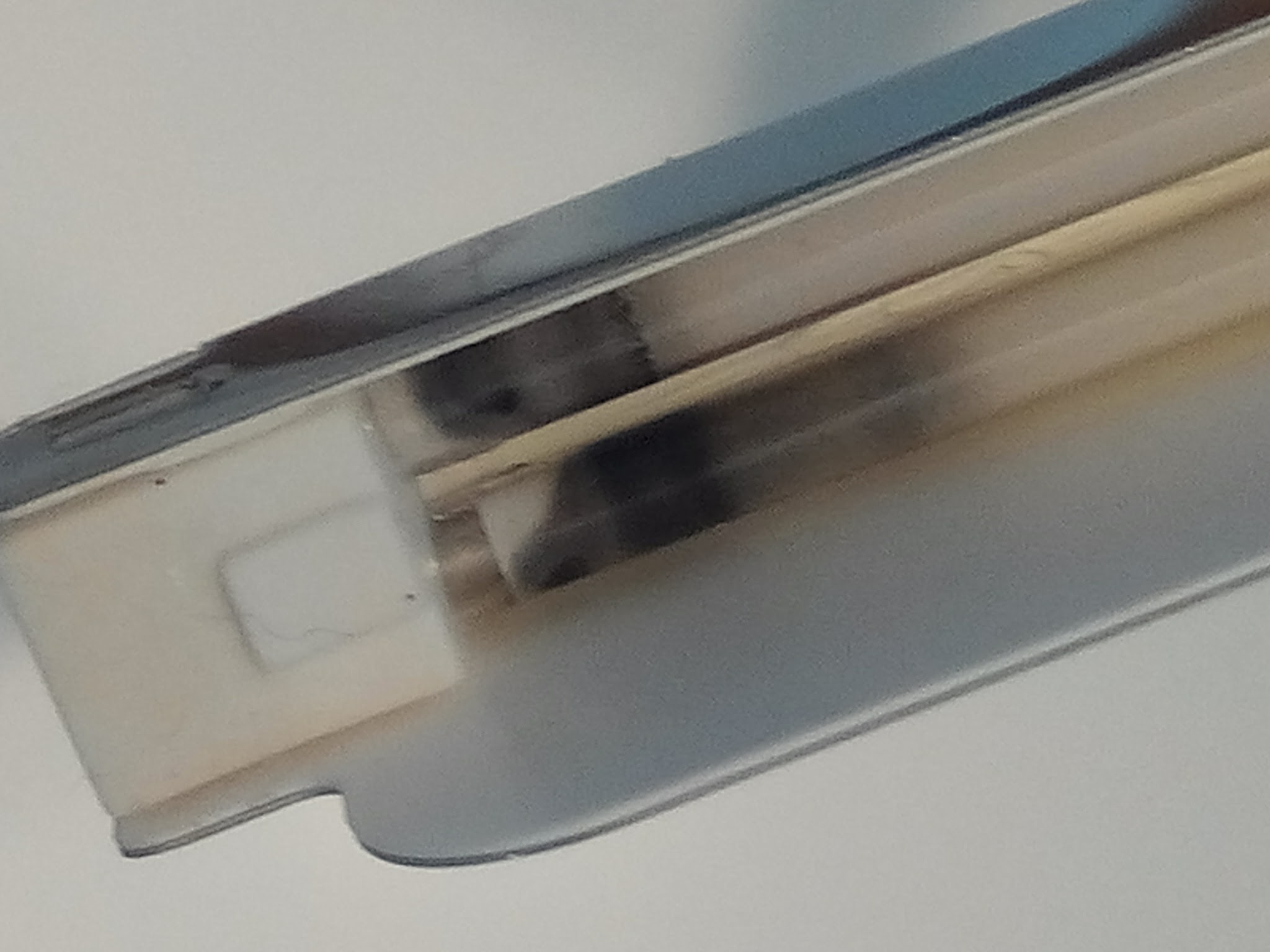

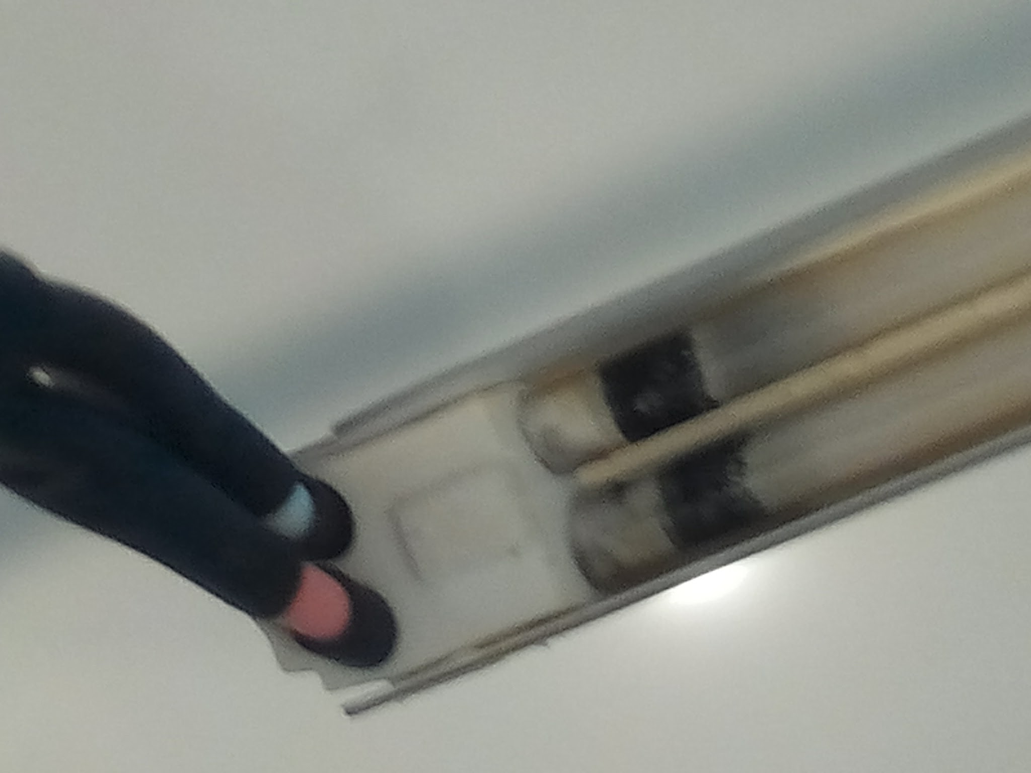

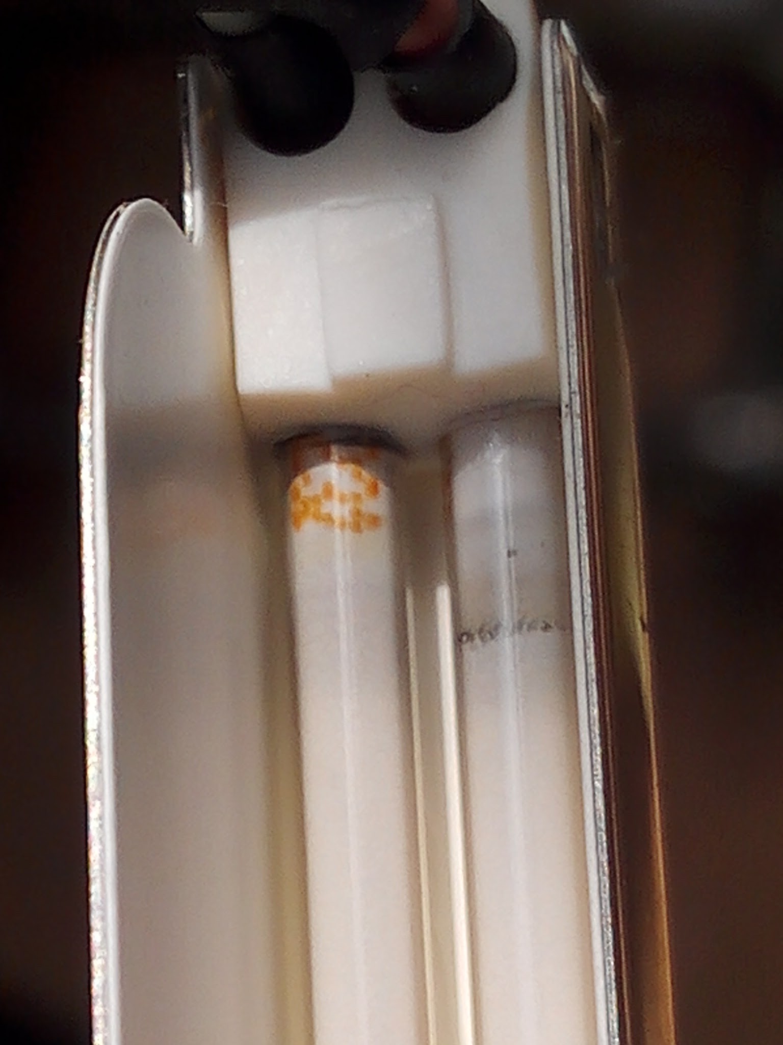

            Took apart the CCFL assembly, and it seems they are bad, see 4 photos showing the edges, black and rusty in places....
            This is 22", so guess I need: 483mm *2.4mm CCFL.. and replace all 4...

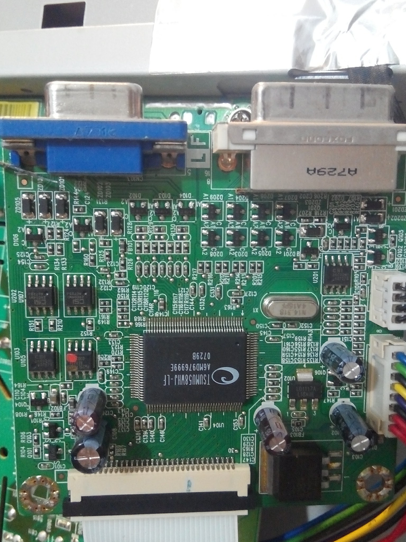

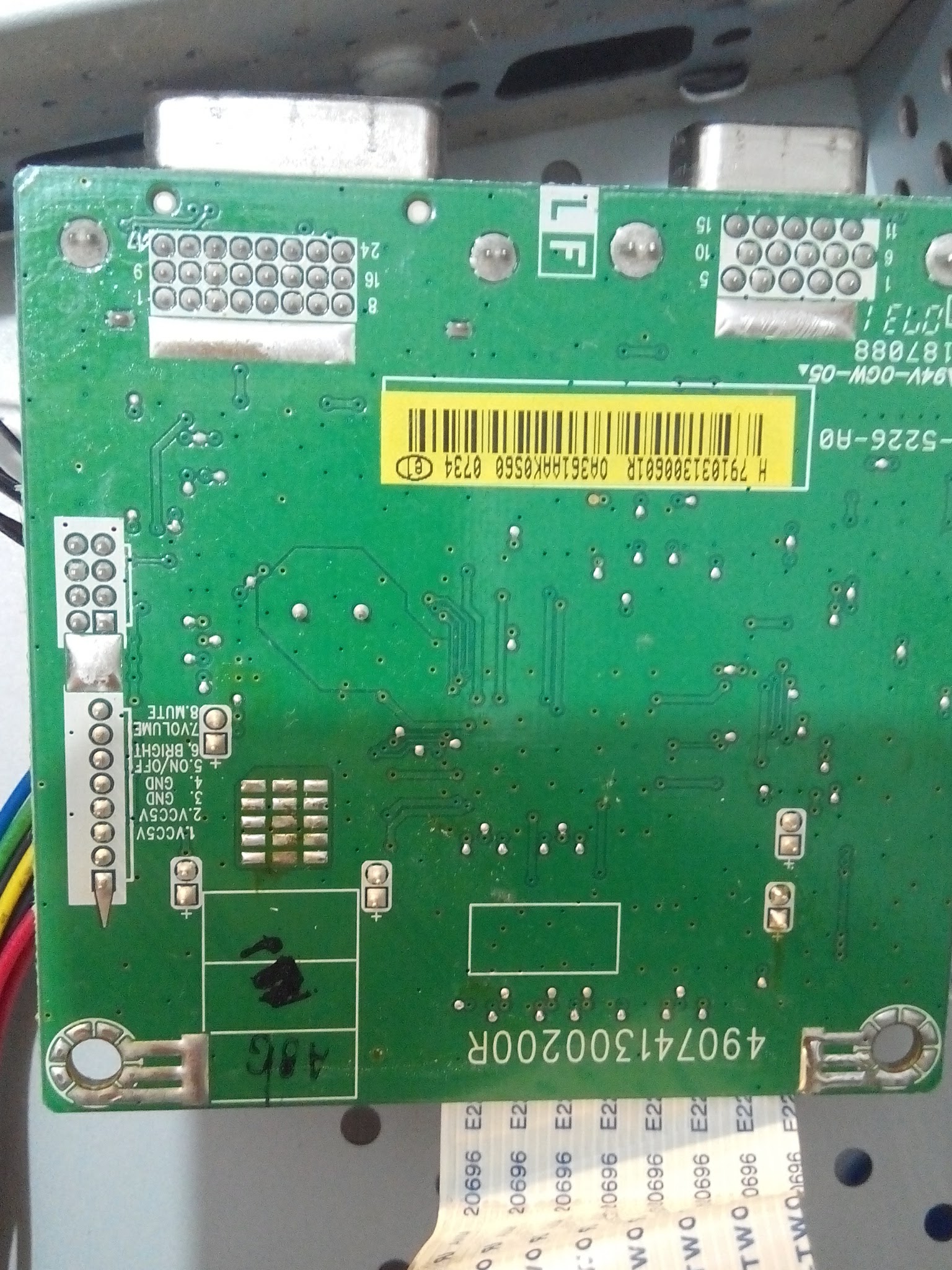

              Found many kits and most of the LED kits call for 9V or 12V, but as far as I can see, my power-board (main) has 5V, didn't see 12. Also the controller-board (smaller, photo attached), has the same 5V.. Questions:
              1) Can I get 9v or 12v from the main board somehow? or should i search move to find an LED that is driven by 5V board, will that be bright enough?
              2) Once this is working can someone tell which capacitors can be removed from the main board b/c the AC invertor won't be used at that point. So they don't heat up, or waste power?
              Thanks.

                1) got new CCFL bulbs, replaced all 4, tested outside each bulb separately, all holds light for 1 minute, no issues.. when connected to board, same issue, turns on but ~2 seconds to black all lamps.
                2) Pulled R506 next to C506, and measured 1.475MOhm, based on: https://www.allaboutcircuits.com/too...de-calculator/, BROWN, GREEN, GREEN, GOLD, it is 1.5M, so within margin of error.
