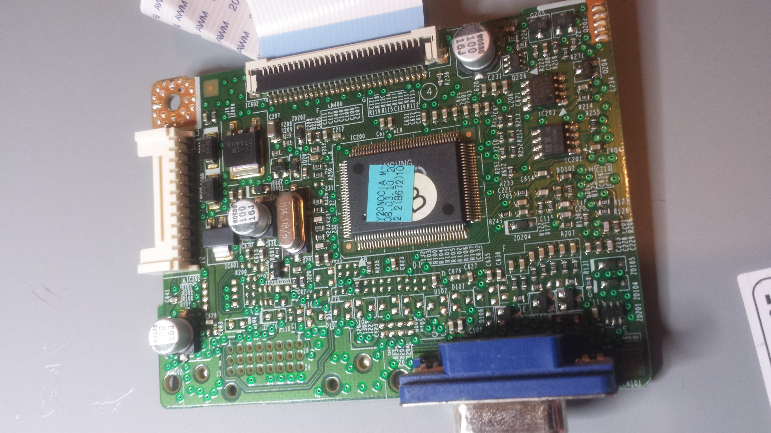

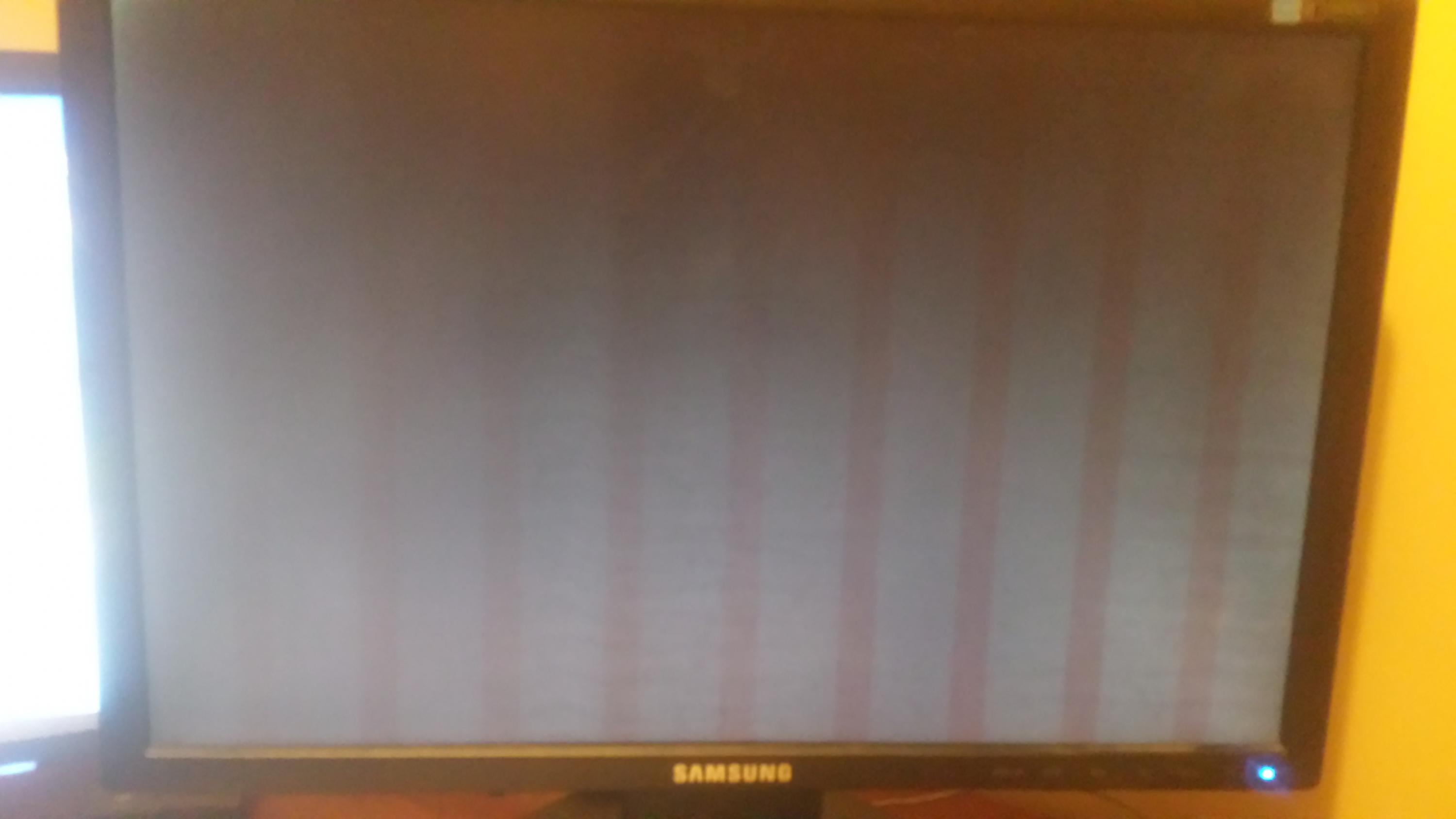

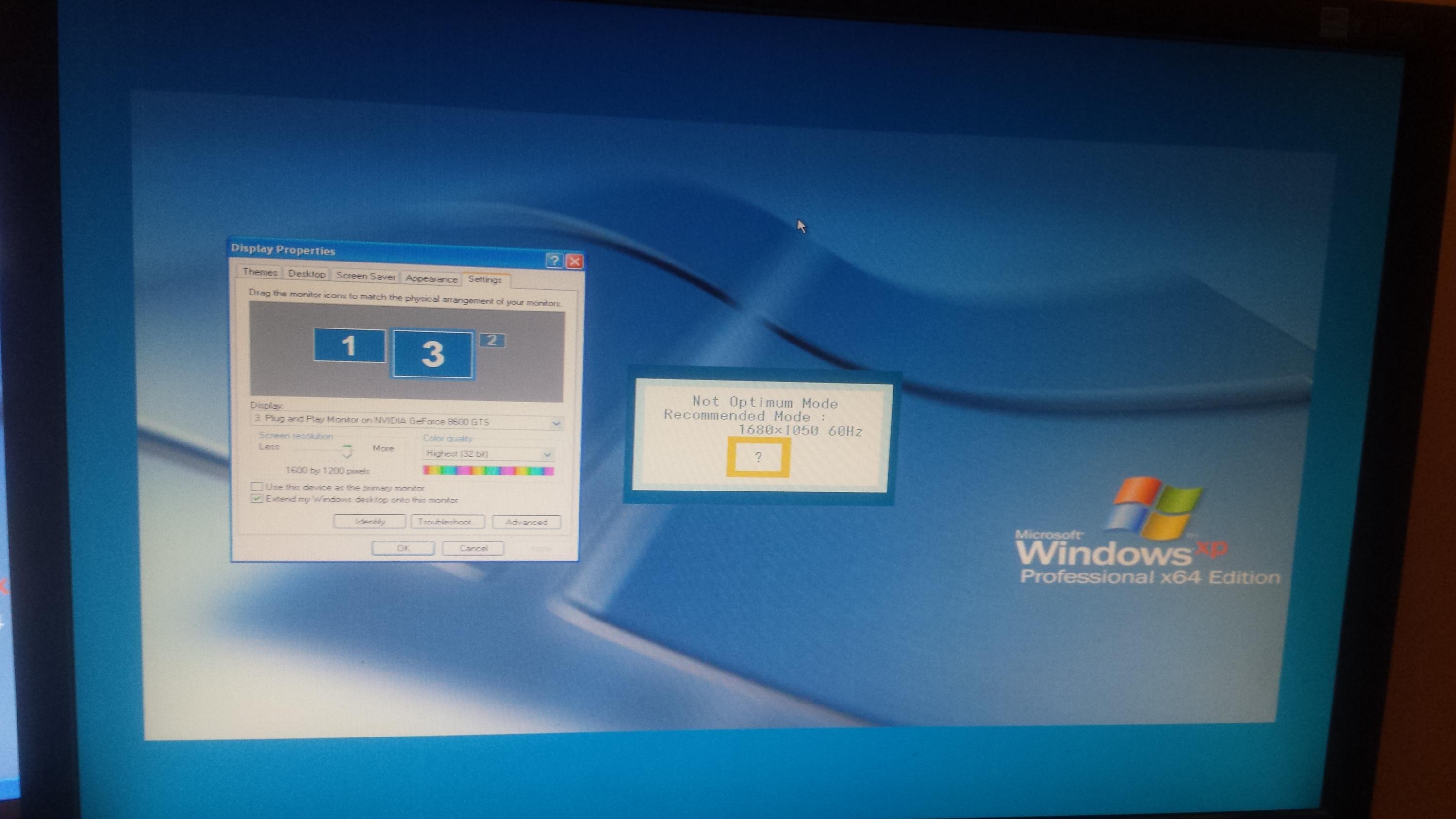

    Hey guys I have a Samsung 2043NW LCD that is showing some strange problems. When I set the monitor to 1600x1200 it works just fine apart from the lower resolution. No flicker at all. When I switch the setting to the recommended 1680x1050 it has a black screen with some strange bars and slowly bleeds to being completely black.

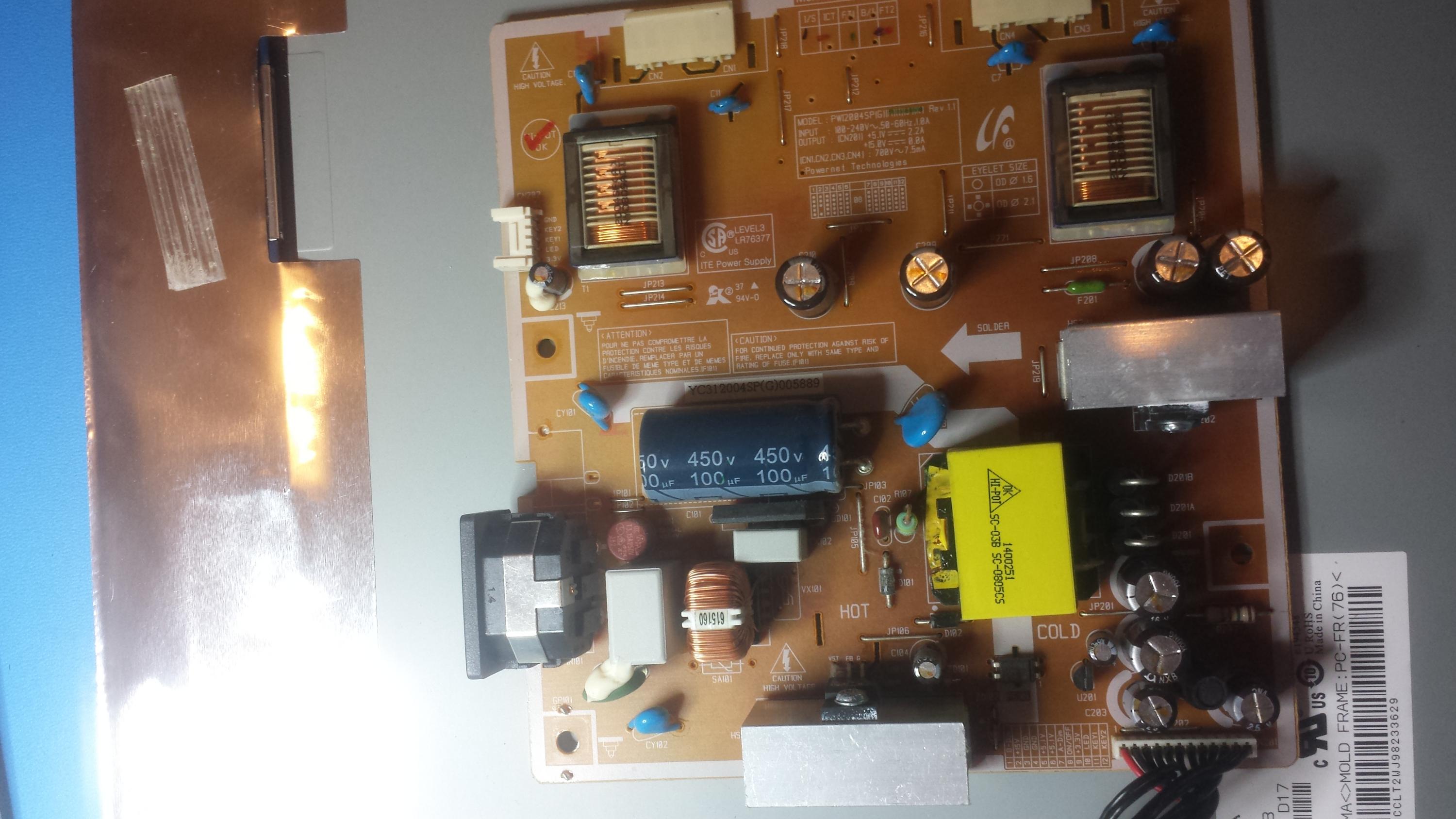

    I know that the computer and cable are fine because when I plug another monitor in and set it to 1680x1050 it works beautifully. I looked at the power supply board and none of the caps are bulged.
    This is something I have never seen before. Any ideas on what would cause it to work fine in the resolution lower but not on the recommended resolution?

    I would try replacing those 3 lytics caps on the main board.
    BTW, am I seeing brown stains on top of those lytics caps on the bottom right of the power supply board next to the white connector?.
      • 31255
      Re: Samsung 2043NW Strange Issue with High Resolutions
      there are marks on ones without a vent, i think it's just marker pen.
      i'd change them anyway though.

        Yeah it's just the marker they use at the factory. I'll change them and see what happens.

          Tried replacing all of the caps and the problem is exactly the same. When trying to display a high resolution I can hear a faint screeching coming from the circuit board that travels along the top of the LCD.
