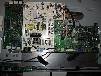

    hp f2105 slow screen
    Hi just received a hp f2105 from my son. It powers up with full screen but the desktop is showing vertical lines from top to bottom where there is an icon even the mouse. When I move the mouse it is very slow re-acting and leaves a tail? The faster I move it the longer the tail? All action on the screen is very slow? Can someone tell me what would cause this.

    Re: hp f2105 slow screen
    Try a different monitor so you know it isn't a video card problem.
    If it was only lines I'd say the monitor but with those other things going on you should make sure it's not the card.
        I think what is going on is the refresh rate has slowed down.
        That's what updates the screen when something changes.
        The cause could be a number of things.
        Bad Caps, bad soldering, bad transistor or IC chip.
        Even a corrupt firmware or just a loose connector.
        I'm not a guru when it comes to video.
        I'm just trying to help some until one of those happens along.
        Off the top of my head davmax is very good at this sort of thing.
        Look him up with user search and send him a PM. See if he has time to help.
        In the mean time it's obviously inside the screen.
        I suggest disassembly and inspection for obvious problems.

          Thanks I checked for loose connections but didn't find any The caps look good but I know that dosen't mean much. Where can I download firmware for this model? I disassembled the thing but didn't see anything obvious. I was hoping that someone like davmax would drop by sooner or later.

            Could this problem be caused by the video board? Looking at the caps on that board they all look good but 14 of them are Lelon caps. known bad. 3 are jamison and 2 elite!!
              I have had bad BAD experiences with Elite in LCD's.
              Other people have similar complaints about about the other two. (Especially Lelon)
              There is a fair chance just replacing those caps will fix it.
              It's not for sure of course. Just a reasonable change.

                        Finally received the caps off ebay and replaced the 14 on the video board but the problem with the refresh rate still exist. I can however access the OSM which I could not do before.

                                        I finally got back at this monitor. I have now replaced all the caps in two of the four boards (that were all elite caps) with no results. I did find a loose connection at the main plug connection (120v) and re soldered but did not make any difference. Not sure what to try next. here is a photo of the boards I think??. My first post with attachment??
