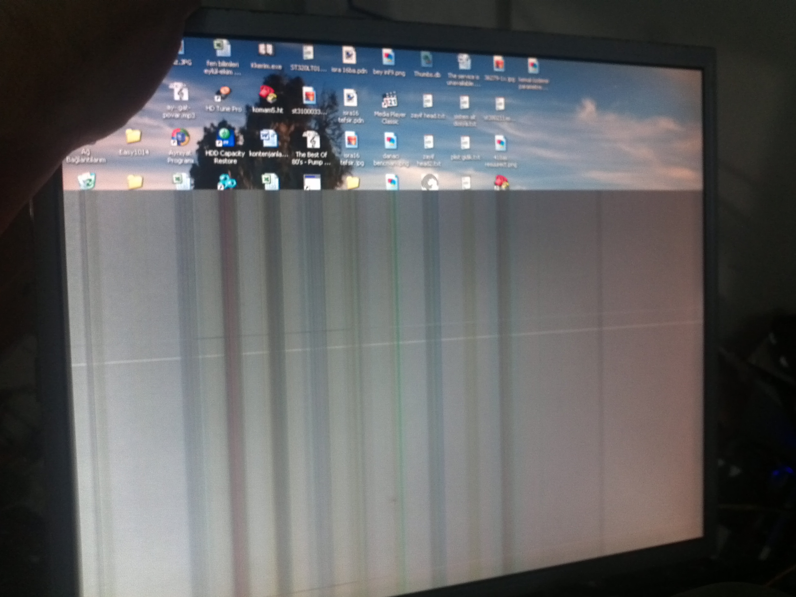

    LCD Panel Problem of Philips 170C
    Logic boards also had 3 bulging caps that i swapped.
    Problem continues.
    also LCD stayed in moisture for a long time..
    Why?

    Re: LCD Panel Problem of Philips 170C
    becuse of:
    1. flat cable to panel and sucket problem
    2.T-con board problem
    3.panel problem
      It did not issue another panel
      this is absolutely panel problem.
      is it possible to repair panel?
      Which cause of this? film or pcb of panel?
        i think film have problem.you can push top of T-con board for any change in picture.
