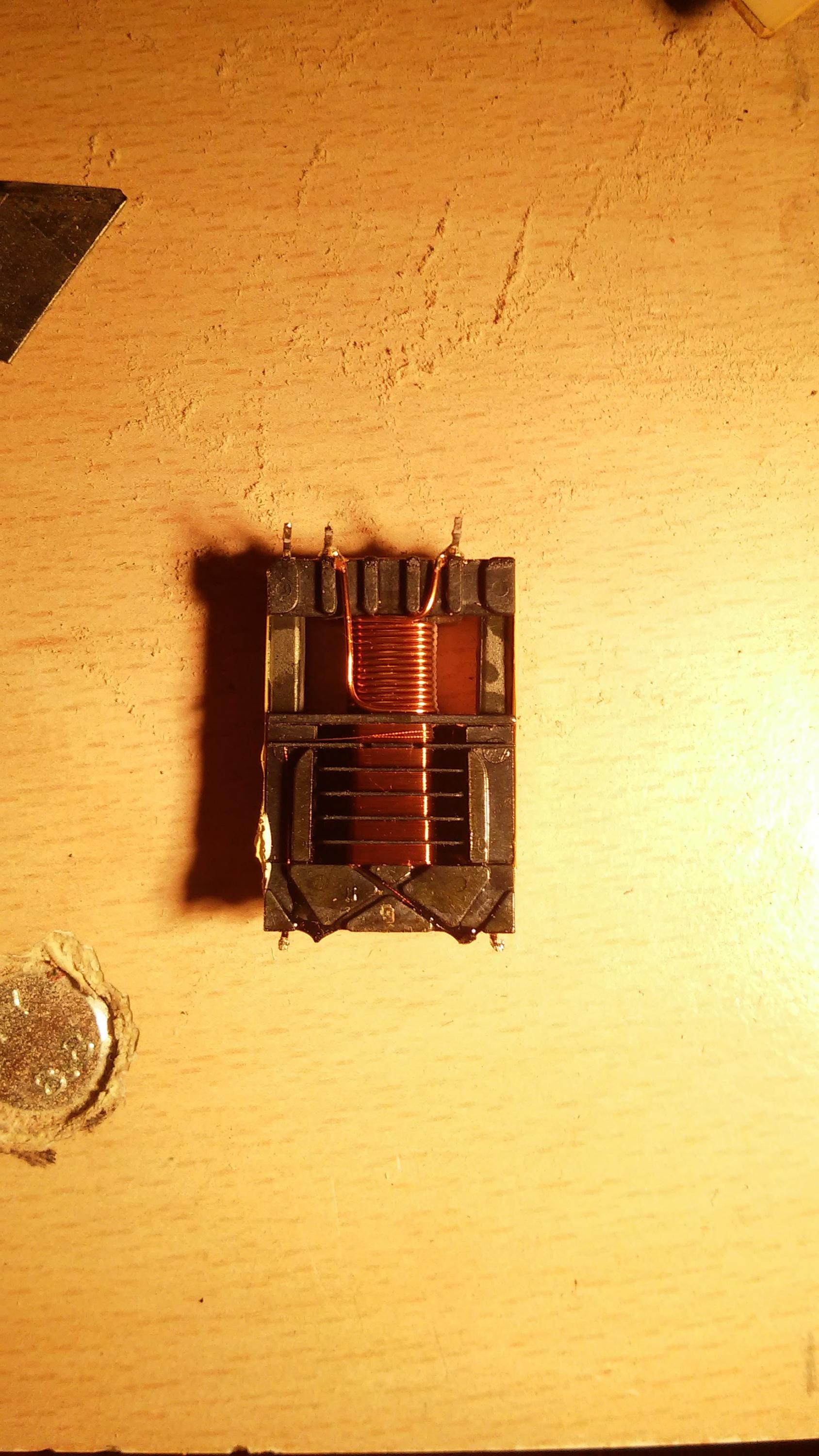

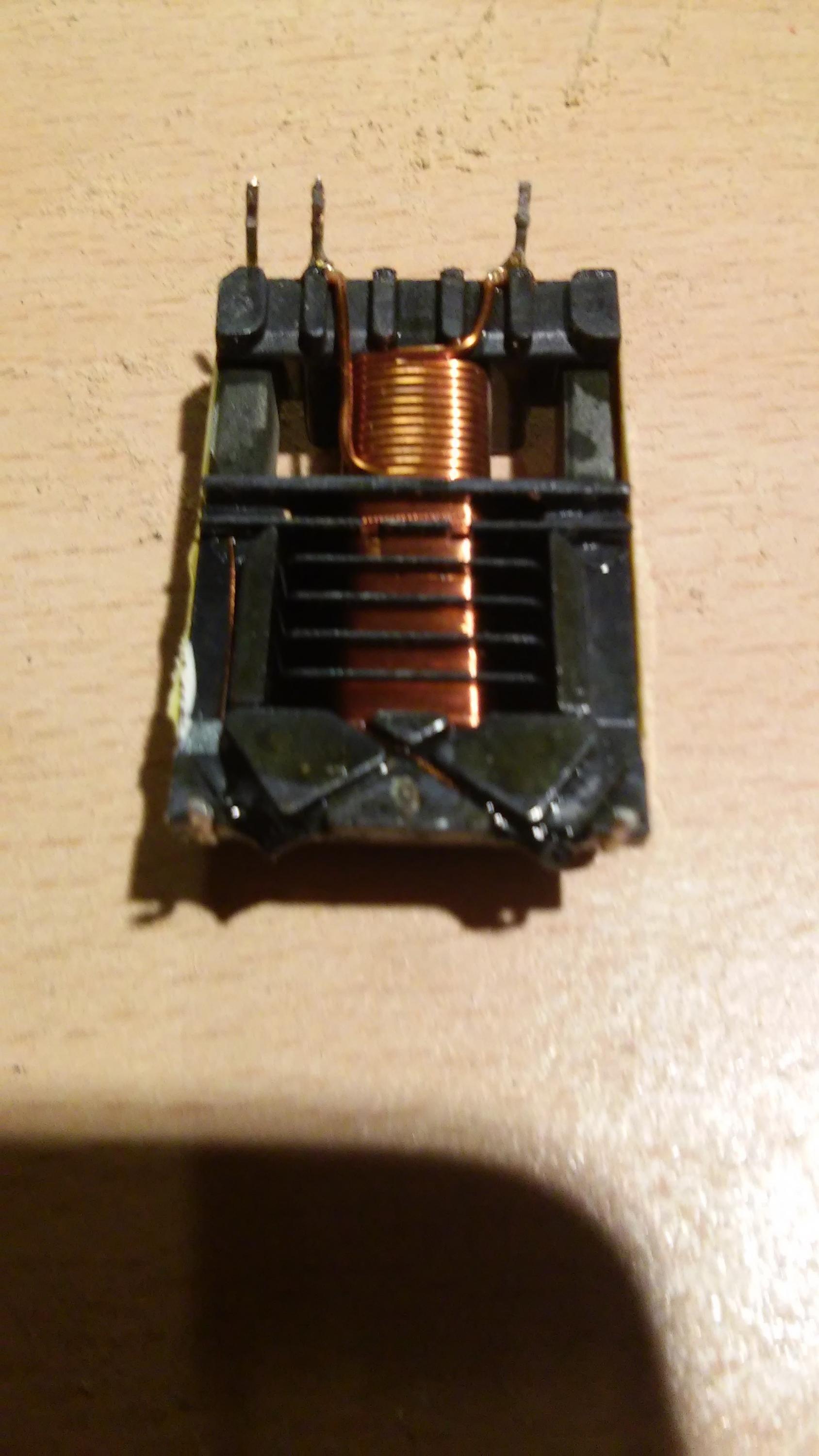

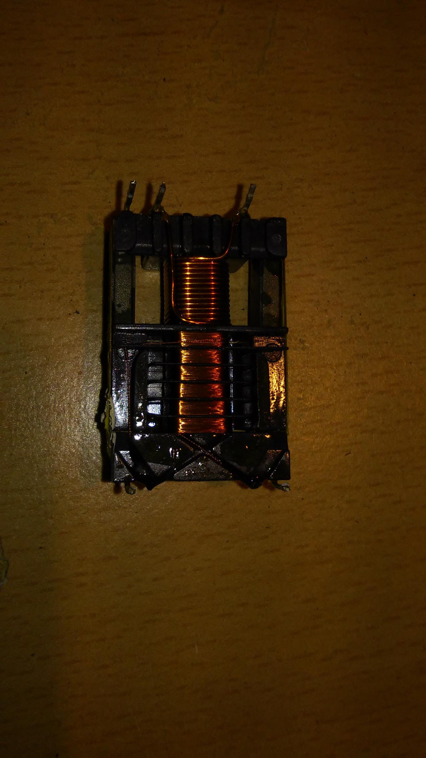

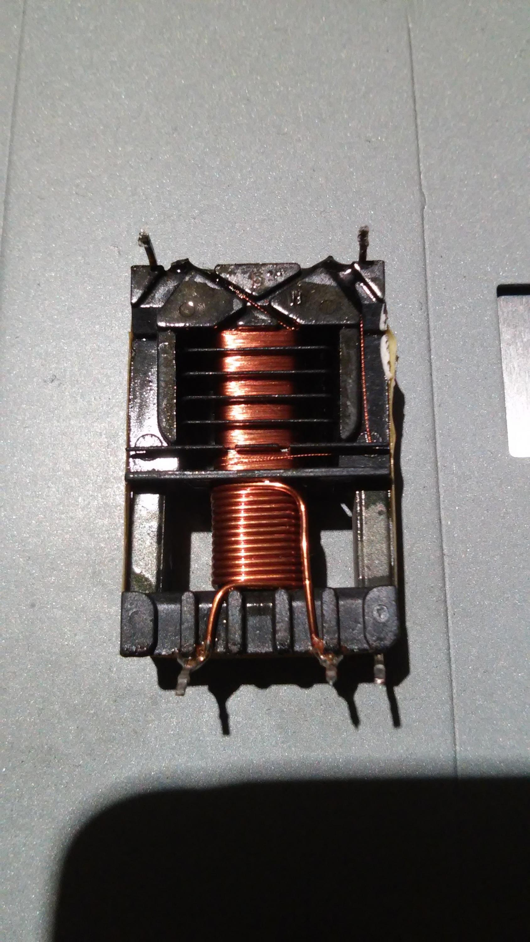

    Re: philips 170s turns on for 1s and than dead
    Here you go.
      #42
      Any markings on the side? Maybe like TK.2006M.101 or 080GL19T 8DN1.
        #43
        Here it goes:
        IT-E19-NB4004B
        DCWM0541(02)INV
          #44
          If you read post #44 from the following thread, it sounds like the secondary should measure ~550 ohms:
          https://www.badcaps.net/forum/showth...NB4004B&page=3
          The IT-E19-NB4004B is available on ebay for about $5.
