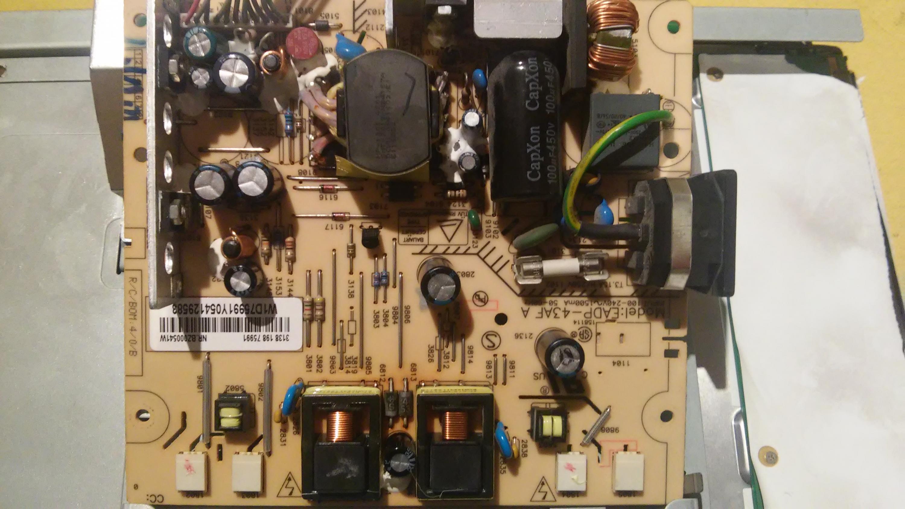

      Um. Is it too late for me to pitch my problem in this same thread?
      Exactly the same problem here. I replaced all bulged caps, but still no go on the 2 sec to black. Also tested transformers, seem to be working, I guess. I can't find the fault. Help, pls?

        Did you verify that the lamps are good or not?
        Verify the board: https://www.badcaps.net/forum/showth...er+testing+cfl

          Is it possible to connect original lamps one at a time and power them through the circuit to see if they're ok? Or do they all need to be working at the same time?
            Re: philips 170s turns on for 1s and than dead
            You can test one lamp at a time and see each one will light up or not. The lamp will not stay on of course because the protection will kick in, it only take one bad lamp for the protection to kick in.

                      #30
                      Can you read the part numbers circled in the pic?

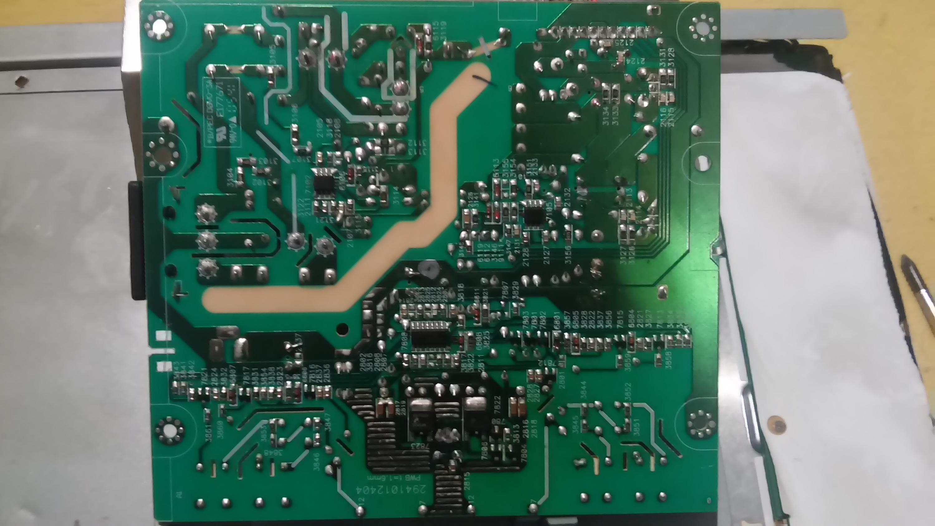

                        #31
                        7808 is: bjt31936 f18k8 06535
                        7823 is: 40T03gh 534546
                        7806 is: 4415GH 536418

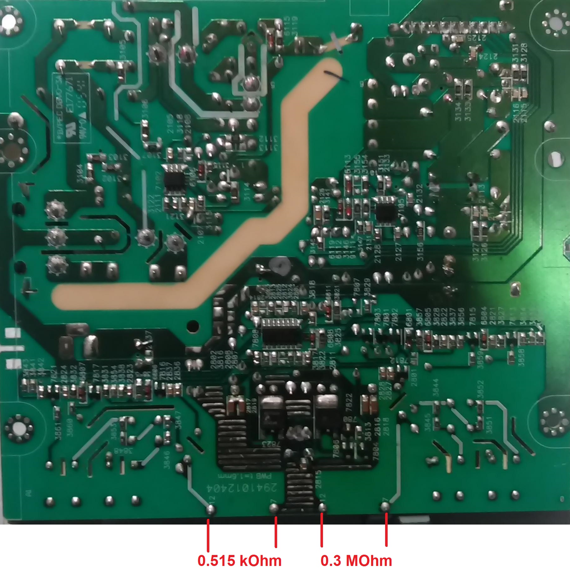

                                  #36
                                  Any suspect component would have to be taken out of circuit and rechecked.
                                  I'm a little concerned about your measurements for the secondaries of the transformers:
                                  left : 500 ohms
                                  right : 300k ohms
                                  The one on the right in the pic is awfully high. I'm wondering if it's actually open, and you're reading 300k ohms from something else in circuit. You may want to remove it from the circuit, or possibly remove the solder on the secondary pins, so they are isolated from the circuit.
                                  Edit: posted before reading Budm's post. Budm, what do you think about the secondary resistances?
                                    #37
                                    I would remove the one that shows 300K, or maybe his probes did not make good contact with the solder pads.

                                      #38
                                      I checked for reverse continuity on the mosfets and I get a reading in only one direction.
                                      As for the transformer, I rechecked it and it really is 300K. I'll disconnect it and measure again.

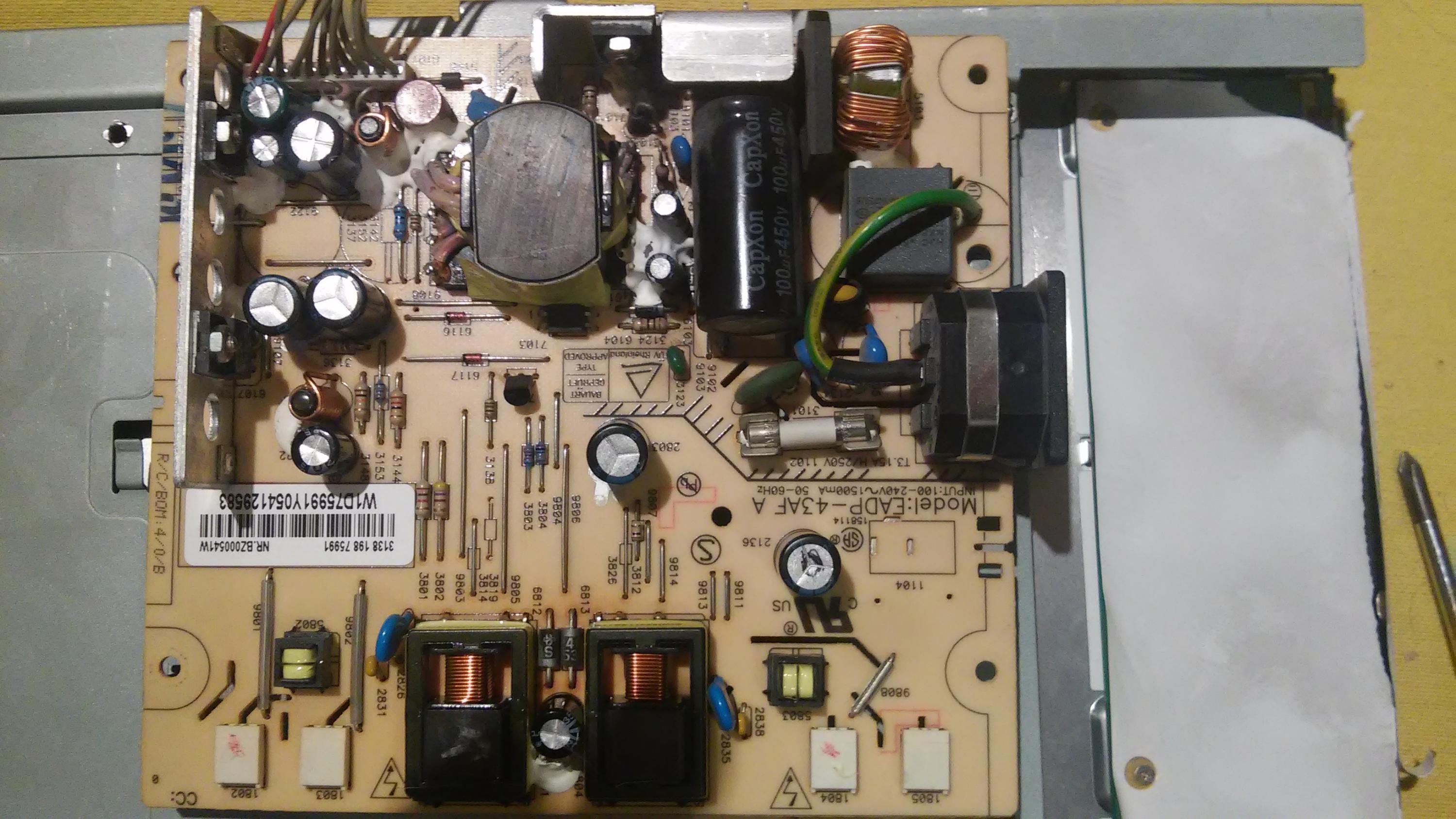

                                        #39
                                        Yup, still the same. 0.355 MOhm reading.
                                          #40
                                          Can we see the bottom side of the transformer to see how the windings of the transformer are connected to the pins?
