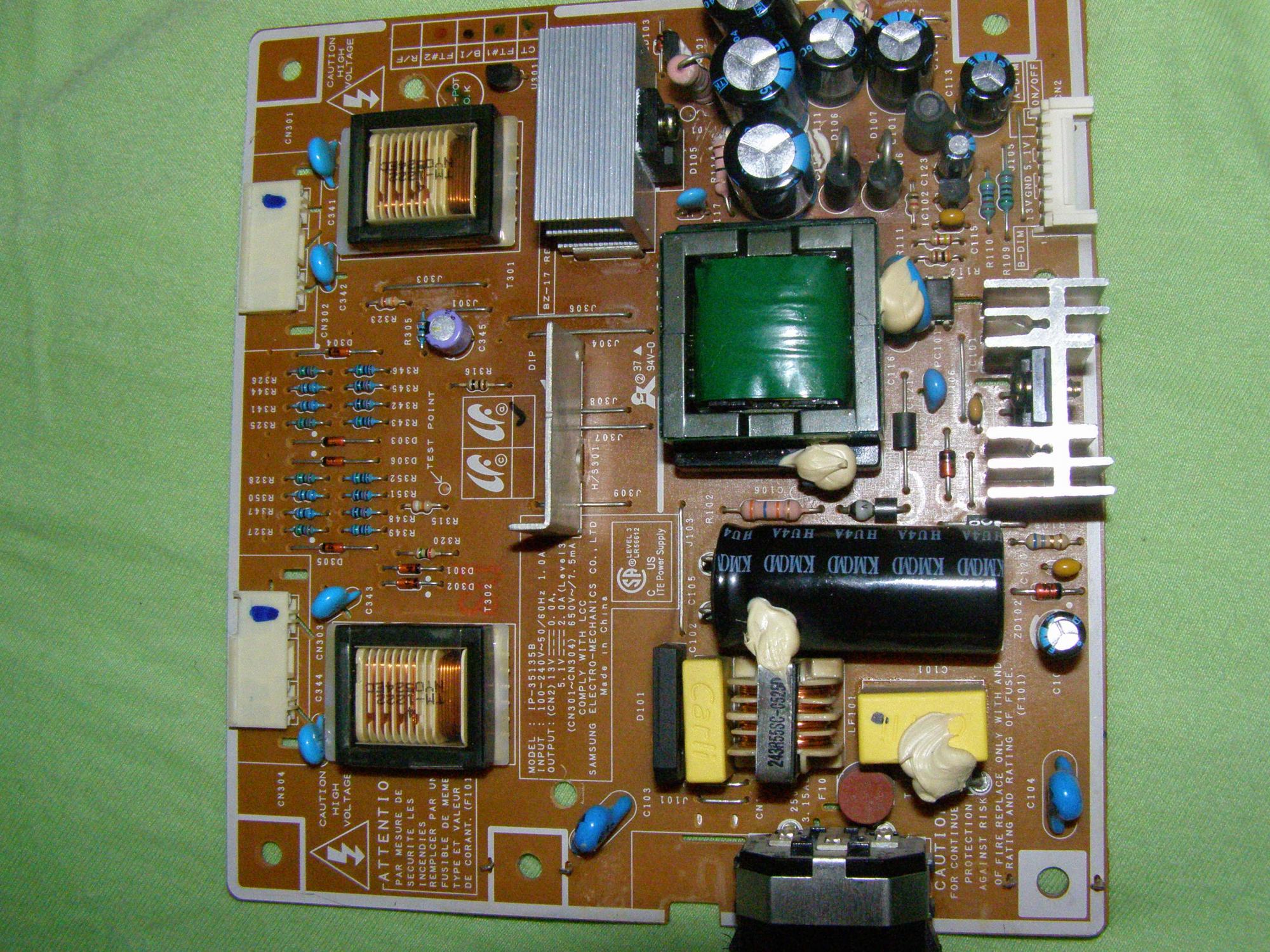

Can we get clear and focused picture of YOUR boards? Referencing other people's pictures doesn't help us diagnose YOUR problem. Your board could have unique characteristics not shown in someone else's photo like a charred resistor or suspicious looking transistor.
It is not uncommon for manufacturers to make changes on their boards. Also try to get the resolution as close to 2000x2000 as possible.

Well, I'm no expert on electronics. I learn quickly but I was following this thread from the start and i replaced the caps. Others mentioned the fuse being problematic so I was looking for it to test it.
I did the whole power on and check with a flash light. I see the image so something is working right. I still will take some pics if I ever get some time.. been really busy fixing computers.
I think I found the fuse under a glob of rubber stuff. I'm going to check it out and see if its tests good. A friend of mine repairs defective Toyota ECM's so I might have an in on some help.. lolComment

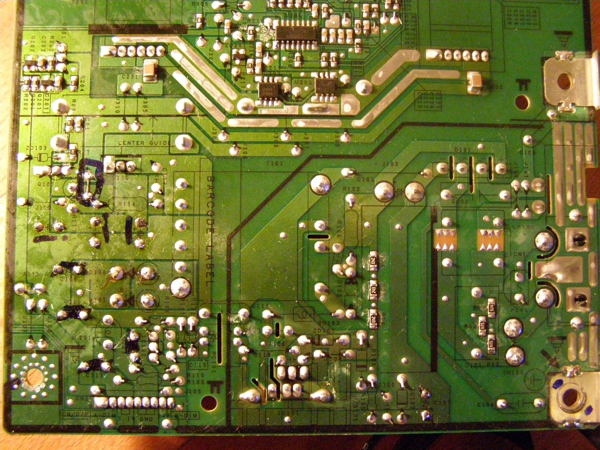

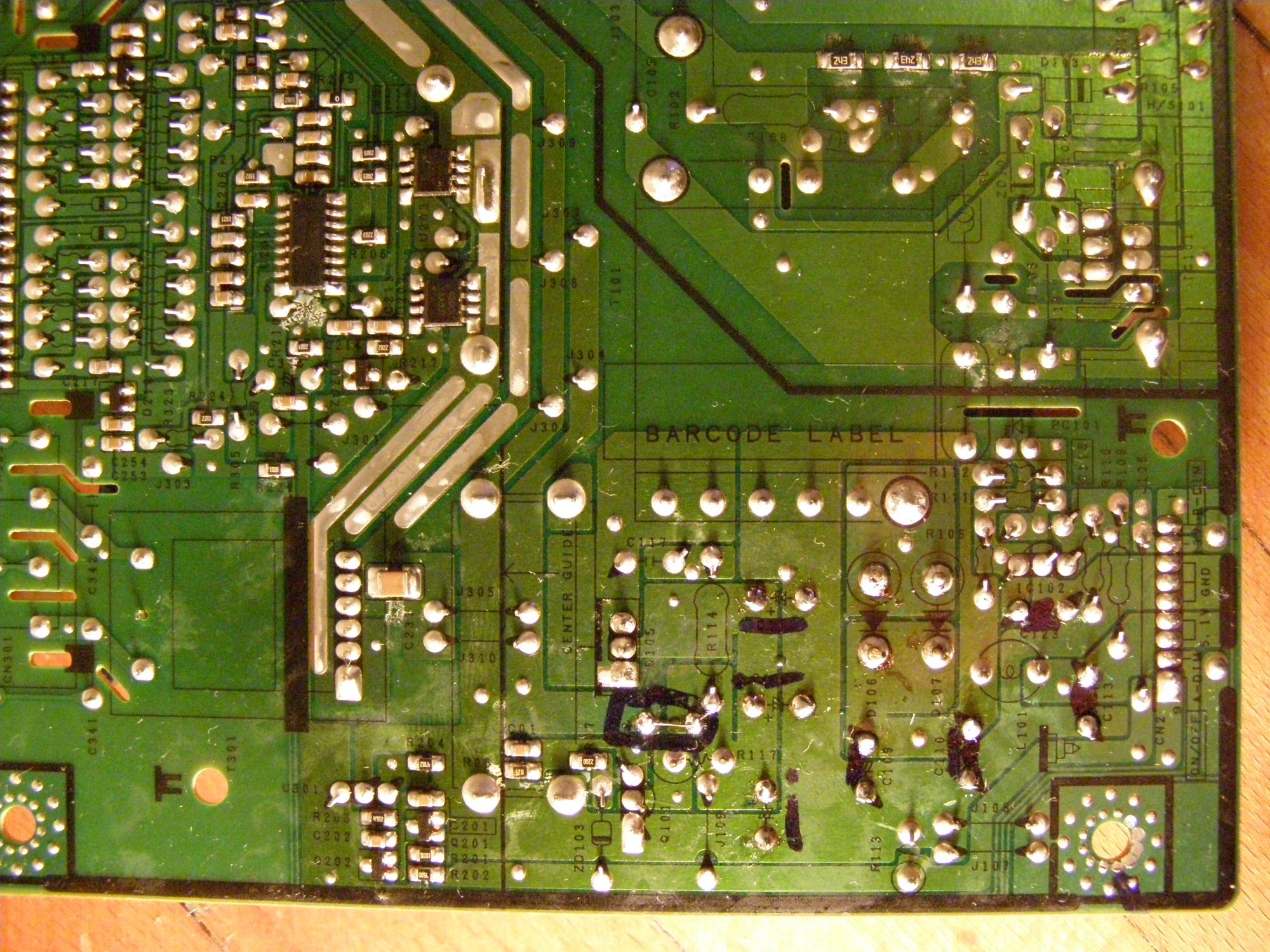

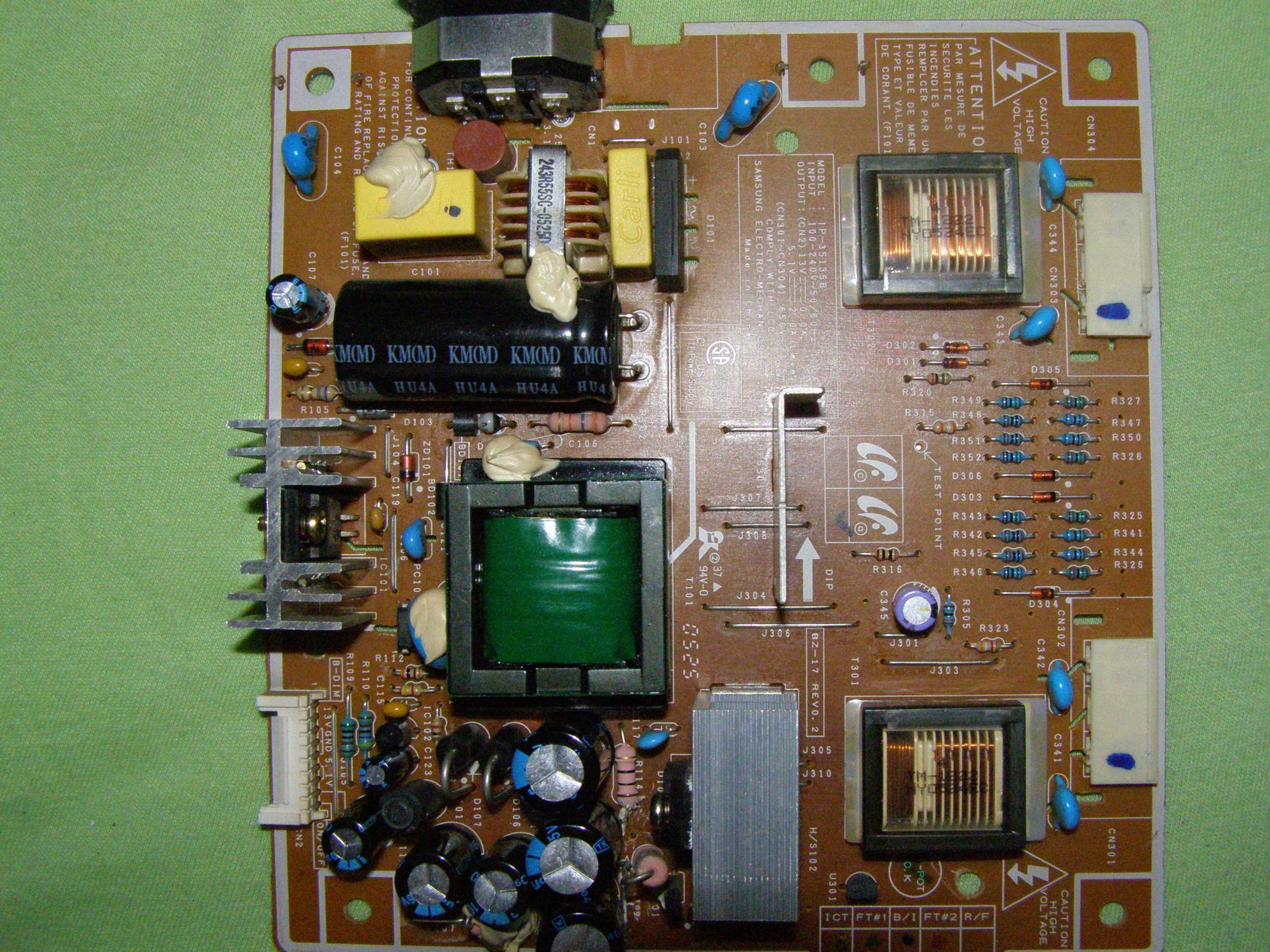

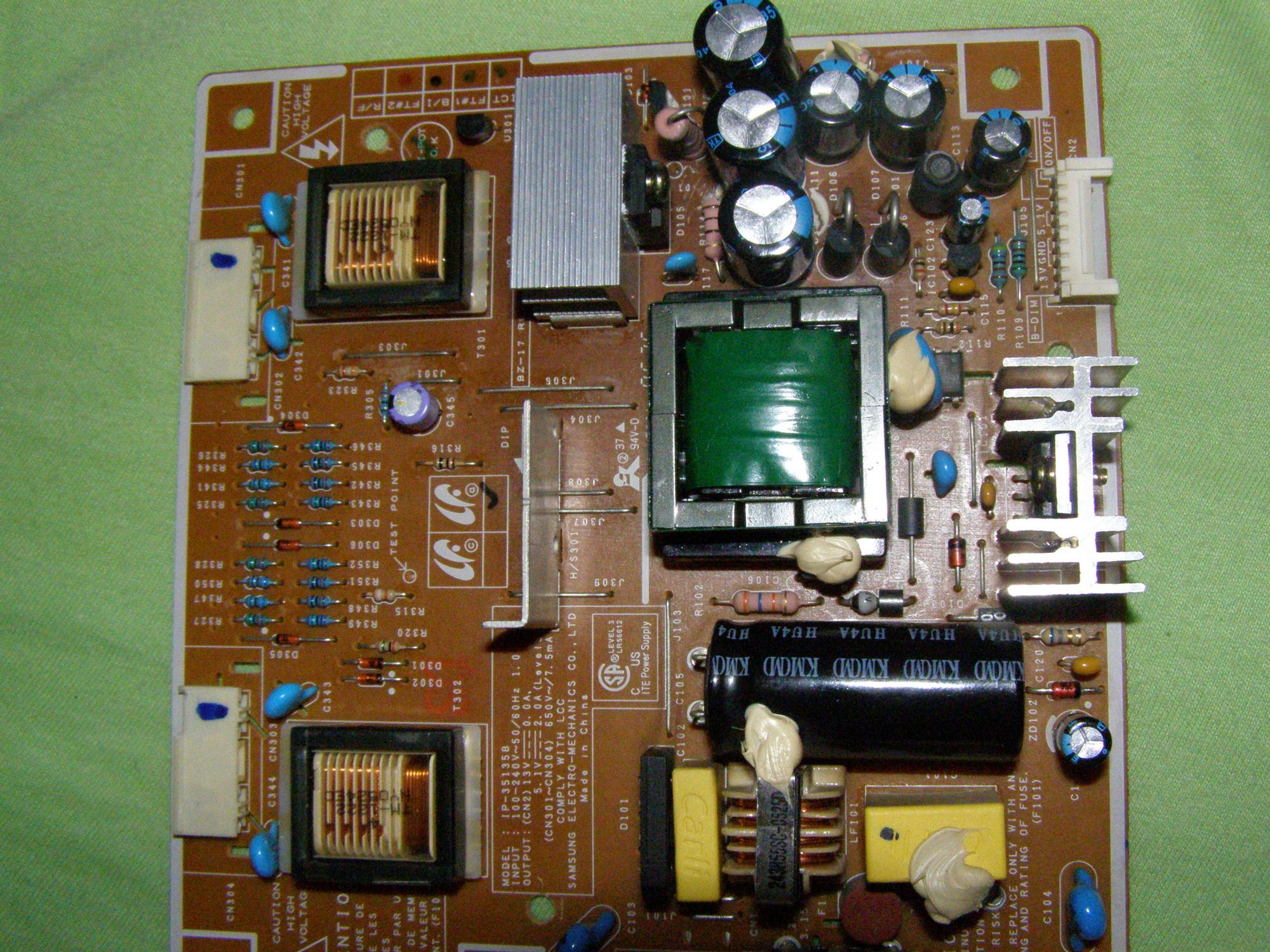

Problem is that backlights arent working at all.Power light is on. I replaced 3 bad CapXon 820uF 25v caps with 1000uF 35v and others 2x100uF16v,1x330uF 16v, 1x10uF 63v, 1x47uF 63v. I replaced them with new "JAMICON" caps. Replaced picofuse with litle wire.You can see picture but still no backlight. Where else to look?

Tip: You gave us good pictures of the top of the board. An equally good picture of the bottom would help us help you.
Tip 2: A fuse is placed in a circuit to protect components in case of an overload. Substituting a wire for a blown fuse without verifying the cause of the blown fuse has been eliminated often leads to more expensive and expensive repairs.

Measure the ON/OFF and A-DIM pins on the connector. ON/OFF should be about 3.3 volts, A-Dim will probably be lower, around one volt. If these are correct, trace the signals from the connector to the inverter controller. Check for proper voltages at the inverter.
PlainBill

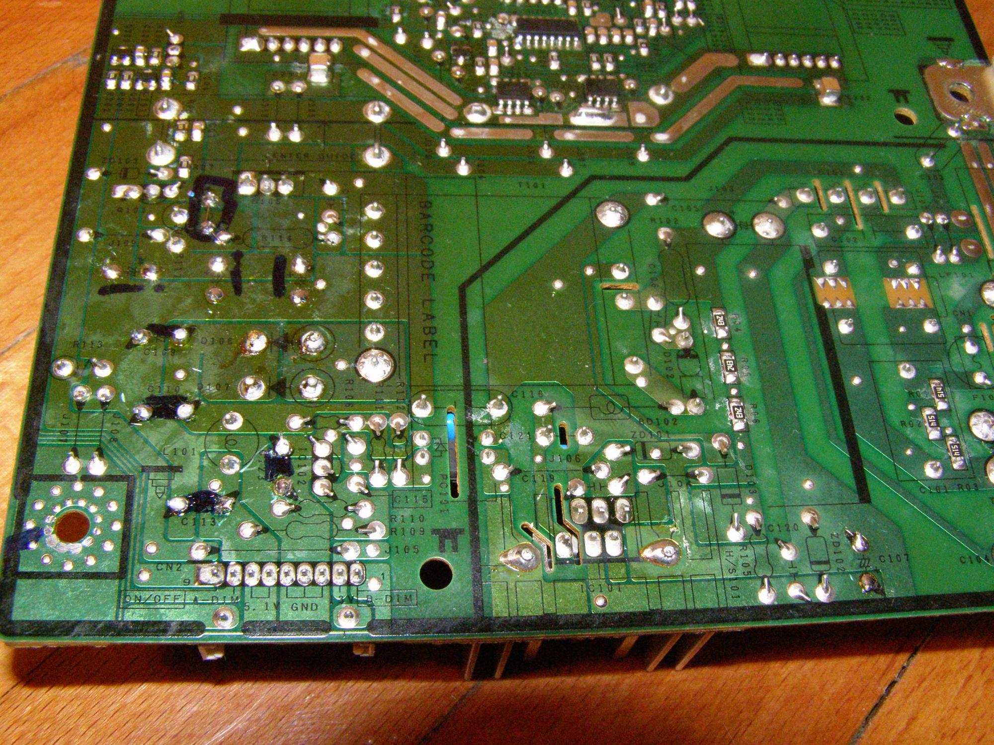

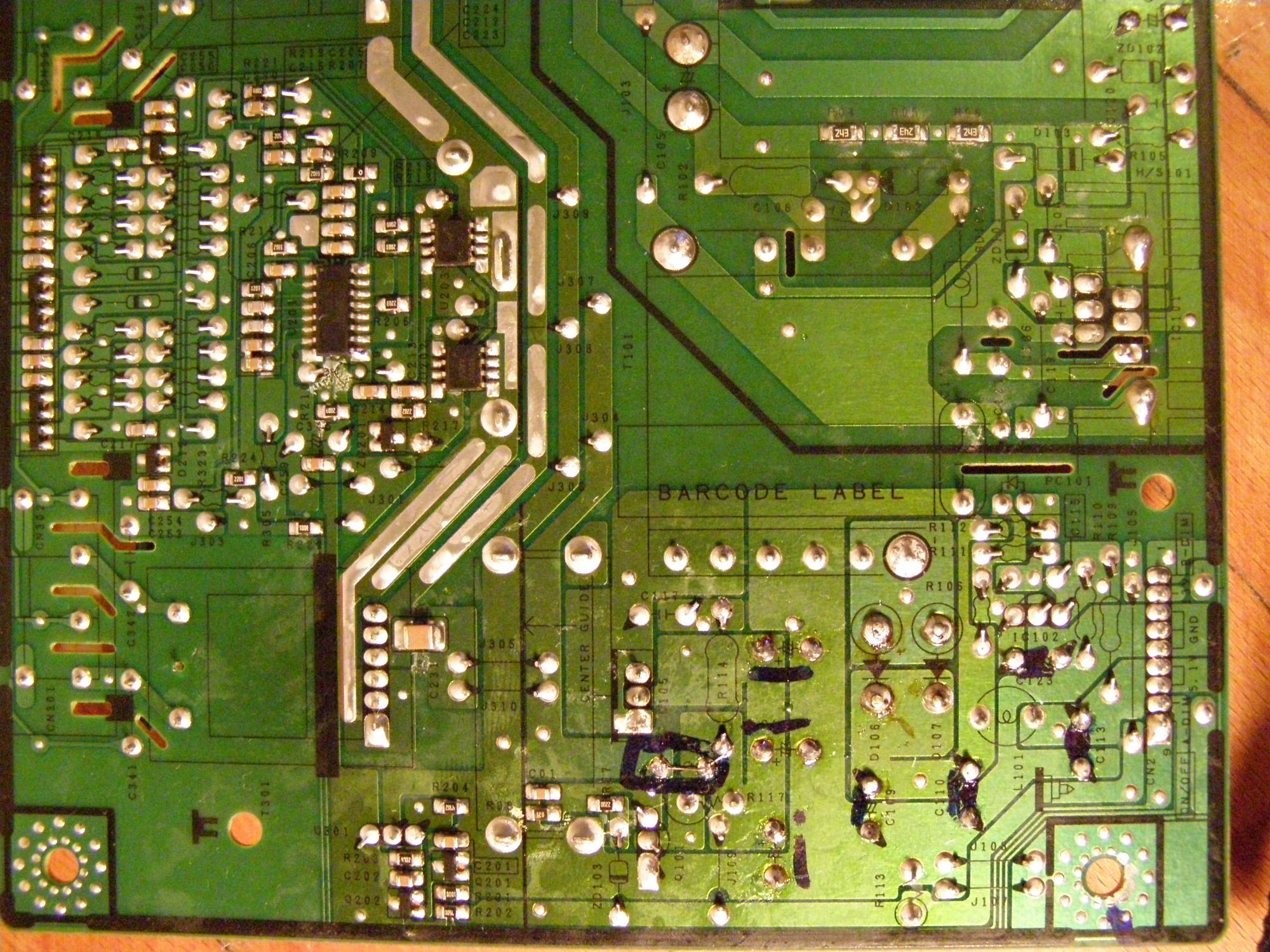

My knowledge about electronic isn't too good but i measured it on the back of the board. On/OFF 0v, A-dim 0v, 5v and 13 are ok.
(i measured it without connected videoboard?)
Here are pics of the back.Last edited by rico_st; 06-09-2011, 11:18 PM.Comment

The A-Dim and On/Off are supplied by the video board,so you need to,have it connected to the PSU/Inverter,and then you need to arrange the Monitor to be switched on,with the VGA lead connected and your PC switched On.There are other ways but this is maybe the best way for you.When your Front panel lamp shows the PC signal has been recognised, then you should be able to measure the A-Dim and On/Off voltages.Comment
Re: Samsung 930b LCD cold start problem (inverter?)
No problem, the Dim voltage varies depending on where the OSD level is set, BUT the on/off voltage should have turned the Lamps on, so plug them in....Comment
Well, looks like Last Chance Saloon,before the Backlights become the Main suspects,so I would resolder the Inverter transformers,and all other joints between the secondary and the Lamp sockets,eg the small Blue Caps etc etc.Comment
