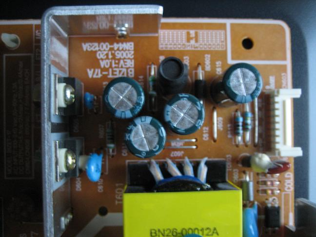

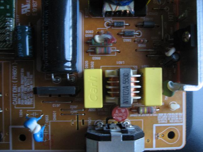

            Re: Samsung 930b LCD cold start problem (inverter?)

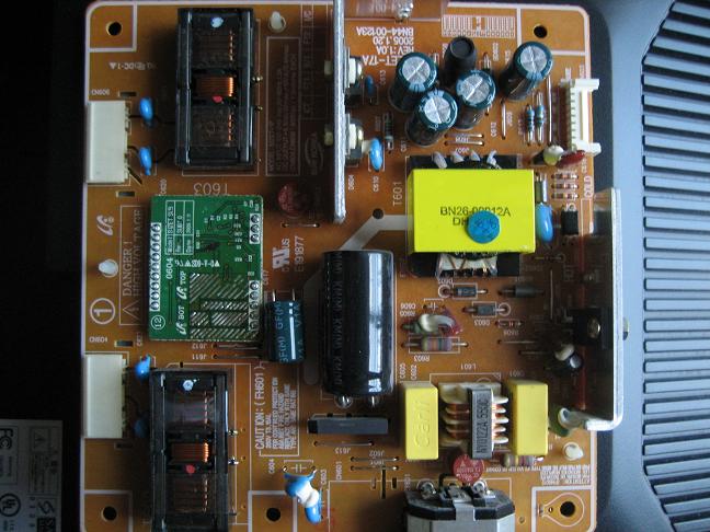

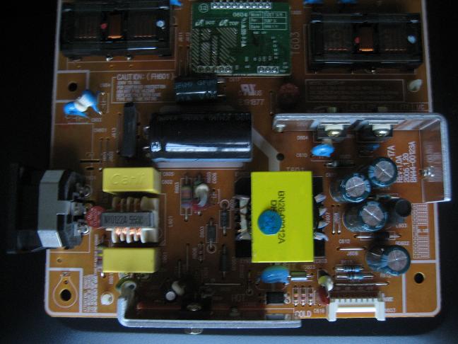

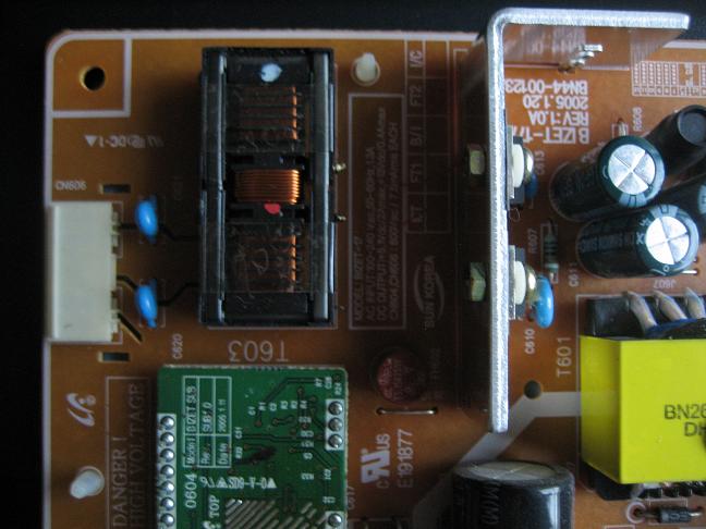

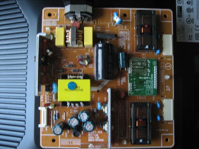

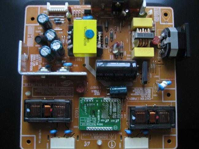

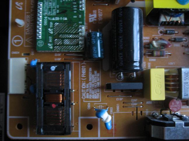

            I have a Samsung 930B monitor which started having the same symptoms as the original first post of this thread. The monitor started taking a long time to display any picture and the green power led started blinking rapidly, much faster than when the led was normally blinking in power saving mode. Eventually, it will not display any image at all, the power led just blinks rapidly, none of the buttons on the monitor respond, and no OSD is displayed. I have taken apart the circuit board and attached photos. Can anyone verify if it is the same bad capacitor problem? If so, which replacements should I obtain? Is digikey the recommended source for replacements?
            http://img26.*************/g/img4136e.jpg/

              #66
              1) Do you see the display if you shine a flashlight at it?
              2) Well, the caps look visually okay, but they could still be bad. Let's assume, for now, they are good and start with measuring voltages.
              3) If you have a multimeter, take voltages readings on the connector between power board and the logic board. You should get 5V DC on least one of the pins and possibly 12V or 19V DC as well.
              4) If you don't see the voltages above, then carefully measure the DC voltage across the large main capacitor. Careful, it is mains * 1.4 voltage.
              5) Also, you may have to desolder that green board that is upside down to get a picture. One person had a problem with a Samsung monitor about 5 weeks ago and it was a component on that board that was the problem.
              6) There is also a red fuse right next to the green board. Check to make sure the fuse reads less than 1.0 ohms.
