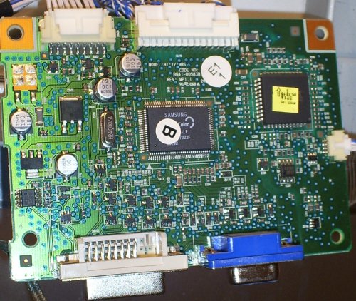

      With great care and lots of photos, I got it apart. The video input board didn't look have much to look at. <photo attached at bottom>

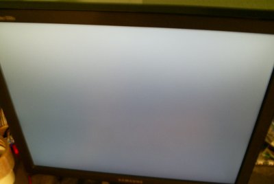

      Put it back together and I got a flat white screen.
      Damn. Well at least the power is on.

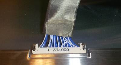

      Took it back apart, turns out this flimsy little video connector wasn't quite latched in right. I had fiddled with it before deciding it didn't need to be unplugged. Photo shows it in proper position, before I had messed it up:
      The metal hooks were unlatched and it was bending to one side a bit. I got it clamped back down, but it sure doesn't seem like a very solid connection.
      Anyway, it works now.
