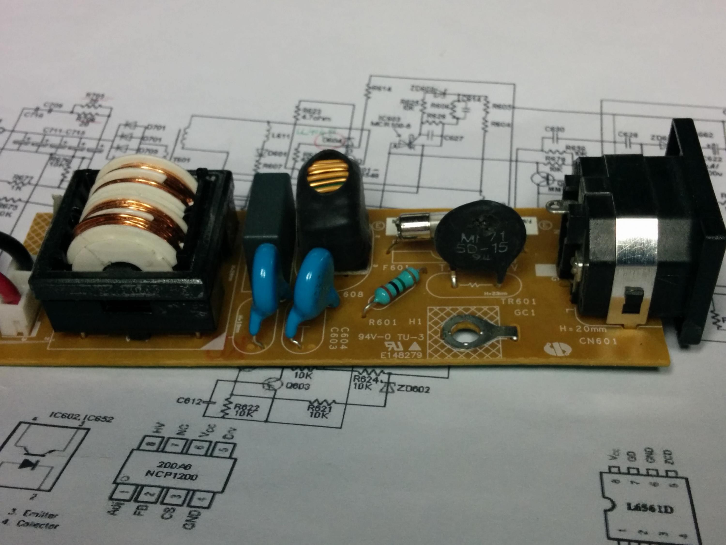

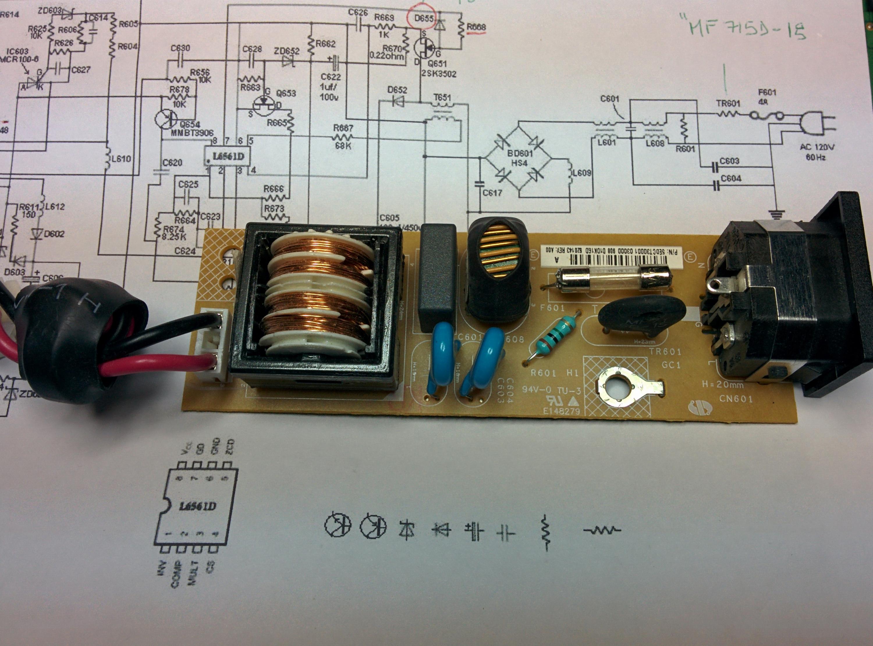

    Russound CA4 Power Supply Repair
    by CMCM
    Hello Everybody,
    Trying to repair a power supply from a Russound CA4 Multizone Controller (picture attached)
    Russound no longer supports it but were kind enough to provide a schematic of the power supply (pdf attached).
    The outputs marked 12v and 20v are all measuring only 1v.
    The board is clicking, which I think means it is in something called hiccup mode when the flyback transformers switches because of an internal problem or something else on the board Overloading it.
    The capacitors physically look clean (no bludgesor leaks) and...
