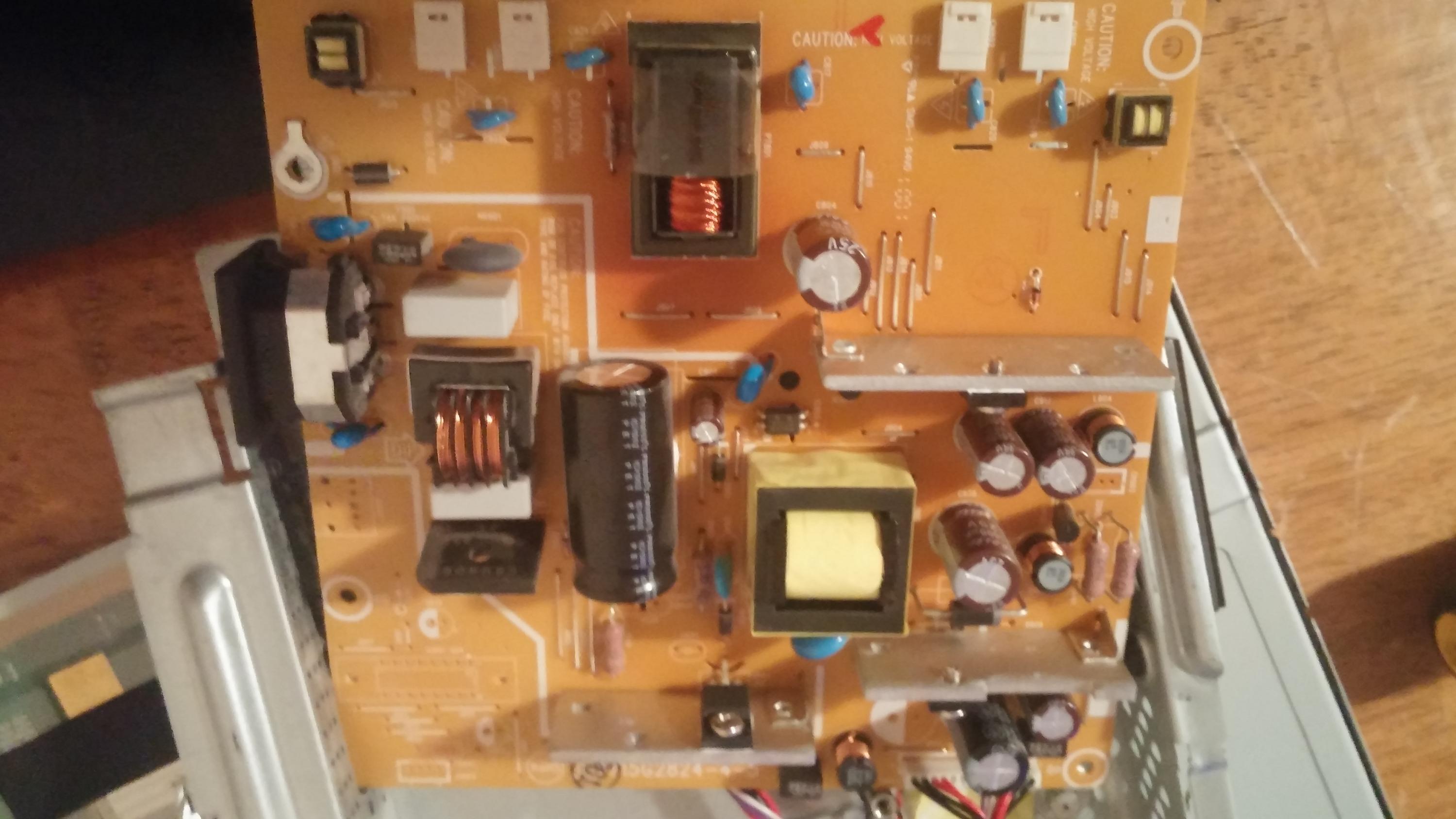

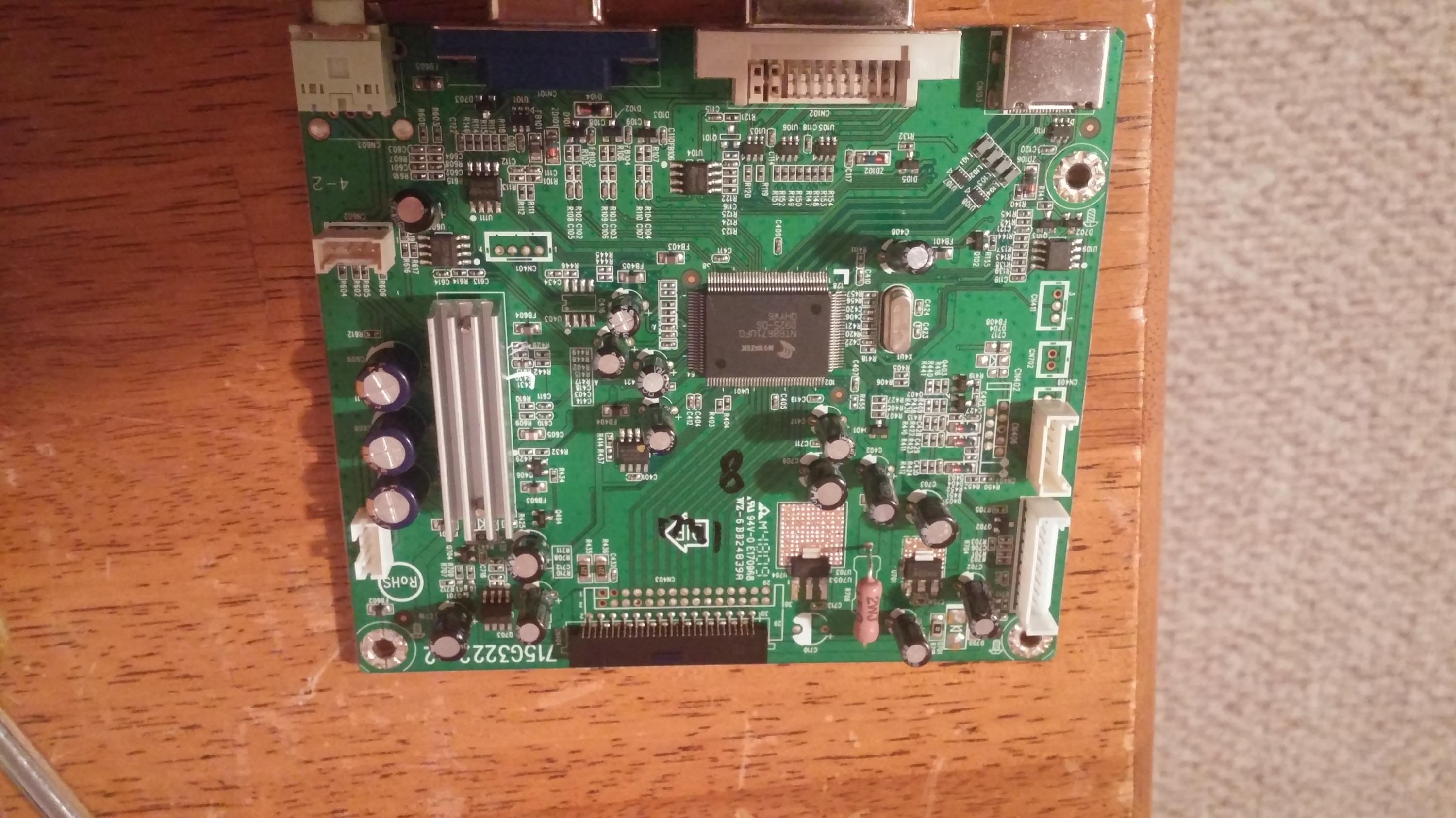

    Hanns.G HZ251 white screen
    I recently got an older non-working LCD monitor from a friend. I would like to repair it as it is much better than my current monitor. I am pretty good at soldering, however I am a bit rusty with a multimeter. Anyway, after I plug it in and turn it on, I get a completely white/gray screen. I opened it up and looked at the PCB's and no caps seem to be bulging, but I'm no expert. Click image for larger version
    Here are a couple (crappy) pictures taken of the two boards in the monitor. The white screen I am seeing is the same as the last picture in the first post of this thread; https://www.badcaps.net/forum/showth...ighlight=hanns
    Thank you, and I hope I can get this fixed!
  • 1supertech
    • Apr 2012
    • 384
    Re: Hanns.G HZ251 white screen
    T conn board has a fuse f100 check the continuity if you get OL it's no good.
    • ahendricks18
      • Oct 2015
      • 16
      Well, i did a continuity test on the fuses and none say OL. Not sure what's up with this thing
      • ahendricks18
        • Oct 2015
        • 16
        BTW, could you describe or link to a picture of said fuse to make sure I'm looking at the right one? Thank you
        • ahendricks18
          • Oct 2015
          • 16
          Well, duh! I've been looking for the wrong thing. Anyway, I followed what you gave me and the info here and I located a fuse labeled FB101. It looks similar to the one in the picture in the PDF on that thread, but its not labeled just F101. So anyway, I tested it and did not get OL. I got just 1. So what is the next step now?
