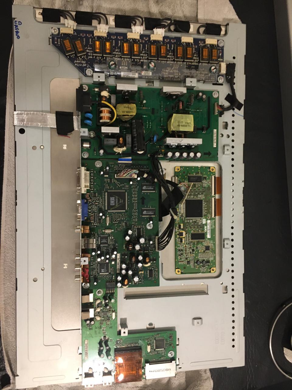

    Hey, after 2 years of use my dell 24" model 2407WFP start show me ghosting problem, so i purchased a new monitor and stop using the old one. A few months ago i start using the old one and after a few uses now the colors are very very bad.
    I open it and checked caps, and looks all OK.
    Is possible to start fail the chip FLI5962?
    I try to find a main board to purchase without luck :/
    Show some pics of the error of the LCD!
    something to recommend me to check?

        changed 4H.L2K01.A03 board and still same problem (or worst)
        is possible that will be the PSU Fault?

          Re: Dell 2407 Ghosting and Color Problems
          hi
          please check lcd flat cable.bcs you changed panel same problem
          may take a clear picture of T-con board?your picture is negative.

            Yes ., changed Main Board instead TCon one, will take some picture today (need to dissasemble again).
            Btw, i will try to purchase a new T-Con board i see that some ICs was overheat because same ics looks diferents in the same board, for example printing letters, in some are cleaned out
            Will send a picture later!

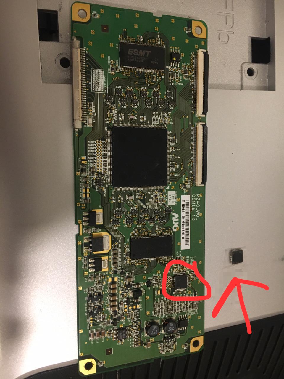

              Yes it looks like a T-CON board problem. Main board should be fine. You already found that out by now, as a new main gives the same pictures.
                Seems the common gamma buffer chip problem, write here the marking of the little chips of more than 8 pins (seems are 2).. or check them for datasheet, if them are multi buffers, check that them are not programmable ics, if them are you have to change tcon, if not you can change only the chip..

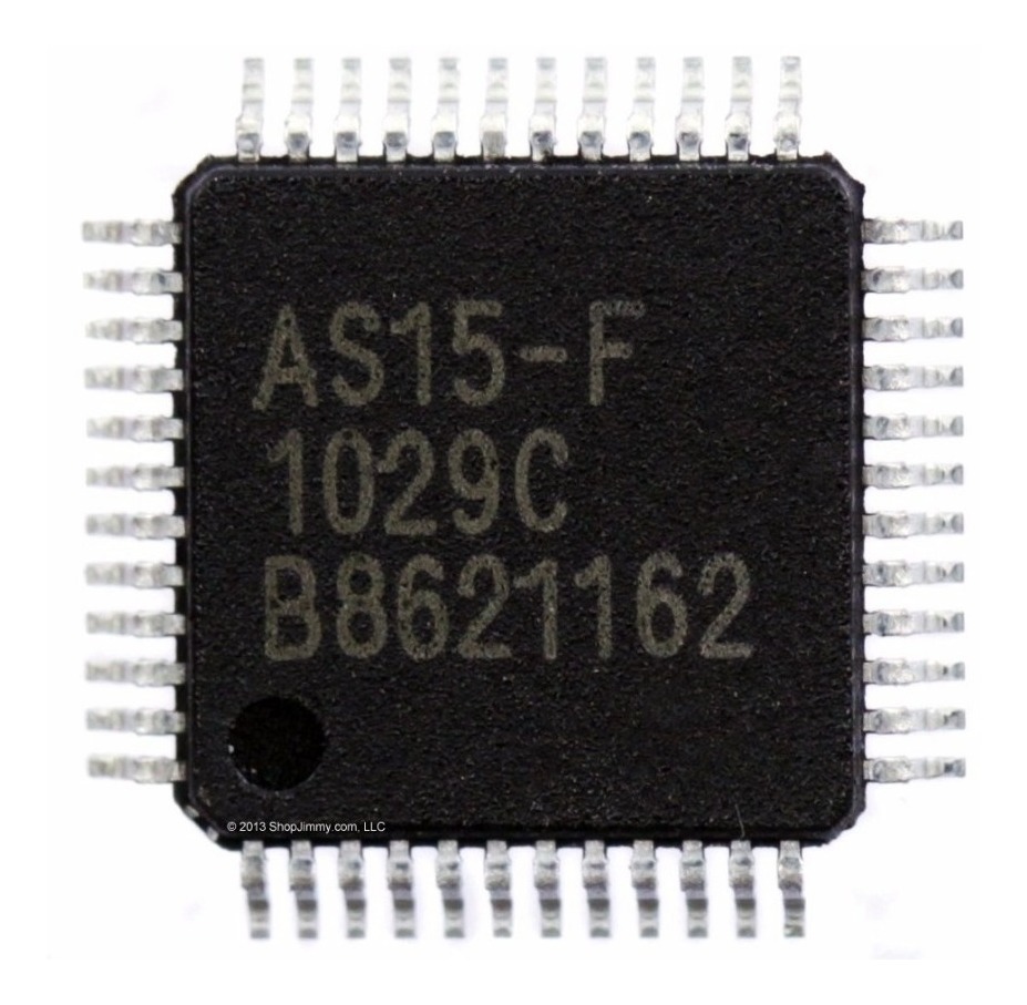

                      here is the solution
                      if the panel is an AU Optronics the tcon model is M240Uw01 - 05M16-1d
                      you can replace that board or try to repair it replacing this ics: As15-f
                      Pics attached
                        gamma chip
                        try freezing it and see if pic gets better .
