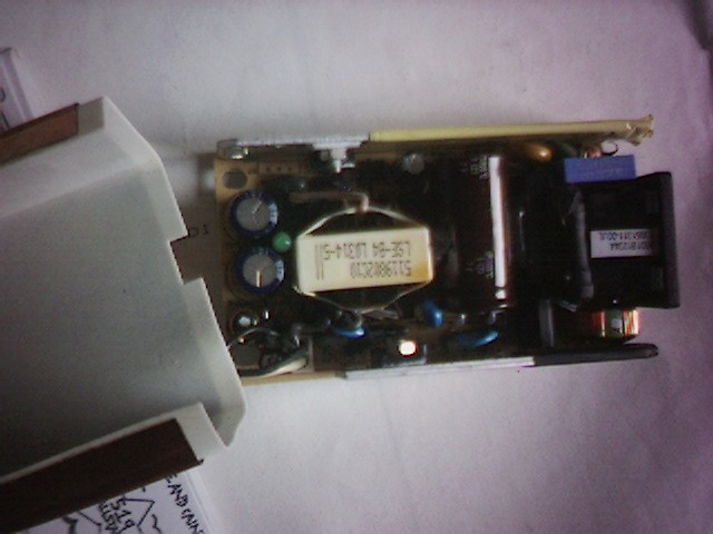

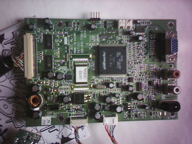

    Received a Xerox XL370s (ProView re-brand) 17" LCD which had power-up problems. No display on power, the power led flashes and a clicking sound is audible. Opened it up to check the boards but they looked fine. Disconnected the panel and it powers right up, backlights operational. If I re-attach the panel it just sits there flashing the led & clicking. Caps on the display board are Su'scon brand, none appear to have leaked / bulged and they are all 220@16 or 100@16. There is heat discolouration around the 3.3V regulator section and on the bottom of the board so is it possible that the capacitors in that area (5 are close, 3 would get most of the heat flowing around them) are dried up & causing the problem?
    All fuses are good on all the boards including the panel. Cable continuity is also good.
    I also checked the power supply in case it wasn't putting out enough juice but it appears to be good (proper voltage), all the caps look good, United Chemicon series LXZ.
    Any ideas?

    Su'scon was a bad brand in past and your caps are suspicious even if capacitances are small (100-200 uF), but the troublesome part may even be an inverter or another chip on the inverter board.
    I'm not an expert so I'd suggest taking a better quality photo of the inverter board and waiting for KC8 or Davmax replies.

        As a bit of a follow-up I found one 100uF capacitor which looked dodgy, near the crystal in the 1st picture. Almost looks like someone did a bit of a "repair" in the past to a smd resistor and melted the side of the can. Anyways, I tacked a 100uF cap onto the back I had extra from recapping some other LCDs and voila the LCD turned on yay.
        Crap picture, all white with a couple vertical lines which faded in and out and the text vanished almost instantly but it did work.
        My question now is: does anyone know where I can get low profile (5mm) 220uF and 100uF 16v caps? All the low ESR ones I've been finding googling are too tall...
