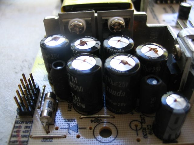

I just opened a MAG Innovision LT716S that does not power up. The power board is another typical case of 'bad caps' bulged and 'oozing on top', as shown in the pictures. These caps are all on the secondary side of the power supply: seven Xunda capacitors, including six 470micF/25V/105deg and one 220micF/25V/105deg. Failures of the components have taken out the two fuses on the primary [in-line with the mains VAC wires] and secondary sides.

First, check all pins on the bridge rectifier and MOSFETs on the primary side for any internal shorts with a multimeter.
If OK, replace all electrolytic capacitors with Nippon Chemi-Con KY Series, with the 400V/450V unit being replaced with a Nippon Chemi-Con KMG Series unit.My first choice in quality Japanese electrolytics is Nippon Chemi-Con, which has been in business since 1931... the quality of electronics is dependent on the quality of the electrolytics. -

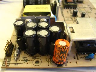

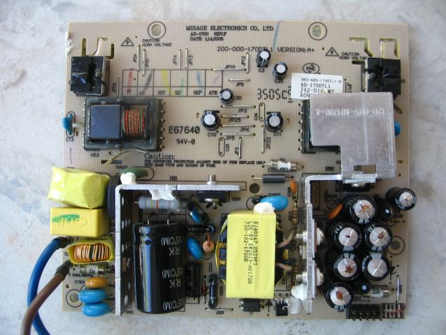

I had time today to look again at the power board [1] the primary & secondary fuses tested OK when I used a sharp probe to get through the oxide [2] primary rectifier and both secondary Schottky dual-diodes [one dual common-cathode for the +5VDC and one dual for the +12VDC] tested OK with a multimeter on 'diode test' settings. I then recapped with capacitors bought at HSC in Sunnyvale: six 470mF/25VDC/105deg and one 330mF/25VDC, see enclosed photo. Note on the photo that the output pins of the power board are clearly marked +5VDC, +12VDC, GND, BRI, LPON.
The LCD now is fully functional.Comment

Its not just those caps that fail,but also C10 and C11, next to each of the Inverter transformers.Measuring ESR in circuit,shows they look ok,BUT as they are across the transformers,this confuses the issue,and they usually fail on ESR testing when out of circuit.Comment
