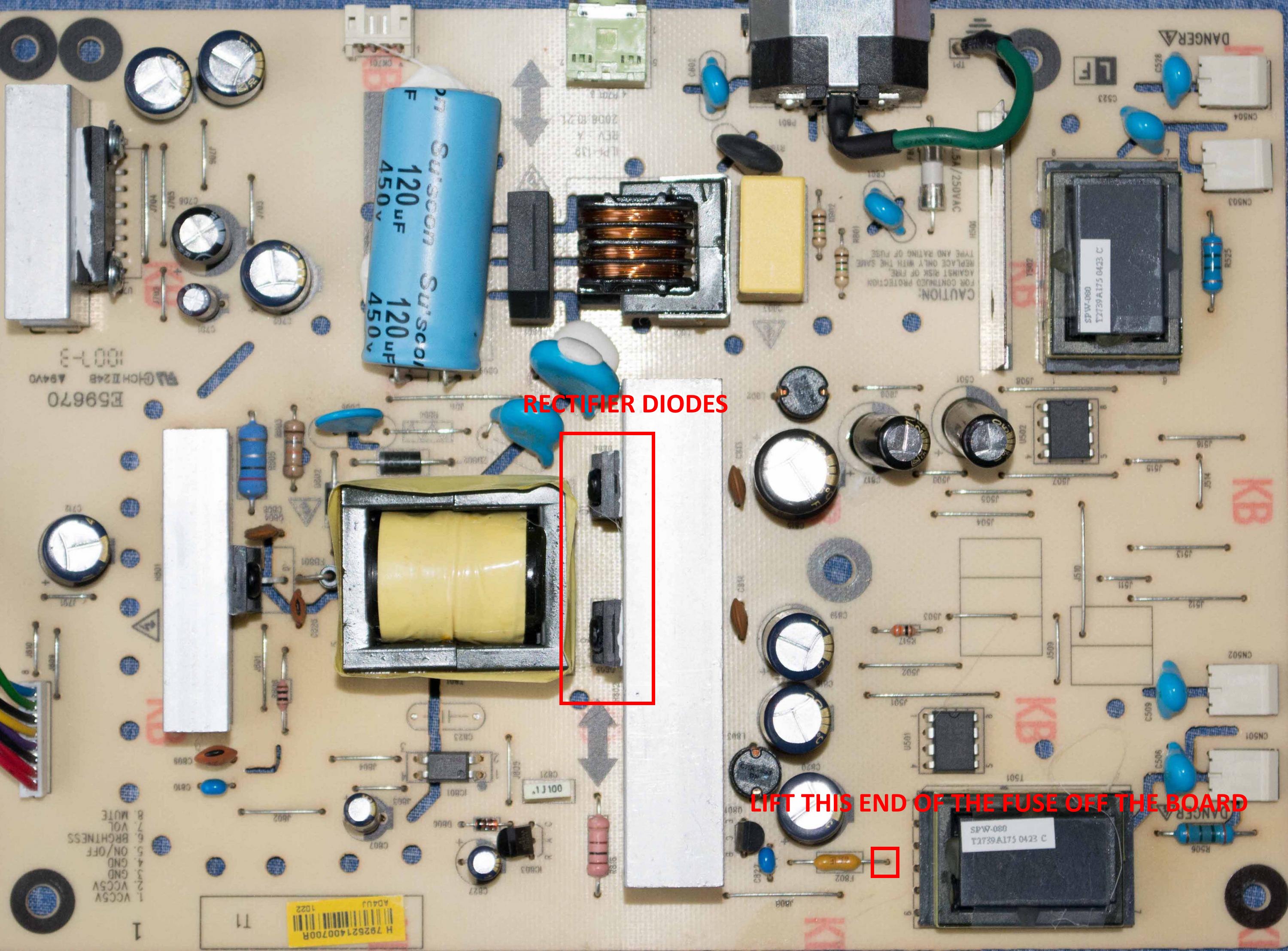

    Lets do the quick resistance test between S1 and D1, S2, and D2 to see if any of them show low resistance.
    AP9971GD Dual-MOSFET.
    OK, I tried this but am unsure which pins are S1, S2 etc.
    I see the pin denotation in the pdf but only the corner pins are marked on the actual board (1,4,5 and 8).
    For both units (U501 and U502), I will assume that Pin 1 is S1.
    Then for U501 I get the following resistance readings:
    S1-D1 1,755 Ohms (1.755 kOhms)
    S2-D2 1,754 Ohms (1.754 kOhms)
    For U502, I get
    S1-D1 1,750 Ohms (1.750 kOhms)
    S2-D2 1,750 Ohms (1.750 kOhms)
    These tests were done with no power applied to the board other than what the multimeter supplied.

        Re: Acer LCD monitor on-off repeatedly
        See the marked Rectifier diodes.
        Also try lifting one end or the fuse and then connect the main logic back back in place to see if the 5V is steady.
          Thanks.
          OK, I removed the end of the fuse as you suggested (photographic "evidence" available but I was unable to attach it as keep getting "server error" message ) and hooked up the power board to the screen backlights and the main board and plugged in the mains power supply.
          The voltage on both sides of the fuse F802 was rock steady at 5.22v over a long period.
          However, as I assume you expected, the voltages at pins 1 and 2 of the 8-Pin connector between the boards were barely measurable at about 0.05v.
            Basically, this power supply has two outputs: a 5V standby (VCC5V) for the control/video board and T-con (board that connects to the TFT panel), and another output that is usually 10-20V for providing power away from the inverter (monitor backlights). The purpose of fuse F802 is to protect the power supply from an overload condition if there is something wrong with the inverter. By lifting one end of this fuse, you are essentially cutting power away from the inverter to see if the inverter is (likely) the problem or not (which is excellent advice from budm, BTW).
            Since you say the monitor does run for a very long time with one leg lifted on fuse F802, then that likely indicates a fault with the inverter when it heats up. My advice would be to re-solder the joints on the inverter transformers (those black boxes with T501 and T502 designators on the board), resistors R506 and R525, as well as those 8-pin ICs (MOSFETs?) U501 and U502. The re-solder the lifted leg on F802 back to the board and see if the monitor runs or has problems again.
              Hi momaka
              Many thanks for that great reply.
              It's a tutorial in itself.
              Just to avoid misunderstandings, when one of the F802 pins was desoldered from the board and the power board then connected to the main board and mains power, the power reading at the F802 fuse remained unvarying at 5.22 volts for about 10 minutes which is as long as I left it running.
              The screen backlights, however, did not light up as (I think) was expected.
              OK, I carried out all of the resoldering as suggested.
              Note, however, that I did not remove any of the old solder on the joints but used the soldering iron to remelt the old solder and then applied a very small amount of new solder. This was the case for the inverters T501 (8 pins) and T502 (8 pins) and the resistors R506 (2 pins) and R525 (2 pins).
              For the mosfets U501 (8 pins) and U502 (8 pins), however, I was more cautious because the solder joints were so very close together I was concerned about creating a short between adjacent pins.
              Therefore, for U501 and U502, I merely remelted the old solder and allowed it to resolidify.
              Then I reconnected the desoldered leg of F802 and connected everything back together and switched on mains power.
              However, the behaviour of the system was unchanged. The screen and blue power light cycled on and off exactly as before.
              I will also mention that after about 10 minutes running, I could feel (finger) no heat in either T501 nor T502 which suggests that overheating of these transformers may not be a factor in the malfunction of the monitor.
              Incidentally, after budm had pointed out the rectifier diodes D804 and D805 to me, and following the suggestion in this thread by stj that the problem in my monitor may be due to a faulty rectifier diode, I tested D804 and D805 but without taking them out of the circuit.
                your tests are pointless if it only fails when its running.
                you need to meter the voltage coming from the rectifier and see if it slowly starts to drop as it warms up.
                  Thanks for the suggestion.
                  Well, I tried that on D804 but due to a last minute twitch of the hand I seem to have shorted out the diode with a resultant
                  Not quite that dramatic but enough to render the board inoperable.
                  So, whether the rectifier diode was deficient before or not, it certainly is now.
                  Nevertheless, for a little more than the cost of a replacement diode, I can get a new power supply board.
                  So, that's my next step.
