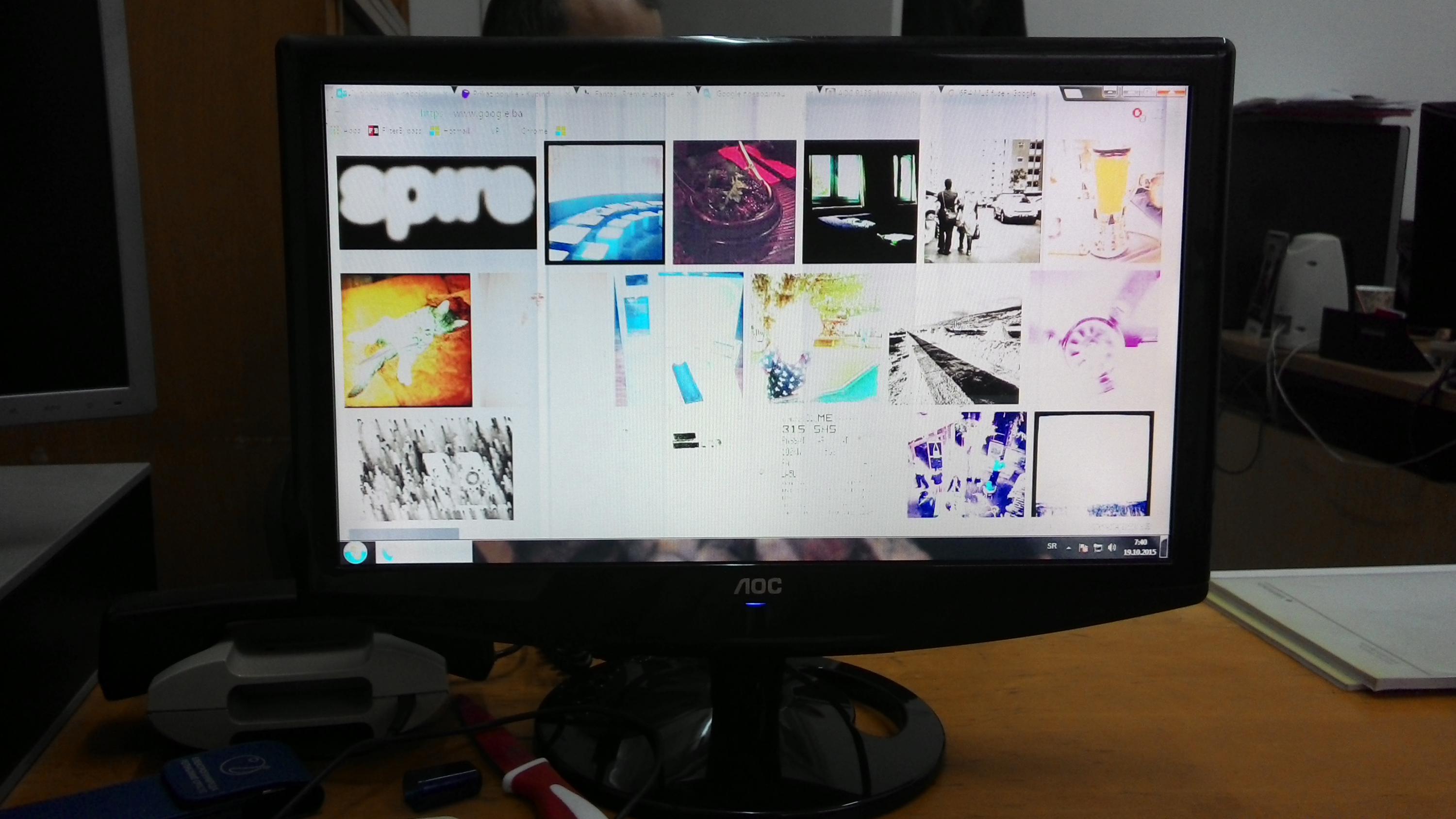

    I have monitor AOC 913Swl. It has problem with white screen like this:
    https://www.youtube.com/watch?v=KF43WKaZBEk
    I try erase contacts on flat cable like on this video:
    http://www.youtube.com/watch?v=FfbmQRuqDD0
    But it didn't help.

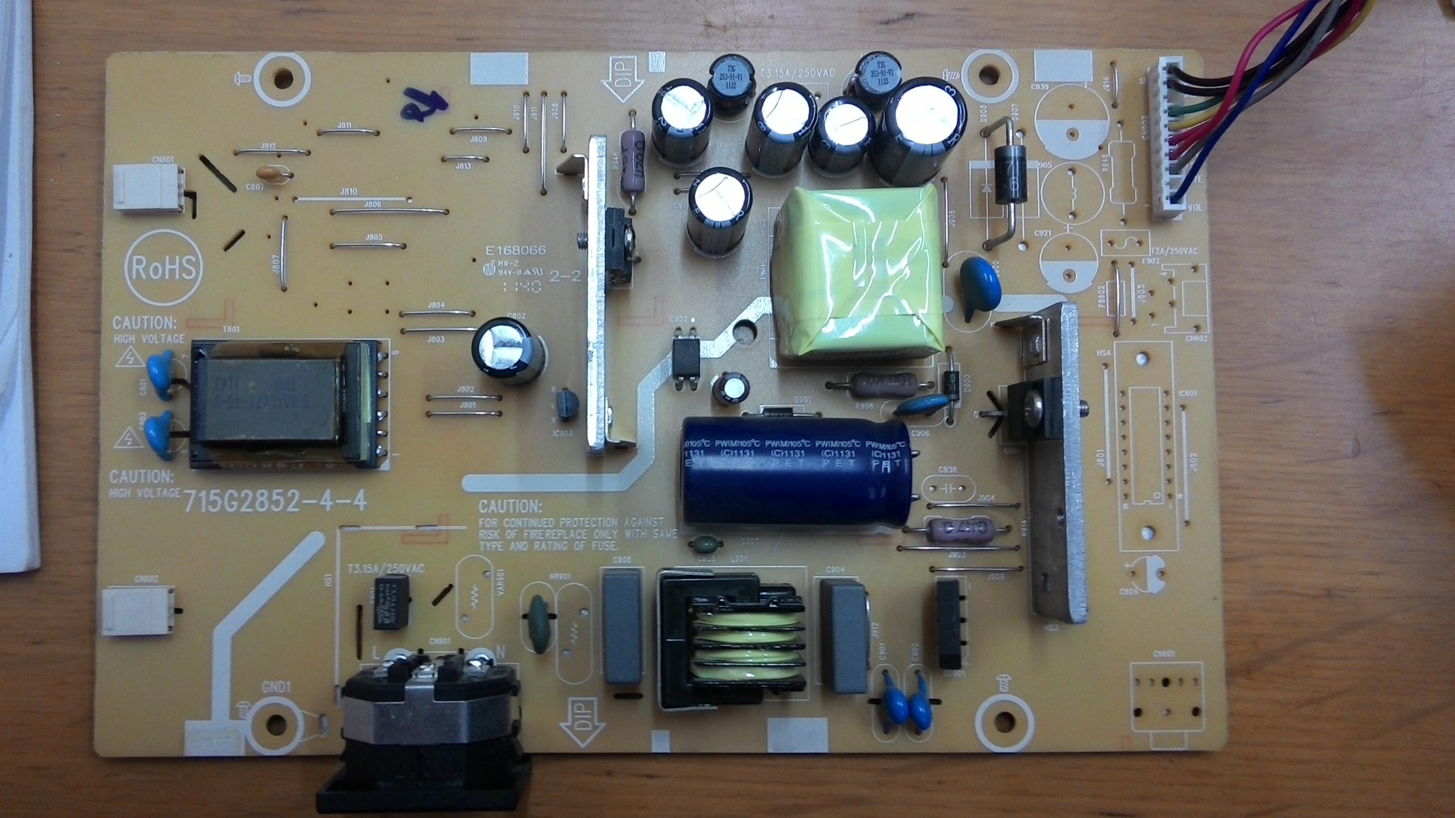

    I check PSU board and I think that it's good. All Voltages seams good. (Only on 12V pins I have 14.90V)
    I can post all voltages if that is required

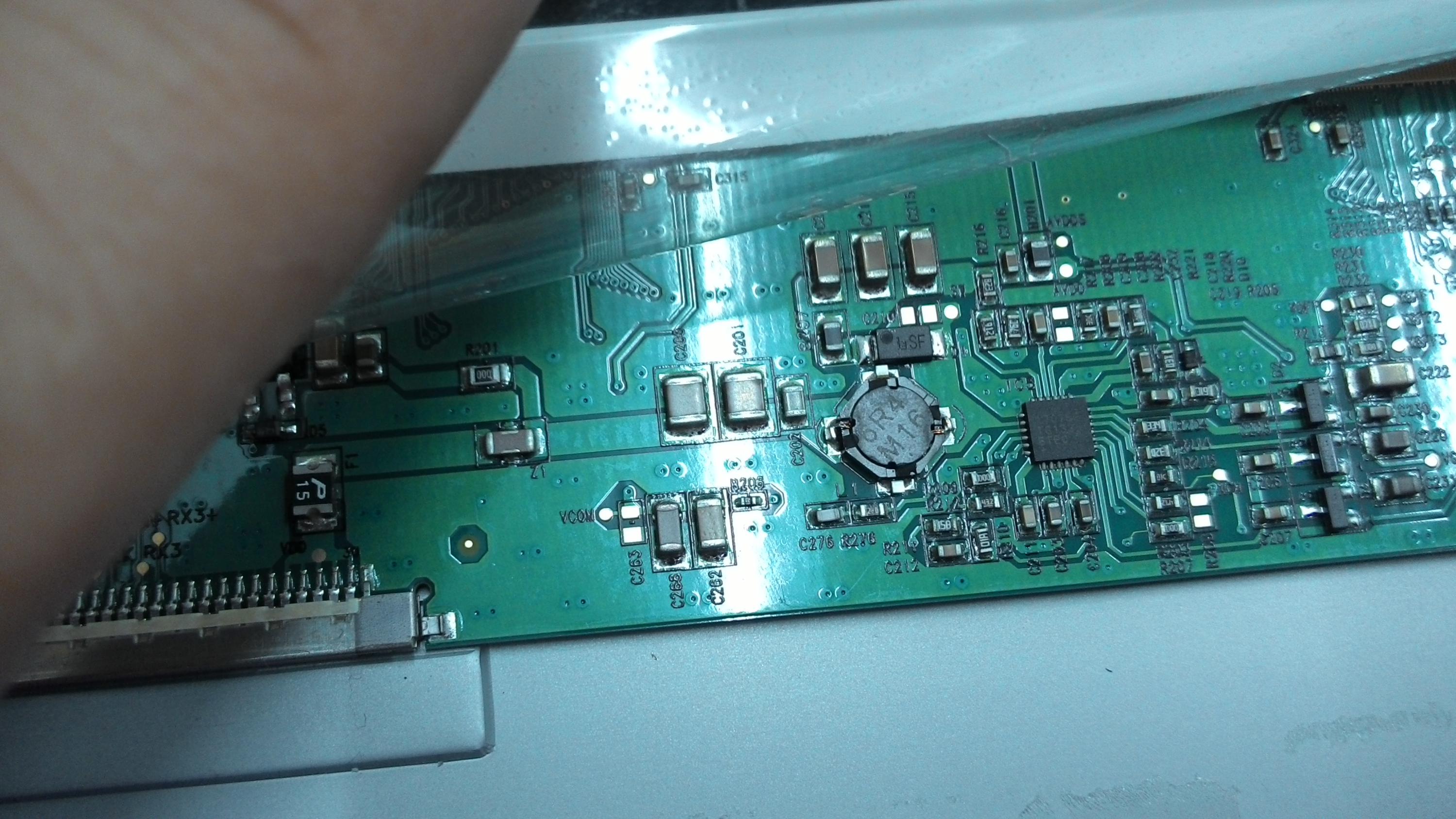

    Likely T-con board issue. Check fuse on T-con board. It should be near the LVDS connector. The T-con board is the one that is attached to the LCD display TFT matrix.
    If possible, post some clear pictures of the T-con, so we can assist you further. Use the forum's "Manage Attachments" (found after clicking the "Go Advanced" button) feature to submit your pictures.

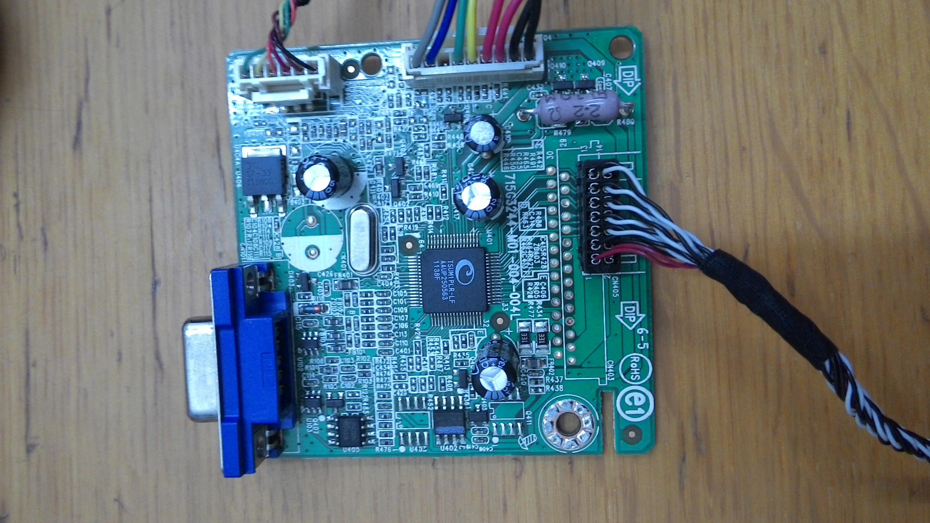

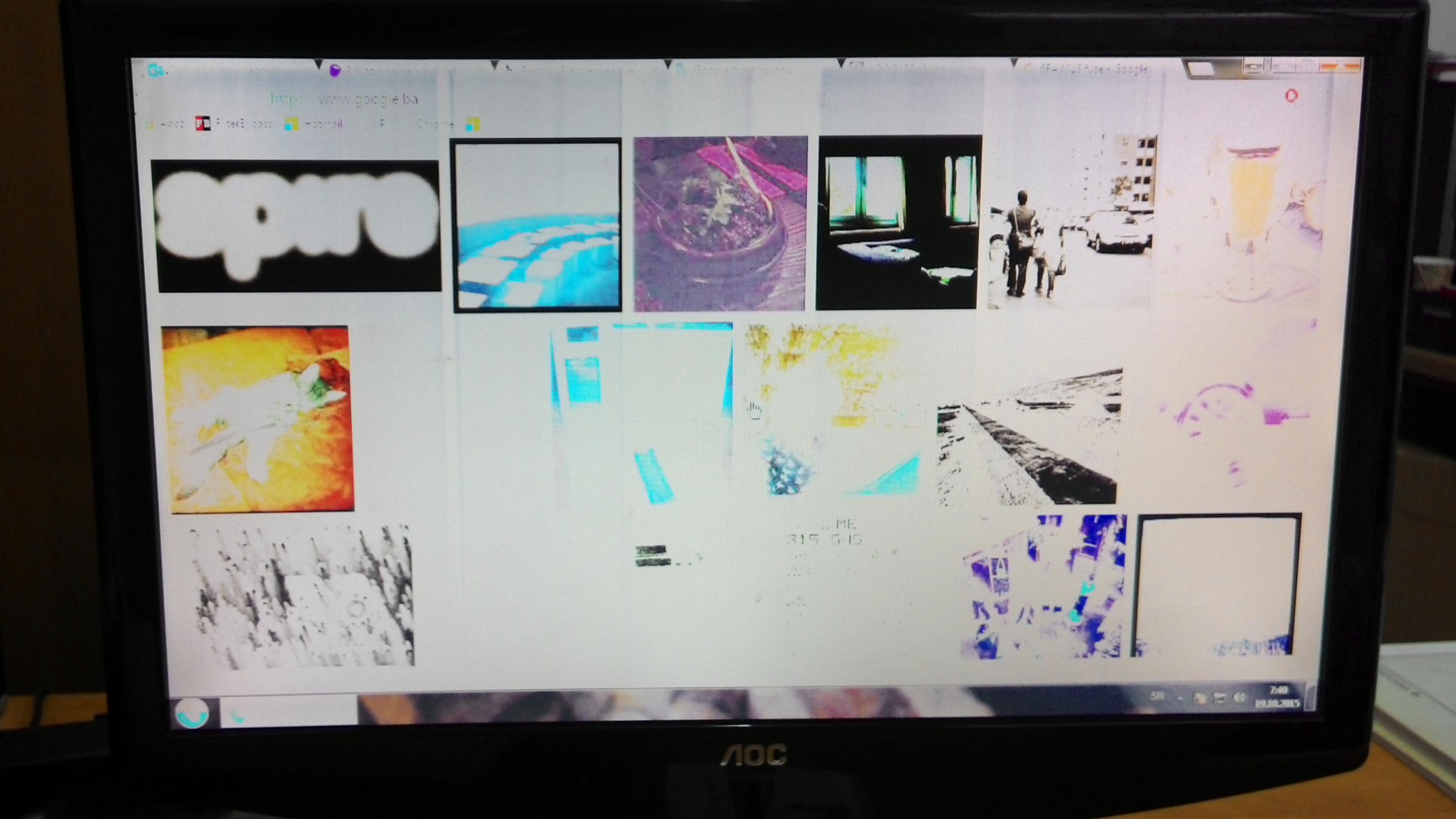

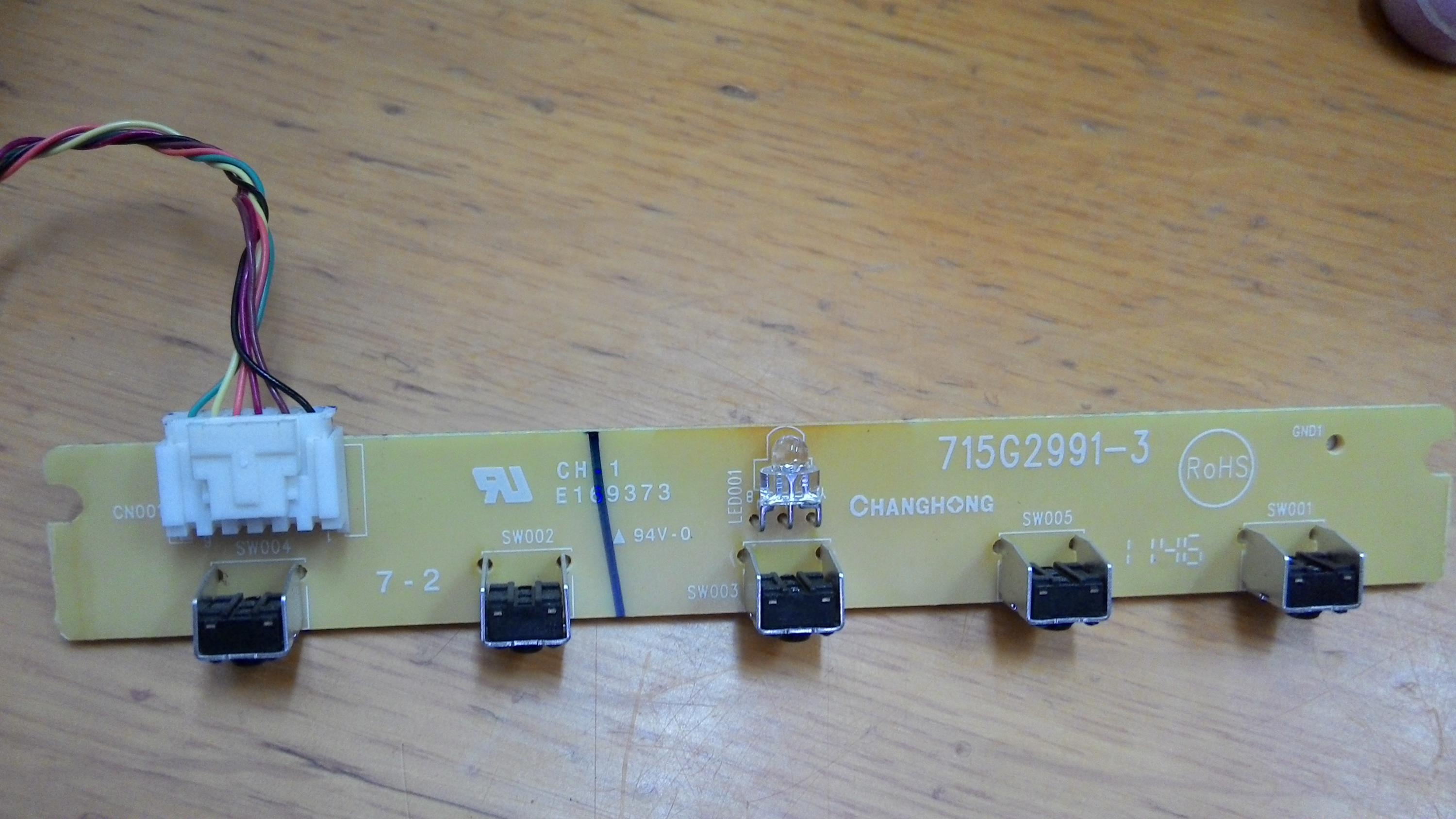

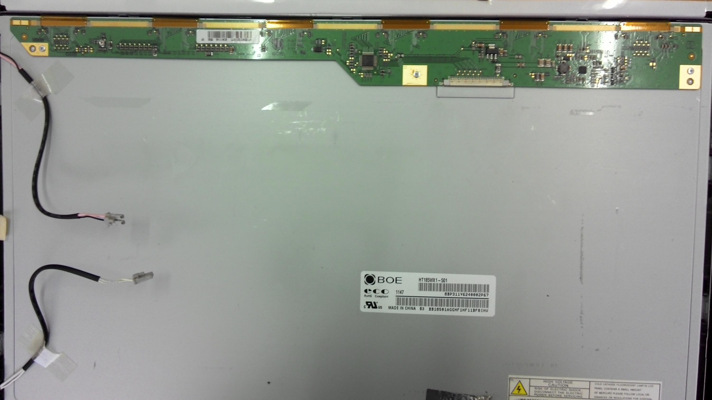

      Re: AOC 913Swl has a white screen.
      Tnx momaka for your reply
      I searched fuse on all boards but without success.
      In this post I will attach images of all board and original image of screen.
      This AOC 913Swl was broken before 5 months. I left him in basement.
      After 5 months I try again and all was alright first 1-2 min. Later problem returned.
      The Screen has very slow response and if I change screen image(for example, pres CTRL+ALT+DEL) on display screen change after several second and change very slow.
      I don't know what is 6R4 M16, but that is suspiciously.

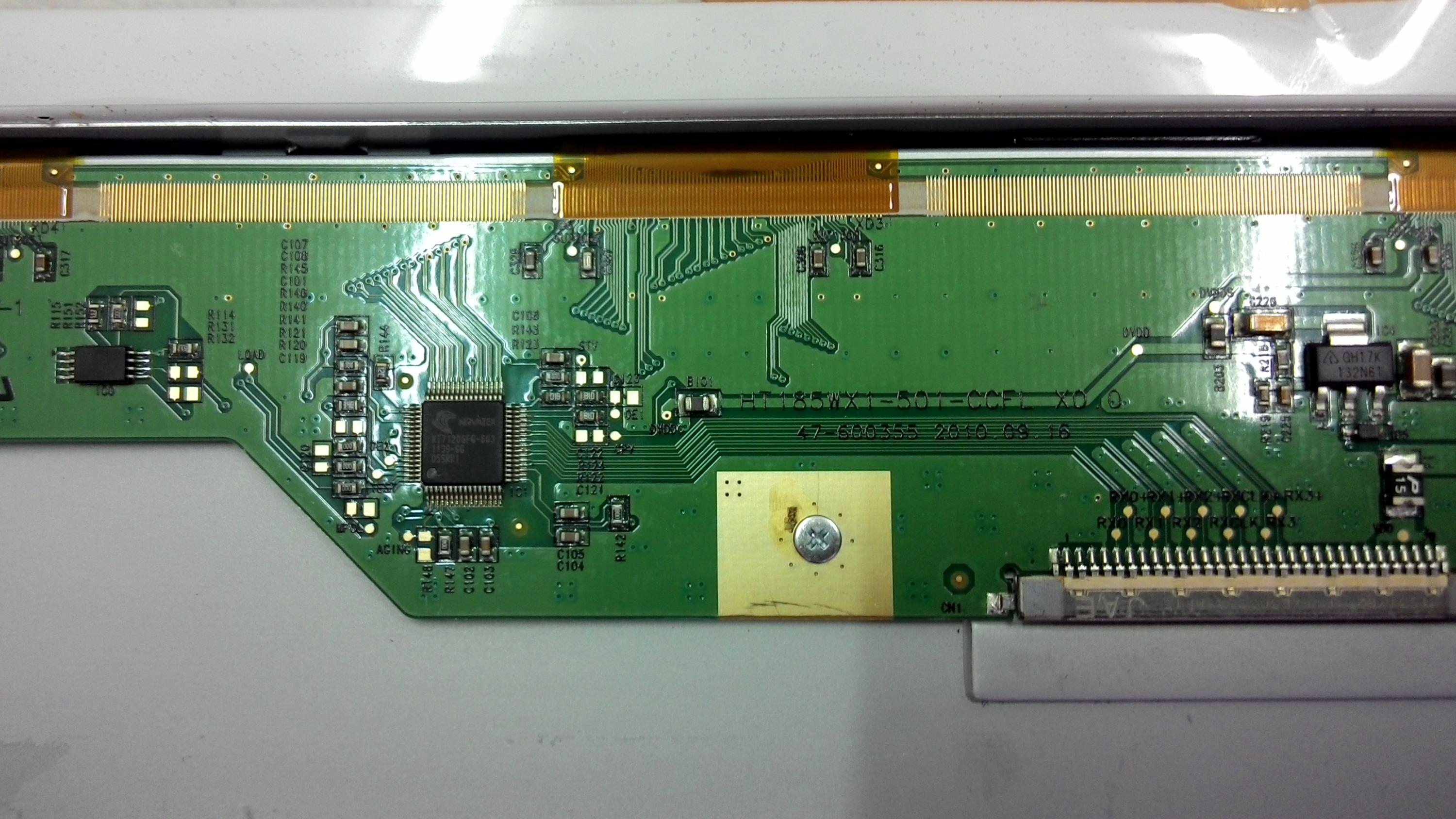

        In the fourth pic from left fuse is F1 it has P15 written on it I think tab bonds are going bad.

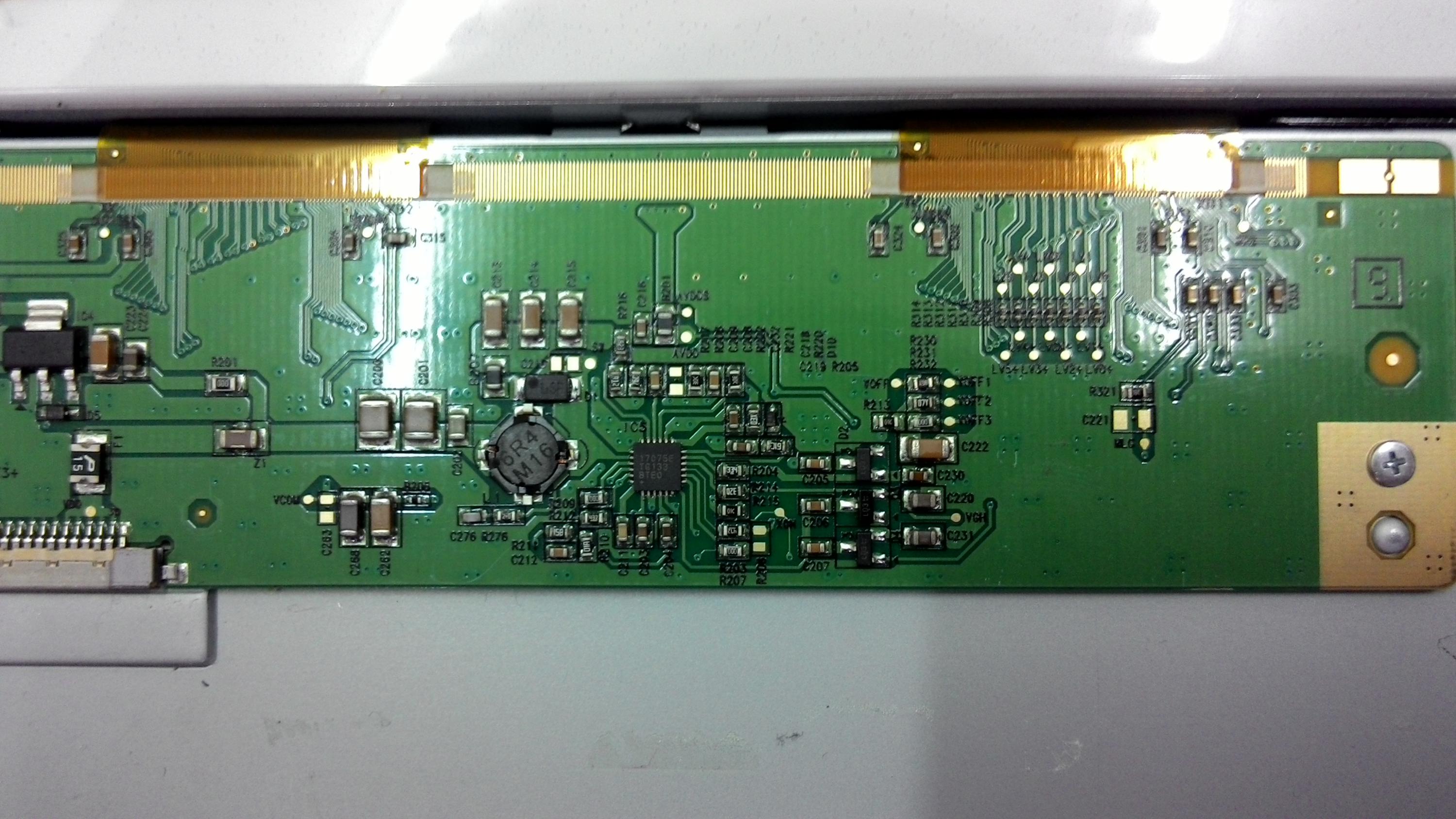

          Ah okay, I see that this is not a complete white screen problem - just washed out.
          In that case, the fuse on the T-con board is likely NOT the problem (which is F1, with "P15" written on it, as 1supertech pointed out. Still, check it just in case with your multimeter. It should have good continuity. 1-2 Ohms resistance max (or less, depending on how good your multimeter is).
          I'm thinking this is likely NOT tab bonds either, since the whole screen seems to be affected and there are no vertical lines.
          Try this: when you press the "MENU" button on the monitor, does the OSD also appear with strange colors too?
          Another test to run is to check the voltages on the T-con board (that is the board in picture #4 you posted). There are small golden dots on your T-con board - these are voltage test points. What you need to do is use your multimeter to measure the voltage between ground (monitor metal chassis) and the following test points:
          VDD (located right below fuse F1)
          AVDO (located top right of that "6R4 M16" inductor")
          VGH (I can't find it on your board, but it should be there. Sometimes called V_GON or VDDG)
          VGL (I can't find it on your board, but it should be there. Sometimes called V_GOFF or VEEG)
          The problem could also be bad gamma IC, I think. If you can, please post a full picture of the T-con board.
          Changing the electrolytic capacitors on the video/logic board (picture #2 you posted) could also be the problem.
          Sorry I can't give you more exact guidance where the problem is. I've seen problems like this before and often times they either couldn't be solved or the problem was different for each one, so there were different solutions. Hopefully, the above tests should help determine where the problem could be.

            I check the voltages on board:
            VDD=5.04V
            AVDO=12.65V
            VGH=27.8V
            VGL=25.4V
            Resistance of the fuse F1 is about 0.7ohms.
            When I press MENU button colours are strange and it have slow respons.
              master hoarder
              • May 2008
              • 12170
              • Bulgaria
              VGL=25.4V
              And that might be it.
              VGL is usually -5 to -10 Volts. It is responsible for making pixels in the LCD appear dark (whereas VGH turns them ON and makes them pass-through the backlight).
              Speaking of which, I can't find where test point VGL is on your T-con. Could you point it out to me. I know there should be one somewhere if there is VGH.
              Basically, bad VGL could be caused by a bad transistor, bad diode, or shorted ceramic capacitor. Once I know where VGL is, I should be able to point it out to you which components to check.
