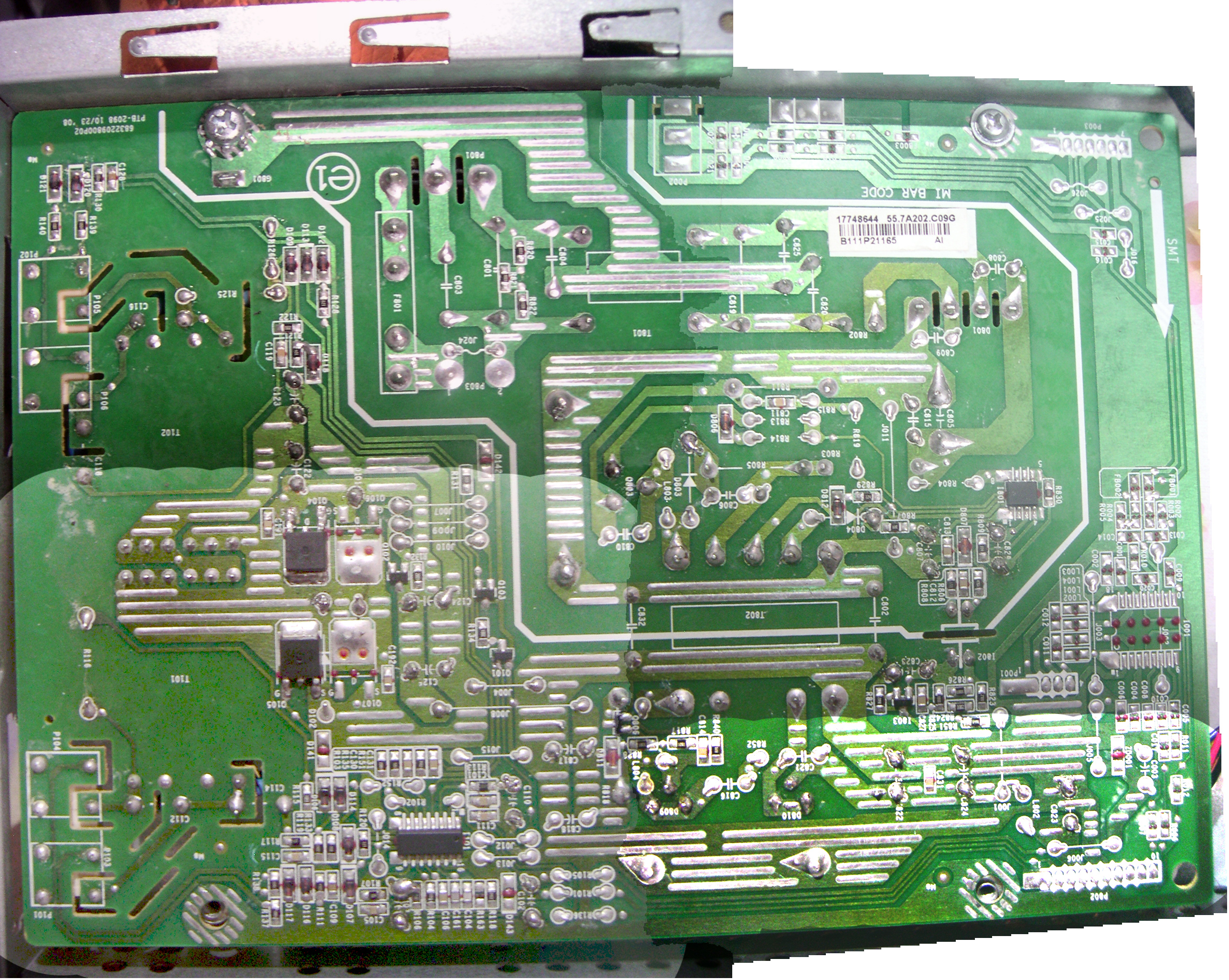

Acer G235H Abid (dead) no indicator LED

                Re: Acer G235H Abid (dead) no indicator LED
                i know it looks ugly, but this time the traces are very visible. it is composed of 4 seperete pictures hence the different exposure in the 4 sections of the one picture, but now the whole thing is visible
                thank you in advance
                if this one is still not good enough i will try again
                  There look to be one or two poor solder joints on the transformers and
                  some of those you have done on the caps look a bit grey (not shiny) but
                  as the screen did light up I guess the power supply is ok.
                  The cycling through the colours might be part of a self test. Did you have a working PC connected? At least you can tell if the screen is not damaged and the backlight works. Did you try pressing the menu button?
                  Looks like it may be the main board but it is very difficult to test all the tiny components on it so replacement is the usual step. They look quite expensive v the value of the monitor perhaps try and find a seller who will let you return it ,if it doesnt work?
                        i further rechecked the SMPS/PSU and by accident i tested for continuity of the 5v rail to ground, and there is a closed circuit, does that mean that i have somewhere a short to ground on the PSU? and that it actually might not be the mainboard but the PSU?
                        btw. it happens only when i plug the cord into the PSU without it the meter shows 117 in the diode mode, but as soon as i plug the power cord in it starts to beep and shows 266 whatever that means
                        ah yes that happens only when the psu is connected to the mainboard, well i guess then it is the mainboard that has somewhere a short to ground, that answers that, or at least i think that is what is happening. not sure anymore
                            so i believe to have found the fault in the mainboard, so i thought before i replace the LDO
                            uz1084l 3.3V, i thought i will turn it on and test it one more time, and to my surprise now there comes no voltage, so seems like the PSU got something shot. any ideas? i checked the bridge rectifier it seems fine, altough i had ca. 130V so i thought i will replace it with a knows good rectifier and did that, but strangely enough i get same voltage, i guess the rectifier is fine, but who knows
                            • Dogcatdog
                              • Sep 2015
                              • 76
                              #34
                              nvm it was a bad solder joint that stopped the PSU/SMPS from working, now it works again, so i went ahead and replaced uz1084l 3.3V, with an identical one, and the symptoms are same, on the in pin(right 5V) i get a short to ground as soon as i plug in the power, is this normal? or is this the problem?please help thank you in advance
                              Last edited by Dogcatdog; 11-22-2015, 05:24 AM. Reason: mentioned wrong pin, 3.3v actual pin is 5v there is the short
