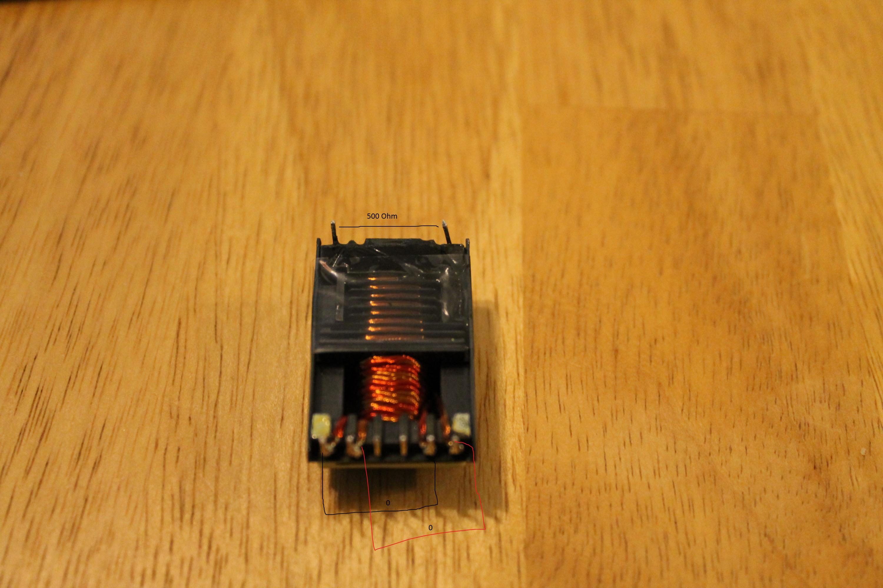

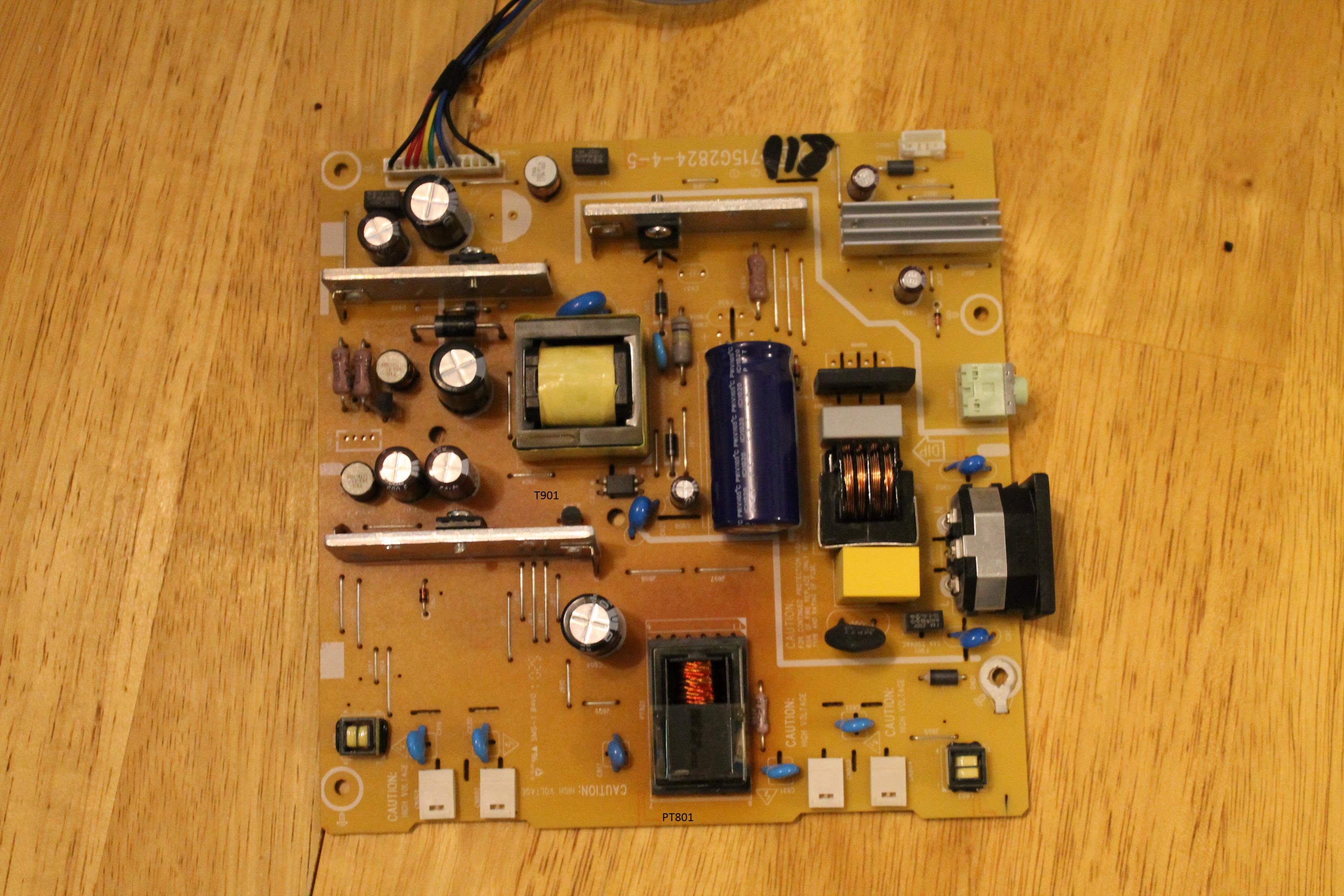

    Hello. I inspected a power board for a VA2431wm that blue led was constant but wouldn't turn on. On further inspection the cap near PT801 was bulging, so I replaced that cap with a NICHICON - HD Series UHD1E102MHD and 2 other caps that were also 1000 uF 25 Volts.
    When I put the monitor back together and plugged it in the blue turned on, but when I pushed the power button the blue led would turn off and on every 2 seconds or so. I removed the board and tried pluggin it in again and I was able to hear a short whistle sound every time the LED went out.
    I tested the transistor nearest to the bad cap, PT801. (part number 80GL24T-23-DN?, attached closeup picture with ohm readings) The side with only 2 leads had a resistance near 500 Ohm, while the other side corresponding leads were close to zero. The other Transistor, T901 (part number 80GL22T-3-H?, still in circuit, no close up) had all readings of close to 0.
    I used the service manual pdf acer_x233h_lcd_monitor.pdf for the power board reference. It appears the same board (715G2824-4-5) is used in both monitors. Here's the endpoints for all the windings:
    PT801
    1 and 2 winds to 5 and 6
    7 winds to 8 (Only one with resistance, 500 Ohm)
    T901
    1 winds to 3
    4 winds to 6 (5 is pictured but missing?)
    7 and 8 winds to 9 (bridged to 10)
    10 winds to 11 and 12
    Thinking about what I have read so far I'd think there is an isue with Transistor T901, but I'm not confident on my understanding of testing transistors yet. I would think PT801's Secondary windings would be 1,2 to 5,6, but that would mean they should have the 500 Ohm resistance, not 7 and 8.
    Please let me know if I'm on the right track or not, and if I am how do I find all the compatible replacement transistors. Thanks!

    "Thinking about what I have read so far I'd think there is an isue with Transistor T901," You are talking about TRANSFORMER NOT TRANSISTOR, right?
    Pictures of the bottom side of the board?
    The board looks over heated, you may have bad power MOSFETS which drive the inverter transformer.
    PT801 is the inverter transformer.
    T901 is the power transformer.
    "When I put the monitor back together and plugged it in the blue turned on, but when I pushed the power button the blue led would turn off and on every 2 seconds or so. I removed the board and tried pluggin it in again and I was able to hear a short whistle sound every time the LED went out."
    If the power transformer is the problem then you will not have your power LED.
    The power supply section (T901 is the power supply transformer) is an ALWAYS ON power supply, meaning it runs the minute you plug the monitor into the outlets.
    When you hit the power switch, the main board will send the command ON signal to turn on the inverter circuit, this circuit uses the most power so if it is bad it will draw lots of current which will send the power supply into shutdown-restart cycle so you will the see the power LED goes on and off.

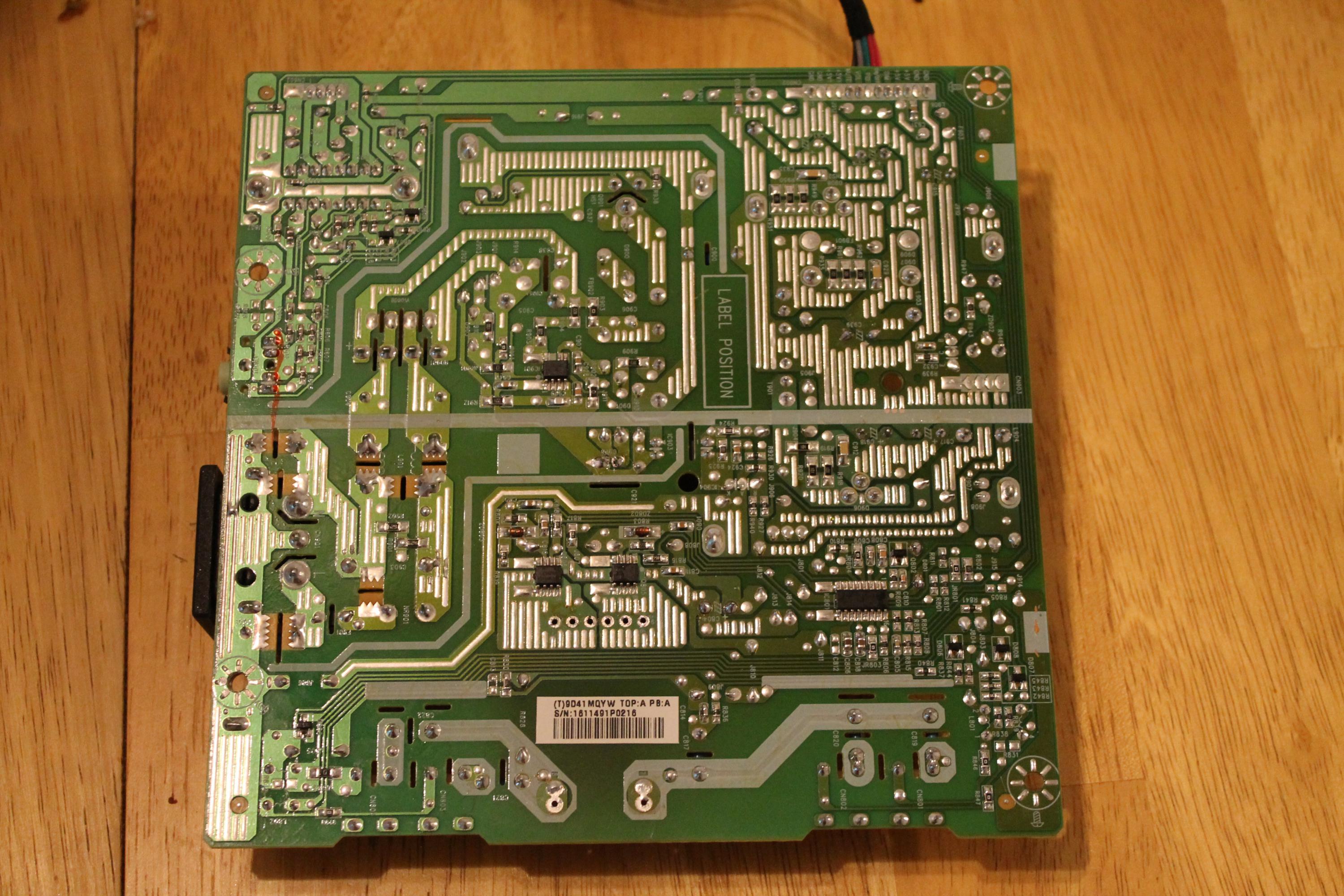

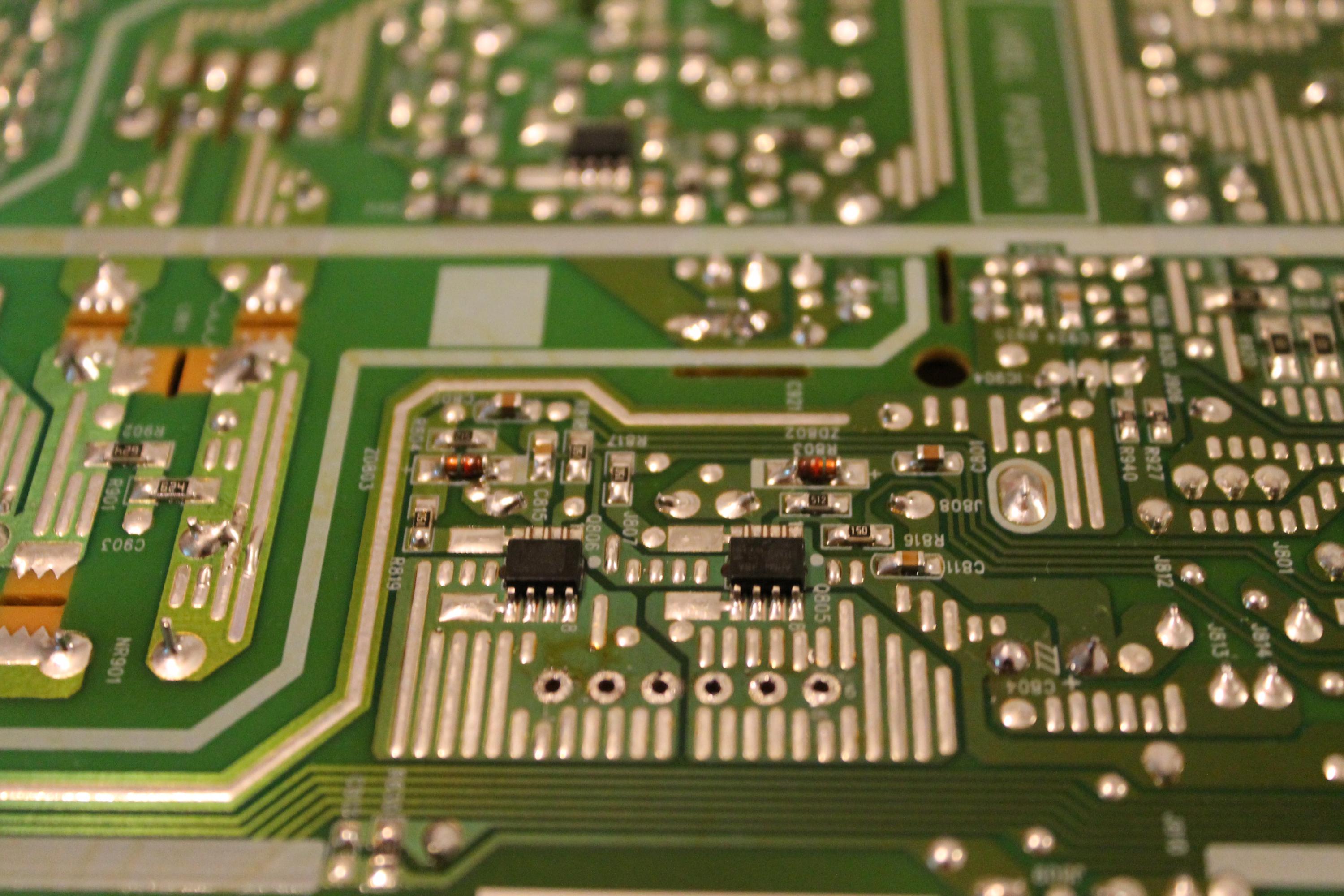

      Attached is a picture of the bottom of the board. It does appear that at least one of the ICs near the inverter transformer look like they have blots.

        They look like ICs in the 8-Pin package but actually they are MOSFETs. I think Q805 and Q806?
        It's hard to tell from the photo if they are blown or just have flux residue on them from the factory. Can you get a better photo?
        You will need to test them with your multimeter for shorts.
        Can you upload that PDF you talked about earlier so we can see the PSU schematic?

            Oh yeah I just finished testing the MOSFETs and I was typing up the following reply:
            Ok I did some readings with my multimeter on Q805 and Q806 (AO4620). Both chips are wired more or less the same with pin 5-8 bridged. Between Q806 Pin 5, 1, 3 and 4 show no resistance, while Q805 does not. So it appears Q806 is toast (and it looks like it is toast from it's appearance too.)
            Is there a substitute for AO4620 that mouser or some other US vendor stocks? I did see SI4542DY listed as a replacement but I'm not sure how suitable it is.
            Here's the best picture I can get of the MOSFETs now. I can get better shots tomorrow when it's daylight if needed. Also attached is the pdf with the schematic for the power board, starting at page 46:

              Don't worry about the photo, if the measurements differ then likely it's blown. Replace both at once though because even if only one has blown the other was probably overstressed during the event. Also, if you use a different model or manufacturer for the replacement you should not mix them.
              The SI4542DY is very similar and would likely work, but it is a bit slower going by the datasheet. I don't know if that would be a problem in an inverter driver or not. If you want to be sure, get one the same or faster. Where did you find the SI4542DY listed as a replacement?
