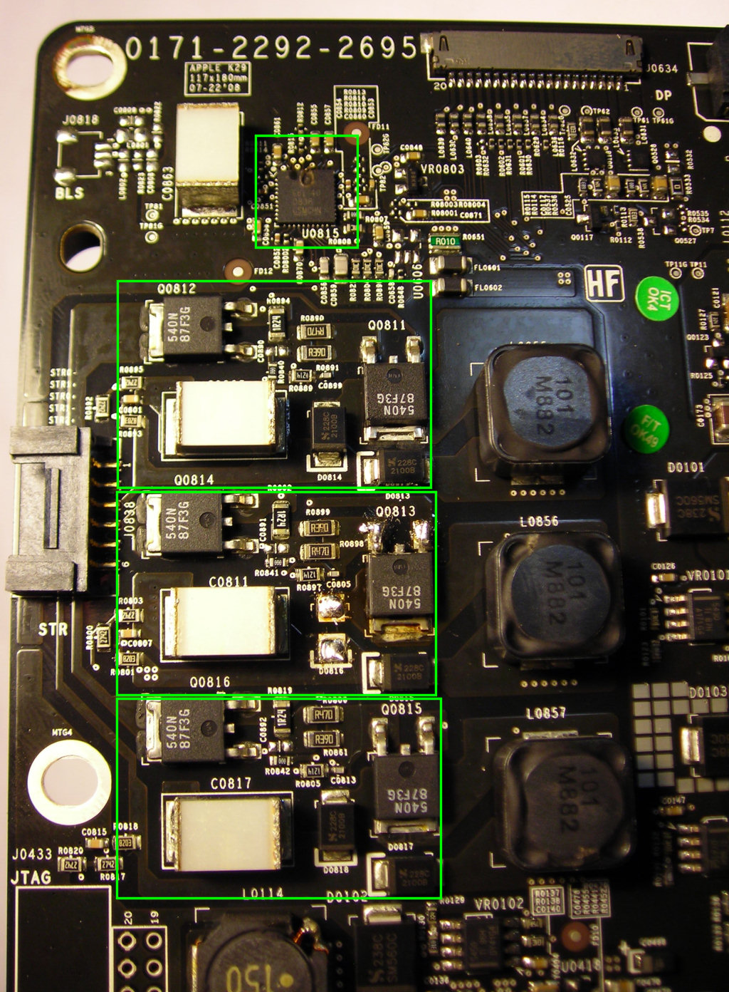

    This nice 1920x1200 monitor has dead backlight. Image correctly formed on LCD but no backlight. His owner says that last days it was working it got unusually hot in the lower side.
    Once opened, I detect a short mosfet (540N ?) and a short diode, plus a perforated IC [U0815] (cannot read its name as the perforation is precisely there). I don't have schematics (Apple service manual considers that nobody will repair it at component level) but I assume that [U0815] is a controller for 3 power LED drivers, one for each LED strip at the panel (LCD panel LM240WU6(SD)(A1), with 3 LED strips). Shorted mosfet and diode belong to a single power driver circuit.
    I attach image with interesting spots. Damaged driver circuit is the middle one (transistor disconnected and diode already stripped).
    Since [U0815] is irreplaceable to me, I'm forced to replace logic board, BUT, I'm afraid that there's something at middle LED strip that caused this failure to the driver and controller, so changing logic board would be a poor long term investment...
    And then the question: how can I cheaply test each LED strip to be sure that they're OK before buying a new board? According to panel datasheet each strip needs about 60V and 350mA.

    Re: Apple LED Cinema Display 24" (A1267)
    If your lab power bench can't reach 60v DC, maybe you can build a small circuit which inputs Mains voltage, rectify that AC to DC voltage and lower the voltage with a few 2W resistors.
    I have a power supply of some monitor here which does exactly that to get the voltage from 230v DC to 90v DC; they used 3 resistors in serie to get the voltage down in steps, thus not using one big resistor, maybe for heat dissipation reason or something.
    Or create something with a step-up transformer.
      You should check the resistance between the chassis and each pin of that LED connector (connector not connected to the board) to see if any one of those wires going to the LED strips inside is shorted to the chassis or not.
      If I remember it correctly those 3 Power MOSFETs are for the Boost converter to create the drive Voltage for the LED strings.

        I don't think it's that easy. My lab power supply just reaches 20V. But I think that when dealing with LEDs, the important point is current, not voltage. Without intensity control, I'll damage LED strips.
        Budm, I already checked for shorts. I don't detect anything in the range of 20MΩ, not even between any pin and chassis, or between any pin and each other.

          Both. You need enough voltage to overcome the forward voltage drop of the LEDs, but also something to limit the current too.

            I think that my best chance is to try replacing HV9982 and then I'll have two functional LED drivers (the middle one is bad). This will allow me to test each LED strip independently and detect anomalies (overheating, low light level, etc.).
              It will probably go into safety shutdown if any one of the 3 is not on, so you may only see the LEDs flash on for seconds. Probably should look at the IC spec to see how it functions.

                  Since I couldn't dessolder HV9982 with my tools, we ordered a new Logic Board (PN# 661-4823).
                  Replaced, monitor works fine. Lower part of LCD panel (where the LEDs are) is getting pretty hot, but I don't know what is "normal". There's a temp sensor sticked right there, so it's expected to be a hotspot. Time will tell...
