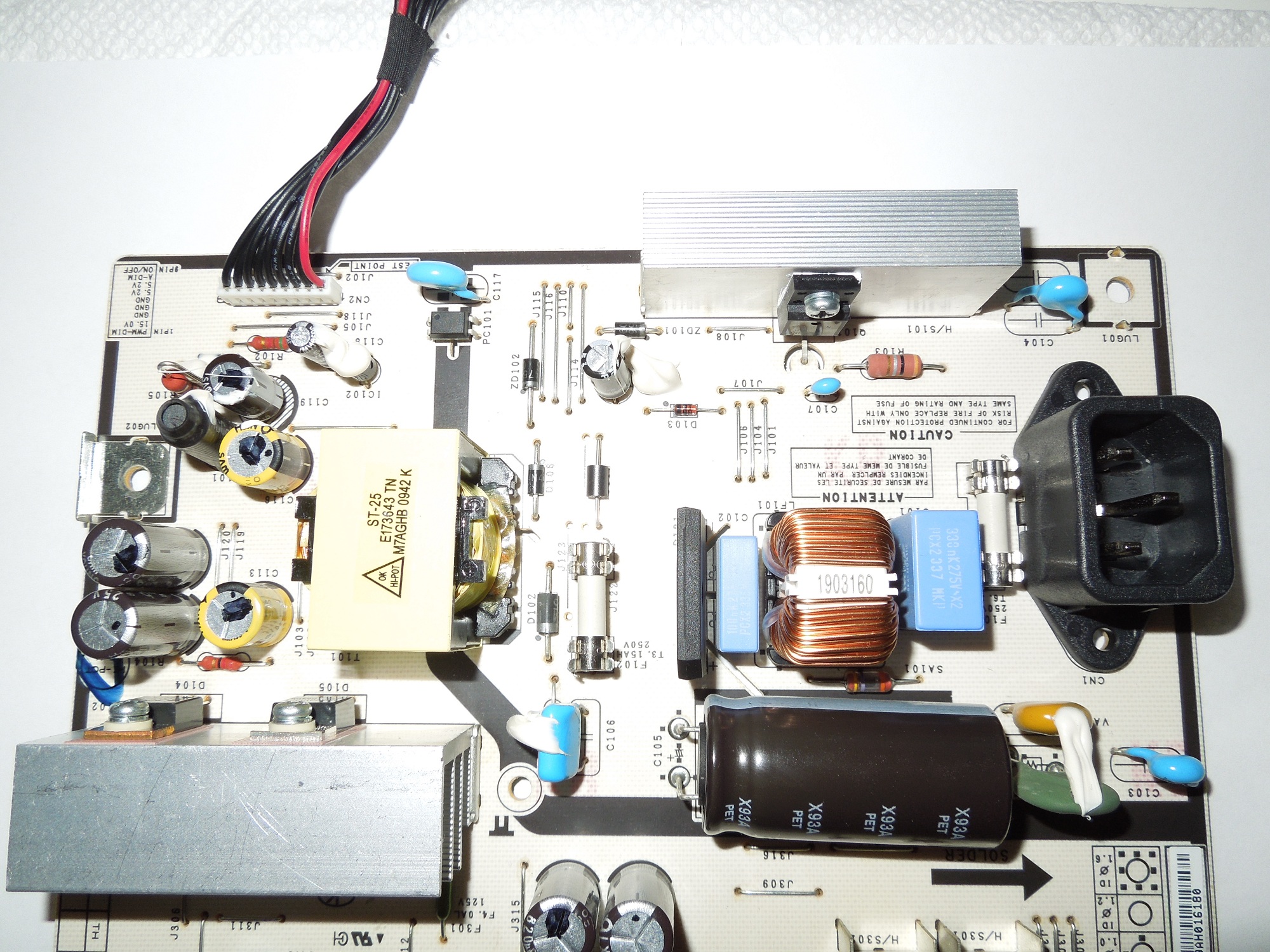

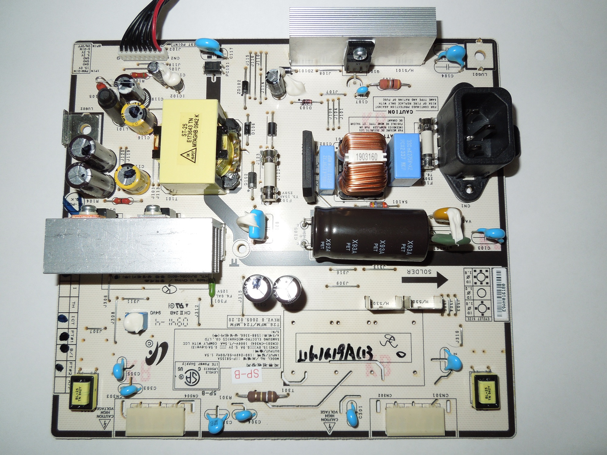

      Re: samsung t260 hd no power no led light power.
      hi budm i'm new on this all i have its a regular multi meter and sold iron to handle this, thanks very much for you reply i upload some pics front and back of the board.
        few more
          front of the board guys

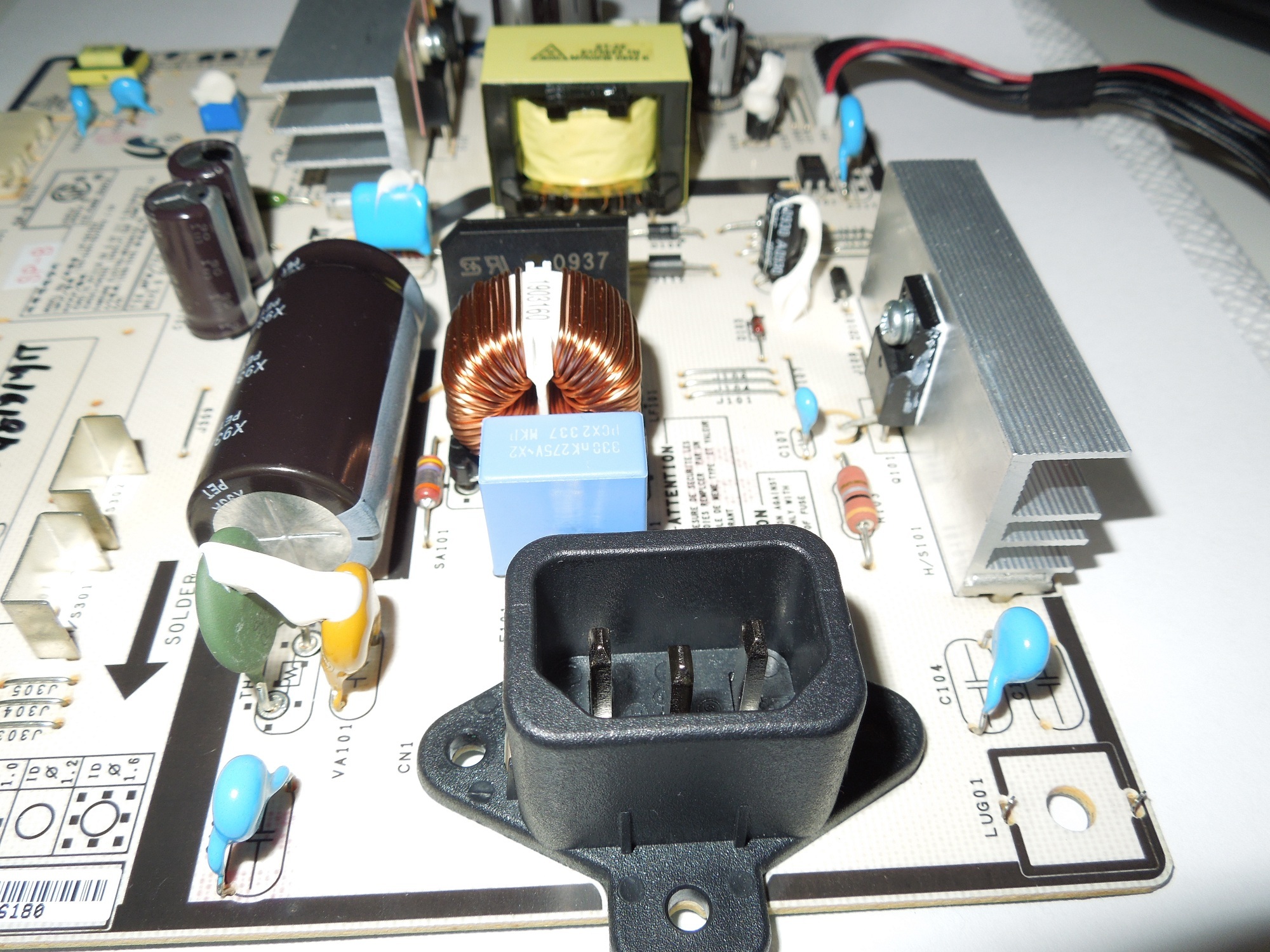

            back now
              So right now just to be clear, you DO HAVE power LED but you are not getting any backlights not even flicker of the backlights at all, right?
              There is SMD POWER MOSFET with 4 legs on one side and big tab on the other side, we need the P/N so we can verify if it is OK or not.
                no no power at all no flicker or backlights. any point to check here is SMD POWER MOSFET with 4 legs on one side and big tab on the other side, we need the P/N so we can verify, i'm new to this and need help how to check that?
                  OK, lets verify this first, disconnect the cable (red and black wires) between the power supply board and the main board. Power up the power supply board and then check the DCV on the connector pins between GND PIN and the 15.0V PIN, GND pin and the 5.2V Pin to see if it shows the correct Voltage
