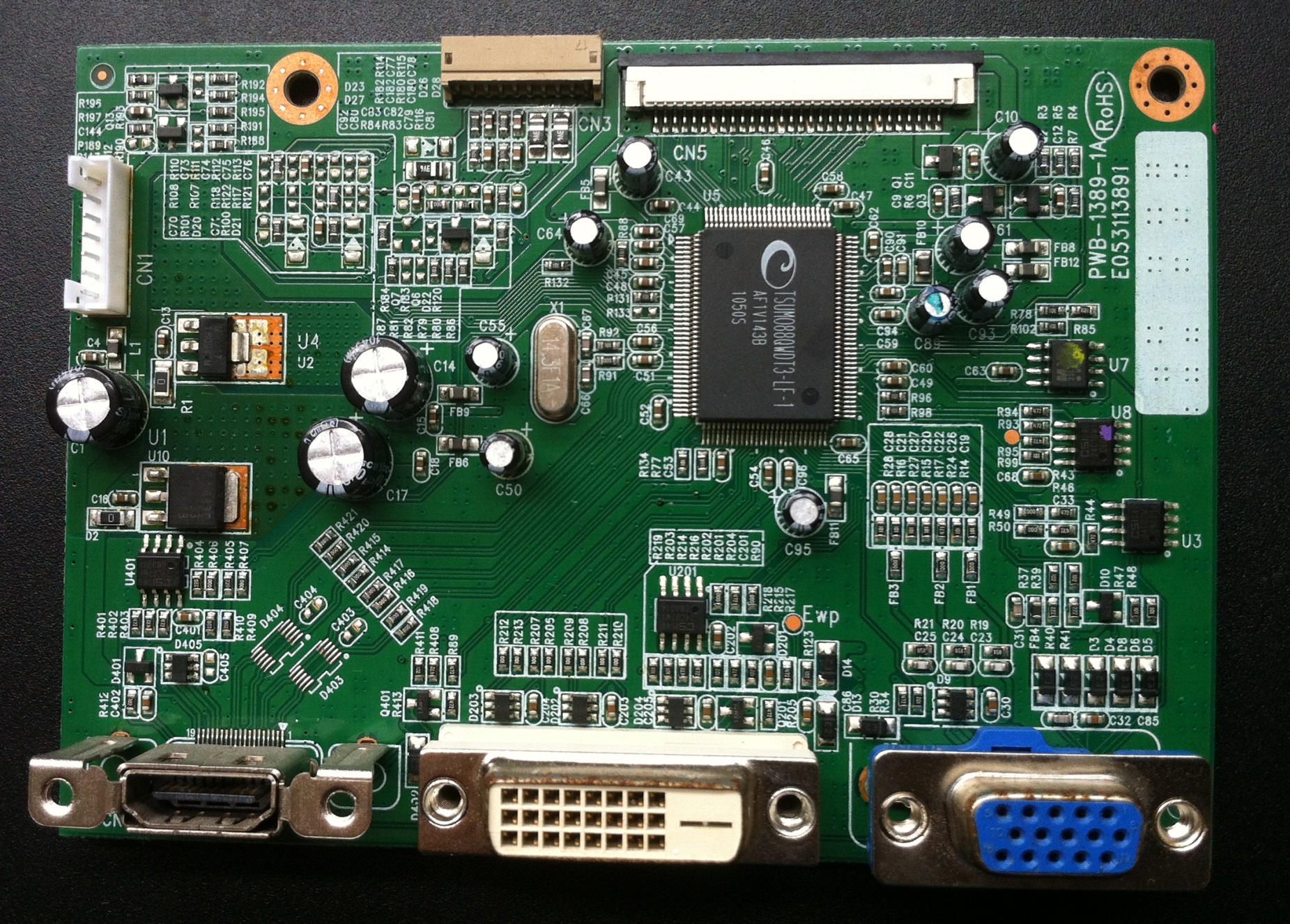

    6630a is the same pinout as the lm1117 and ams1084
    • gagaguu
      • May 2015
      • 20
      • singapore

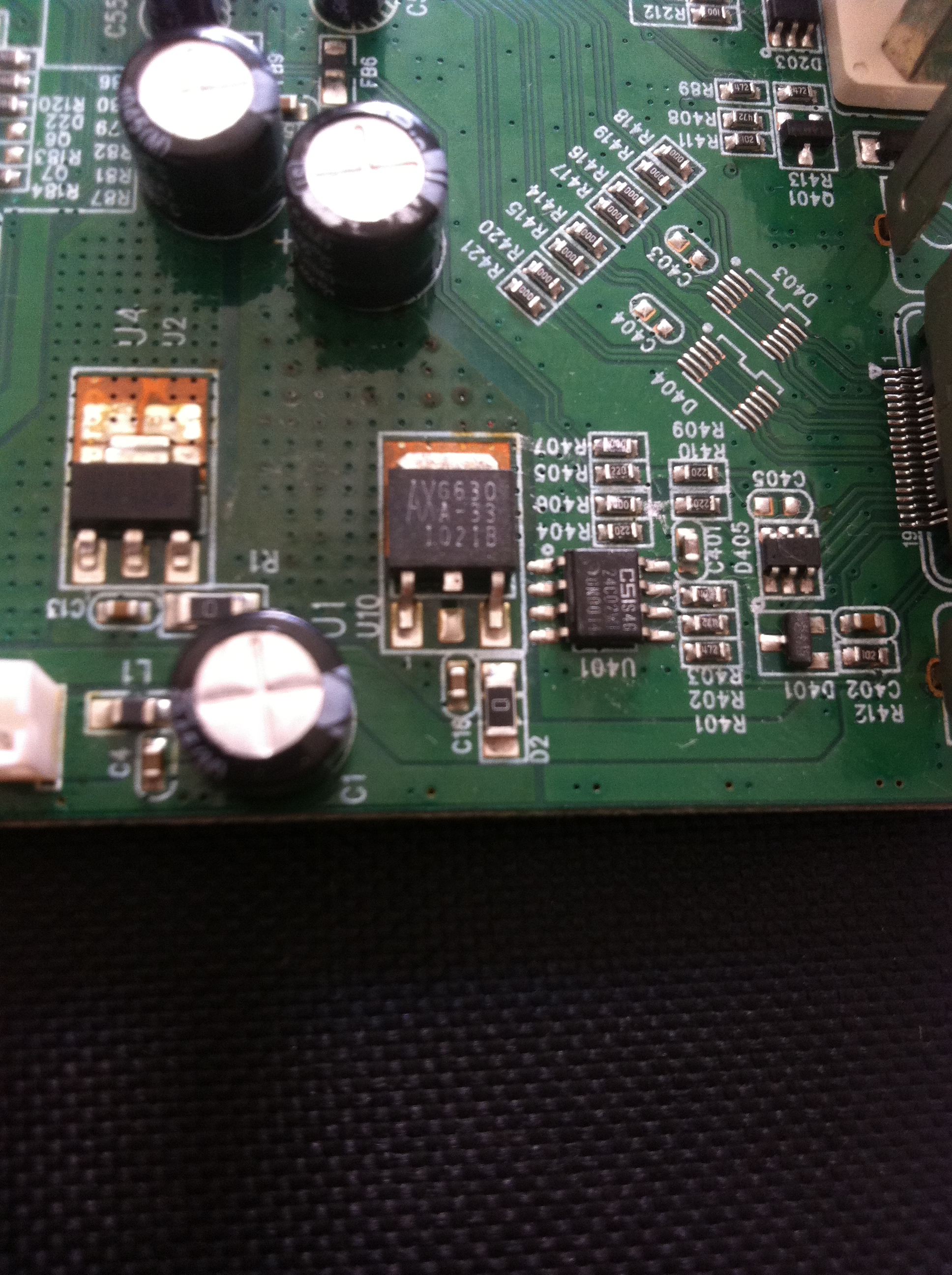

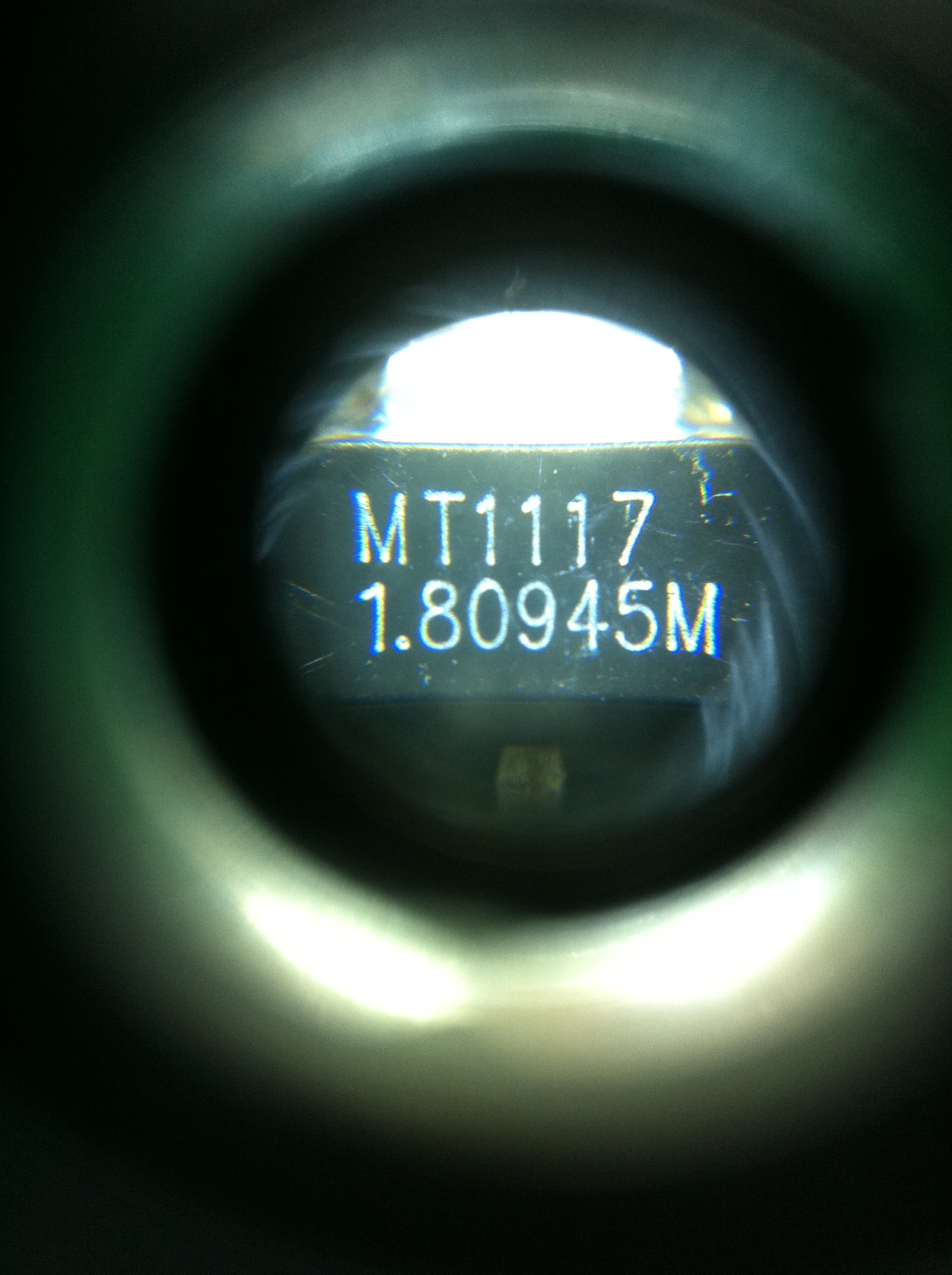

      Re: HP 2311F Monitor: Flashing on & off
      copy...
      U1 is for 5V to 3.3V
      and U4 (MT1117) is for 3.3V to 1.8V
      i will check for bad joints for those 2 regulators..
      thanks..
      • gagaguu
        • May 2015
        • 20
        • singapore

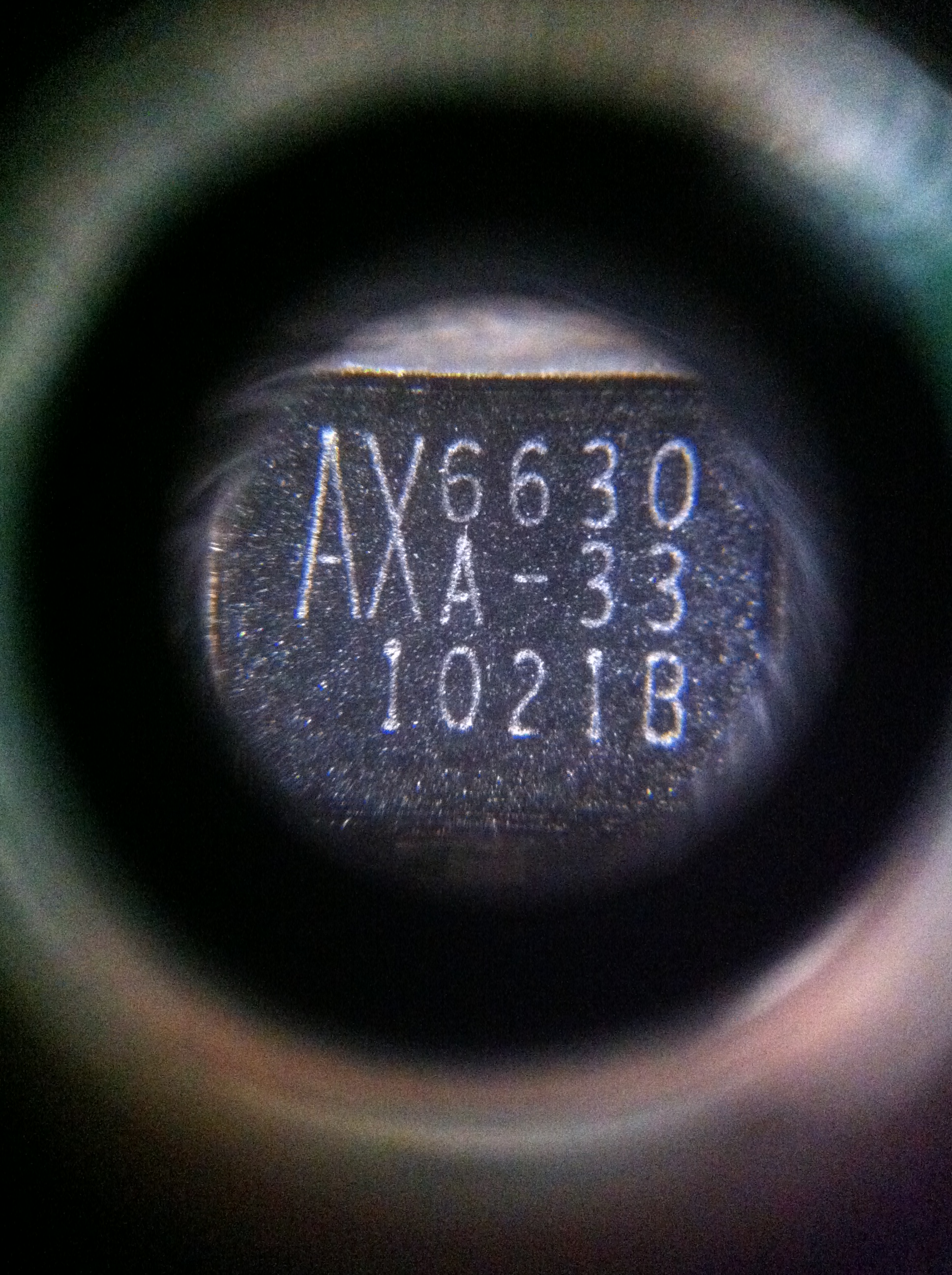

        Re: HP 2311F Monitor: Flashing on & off : Solved
        AX6630A was causing my display flashing on & off.
        tested it with following reading;
        U1 (pcb designation)
        AX6630
        A-33
        1021B
        pin 1 = 0 V
        pin 2 = 3.28 V
        pin 3 = 5.49 V
        IR temp reading = avg 41 deg C
        Spec states " temp shutdown at 140 C "
        i really don't understand the reason but my dummy test pointed out to U1.
        the history of this display is unknown when i got it.
        ( i have no idea how long it had been going on before.)
        compatible with LM1117DT-3.3/NOPB (TO252 package).
        thanks " stj ".

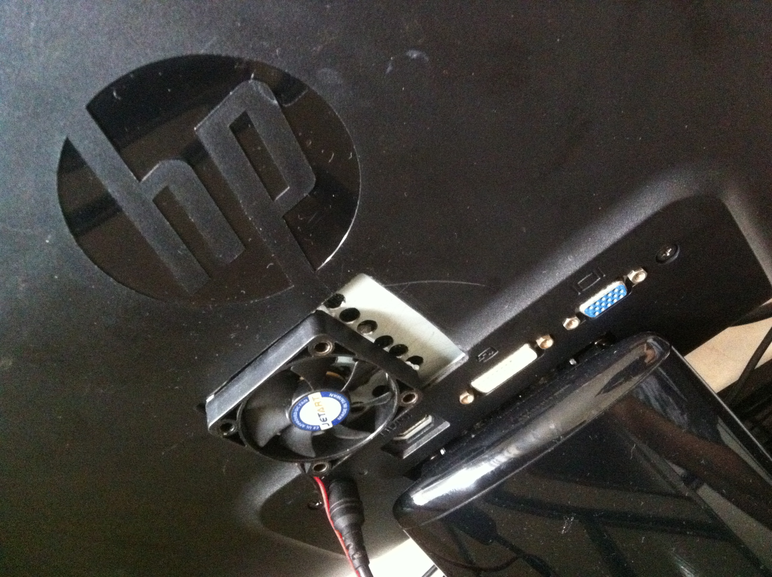

        all in all, the display works fine with small copper heat sink and small 12V fan (cut and attached at back cover).
        I also peeled the board coating off till copper lines appeared.
        it took time but i thought heat transfer would be better since they looked brown. (see attached)
        small sink with thermal paste on copper lines too..
        i dont trust my soldering skill, esp SMD, so i'll leave it with fan attached at back cover.
        last but not the least, this was my case of display flashing on & off.
        i really appreciate the members of this forum for giving a hand to a noob.
        i learn a lot and hope to come up with questions, again, in the future.
        sincerely yours,
        Win K. Soe

                  Special thanks to gagaguu and legacyhaze. I have the exact same monitor with the same flashing on and flashing off problem after about 30 minutes of play time. So I took out the A6630A voltage regulator and replaced with LM1117 3.3V surface mount chip.
                  Unlike the A6630A which has 2 legs with the middle one cut short and unsoldered, the voltage regulator that I bought has 3 legs. So I soldered all 3 legs onto the board and it worked just fine...........https://www.badcaps.net/forum/images...es/biggrin.gif
                  My first monitor repair. Cost is S$1.50 from Sim Lim Towers, Singapore.

                              I have seen PCB like this in Philips monitor. Check the voltages of the two Voltage Regulators on the MainPCB. If defective, they don't provide required voltages to the Processor and the monitor turns on and off or the picture flickers.
                              You will not find exactly this Voltage regulators, but you can replace them with LM series.
                              I repaired Philips monitor with exactly the same symptoms and behaviour and similarly looking MainPCB.
